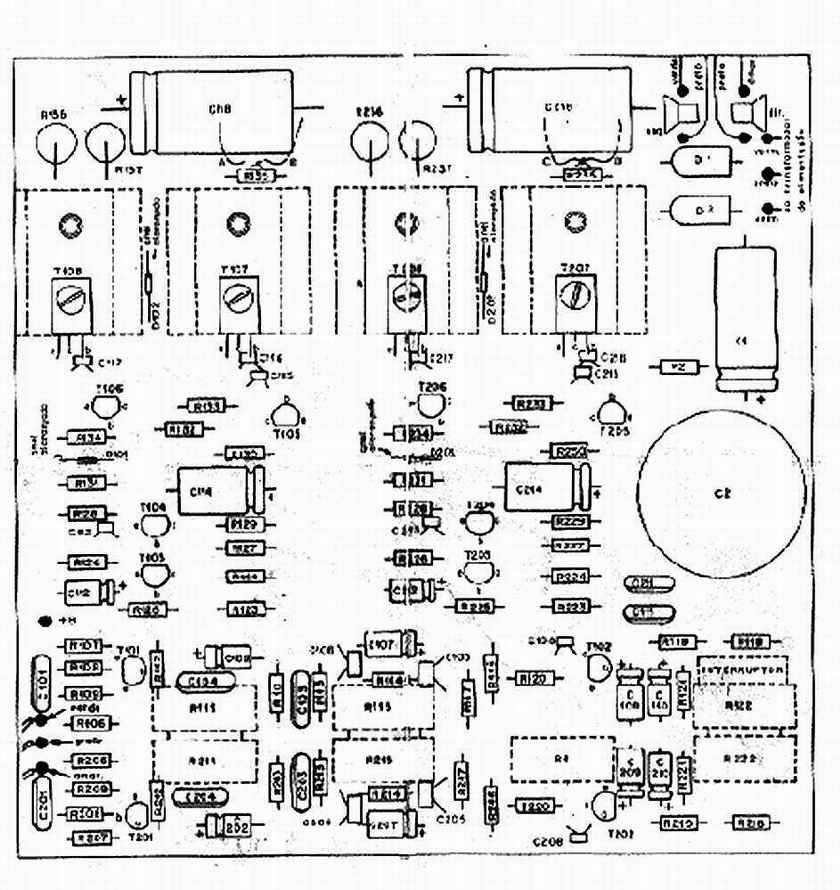

this is regarding a circuit developed by Philips in 1970's. it is a 40/25/15 watts amplifier with Universal preamplifier circuit. it was very popular in DIY groups at that time. it use to give a very good quality of sound, eventhough it was a AC coupled amplifier. originally the output transistors are BD182. but most of the people used with 2n3055.
do anybody have the circuit diagram. i got some printed circuit boards without circuit diagram.

I have this one....made by Brazilian Philips during the seventies
The files are in PDF.... they are 300K size.
Write me a mail with your adress if you are interested, than i will be able to upload you the pdf files.

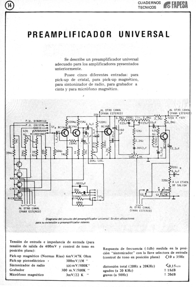

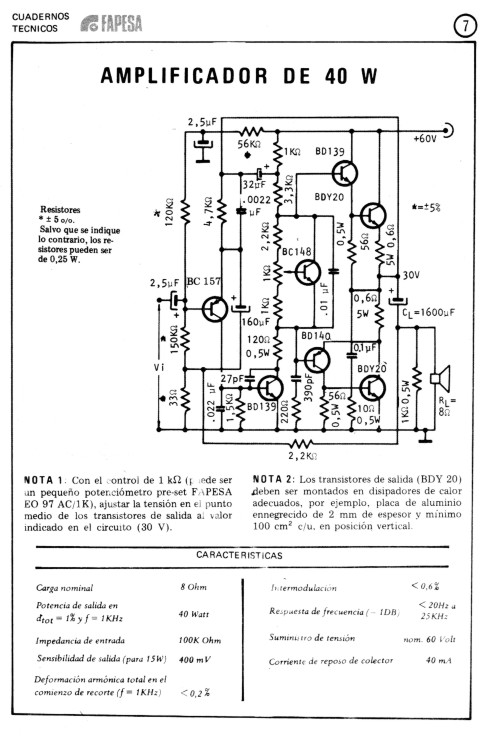

If any of you want the amplifier schematic along with the article (taken from "Audio Amplifier Systems" (3rd Edn.) 1972, written by Mr. Hull from Philips, Netherlands - I have a copy of the book, and it is a priced possession!) please email me to philipreji@gmail.com.

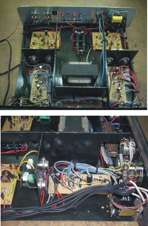

I had made this amplifier in... 2011 (a month ago)!
See how many cables!
I look for that book long ago (Audio amplifier systems by M. D. Hull)...

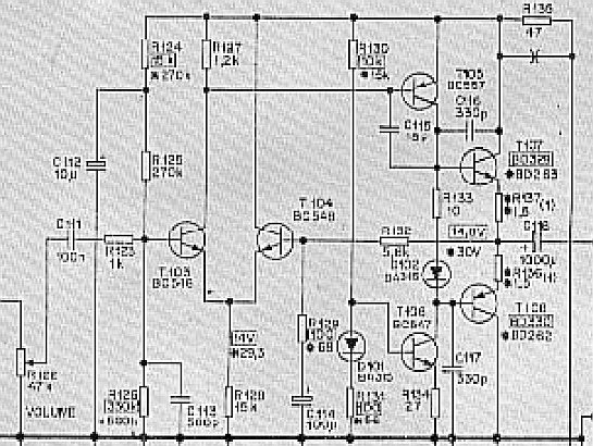

The sound is a bit bright, but balanced enough to be an old design.
The 2N3055 was built in 1982 but BC548/549 are current and have been selected for gain (hFE> 500).
I could not get the BC108/109 nor BD182 ...
The power supply is stabilized (not that you can see in the picture), but the sound has a very small buzz, I am working to remove it.

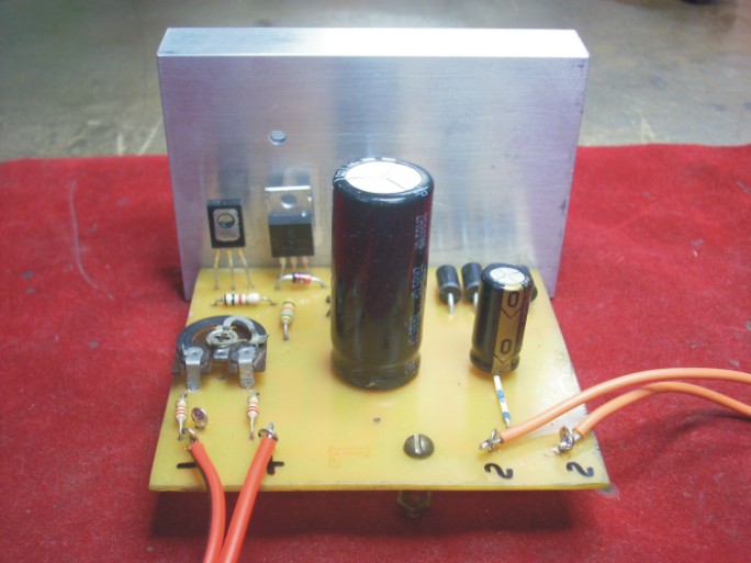

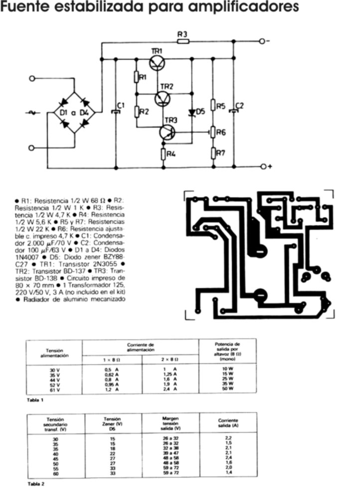

Photo and schematic of the power supply (not the original design):

I think BD182 is not available anymore. I used an unregulated power supply of maximum 70 VDC output (when unloaded). When the amp was running the voltage was around 65 VDC. This amp seems to have a small hiss: probably due to its relatively higher bandwidth.
The quasi-complementary output stage in the original design is a trade-off due to the much higher cost of PNP power transistors in the early seventies. The situation being different now, what about using a true complementary configuration for the output stage (pairing 2N2955 and 2N3055)? Will it make the sound even better?

There are several aspects to this old circuit which can be improved with a little tweaking. I also built this circuit but didn't like the sound much compared with a Bailey. Main reasons are due to the large roll-off capacitor on the base of the VAS (22 nF); and using slow BD182 (can use 2N3055). If you use a complementary pair (2N3055/MJ2955) you can improve the output stage and reduce crossover distortion. Negative feedback should not be taken from the loudspeaker: use a 1.5k directly from the mid-rail. Maybe this was an attempt to improve the bass response with a small output capacitor. Use a bigger output capacitor: modern computer grade capacitors with low ESL and ESR will probably allow 10mF in the space of an old 1.6 mF and give much better bass and not cause undue distortion.
I found that the high input impedance using 150k resistors gave a lot of LF noise. You can reduce this by using a pair of bias resistors (say 27k from tap to + and 22k from tap to GND) and a 22k from the mid point to the base of the input PNP. Use a 10 to 100 uF capacitor from the mid-point to ground to filter the supply line.
FInally, change the HF bias by removing the 27 pF and 22 nF slow-down caps. Replace the 390 pF by a 220 pF and bypass the 220 ohm series resistor; use a 220 pF capacitor between the pnp base and GND to make sure the base impedance is always low and change the overall frequency comp capacitor to 220 pF as well.
You will find that you have a very good amp with these mods which gives less than .01% THD at 20 kHz and negligible crossover using a CP output.
