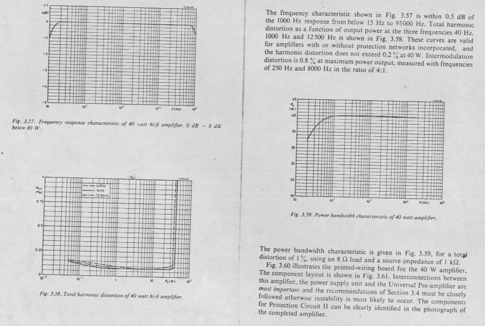

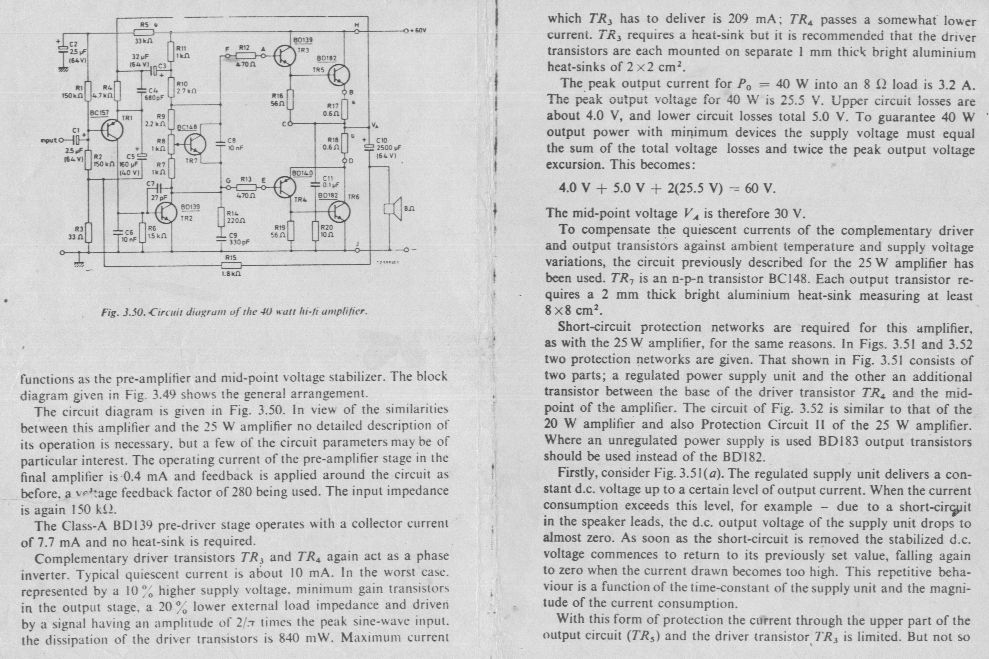

hpavictor
would you please be so kind to post the figures 3.51,3.52,3.60,3.61 that are mentioned in the text you already posted?Thanks in advance!

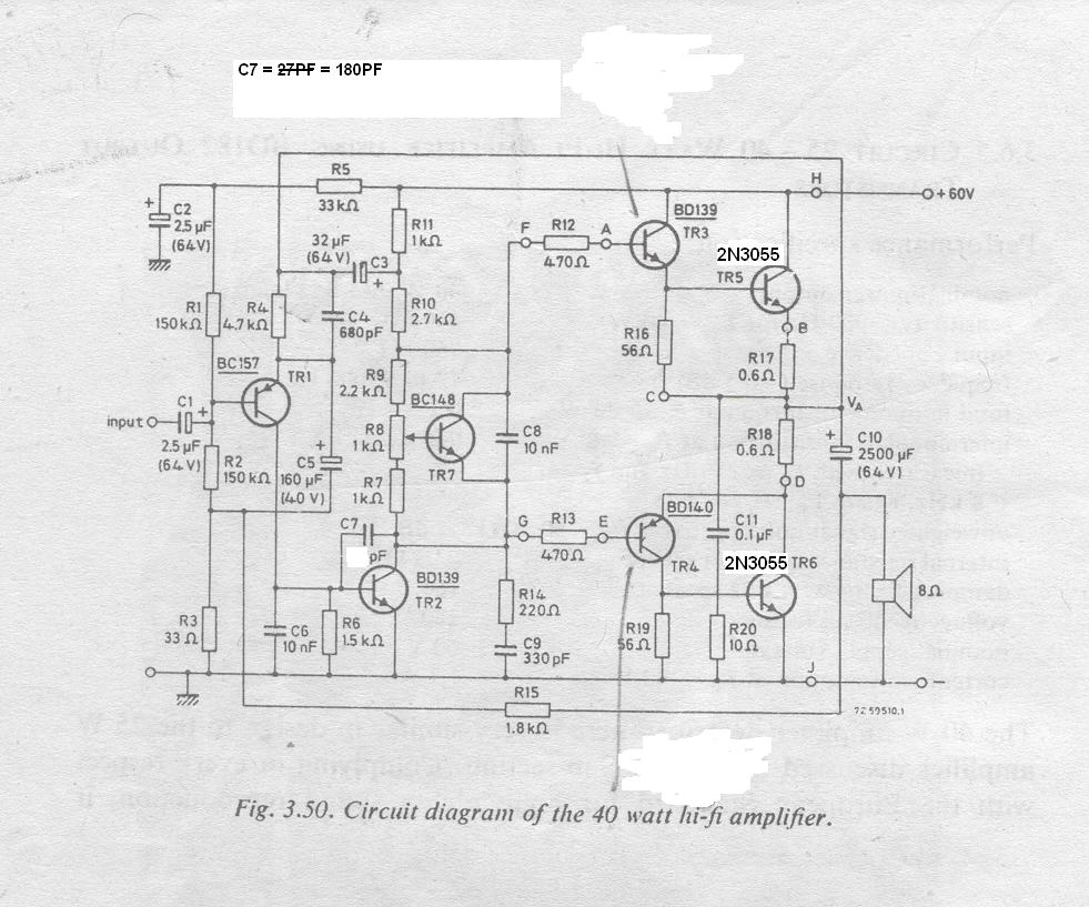

Hi
This circuit isn't the best. I have simulated it using my 2N3055 model (ft~1 MHz) and it does give ~95 kHz band width. But the distortion at 10 kHz and 35W is 0.47%, not 0.1 as advertised.
Mostly this is crossover distortion, and seems to be caused by the Miller and "slug" capacitors C7 and C6. ALso the feedback from the loudspeaker may reduce capacitor distortion but causes clipping at low frequencies, so bass will be poor (differentiated) at high power outputs. Good capacitors today with low ESR and ESL should be OK.
At 95 kHz the capacitor C9 draws 3.6 mA at 40W. If you use slow BD182's or 2N3055's the gain will be falling to around 10 and need 400 mA base drive. The gain of the BD139/BD140s drops to about 30 so the base current needs to be 13 mA, requiring a total current in the VAS of about 15 mA. Since the VAS should remain linear, the current needs to be more like 25-30 mA to meet spec.
If you use faster 2N3055's -or a 2N3055/MJ2955 pair - then the gain will be a little higher at 95kHz and maybe need only 7 or 8 mA, suggesting that the VAS current could be ~15 mA. Conveniently this can be provided by two 1k load resistors, but the VAS will need a small heatsink.
Eliminating the loudspeaker feedback resistor means that the overall feedback resistor should be changed. It could be 1.5k with a 47 ohm "grounding" resistor.
A better bias arrangement for the input PNP is to divide the supply voltage into approximately half (less a little bit for the Vbe offset) using, say, a 27k and 22k resistor pair and connecting the base through a 10 to 22k resistor. The bias tap should be decoupled with a capacitor, but this only needs to be a 40V unit instead of 64 or 100V when connected as shown using high value bias resistors. This alternative bias arrangement seems to reduce low frequency noise.
Finally I would remove the Miller and shunt capacitors C6 and C7. Replace the resistor R14 with a wire and add a 220 pF global compensation capacitor across the feedback resistor.
Finally re-route the upper output transistor 56 ohm resistor between its emitter and base to equalise the driver currents.
Simulated distortion is now 0.1% at 10 kHz and 30W output. 2nd harmonic is 0.1% and third around 0.05% with reducing crossover components below this.
The main distortion component is 2nd harmonic which is due to Early voltage distortion in the VAS. Use a cascode to more or less eliminate this and the distortion reduces to 0.03% -as it should have been for HiFi.
A small improvement can be achieved using a complementary pair with a single base bias resistor between the two bases.

Philips 40w Amplifier with universal preamplifier
I have done what exactly stated at the book by M.D. Hull both preamplifier and Amplifier ckt but there is motorboting sound in no signal condition please give me a remedy.......
Is there any problem with BD139 & BD 140 matching hfe?????????
I use 2N3055 as output
It's very probably a grounding problem, you'll have to be careful on how and where you ground different parts of the amp.
One general purpose solution is using separate ground return wires, at least for the speaker, main amp and preamp, all going to the PSU main capacitor negative.
It's more complex than that, but at list this is a first step.
I also make an arrangement for separate grounding but the problem persist.
Finaly i notice that if i replaced the capacitor C7= 27 pf by a 180pf capacitor then there is no motorboting sound but there is a broken BASS problem in FULL BASS condition.
