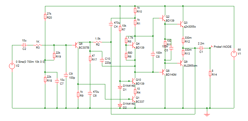

This circuit is my version of a pretty standard complementary single-ended 40W amplifier.
It builds on a number of ideas discussed by Bailey, Gibbs and Shaw. Bailey presented a complementary amplifier in 1968 in Wireless World and Gibbs and Shaw published a version using the cascode pre-driver stage in Practical Electronics in 1971.
It represents a step function improvement on the Mullard/Philips circuits in the following:
(1) the input stage uses a low impedance bias network which reduces LF noise with high input impedance sources (the input impedance however is low at ~20k)
(2) The pre-driver cascode circuit eliminates Early voltage distortion that Bailey was very concerned about
(3) The output stage uses classical complementary pairs, with base-to-base resistor to prevent crossover currents from the drivers (and maybe speed up turn-off of the output)
(4) frequency compensation is achieved with a 100pF input capacitor to ground and a 220pF loop compensation that avoids the Miller capacitor.
Simulated distortion is 0.022% at 10kHz.
If this amp oscillates then it will usually be cured with a "sprog. stopper" capacitor of 220pF between the base of the PNP driver and ground.
It is possible that this could be built on a PCB for the Philips circuit with some simple modifications.
Regarding motorboating: check with an oscilloscope if this is LF oscillation or "sprogging" due to HF oscillation. If HF then you will need to increase the pre-driver transistor base-to ground capacitor to e.g. 22nF or increase the Miller capacitor.
Poor bass response is due to the feeble output capacitors. Despite the PHilips circuits having feedback resistors from the outside of the output capacitor the weak value seriously limits LF perforamnce.
Although I have shown only the classical 2.2mF (=2200uF) at least 10mF is really needed - and 22mF for good bass.
Revert R17 and C6 such that it s the resistor that goes to ground
and then pick the output through a FB resistor that goes to the
common point of thoses two components.
This feedback resistor should be equal to R2 , this will ensure
good enough bass response , to keep the same gain you ll have
to use two 3k resistors of course.
Hi Wahab
This only works in small signal mode. Nothing can compensate for a small capacitor at full drive at low frequencies - try simulating a square wave. Even the droop at 20Hz is poor with 2.2mF, and if you split the feedback as you suggest it may reduce this effect at low powers, but the output capacitor voltage increases to keep the output constant. So the amp will not be able to deliver full power at low frequencies even with a split feedback.
I think it is better to use a bigger capacitor, to avoid low frequency transients from sounding "empty" if insufficient power is available, or the bass may be "artificially boomy" with a capacitor recovery overshoot. The point is, the capacitor voltage should not change with a signal. This needs a big capacitor! (Or none, as most amps are now directly coupled).

Hi John,
Thanks for modifying the venerable Philips amp !
Few queries: (i) Is the bias current through output devices fixed? (ii) Since the extra current required during high amplitude signals will be provided by the (large) power supply reservoir capacitors, is it really necessary that C1 should be as high as 2.2mF? (iii) How does the decrease of input impedance to 20 K affect the overall sound?

Hi
This is a class AB amp which means that the quiescent current should be enough to minimise crossover distortion. Typically 50-100mA. Usually adjustable bias resistors are used to set this but you can trim fixed resistors with extra resistors in parallel.
2.2mF was a common value (used in many amps in the 70's) but is not enough for low bass. You can think of this as a minimum. My point was that feedback from the outside of the capacitor is worse at low frequencies and high output levels than feedback inside from the output (mid) rail, and reasonable performance is possible even with 2.2mF - it depends how "strong" you like the bass...and whether your loudspeakers work well at low frequencies. If you only run "bookshelf" or small speakers with a respose to about 80Hz you may not notice the difference with larger capacitors!
The lower input impedance should not affect performance, as this depends largely on the preamplifier output impedance. The input resistor of 1kohm may have more influence but is intended to reduce slew rate distortion and RF pick up. The input capacitor is added for stability: again, if a preamp is connected then this may not be required for stability reasons but may help for reducing high frequency (transient) distortions.
