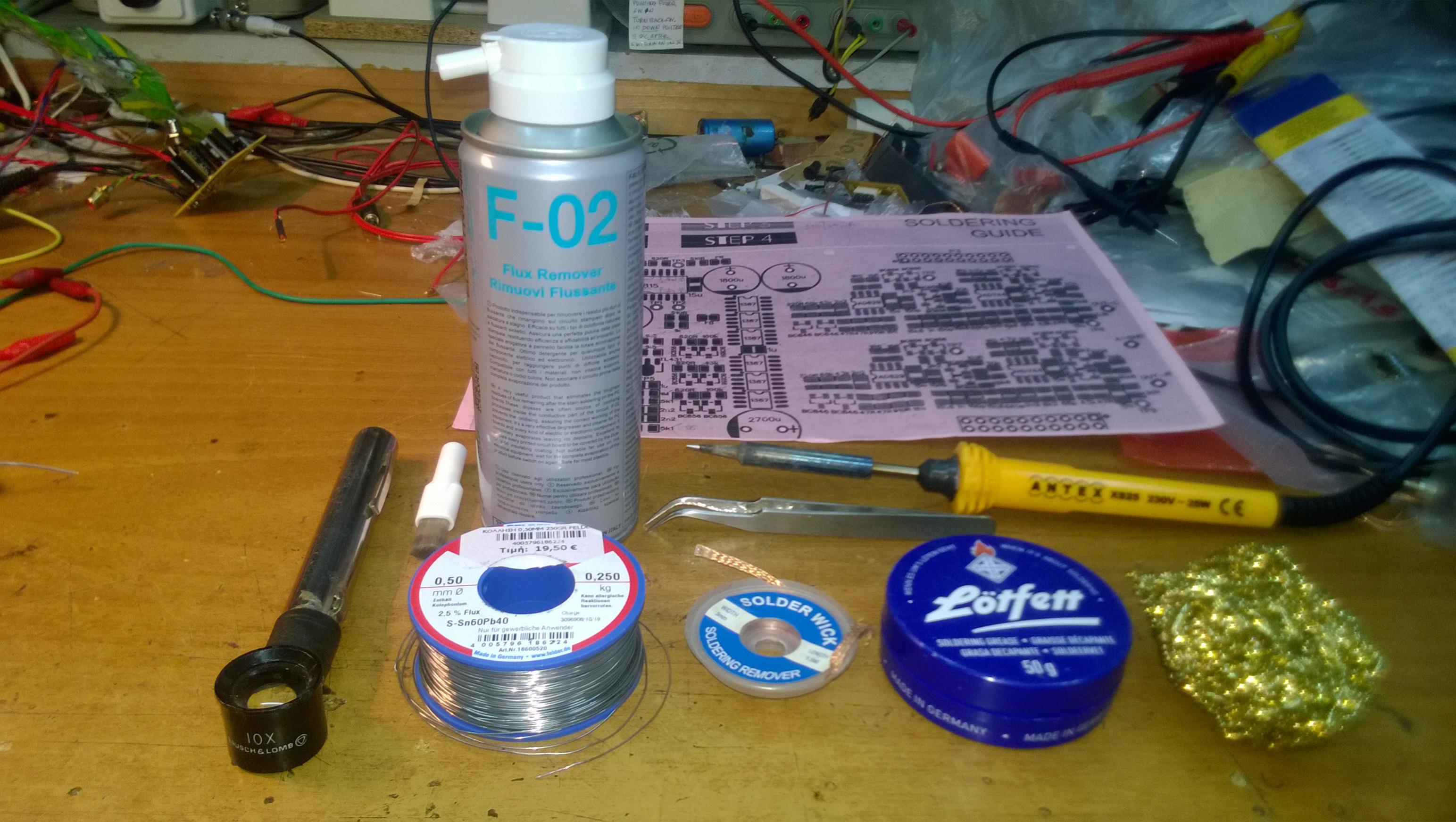

It really helped me a lot in soldering the SMD parts when I used thin soldering wire.
0.5mm solder and 0.5mm tip on the soldering iron.
I applied flux paste with a small brush on the PCB pads.
I find it easier to solder the ICs first, then the transistors, then the resistors and capacitors.

My lead solder is 0.8mm and standard Goot soldering tip that is too big. Usually there is too much solder on a big tip and l have to suck it up the excess

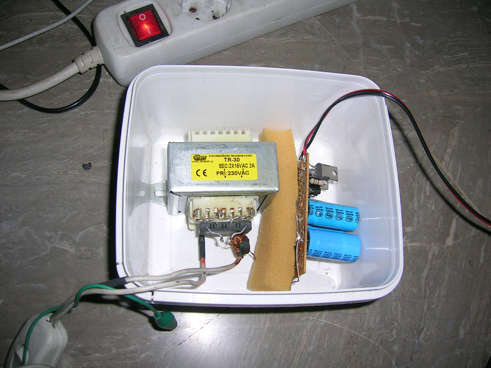

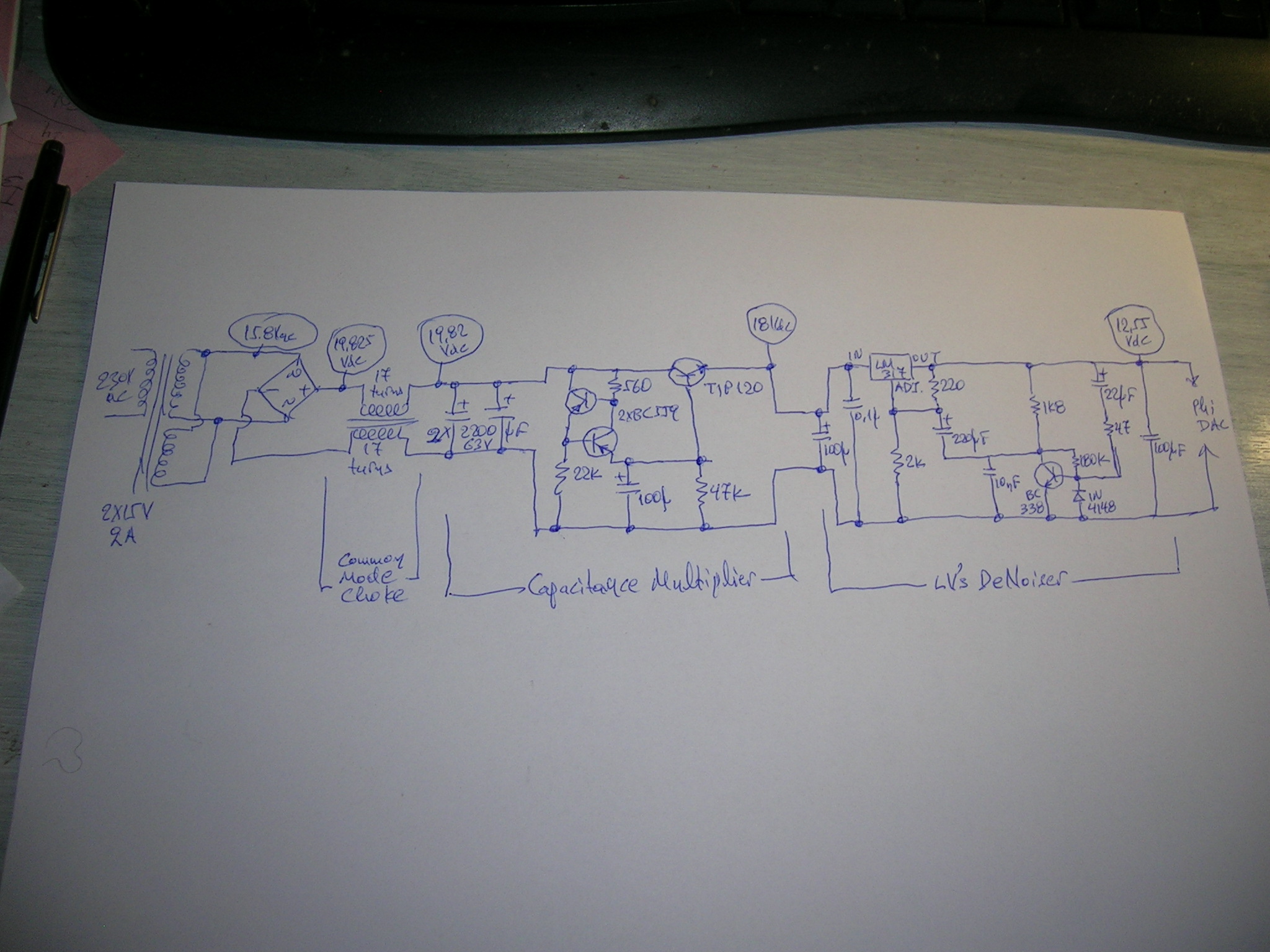

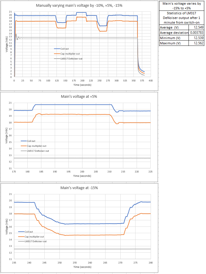

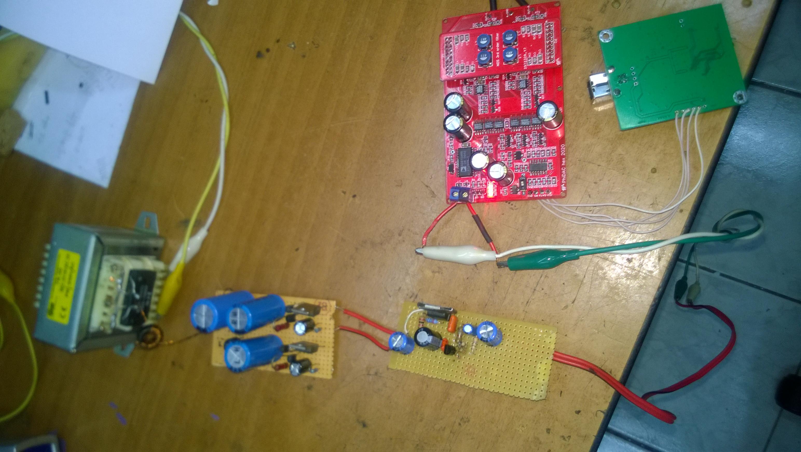

I set up this PSU for the PhiDAC hex from parts I had.
I wound the common mode choke. 3.1mH, 45mOhm. 17turns bifilar winding of 0.38mm enamel wire over a toroidal ferrite core (12.5mm OD, 7.7mmID, 6.4mm height)
The cap multiplier is a left over from some old project (probably for an JLH headphone amplifier).

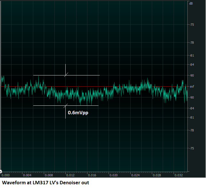

The LM317 voltage stabilizer is Elvee’s brain child: D-Noizator: a magic active noise canceller to retrofit & upgrade any 317-based V.Reg.

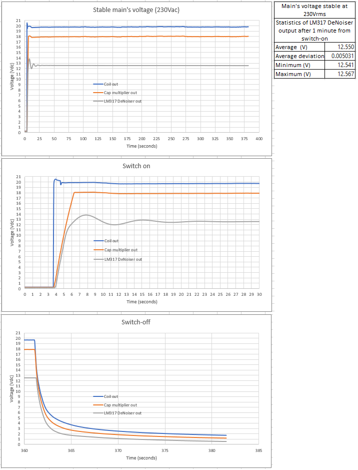

Static measurements of the whole PSU look good.

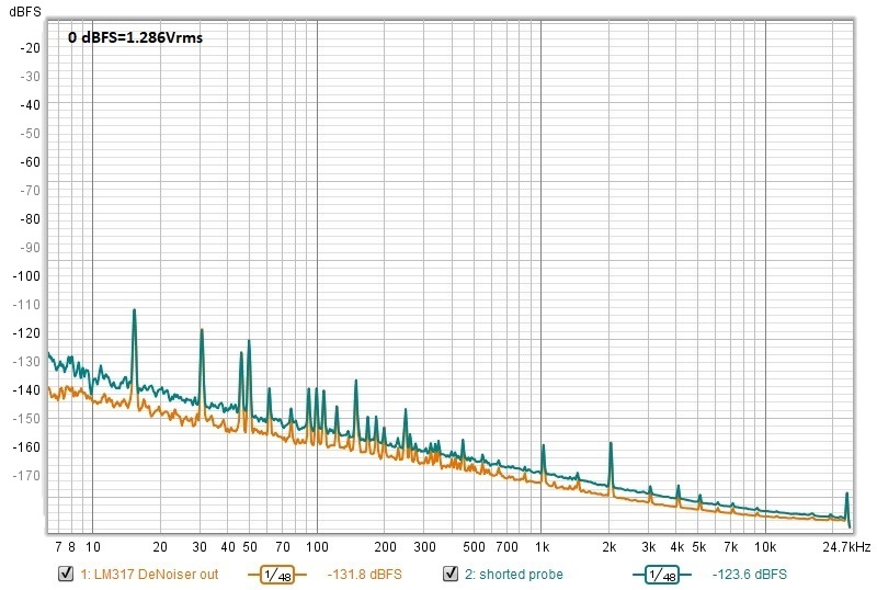

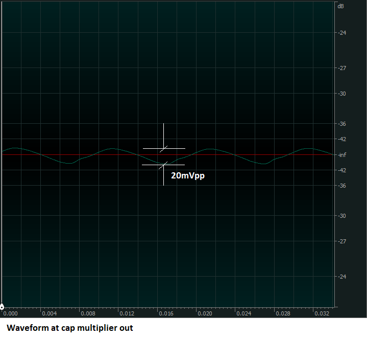

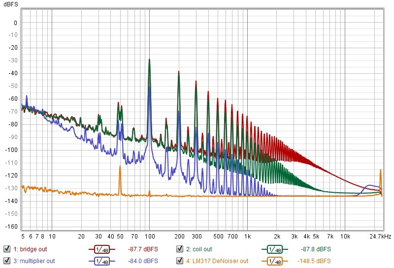

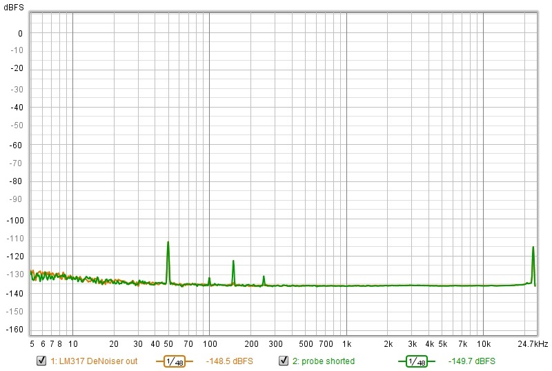

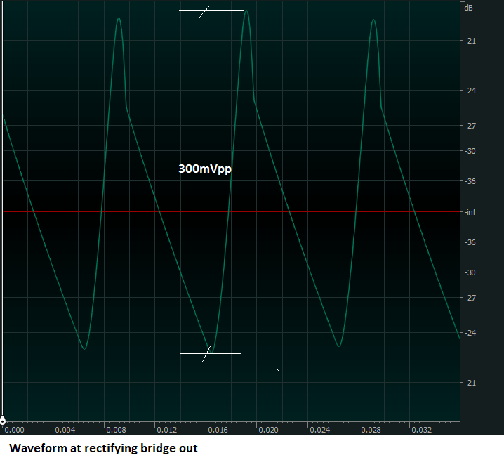

The two FFT plots in the previous post seemed a bit suspecious to me.
The testing chain was: 100MHz (x1) probe, into an Hameg 203-7 oscilloscope. The Y out of the scope into the M-Audio USB Audioplile soundcard, then reduction of the gain (-14.073dB) in Audacity to compensate for the increased gain of Y out. I noticed that smoothing in REW’s RTA plays some tricks in the vertical scaling.
I run the test again. This time the testing chain was: 100MHz (x1) probe, into my AD620 test preamplifier in (x1) single ended configuration, then AD620 output into the M-Audio USB Audioplile soundcard.
FFT plots vertical scaling is proper now.

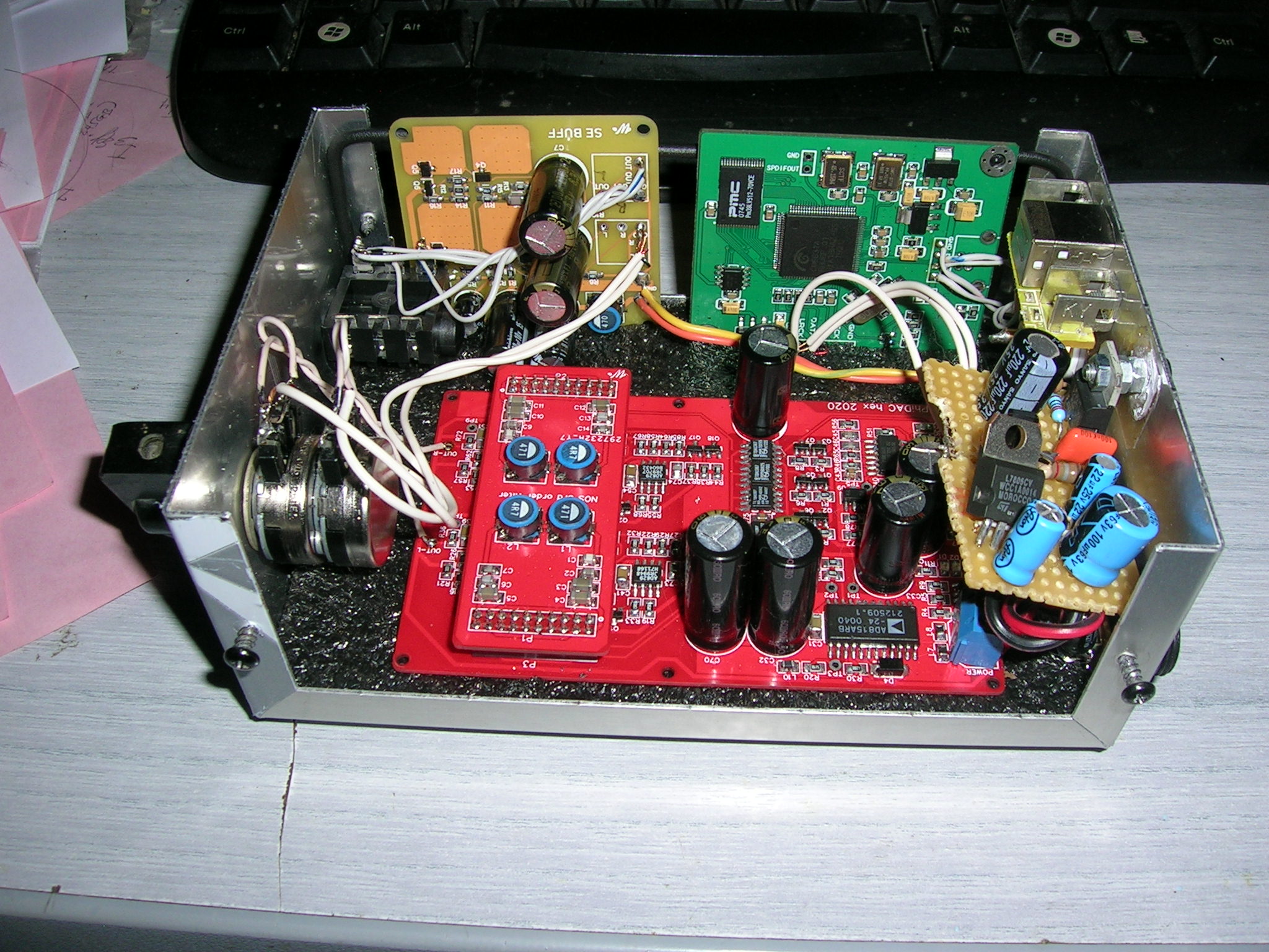

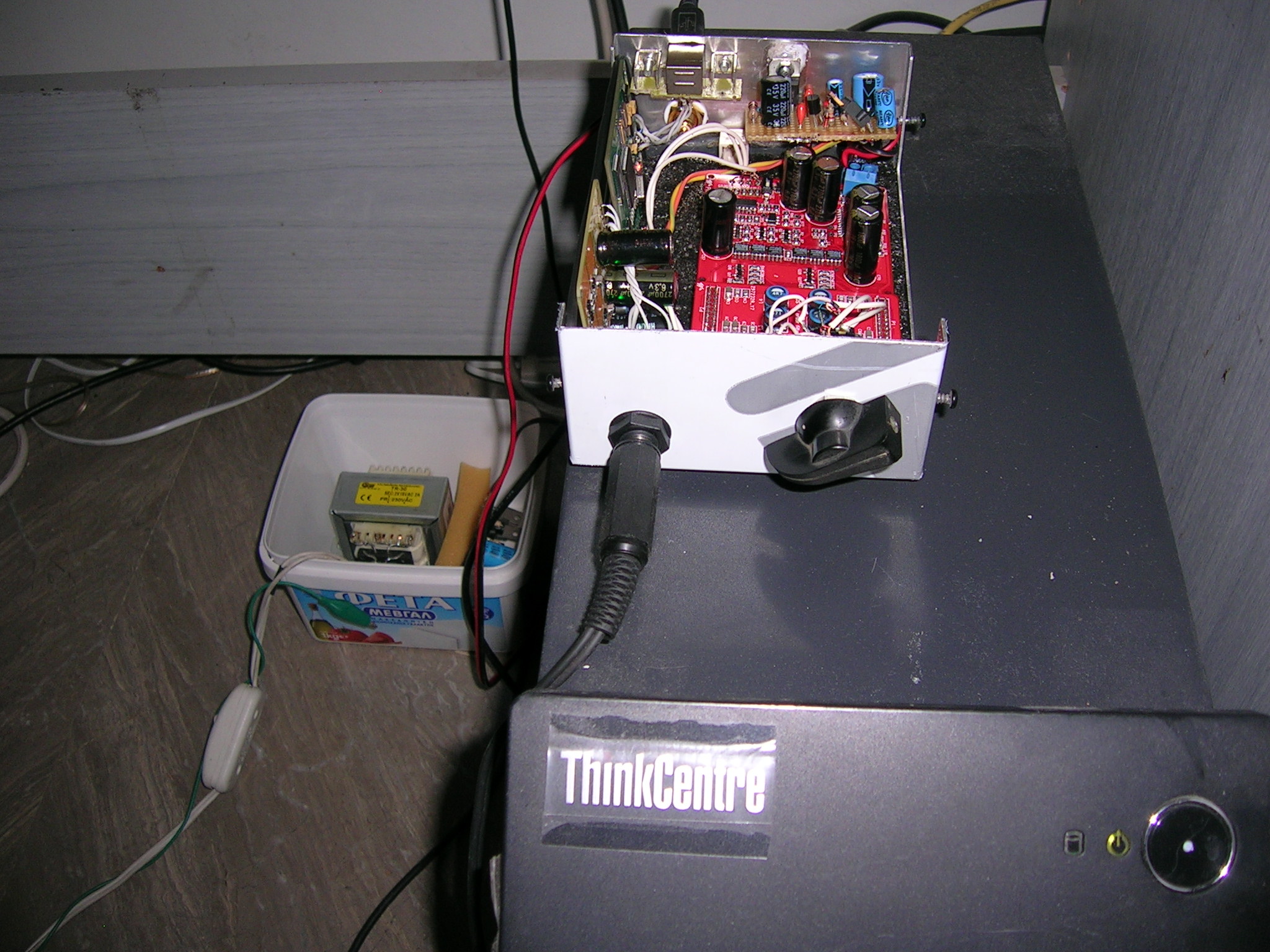

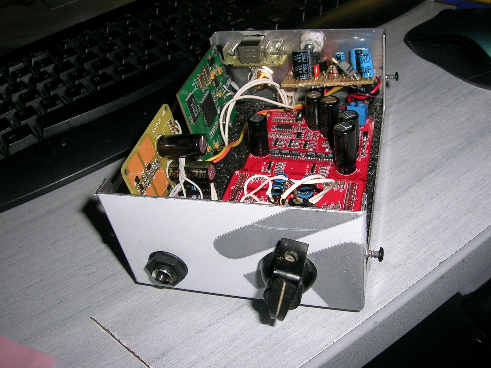

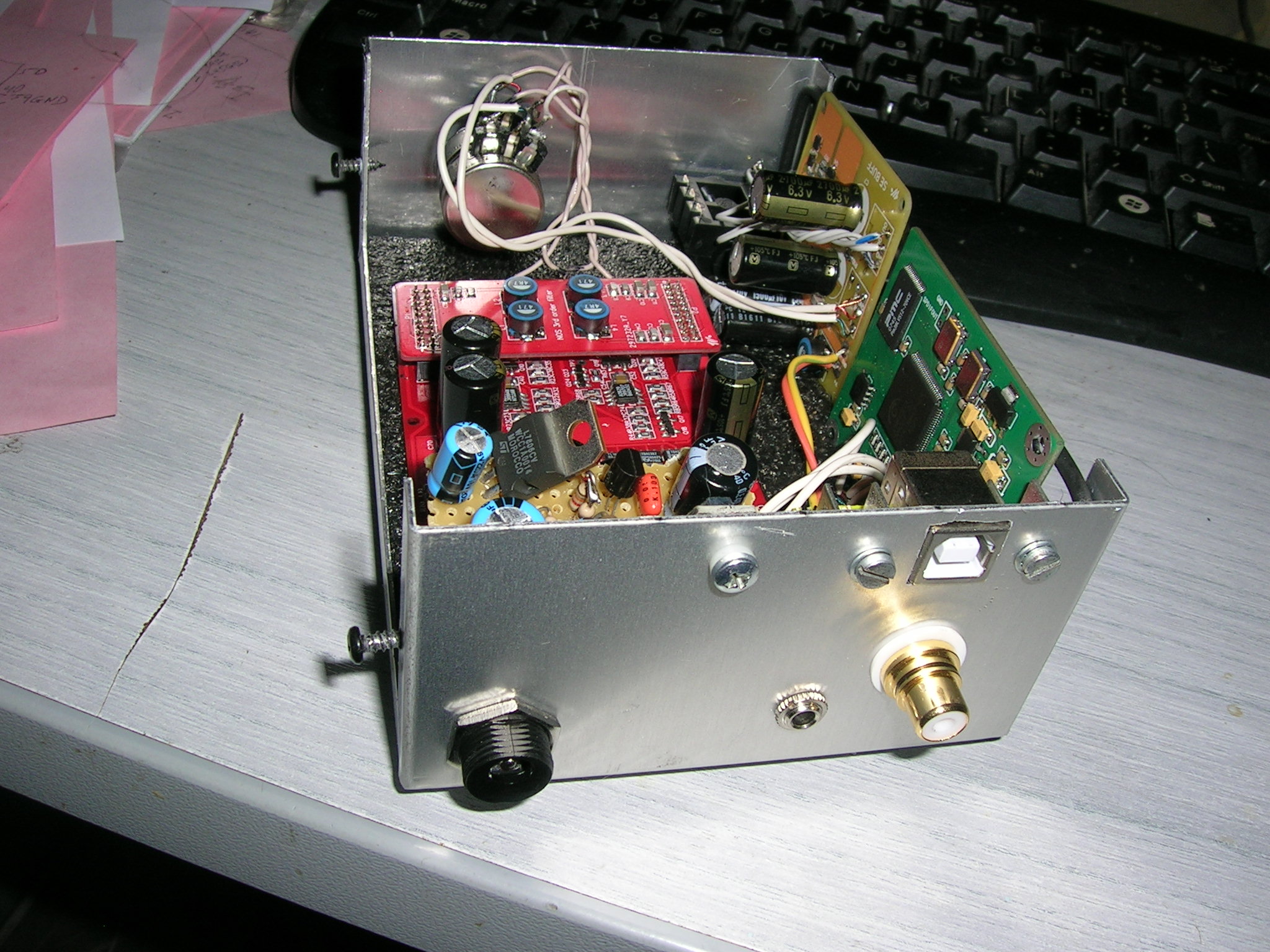

First public appearance of the test-run (industrial design disgrace of the year)
Nevertheless, they all work together harmoniously 🙂

What is the function of the switch on the board?
Hi Wong - its a digital phase switch. The DAC's normally non-inverting (true phase) but if you flip that then it becomes inverting. Note the TDA1387 chip itself is inverting, presumably because its recommended to use it with an opamp I/V stage which inverts.
