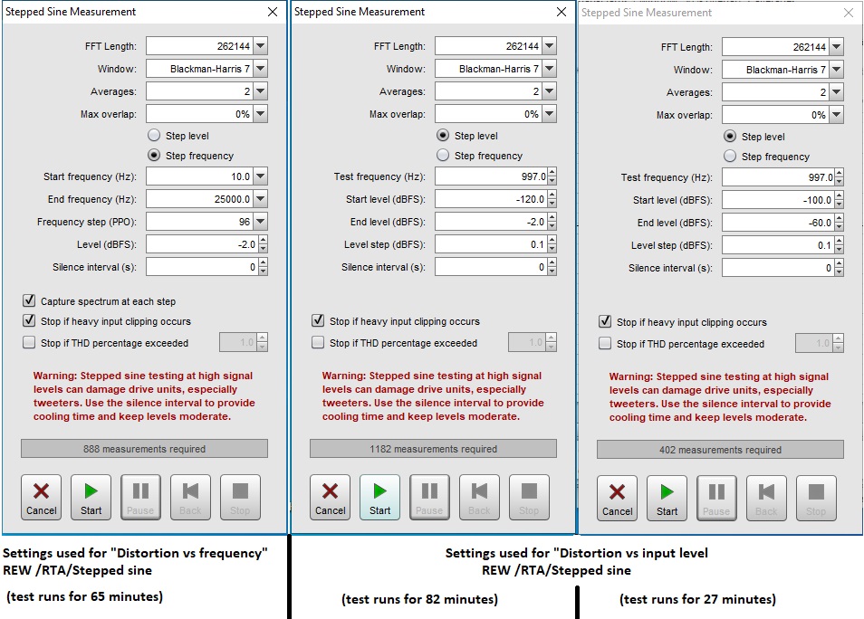

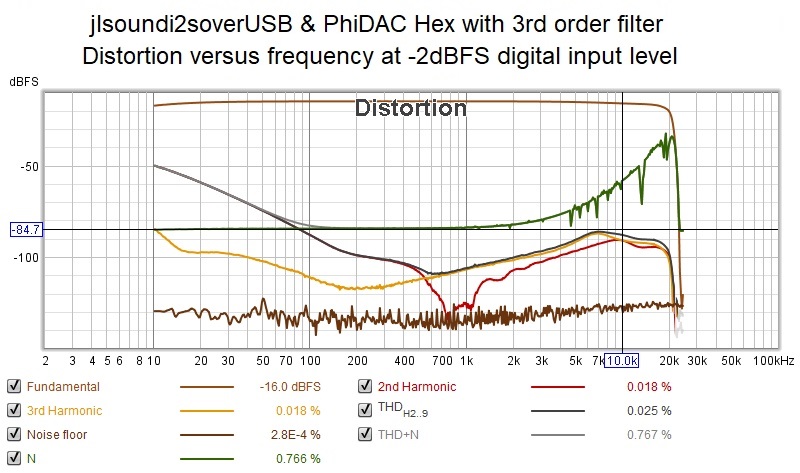

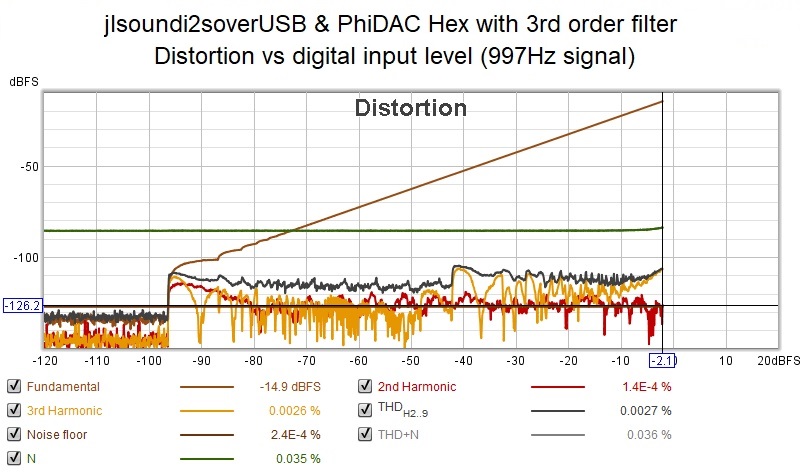

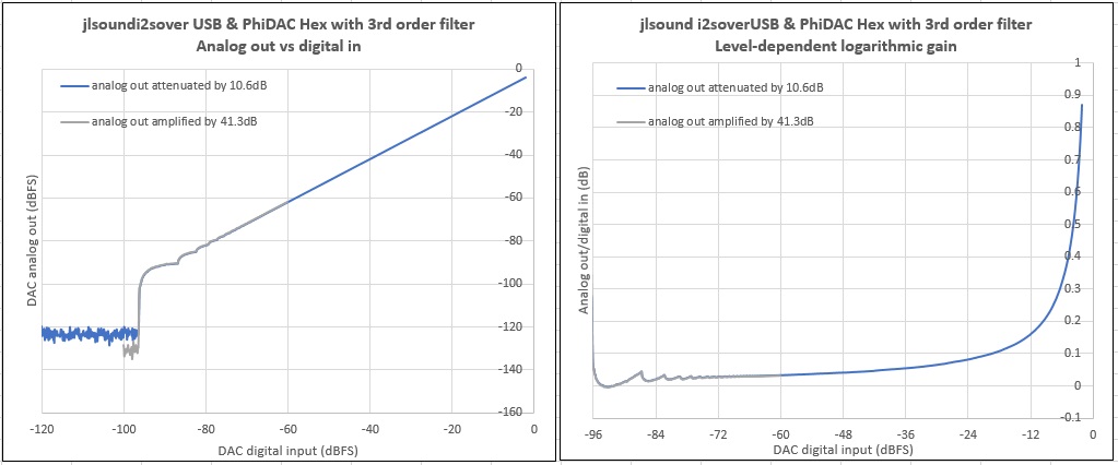

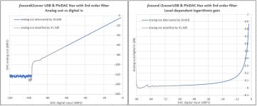

Now the same tests on the DAC with the 3rd order filter installed.
(again, spikes at 1st attachment are measurement glitches, there is no real distortion peaking)
George

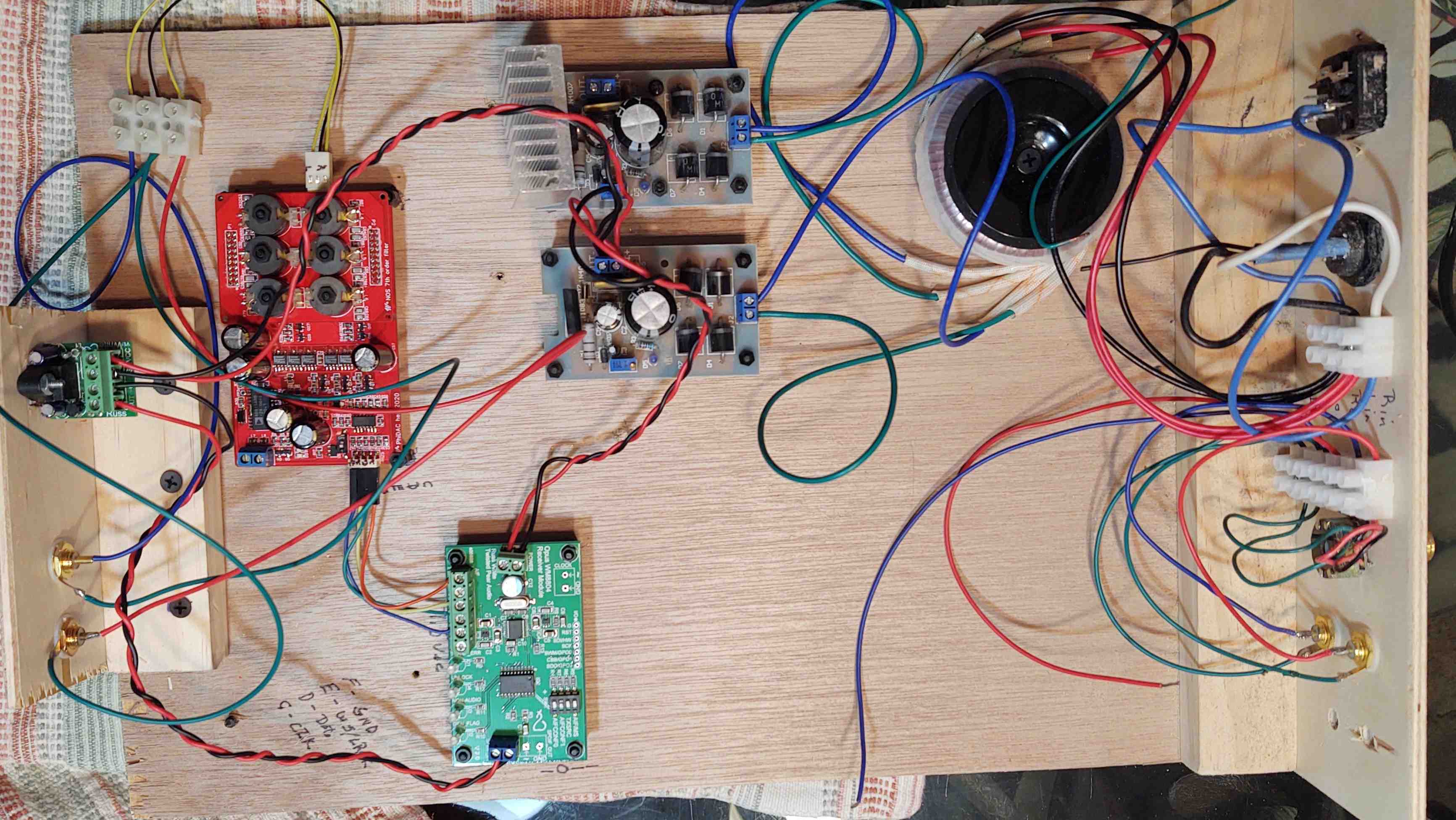

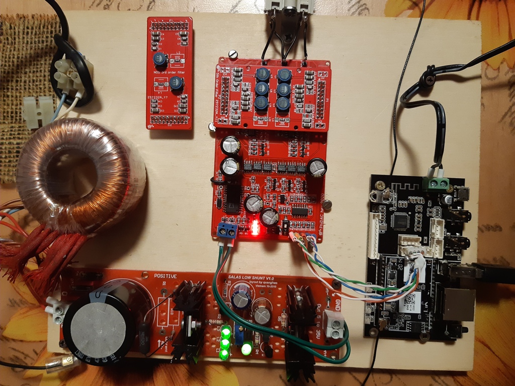

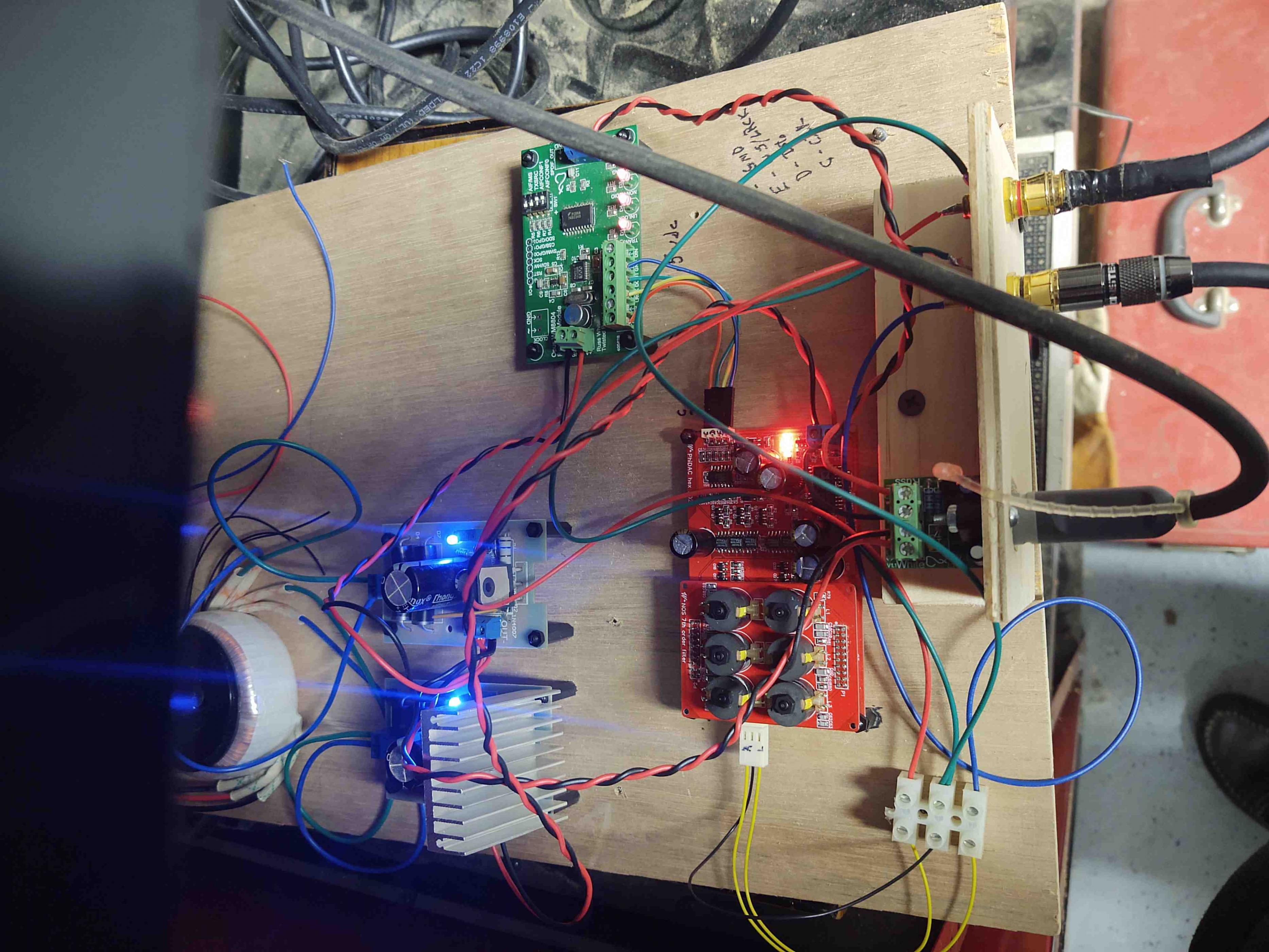

Another Phidac sings. I threw a bunch of spare parts that I had lying around on a board to test the DAC. I used an older spdif receiver from Twisted Pear to feed the dac. I needed to select a 16 bit word length by setting AIDCONF0 and AIFCONF1 to (-) on the tristate switches to get it to work with this dac. I only had to chance to listen to it briefly on my garage system but it sounds very promising. I did a very short comparison to a modified Chinese 9038Q2M DAC that I had hooked up out there (you know the one everone was modding last year). The two dacs do sound different from each other. The 9038Q2M sounds warmer/thicker, seems not quite as detailed, probably due to the higher noise floor. Musical notes on the Phidac like piano and guitar have more prolonged decay, sound more realistic, the overall impression is it has greater detail. The highs aren't rolled off like in some NOS dacs that I've tried, sounds much better than a budget NOS TDA1387 board that I had tried out. My next step is to put it into a decent case with decent power supplies and USB input to try it out in my good systems.

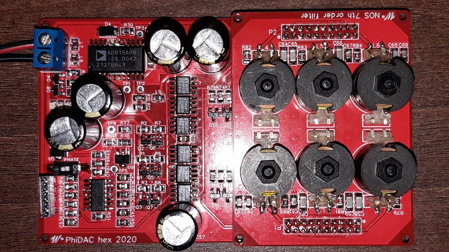

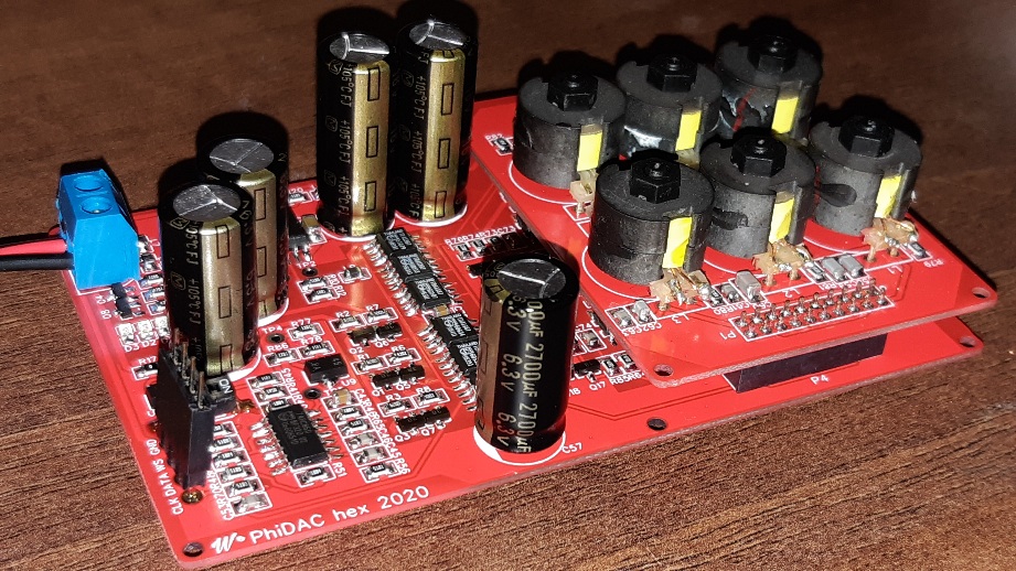

Existing customers of PhiDAC hex don't need to buy a whole new DAC in order to upgrade. Seeing as the plug-in filters are not changing, the one(s) you have already will be good for PhiDeca DAC too. So then only a new baseboard will be required if you want to move up to the next generation DAC.
