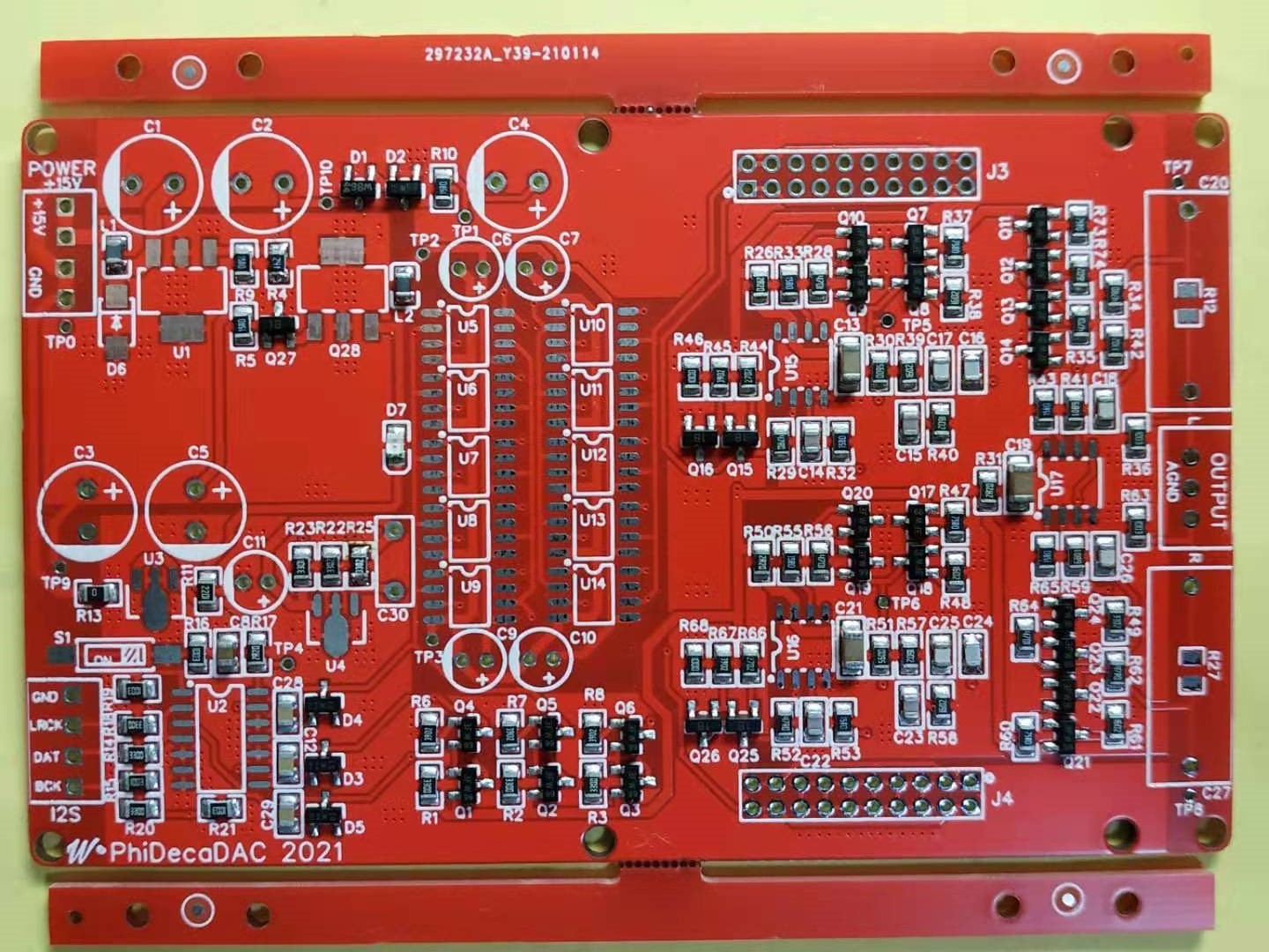

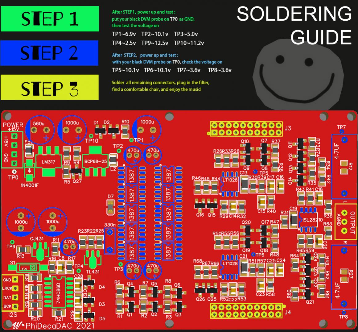

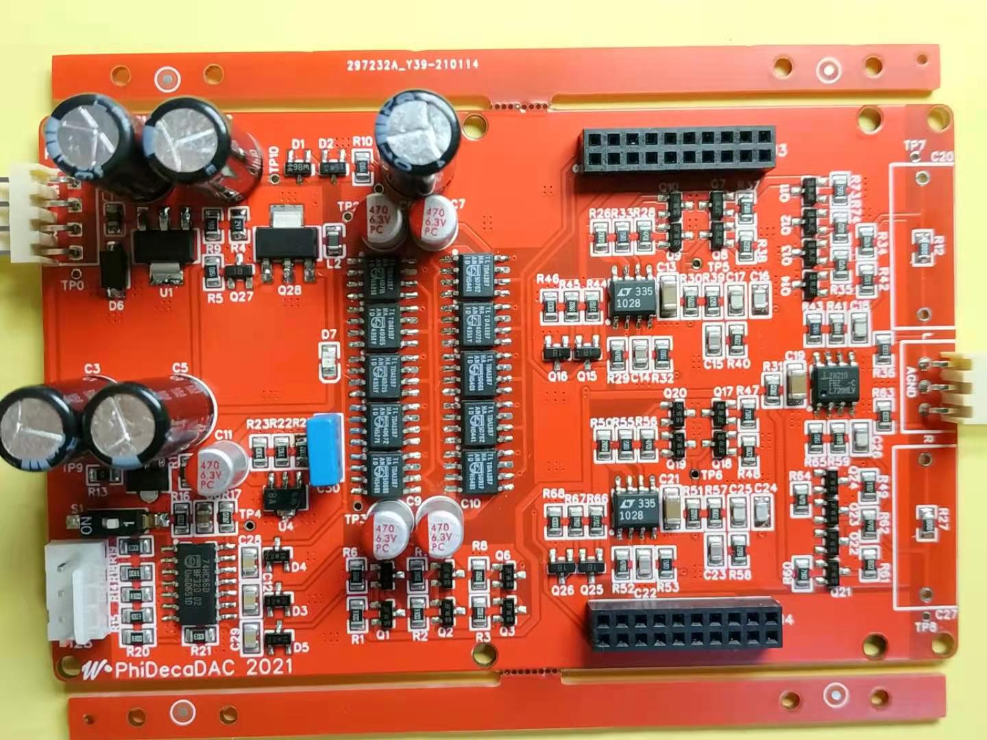

Here are a couple of shots taken with my phone to show what the finished baseboard DAC and the pre-soldered board that comes with the kit look like. By mentally subtracting one from the other you'll be able to figure out which components you have to solder. I'll have a graphic along in a day or so for kit builders to refer to.
The output caps aren't shown fitted on the finished baseboard - they are 4.7uF Wimas and these suit driving a typical input impedance preamp (22k or more input Z). There's a provision to use off-board caps if you prefer - solder the 0R 0805 resistors which short out the on-board caps. I normally use off-board caps myself as I'm driving my trafo-input TDA8932 amp boards and they need an electrolytic of 1000uF or so to keep the output impedance low enough at LF.

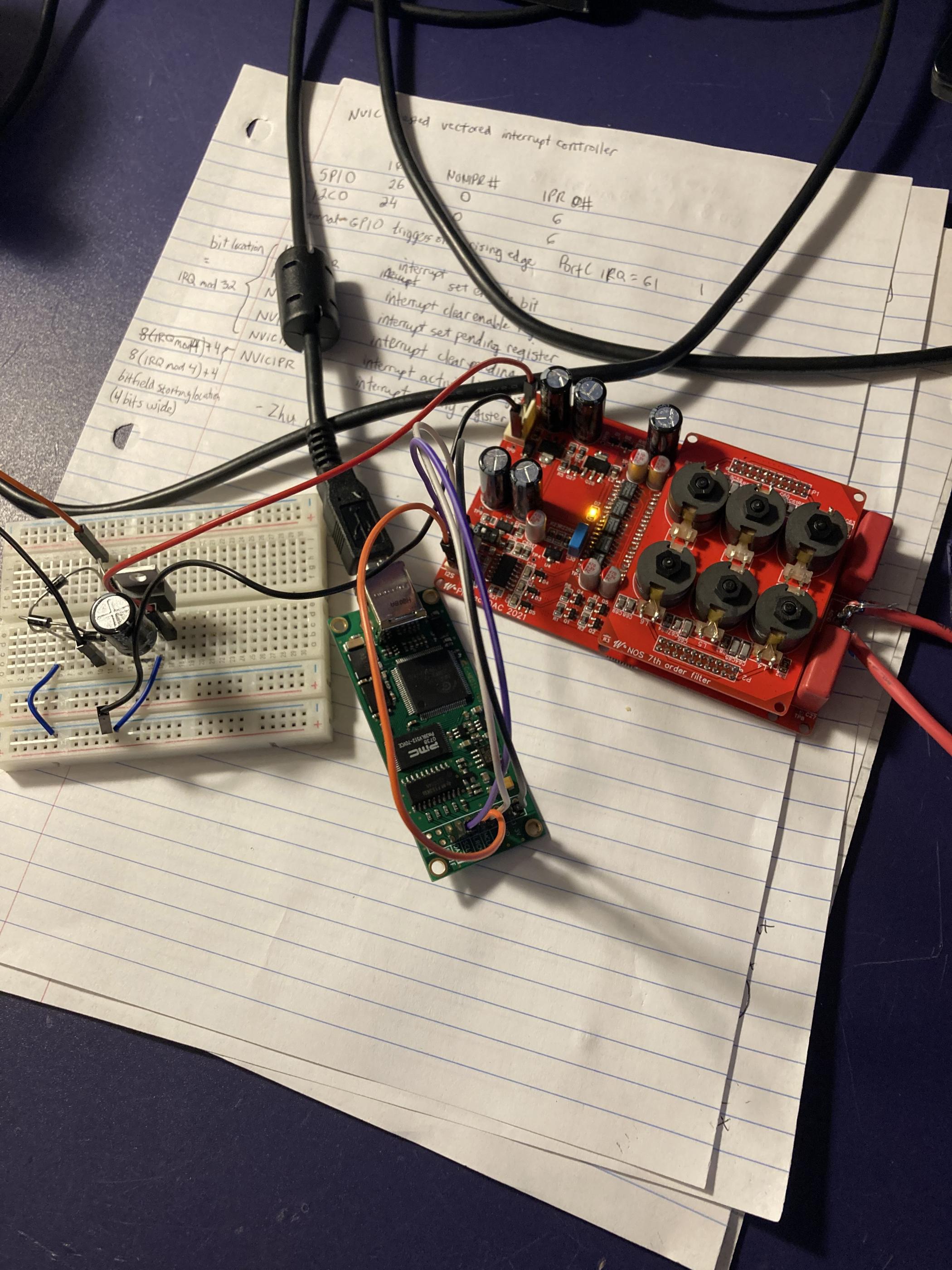

Another happy customer here! Shipping only took 3 days to Seattle which is amazing. It took me about 5 hours to solder everything up. I just followed the guide and it helped me find that I didn't get one of the ICs soldered fully.
First impressions-
It sounds awesome! The noise floor is so much lower than my old schiit modi and this pcm2704 dac I have. The bass really stands out as coming alive.
I will have to experiment with power supplies and different usb interfaces, but so far I'm very impressed with the Phi DecaDAC
