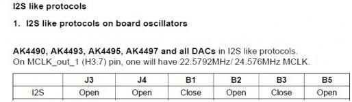

How I wired my JLsounds I2SoverUSB v.III board to my PhiHex dac
(thanks to help from member Rick https://www.diyaudio.com/forums/members/r8833.html )
From all the v.III board jumpers I bridged only B1 and B3
On v.III board there is a 20 pin header (H3)
(H3) pin 11 (BCLK_I2S) goes to CLK on PhiDAC
(H3) pin 13(DATA_I2S) goes to DATA on PhiDAC
(H3) pin 15(LR_CLK_I2S) goes to WS on PhiDAC
(H3) pins 12, 14, 16 (GND) goes to GND on PhiDAC
George
George

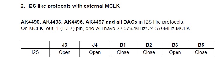

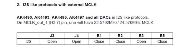

Hi Bjarne
Oh, it’s now I noticed that you are using an external oscillator while I use the on board oscillator.
I use the settings as in 1st attachment (page 4 of manual)
I am of the opinion that you would have to use the settings as in the second attachment (page 5 of manual)
Try it and see what you get (you won’t brake anything). Report back
George
George
