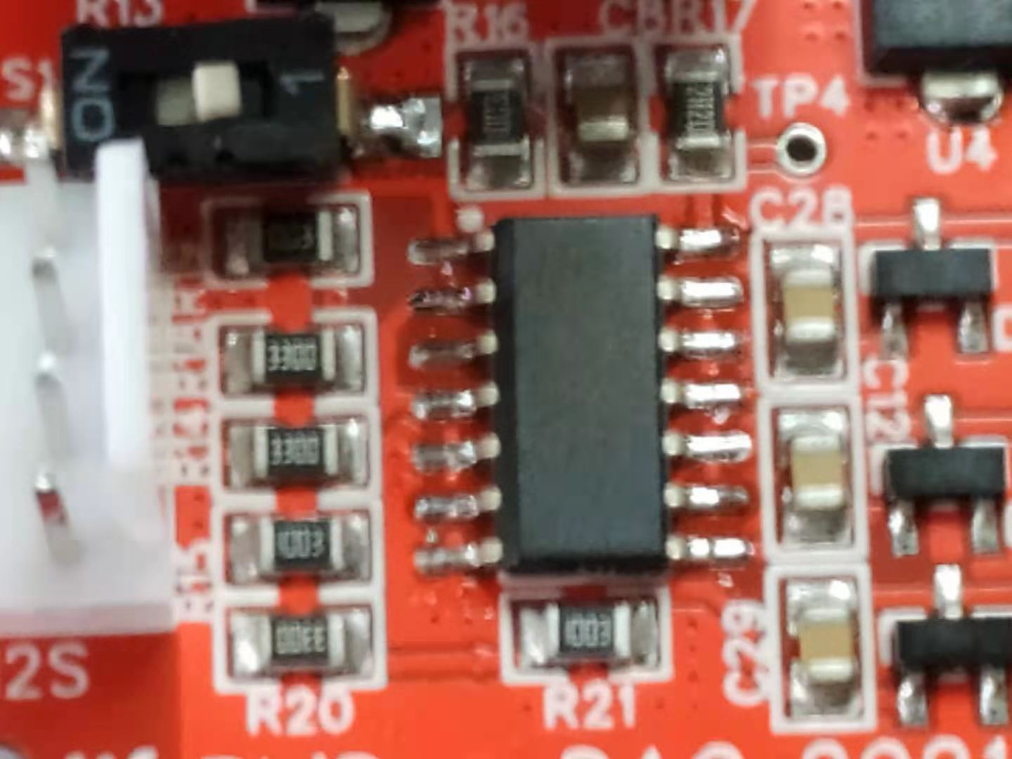

I have completed the step 1. These are my voltages:
TP1 6,97
TP2 10,43
TP3 5
TP4 0,65
TP9 14,45
TP10 11,53
Do you know what could be my mistake?
TP1 6,97
TP2 10,43
TP3 5
TP4 0,65
TP9 14,45
TP10 11,53
Looks to me there are potentially two problem areas. TP4 is much too low - could be a short or open in soldering U3 (CJ431) or could be a solder splash around U2. To dig deeper, measure the voltage across R17.
TP9 is too high by a large margin (increasing the zener currents substantially which drags up TP1, TP10) which makes me wonder whether D6 has been soldered with the correct polarity. Please check that the band marking (K) is towards L1 (ferrite bead).
I have changed the polarity of 1N4001F and now all my measurements are correct, except for TP4 which is still at 0.64v. I have soldered and desoldered the CJ431 several times and it remains the same. In fact, the measurement of the TP4 was the same without the CJ431 soldered to the board. I have checked the welds on U2. What could be the problem? Greetings and thanks.
My best guess is you have U2 soldered in upside down. Check the photo below, the bevel on the SO-14 package goes on the left, the side of the white dot on the PCB silkscreen.
As you said, it was upside down. I have changed it. Now the TP4 voltage is 2,74v. instead of 2.5v.
Is it acceptable?
I think your CJ431 (U3) may have gotten damaged from all that extra soldering iron attention it has received. I believe we sent a spare one in the kit, best replace it.
