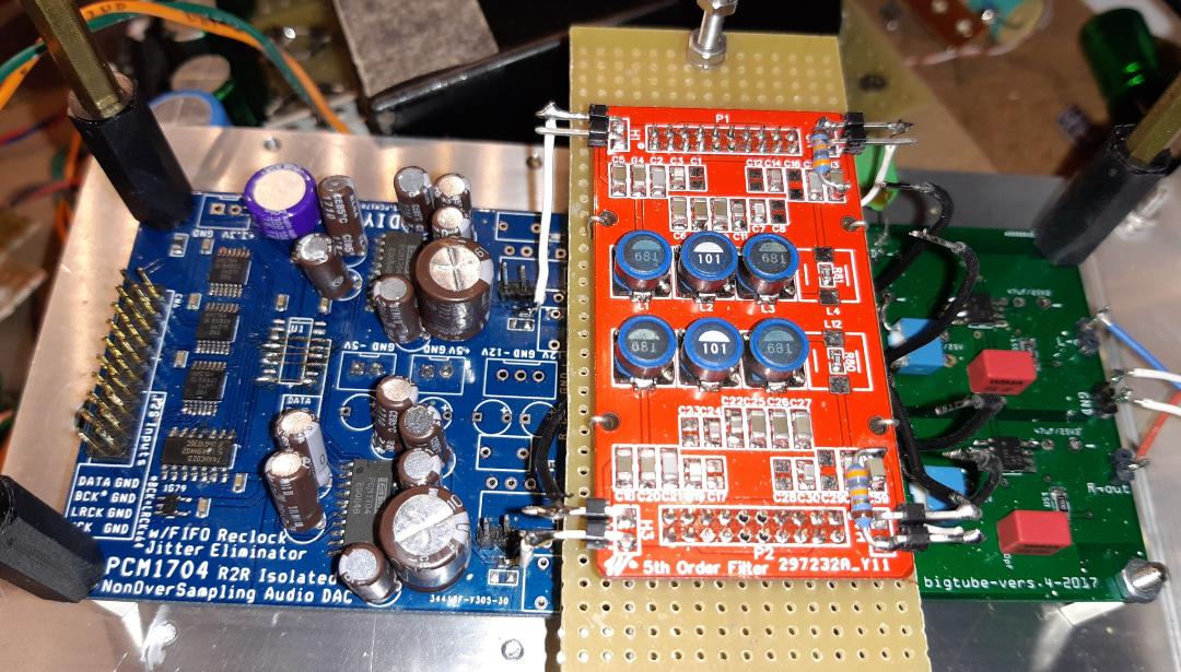

Good evening at the end I connected the 5th order filter of the PHYDAC on my dac with PCM1704 before the I / V. Before this DAC I have had both Buffalo III and Soekris but this PCM1704 is definitely superior. I didn't think I could improve it, but this happened.
Now the sound is cleaner, above all the soundstage has resized has become normal, before it was exaggerated not very real.
A big step forward, now I want to try the 7th order filter.
From our past conversations, this PCM1704 DAC was using an OPA861 for the I/V stage. No feedback in I/V right? But now it has a 5th order LC filter between DAC chip and I/V with a matching resistor so that the filter gets the right termination impedance from the OPA861.
