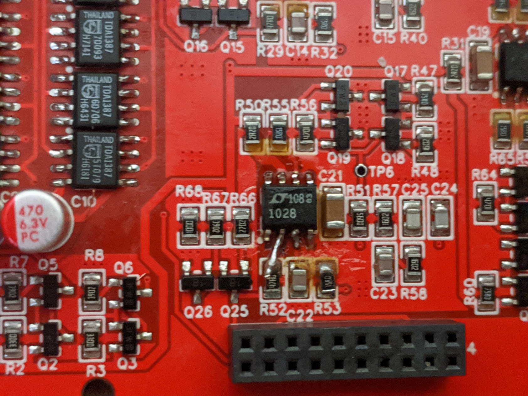

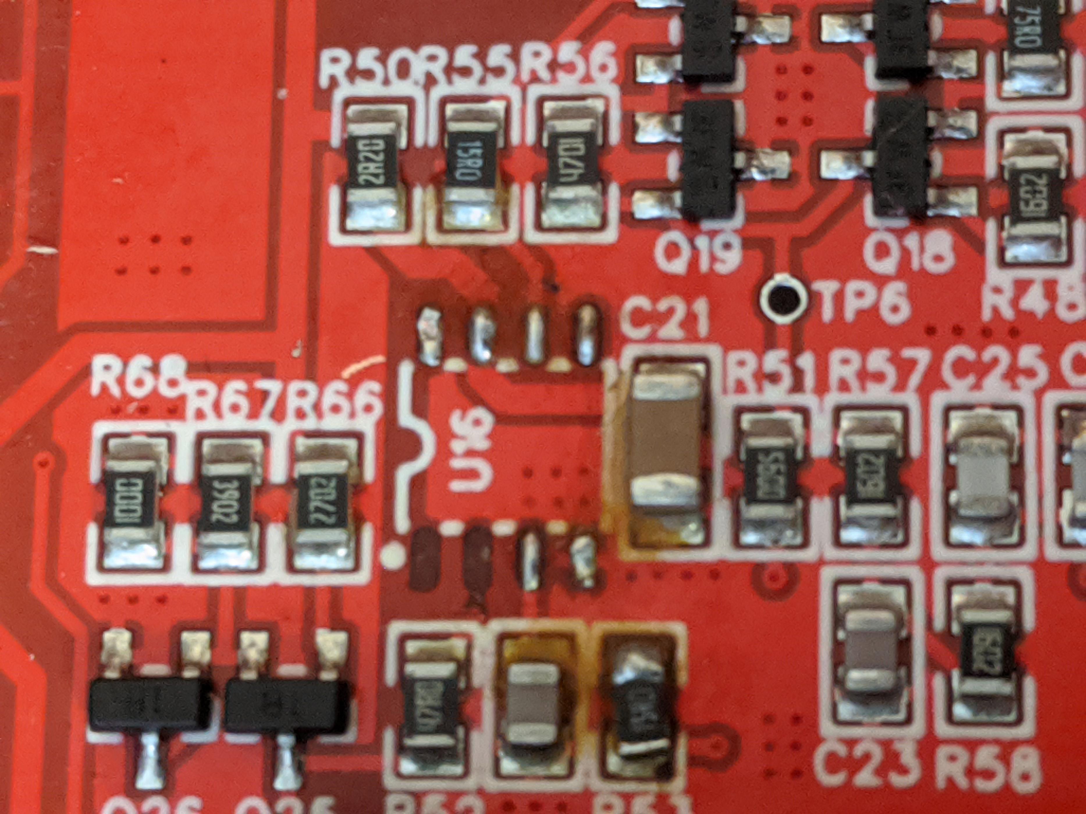

Per our conversation, attached is the image of the PCB. During removal of the faulty LT1028, the solder pads on pins 1 and 2 came off the PCB. Please let me know how to proceed. Thanks!

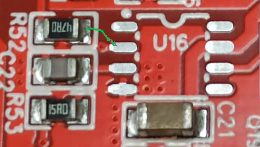

I've added a green 'wire' to show the connection that's missing between pin2 U16 and R52 (47R) and needs adding with a short piece of wire. Pin1 has no connection anyway so the lack of pad isn't a problem.

I followed your instructions (see the attached image) and retested the voltages. I also verified the new connection by measuring about 47 ohms (as expected) from pin 2 of the LT1028 to the opposite terminal of the resistor. With reference to TP0:

A couple of voltages to check - pin3 of U16 (relative to TP0) to see that the R53 resistor you removed did get its connection made properly again. Also check that the via joining R52 with R51 didn't get damaged. That track on the other side goes between R52 top (based on your most recent pic) and R51 bottom. Check that connection with an ohmmeter.

Pin 3 of U16: 185.4mV (Relative to TP0)
Top of R52 to bottom of R51: 0.00 ohms
Pin 3 of U16 should be at 6.8V so your measurement indicates R53 may be damaged (or a PCB track to it is damaged). Replace R53 with one of the new ones from Mouser.
At long last, she sings!!! Replaced the resistor, rechecked voltages, and all were well within tolerance.
First impressions, soundstage and imaging are much better than my old Cambridge Dacmagic Plus. Haven't done enough listening yet to say more.
Richard, my hat goes off to you. Thanks for all your help, I'll keep a close eye out for your future projects!

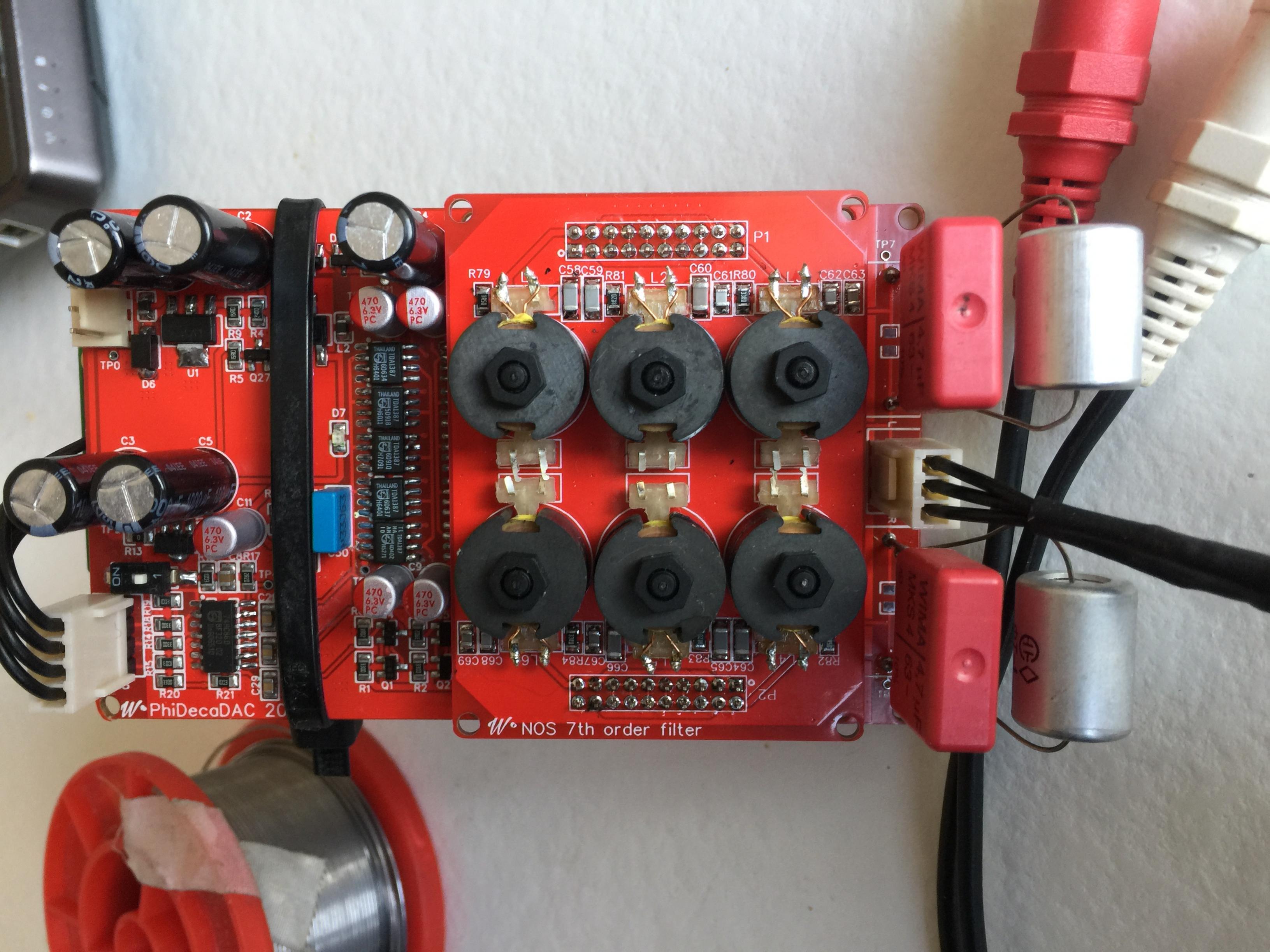

Firstly many thanks to Richard for making this Dac available for us simple soals/survivers!
In short time, Richard managed to get the dac parts to my adress in the Netherlands. Very well packed accompanied with several spares for critical parts With the help of the very clear soldering guide it was a rather easy job putting the parts on their spots. Just by using a fine tipped iron. Despite my being about eighty years old and having had only my first Covid vaccination! Hahaha!
Testround one and two showed all correct voltages and after putting everything together, the result was music in the first try!

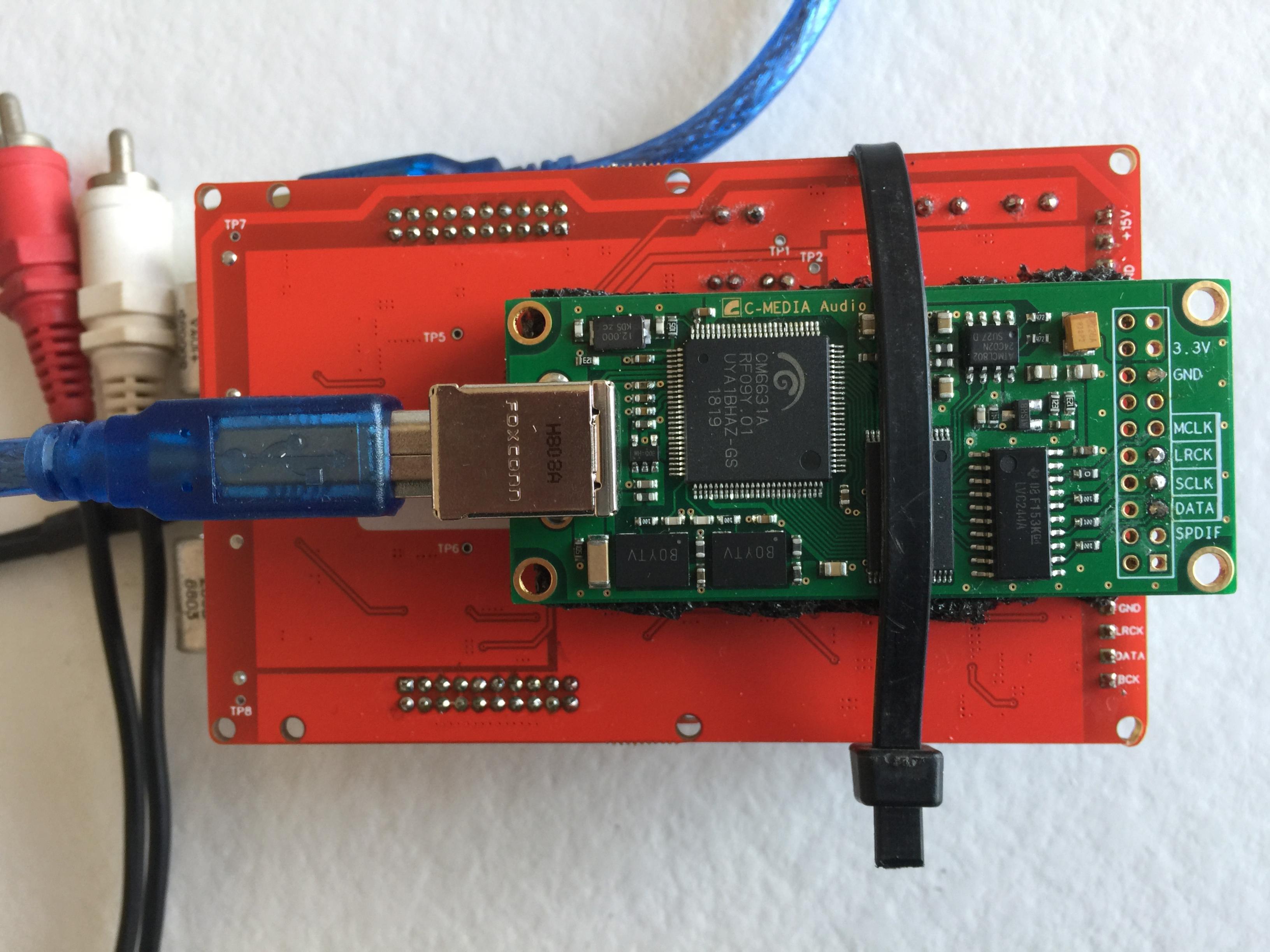

Although this first setup is very basic : simple 500mA 15V wallwart, very simple C-Media audio Usb to I2S (12Us dollars!), standard delivered Wima 4,7uF MKF as output capacitor the Dac has a neutral caracter, very nice balanced.
I will let it go for a few weeks expecting some change in sound caracter.
Maybe than, I will try some other capacitors, or combinations of capacitors.
Another PSU, another Usb to I2s converter, maybe with nice clocks asf.
When I would do nothing at all, I must say the way it sounds now allready in this setup, is very satisfying!
