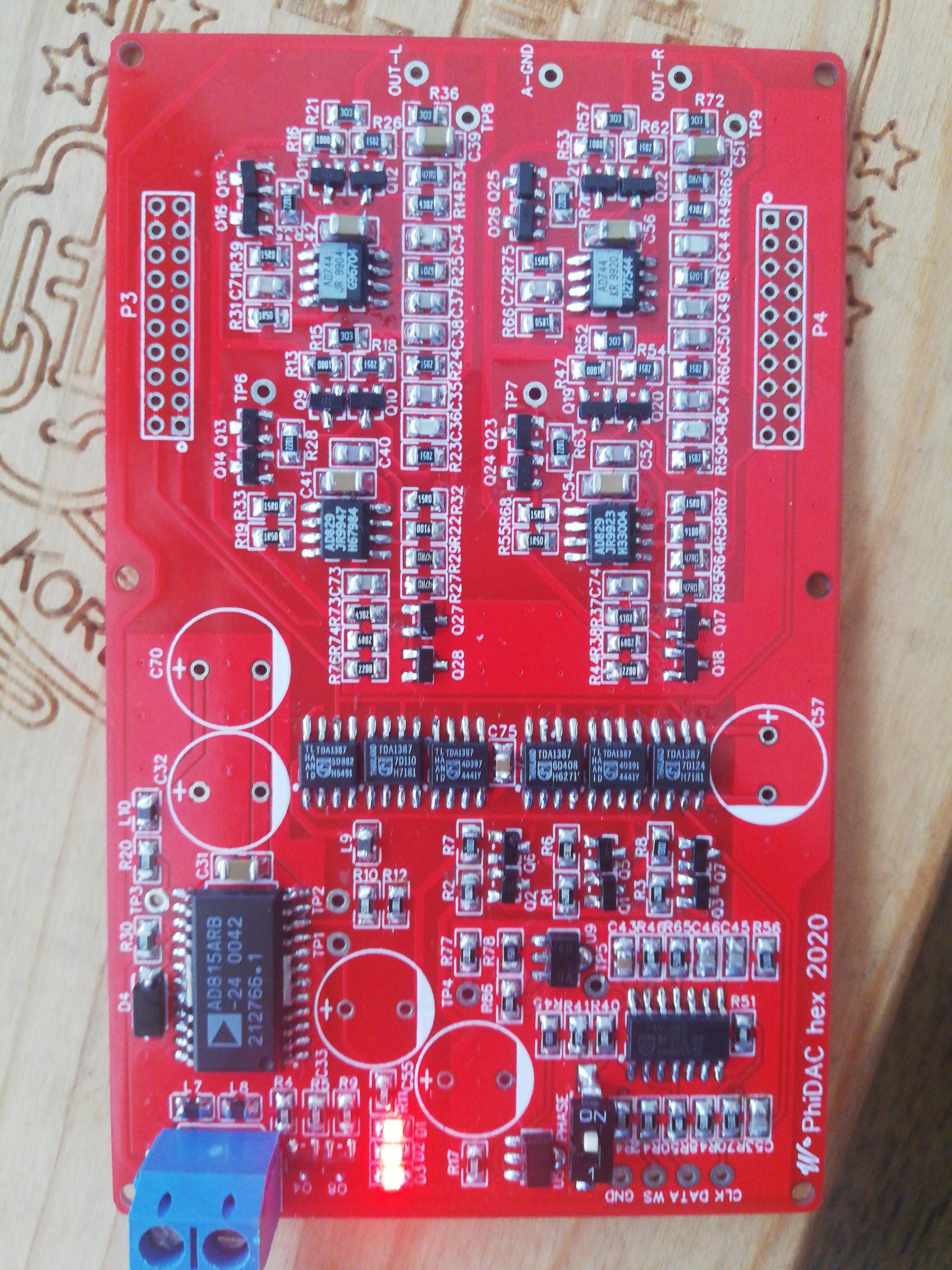

TP7 is the point of interest now, along with TP1. I see a splash of solder between R55 and R68 which is a concern.

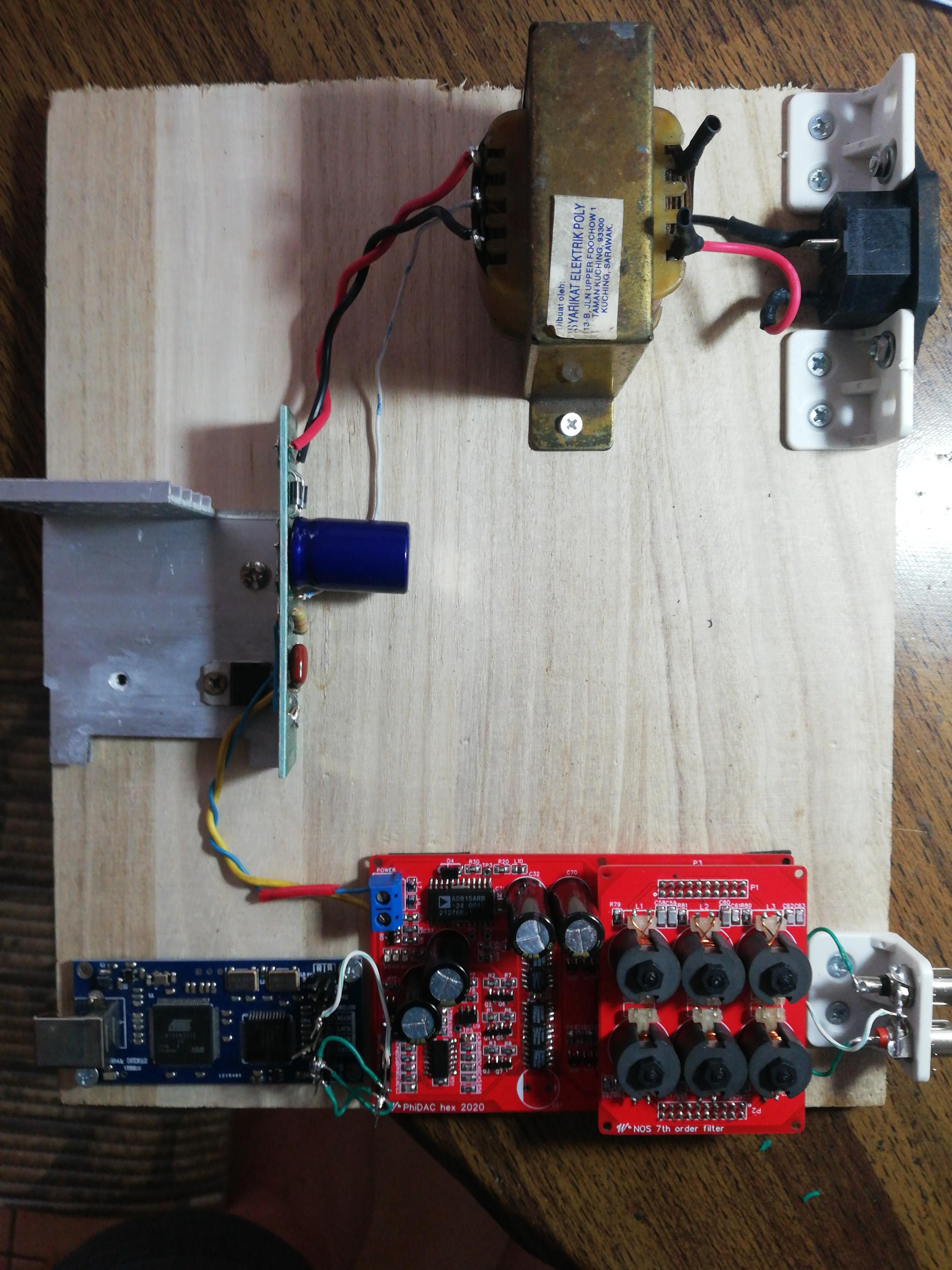

Watchout fro leakage between mains trafo and filter inductors. Why not put the traf and stab into an own box and get it away a few meters from the DAC.
A few meters distance isn't necessary - I regularly have an EI transformer around 50cm from my DACs without any noticeable hum.
Got music! No hum.
I gives me great satisfaction as this project involves the most amount of smd soldering in my diy hobby.
