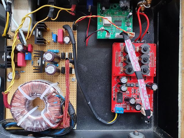

Finally up and running! Thank you @abraxalito for all help you provide to me.
New power supply and PhiDAC in old DIY 1543 DAC case I had.
First impressions are great, I think PhiDAC is dac you can listen all day and have a smile on your face.

You optimised on short output cables... maybe it would have been better to turn the boards so that the digital interconnect was shorter and still just a bit longer output cables - which should probably be twisted.

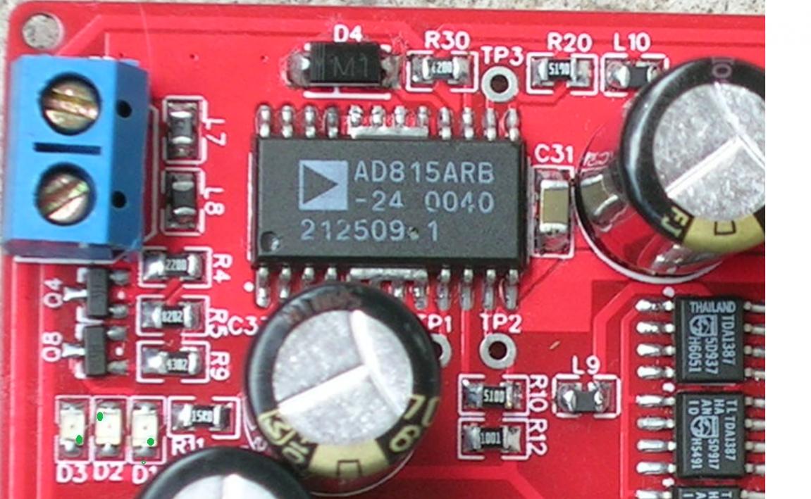

Apply 12V from a supply limited to ~150mA short circuit current to the power input pins at top left. If all is fine the three red LEDs will illuminate and you can check TP1 (5.5V), TP2 (8.3V) , TP3 (10V), TP4 (4.6V) and TP5 (2.5V). These voltages are all measured relative to the 0V power input terminal. Also measure across R56,R65 & R70 (these are level shifting resistors) - the reading across each should be ~4.6V.
Assuming all those are correct within ~0.1V you can progress to 'step 2'.

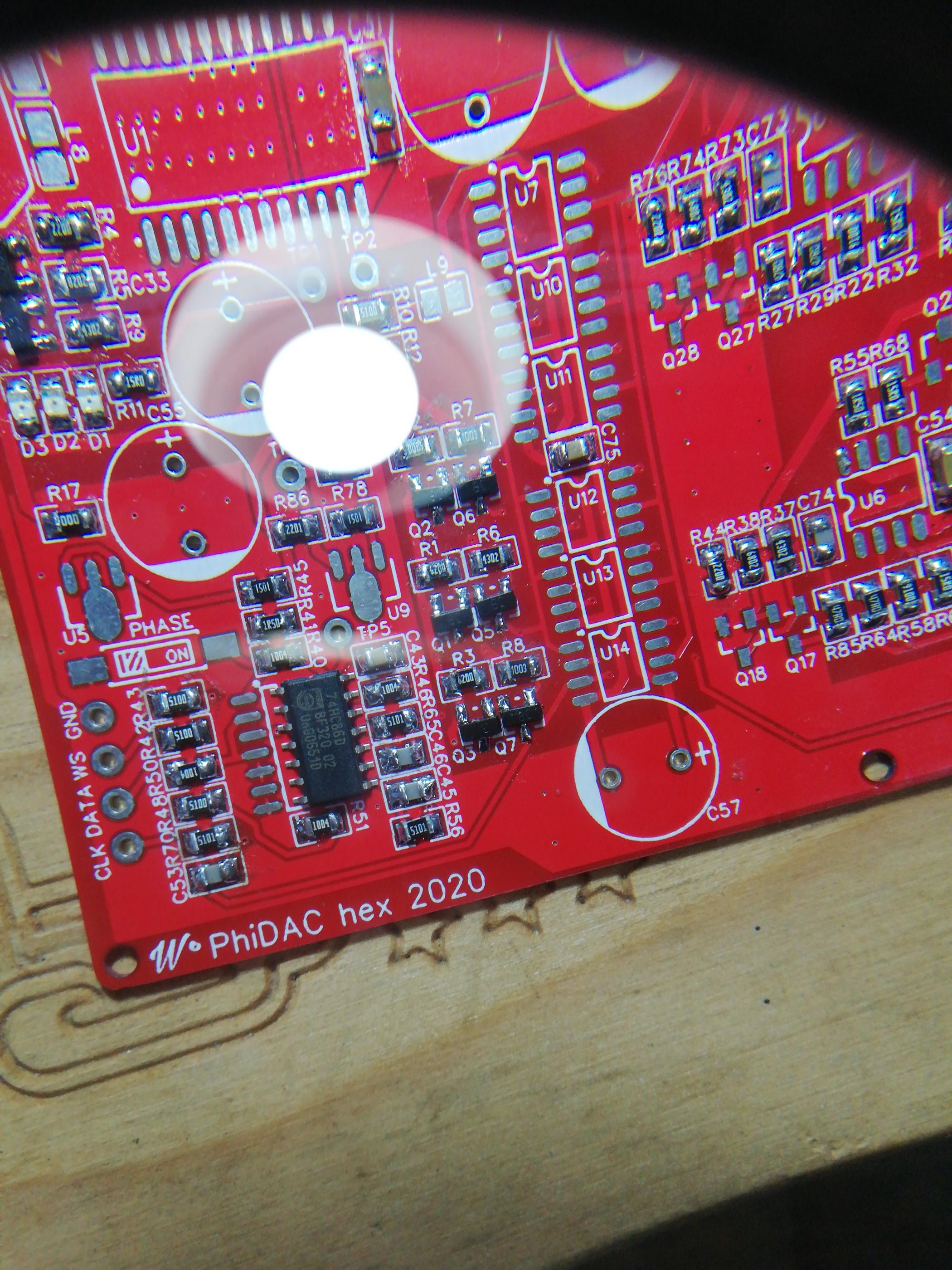

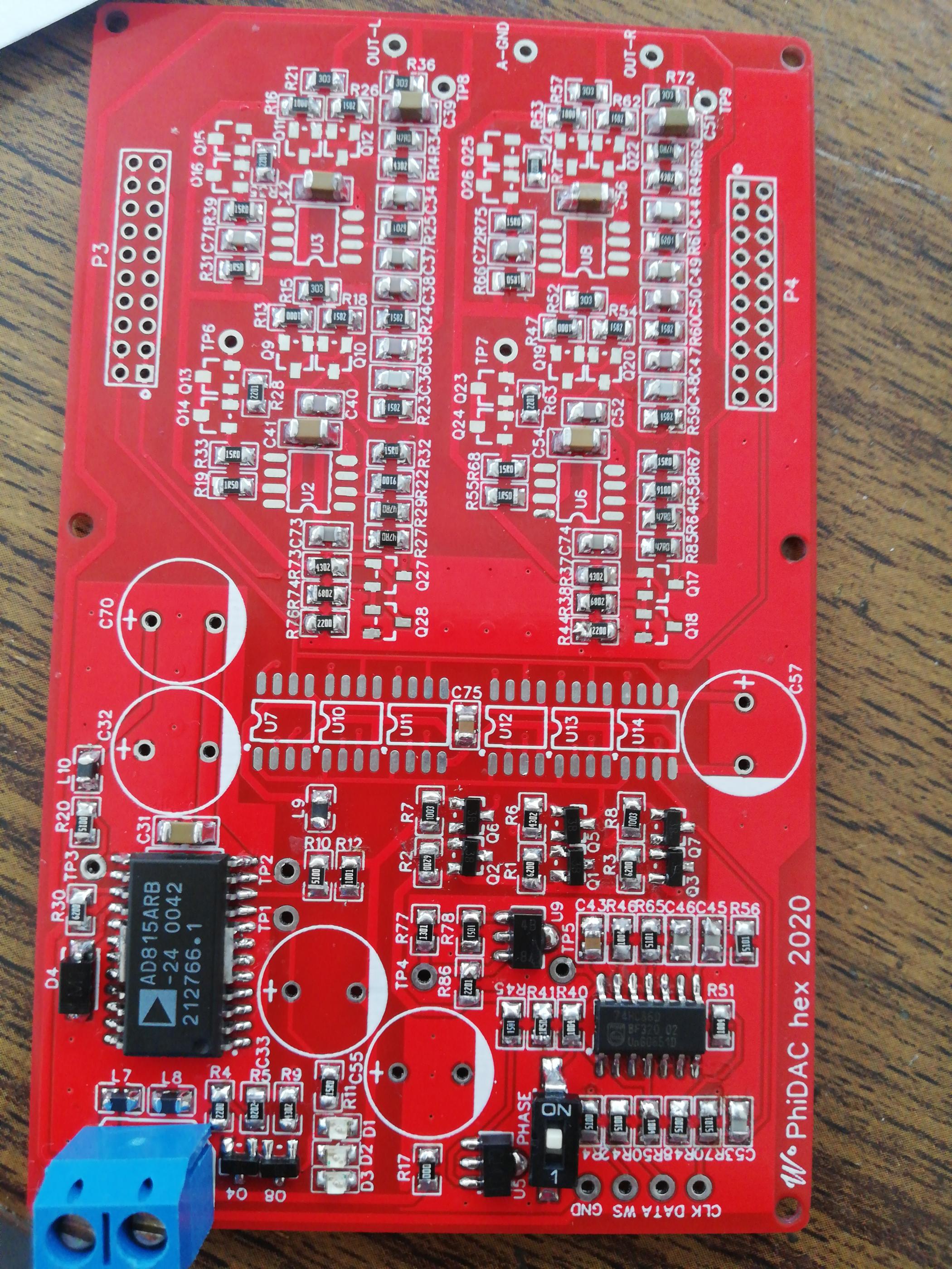

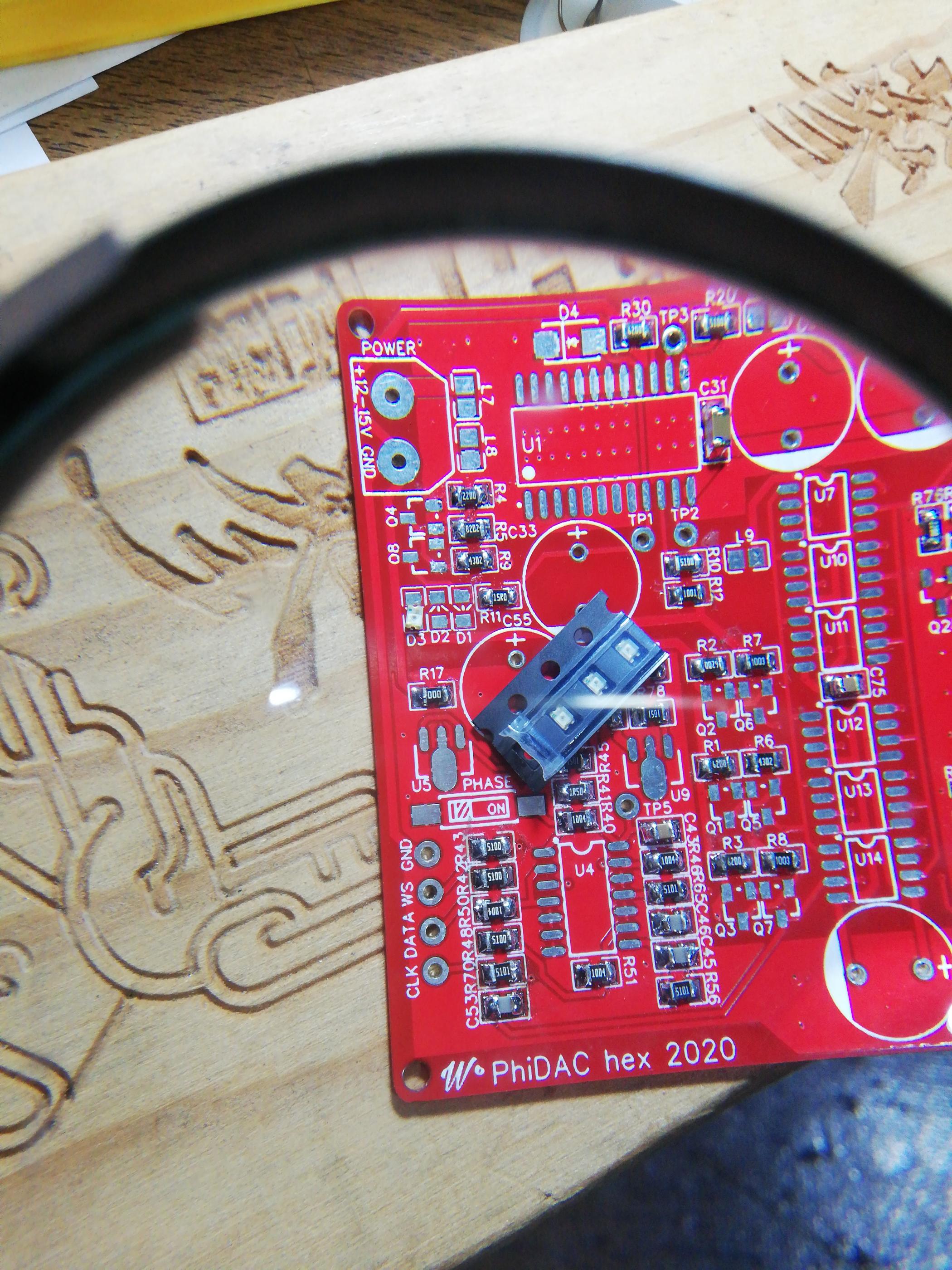

I have populated up to here. Plan to put a 12 v input to check the test points on board. In the current state of my partially populated board, will the measurements of voltage at TP 1 to TP4 valid?
Although you've populated all the passives on the right side of the board I believe all the TP voltages (including TP5) will be unaffected by that.
All voltages at TP 1 to 5 measure within 0.1 to 0.15v.
Proceed to stage 2.

At 'step 2' solder the DAC chips (after powering down, of course!). To be extra-cautious you can replace L9 (a ferrite bead, FB) with a 1R resistor. This will allow you to check the DAC supply current - as they're recycled parts there's the very slim chance you may get one which draws too much current. On powering up again double check the voltage across the three level shift resistors again (4.6V) and also across C57. The latter should be ~3.6V. The supply current should be about 22mA, corresponding to 22mV measured across the 1R test resistor.
Unquote.
What are the 3 level shift resistors? Is it refer to voltage at TP4?
Proceed to stage 2.
Quote
Unquote.
Level shift resistors are R56,R65 and R70 on the schematic. They raise the levels at the output of the HC86 to be compatible with the DACs' logic levels. Since the DACs sit atop the TL431 (U9) their logic '0' is 4.6V and logic '1' is above 6.6V.
Incidentally the 22mA figure was estimated from the datasheet rather than measured in-circuit. Turns out in the circuit the current drawn is less when the outputs aren't connected (as here - the filter's not yet installed) so ~17mA is more like the current to expect.
