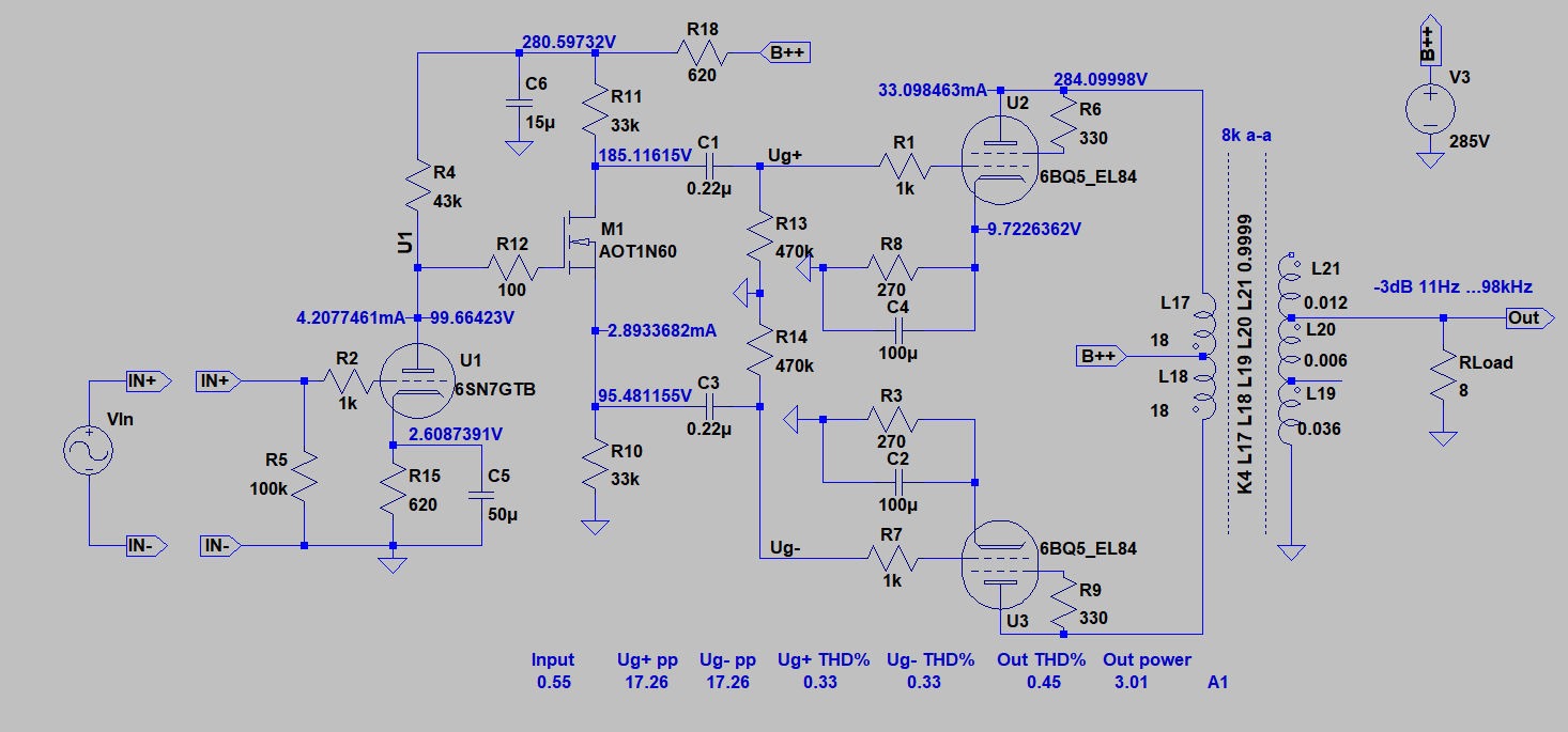

Phase splitter choices on input of PP amp
How do you calculate the design?
For maximum headroom you want the gate of the MOSFET to be about one quarter of the supply voltage. The MOSFET PI can then swing almost half the HT at each output.
However, you're only driving EL84s which need what, ~30Vpp from each PI output? So you need only a bit more than 30V across the MOSFET at idle as a bare minimum, say 40V as a round number. So your gate voltage can be as high as:
(HT-40V)/2
Reactions: 1 user
Do you have an idea why is the DN2540 is so bad? Capacitances?
Crss for the DN2540 is 5pF max, so Miller capacitance will be <10pF, but Cgs adds another few picofarads. Let's say 30pF total input capacitance on a really bad day, which is not much capacitance! R16 is what is clobbering your bandwidth, rather than the MOSFET. But all you need to do is add a compensation capacitor across R16 and you can completely cancel it out and make the bandwith plenty wide. You'll probably have to adjust the cap on test though.
Mostly.
Dynamic gate capacitance is about 200-300pF at low/er/ DS voltage.
It has low transconductance, which "helps" compensate Ciss.... if it's enough large... but not in case of this FET.
See Ale's blog:
https://www.bartola.co.uk/valves/2016/01/09/slew-rate-part-iv-and-source-followers/
This device has -enough- good behaviour, if you use as /cascode/ CCS, but not as VAS. This is my experience.

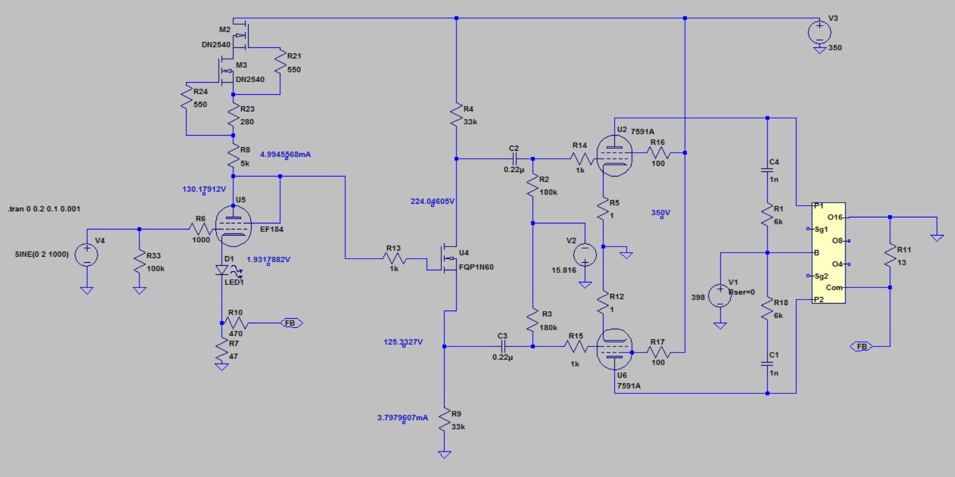

That looked familiar then I realised it's my design :) . The 350V supply was regulated (I used a Maida regulator), R23 was a trimpot adjusted to get the desired anode voltage on the EF184 which also sets the phase splitter operating point. I used it for several years but currently stripped down waiting for a rebuild into something else.

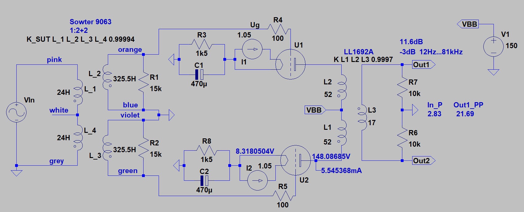

If 2V RMS input is important, the 1:2+2 SUT + PP line transformer loaded #26 tubes is satisfactory solution.
Sample:

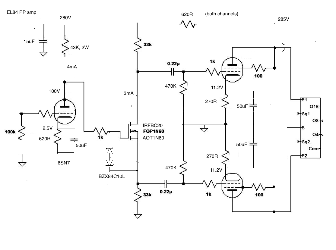

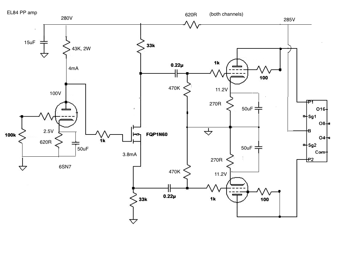

I've had a change of plan. The amp in question is a Leak Stereo 20 so I'm going back to a generic PP EL84 amp with an input stage (not 26) for which there are loads of schematics. I would use it in triode output or maybe UL. Start without global feedback. I like the idea of a mosfet splitter so there's no h-k voltage issues and I can use a straightforward double triode on the input. So I'm thinking a 6SN7 DC coupled to a mosfet splitter. I'll go back through this thread to see if there's a design here I can copy. But it would help me if you guys could post a design with a 6SN7. B+ would be about 280V.
The Leak Stereo 20 chassis imposes restrictions, but for a later PP build on a new chassis I would indeed use a 26 front end and either a PPP output stage or a larger valve in PP. So everything in the thread is relevant.
Thanks @tikiroo. I`m gonna test that schematic.:)
