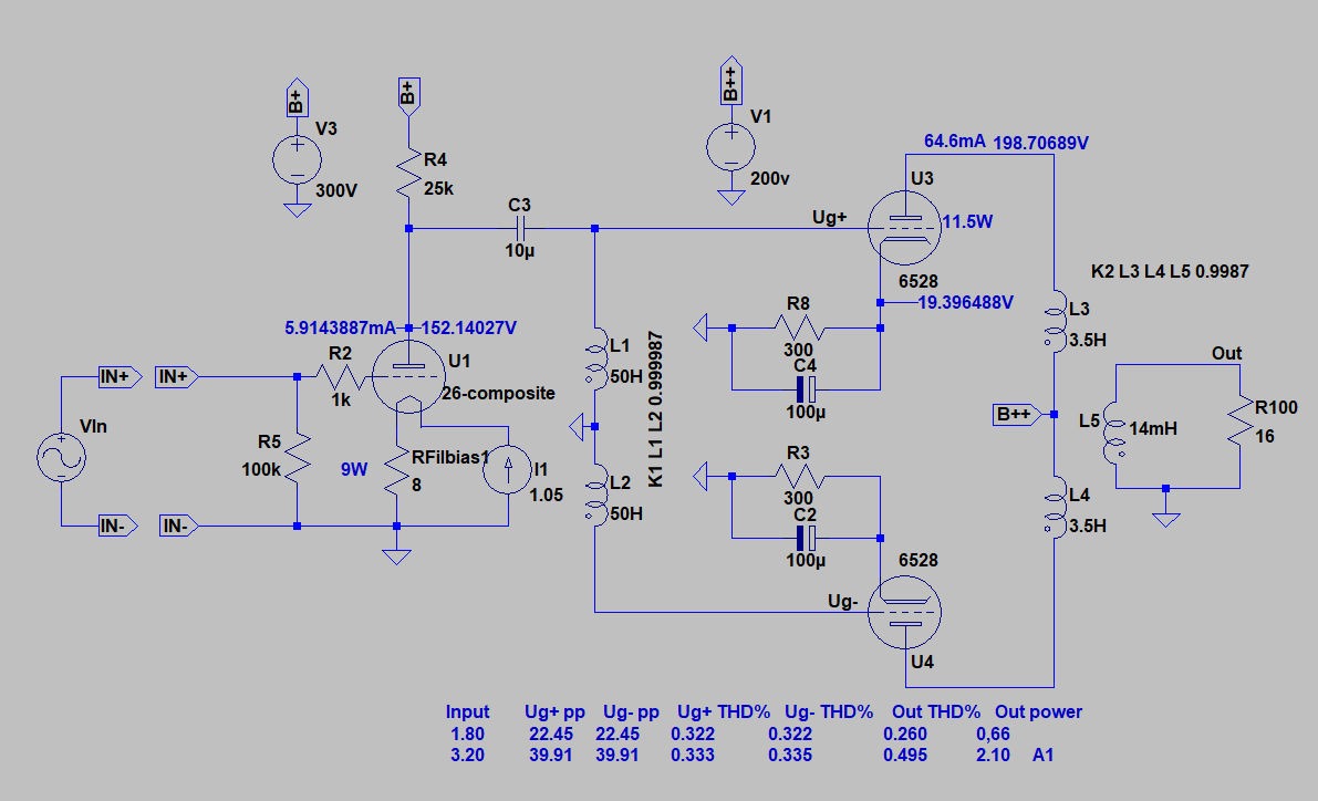

I'm now using the 37 and optimising it. Better resisters in anode and cathode. The sound is becoming very good - getting closer to my 26 stage.
I've been reading posts on the 37/76/27 and there are complaints about soft bass frequencies. This is the only obvious flaw I have. I experienced the same kind of thing with the 26 and the bass tightened up when I used a larger value anode resistor. I ended up with around 5x the anode resistance, i.e. 39K. The anode resistance of the 37 at an anode voltage of around 100V is about 11K, so that points to an anode resistor around 55K or as close as possible. That brings the current to around 3.3mA. We'll see if this tightens up the bass. Otherwise I'm very pleased with this.

I'd never use an adapter, personally. I leave that to others though they clearly are useful. The 6J5 is a good tube of course, but the gain is too high. The 6P5GT is much more viable at a gain of 14, but they are scarce. The 6V6 works but to my ears doesn't sound as good as the true triodes, despite its popularity in triode. 6G6 remains to be seen - that's a gain of 9 like the 37. I'm liking the 37 as the input to my EL12 SE amp, so it's the favourite so far, plus there's the 76 as an alternative. I now have a few of each. If the 6G6 doesn't knock the 37 off its perch I'm going with UX5 sockets. 37 and 76 aren't common but they're still obtainable and at realistic prices.
Is the 37s output impedance at 11K alright for the mosfet splitter?
