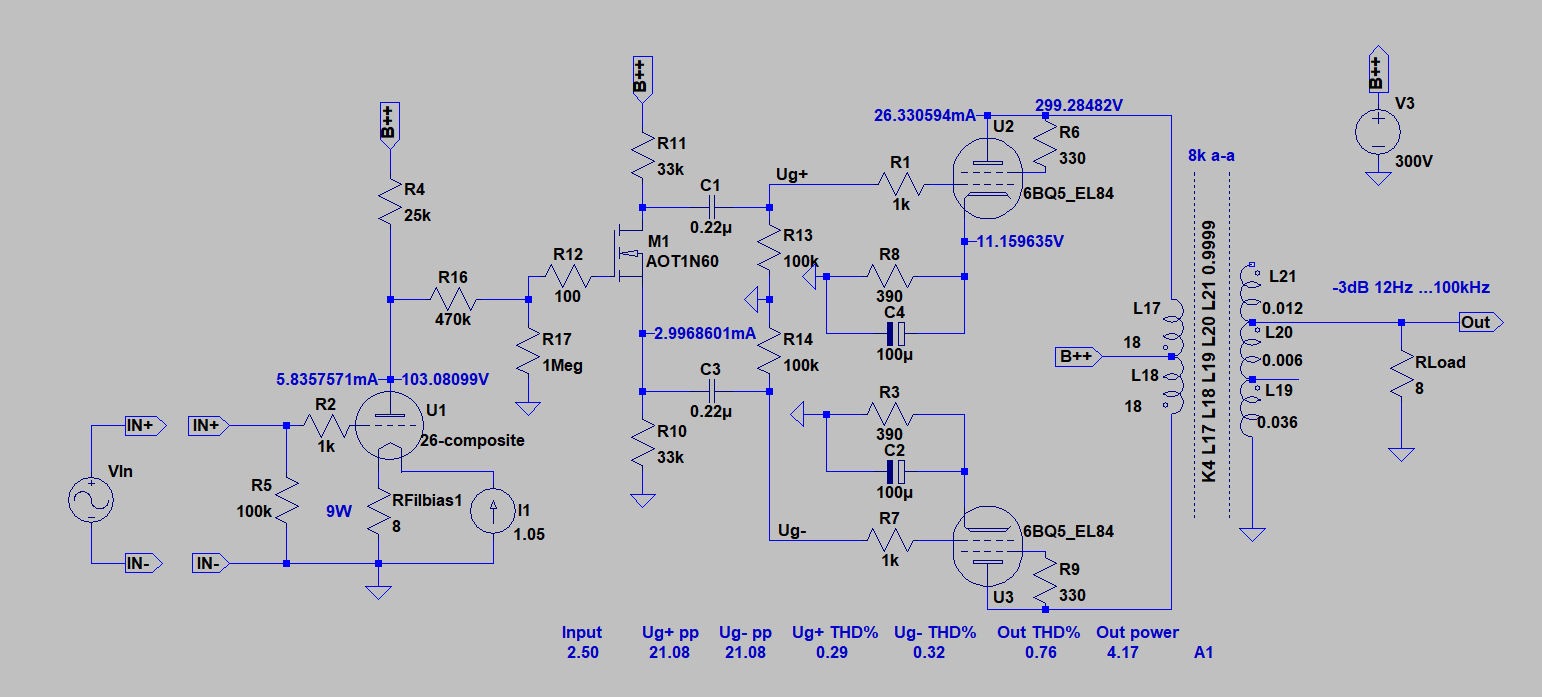

Phase splitter choices on input of PP amp
I'd like to know what are the choices for a phase splitter on the input of a PP amp so it could be driven by a preamp with gain using RCA inputs. Amp in question is an EL84 in PPP triode, so 8 output tubes in all. Choices I can think of include....
  • input transformer like 1:1+1 or 1:2+2
  • solid state splitter
  • valve concertina without the gain stage in front
  • ??? something else
I'd like something simple and transparent that could be driven with a 26 DHT preamp in this case, but this is a universal application so feel free to talk around choices as much as you would like.

A conventional EL84 PP amp with feedback isn't in my plans, though I agree they can sound very nice. I'm very happy with my "Inverted DHT" amps - single ended 2 stage with 26 driving high gain output tubes like the EL12.
I just have a PP chassis which I'm wondering what to do with. I might use it to drive a pair of bass units with an active crossover, for instance. Just speculation at this stage. But my preference would be to use my 26 stage. I could build myself a new preamp stage with e.g. 4P1L into a LL1660 which would do the phase splitting. But I would prefer to put the phase splitter in the amp.

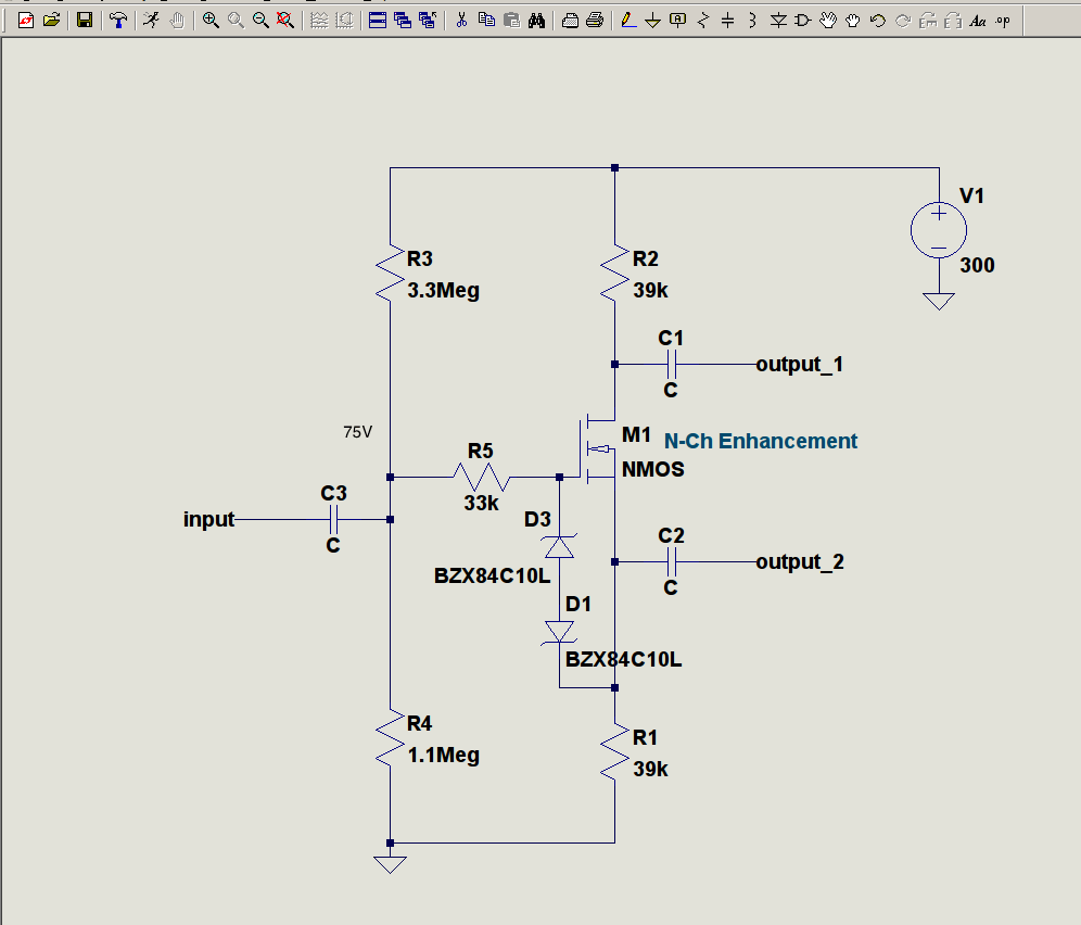

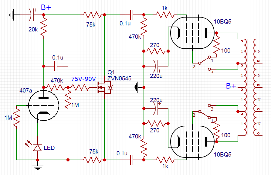

Played around with an old/odd idea of an iron concertina.

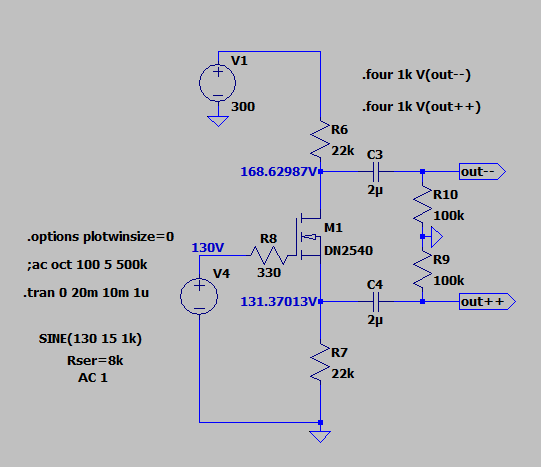

How do you calculate the design? Do you leave the Va and B+ of the valve stage as they are and let the voltages in the Mosfet just find their natural level? Or is the Va of the valve stage critical? If you used a voltage divider in front what would determine the voltage of that, say in relation to 300V?
Presumably you choose the resistor value for the current you want - in your design 6mA.
DN2540 works well at 5-6mA. When you know the drivers Ua you can calculate Rk. Ra must be the same, ie you have to select B+ to get enough voltage over the depletion mosfet.

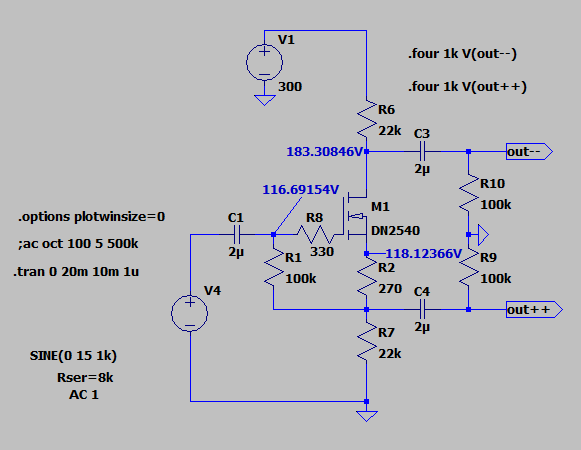

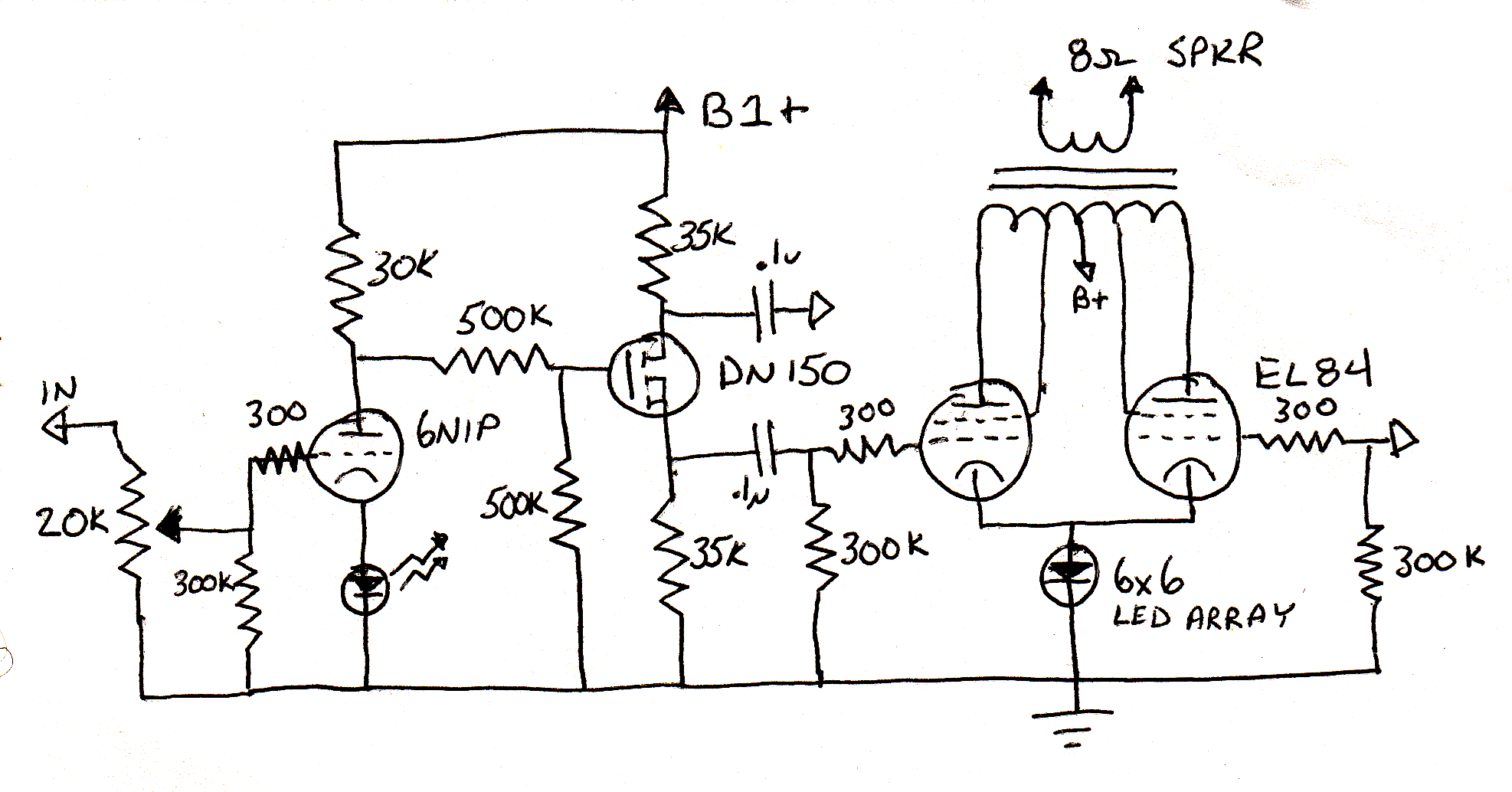

Wouldn´t go for a voltage divider with AC input, would do it like this instead:

FET phase splitter sample based on the above.

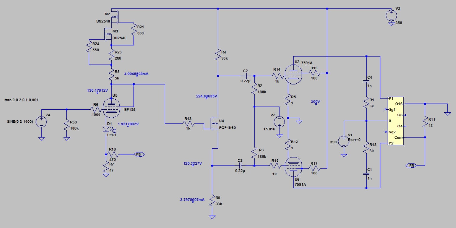

p.s.

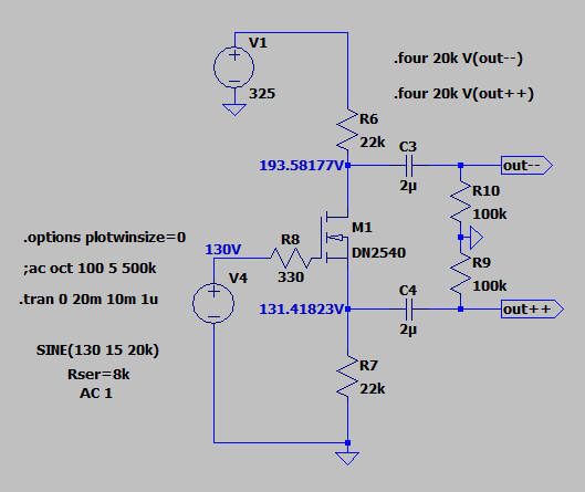

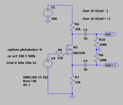

DN2540 almost unusable as next VAS (or in this case splitter) stage with high output impedance tubes as #26. It's HF behaviour is horrible, even over 10k the falling begins.
Remember the concertina has heavy NFB, like a source follower with two outputs. When adding your, in my view unnecessary voltage divider it might be, but with 8k directly from a 26 you reach -3dB at over 350kHz. With 50k you will only reach ca 70kHz.
Not familiar with the one you use, how much lower capacitance has it got?
