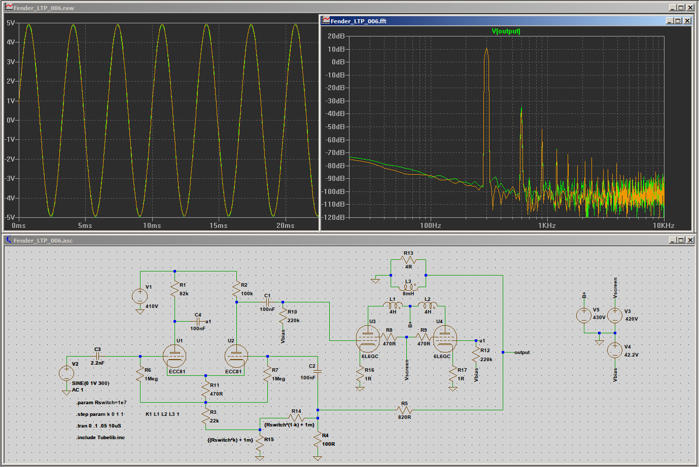

How about running a plot with 82k and 100k plate resistors for kicks?
Sure thing, you got it! Screenshot attached.
Leo-feedback seems to do even less with the LTP with unbalanced anode loads. There is less (fewer dB) reduction in second-harmonic distortion when Leo-feedback is implemented.
-Gnobuddy

Thanks for your simulation, Gnobuddy!
I think your results support my assumption in #38 (GNFB via the 1st triode only in Fender's circuitry).
Best regards!

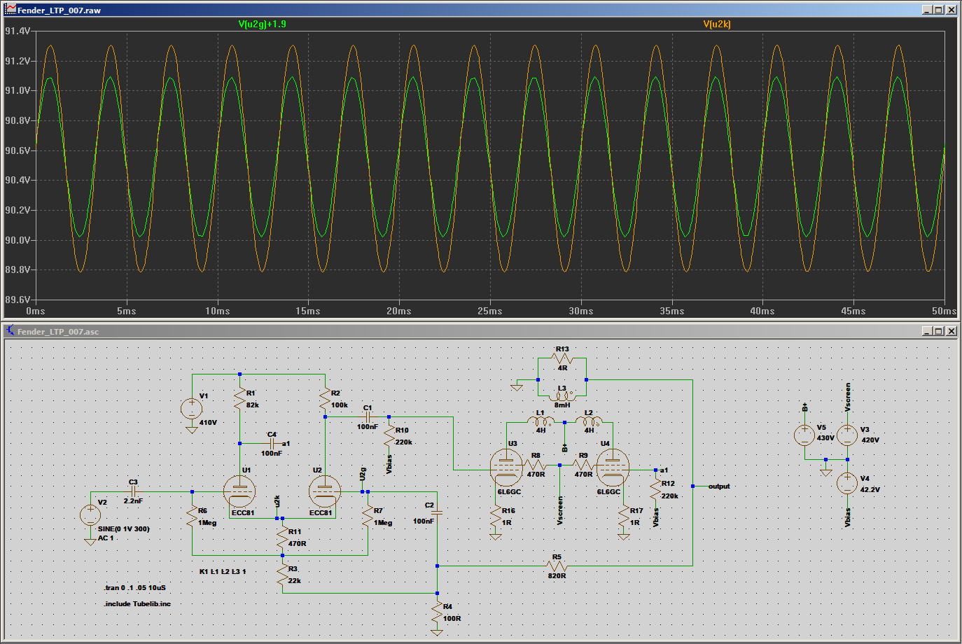

The attached screenshot shows that the signals at U2 control grid, and U2 cathode, are not the same size.
(I added a DC offset of 1.9 volts to the U2 grid voltage trace, to make it easier to compare the two, since the quiescent cathode voltage is about 1.9 volts more positive than the control grids.)
Since V(u2k) and V(u2g) are not equal by any means, there is a net voltage difference across U2 grid and cathode, and so U2 is definitely also amplifying, and responding to the feedback signal. Not just U1.
If we look at it a little more deeply, U2 cathode has about half of the input signal applied to it (as usual in any balanced LTP), plus about 4% of the NFB signal. U2 grid, meantime, has the full NFB signal applied to it.
This means that the AC component of Vgk of U2 looks like {(0.5*Vinput + 0.04*Vnfb) - Vnfb)}, which simplifies to {0.5*Vinput - 0.96*Vnfb}
(I've neglected an overall minus sign, so if we're fussy, Vgk(u2) is {0.96*Vnfb - 0.5*Vinput} rather than the other way around.)
In other words, it's not just U1 processing the feedback - U2 is involved too, and the only difference from a proper textbook NFB is that the feedback signal to U2 has been reduced by about 4%.
(The "4%" number was from my quick back-of-the-envelope calculation in an earlier post on this thread, based on the fraction of the signal that makes it through the 22k tail resistor and appears at U2 cathode. It won't be exact, but the crucial point is that it is a few percent, not 100 percent - the entire NFB signal does not appear at the shared cathodes. And therefore there is net feedback acting on U2 as well as U1.)
-Gnobuddy

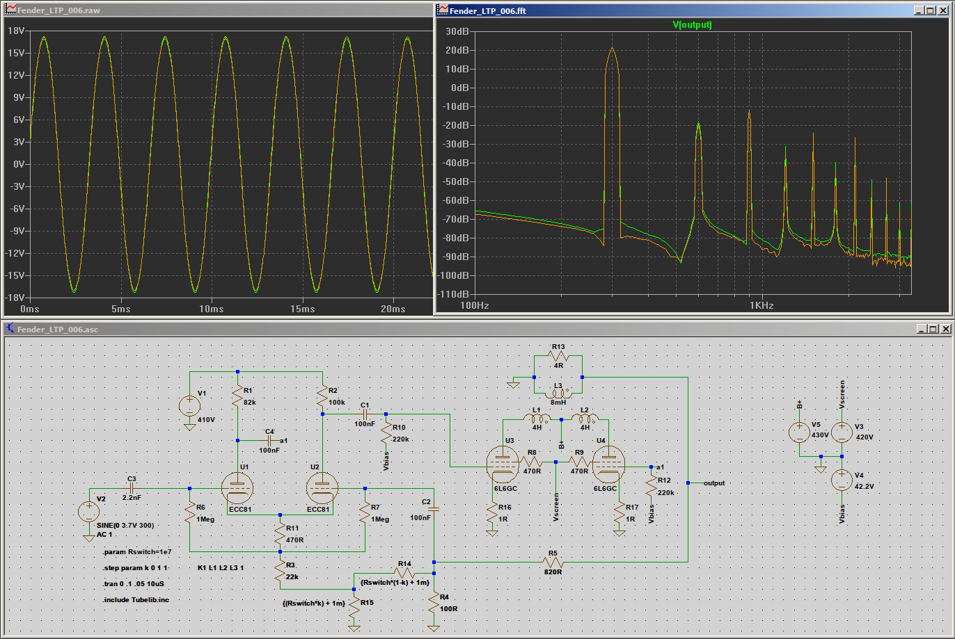

These 1%-0.3% THD numbers are for 2 Watts? That's not what a Bassman is for. 40, 50, 60 Watts (yes, gross clipping).
I also recall that load impedance mattered. While a full speaker-sim is tedious, a 4/40 Ohm switch would fair-model the two extremes (200-600Hz versus 90Hz thump and >3KHz screech).

Keep in mind, I have no idea how accurate the Spice tube models are deep into clipping. Apparently some of the popular pentode / tetrode models (Koren, etc) are very inaccurate at predicting screen grid current under heavy drive.
The Derk Reefman models I'm using are supposed to be much better than some of the other models out there when it comes to generating anode curves. But screen current under hard clipping? I have no idea how close to reality that is.
That said, here is the same sim, just at the threshold of clipping. About 34 volts peak-to-peak into 4 ohms, or a hair under 40 watts RMS. Plenty of harmonic spikes at about 40 dB below the fundamental, so a few to several percent THD if you add them up.
And? If we believe the sim, at 40 watts output, there are still no visible benefits to Leo-feedback (or Leo's-amp-tech feedback). Green and yellow-brown traces almost overlap perfectly, both for waveform and FFT. (If you can't see a green trace at all, it means the yellow-brown trace overlaid it perfectly, hiding it from view.)
