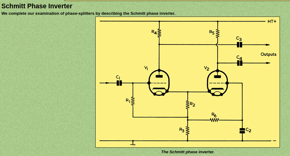

I'd never heard of the Schmitt phase-splitter, but I see it is nothing other than the long-tailed-pair (image attached.)...the Schmitt PI is a proven design, done by the millions.
Yes, I agree, Leo Fender's version is a botched-up long tailed pair.

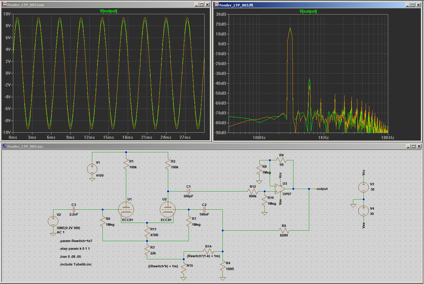

I fixed the mistake I was making in my simulation (a tiny drawing error, trace that didn't actually connect to the resistor symbol it went to.)
A little introduction regarding the simulation in the attached screenshot:
1) I used Derk Reefman's SPICE valve models for the 12AT7 (ECC81). Reefman's models seem to be among the best SPICE models for valves that are available.
2) For simplicity, I replaced the push-pull 6V6, OT, and associated components with an op-amp. I adjusted the voltage gain of the op-amp so that there is 6 dB of negative feedback when connected the same way Leonidas did. I'm guessing at how many dB of feedback is in the real Bassman - but it can't be too far off from 6 dB, probably within a couple of dB either way. If I got the amount of overall feedback right, this means the op-amp circuit now has the same voltage gain as the 6V6 pair along with its OT.
3) To keep the op-amp from clipping in the simulation, I increased its supply voltage to +/- 30 volts. A real OP-07 cannot withstand this much supply voltage, but the LTSpice model doesn't know about excessive power supply voltage.
4) Resistors R14 and R15, along with the .param and .step SPICE commands, act like an SPDT switch. At any given time, one of them has a resistance of one milli-ohm, while the other has a resistance of ten million ohms. These values are swapped when the ".step param k" statement is executed.
So the effect is to switch the 22k tail resistor either to ground (the proper "textbook" location), or to the top of the 100 ohm resistor (where Leonidas connected it.)
5) Input signal is 4 volts peak-to-peak, or 2 volts peak, or 1.414 volts RMS, 300 Hz, sinewave. (This is just below the threshold where the op-amp clips due to output current limiting, from trying to drive the 820 ohm feedback resistor.)
6) The green trace shows the output voltage when the feedback is applied properly. The yellow-brown trace shows the result of Leo's screw-up. As predicted, the effect of Leo's mistake is to very slightly reduce the amount of negative feedback, and therefore very slightly increase the voltage gain of the Bassman. The yellow-brown trace has very slightly more amplitude than the green one.
7) The FFT shows a minor change in 3rd-harmonic distortion. However this is 50 dB down from the fundamental, and therefore not audible.
All other harmonics are at least 65 dB down from the fundamental, and completely inaudible.
8) I see no evidence to suggest Leo's feedback connection does anything special. This lends credence to the idea that it was either a mistake, or a convenient way to re-use existing turret-boards with the newly redesigned schematic.
About now, somebody will probably say "Leo's magic mojo only happens when you include the 6V6s!", and we will be back to square one again...
-Gnobuddy

What is the change in the 2nd harmonic?
I'm not in a mood to analyze this now (I did but many years back), so ignore me.
But you have taken one of the two outputs of the splitter. To a first approximation they ARE equal. BUT injecting a single-ended NFB signal into the common-mode input (the tail) is liable to have +/- effects different in each plate.
The "fake output stage" can be a differential-input amplifier. PSpice has several function-blocks to do such work without abusing or complicating "real" parts; Mooley may know the LTspice way. (Don't assume the single opamp diff-amp is OK, it has different impedances for different drives.)
There isn't any 2nd harmonic to be seen in this sim - it's buried in the FFT noise floor, 90 dB below the fundamental.What is the change in the 2nd harmonic?
A balanced LTP cancels out even harmonic distortion from the two devices, so this isn't too surprising. In LTSpice the balance is (unnaturally) perfect, and so there will be perfect cancellation of even harmonics.
Since the two devices are (ideally) matched, I would expect that anything injected at the shared cathodes will appear identically at each anode - this is just a perfectly ordinary common-mode signal, after all.BUT injecting a single-ended NFB signal into the common-mode input (the tail) is liable to have +/- effects different in each plate.
We can apply the usual principle of linear superposition to the two devices in the LTP, in particular, the one that's being a fed a feedback signal at both its cathode and its grid. Both signals are in phase, so the net effect is to reduce Vgk a tiny bit, effectively reducing the amount of feedback just a hair, and thereby increasing closed-loop voltage gain a hair.
How big a hair? The LTSpice simulation shows it's pretty small. Compare the amplitudes of the green and yellow-brown sine wave signals. The difference is too small to read precisely, but a quick approximations is that one signal (green) has a peak value of about 9V, the other about 9.5. That's about a 5% increase in closed-loop voltage gain when Leo's "special" feedback is implemented.
(5% is well below the minimum audible change of 1 dB, which is 12%. Too small to hear. Leo-feedback makes no audible difference.)
Without using Spice, we can make a rough estimate of the same thing as follows: impedance at the cathode of one 12AT7 should be (1/gm) + (ra/mu) + (Ra/mu). The first term is about 250 ohms, the second one another 250 ohms, the third about 1.5 kilo ohms. Total 2 kilo ohms; in parallel with the same impedance from the second triode, back down to about 1k small-signal impedance at the cathode.
With the signal fed to the bottom end of the 22k tail resistor, that means ~(1/23) of the feedback signal - call it 4% - makes it through the tail resistor to appear as a change in cathode voltage at the triodes.
So we have an amp with only a few decibels of negative feedback to start with, and then a tiny fraction of that already-small NFB (about 4% of it) is applied to the cathodes in Leo's scheme. Net result, the negative feedback signal is reduced by about 4%.
One would expect that this would result in about a 4% increase in closed-loop voltage gain, which is about one-third of a decibel. Well below the minimum 1 dB change detectable by human ears.
That 4% back-of-the-envelope estimation is gratifyingly close to the roughly 5% change seen in the LTSpice simulation, no?
I could do the classic three op-amp instrumentation amplifier circuit. But it may be just as easy to throw a pair of 6V6GT in the simulation - they're included in the Derk Reefman LTSpice tube library.Don't assume the single opamp diff-amp is OK, it has different impedances for different drives.
The other question is what that does to simulation run-times on my ageing Core i5 PC, but I guess we shall see!
-Gnobuddy

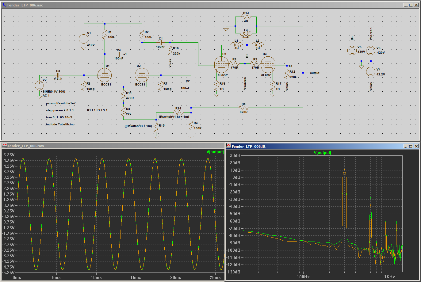

The plot thickens!
Here is the LTSpice simulation of the entire power section of the Bassman, including a pair of 6L6GC biased to 40 mA each.
Keep in mind this is a simulation, not reality - results are only as good as the tube models. I'm using the Derk Reefman models, which are said to be perhaps the most accurate ones available now. Still, this is only a simulation, and we should all keep that in mind.
A few interesting points:
1) Adding the 6L6 output tubes brings back 2nd harmonic distortion, as it should; Schade's white-paper on the 6L6 explicitly mentions that beam power tubes tend to produce lots of 2nd harmonic distortion compared to otherwise-similar pentodes.
(But why doesn't the 2nd harmonic distortion cancel out in the push-pull output stage? It's a simulation, so everything is perfectly matched.)
2) There is now even less change in output amplitude (and closed-loop voltage gain) when switching between textbook negative feedback, and weird Leo-feedback. The difference is so small that it's completely negligible - it's barely detectable on the plot, and would be completely inaudible (far less than 1 dB change).
There is about 6 dB of overall negative feedback, as before; I did nothing to ensure this, other than assume a 4-ohm speaker, and set up the transformer turns-ratios to present 8k anode-to-anode load to the 6L6s. That done, the voltage gain drops to about half when the NFB is connected.
3) FWIW, the FFT shows that Leo-feedback reduces 2nd harmonic distortion compared to proper feedback. But - it goes from completely inaudible (1%, 40 dB below the fundamental) to even more completely inaudible (0.3%, 50 dB below the fundamental.)
In the era of carefully controlled audio tests done by trained professionals, there was some doubt as to whether 1% THD could be heard or not; some people could detect it using a pure sine-wave test tone, statistics were inconclusive as to whether anyone could detect it listening to music. I'll bet my hat there is zero chance of anybody detecting 1% THD using an electric guitar as the test signal.
The Bassman's preamp would have been generating considerably more distortion at some control settings, and that certainly could be heard. But if this LTSpice simulation is close to correct, the power section of the Bassman was squeaky-clean, Hi-Fi clean, no-audible-distortion clean. No matter whether using Leo-feedback, or proper textbook-feedback.
-Gnobuddy
-Gnobuddy
