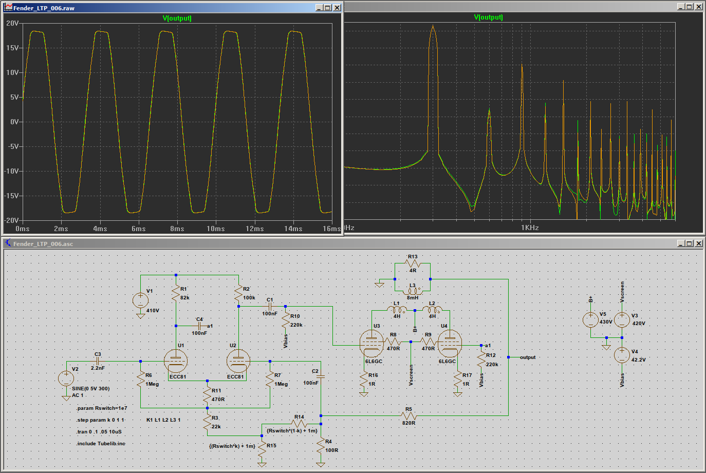

Now that I have one Bassman schematic modelled in LTSpice, and the grunt-work is done, it won't take a lot of work to model another variation on the theme. LTSpice does frequency response plots too, so things like the effect of a presence control can be studied.

Speaking of dirt, here's a screenshot of the Bassman LTSpice simulation deep into clipping....Twin...some dirt.
I don't know how much we can trust the vacuum tube models when the amp is pushed this far, but for what it's worth, this is the result of the simulation.
Clipping looks pretty abrupt, probably because of the negative feedback. There is a forest of spikes in the FFT, with lots of unpleasant-sounding higher harmonics; this is no gentle "tubey" distortion, but something much more abrupt and crunchy.
And there is still no benefit (or disadvantage) to be seen from Leo-feedback. The green and yellow-brown curves fall almost perfectly on top of each other in both the waveform and spectrum plots.
