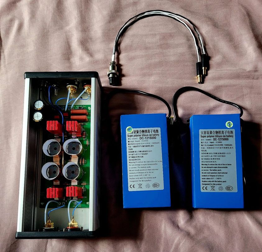

For my latest build I did the same as you with isolated RCA's
My first build used a SilentSwitcher powered off a battery pack but I no longer have that build.

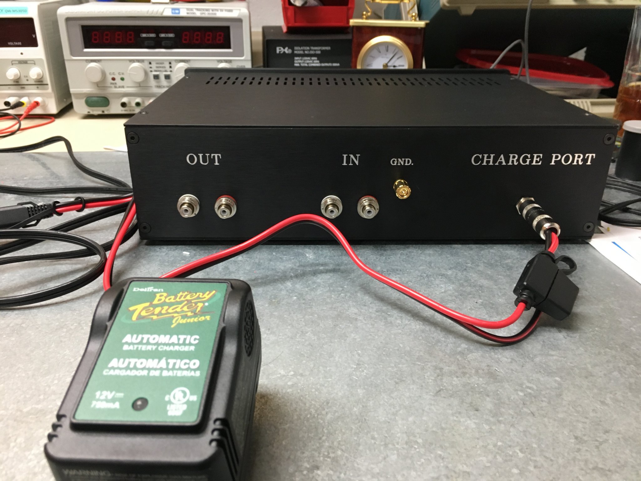

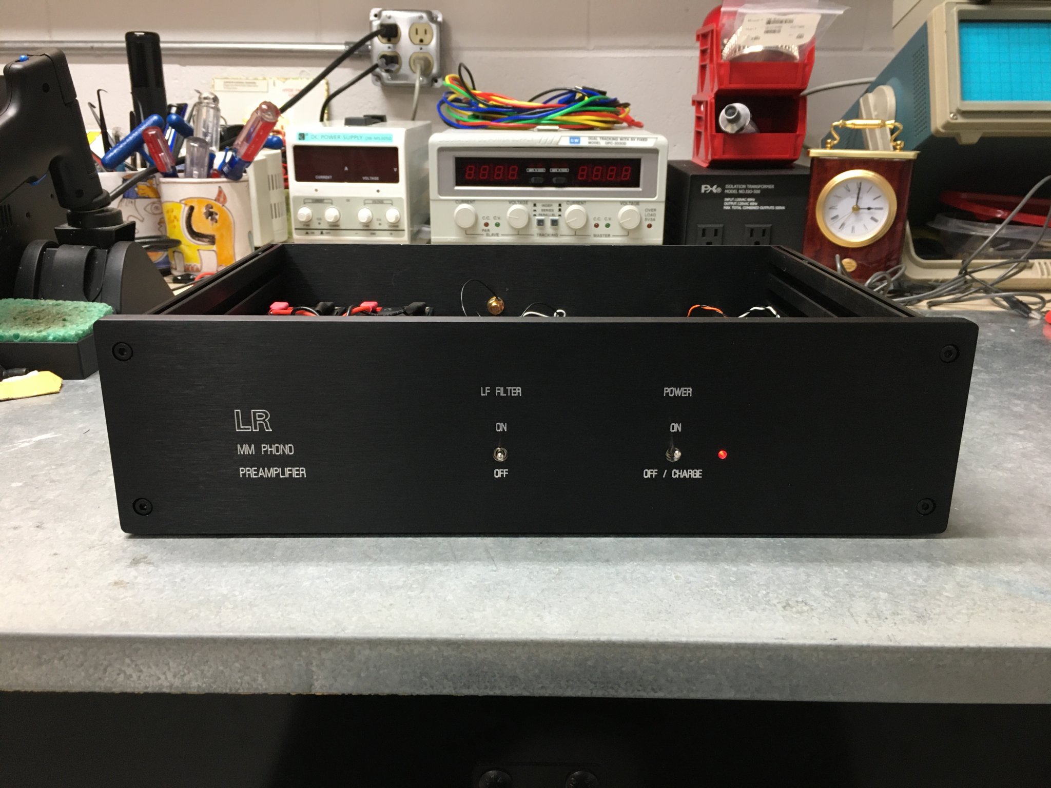

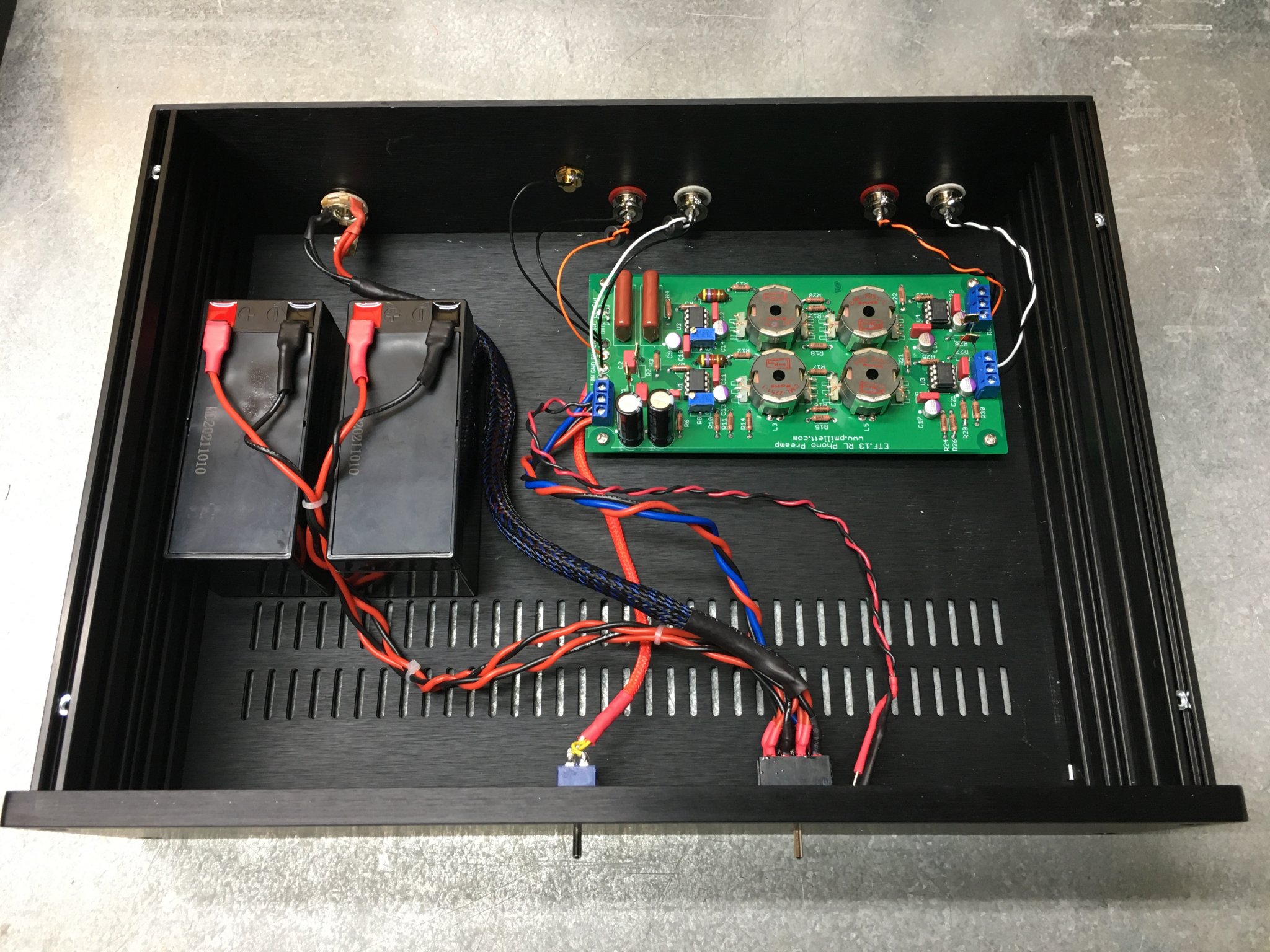

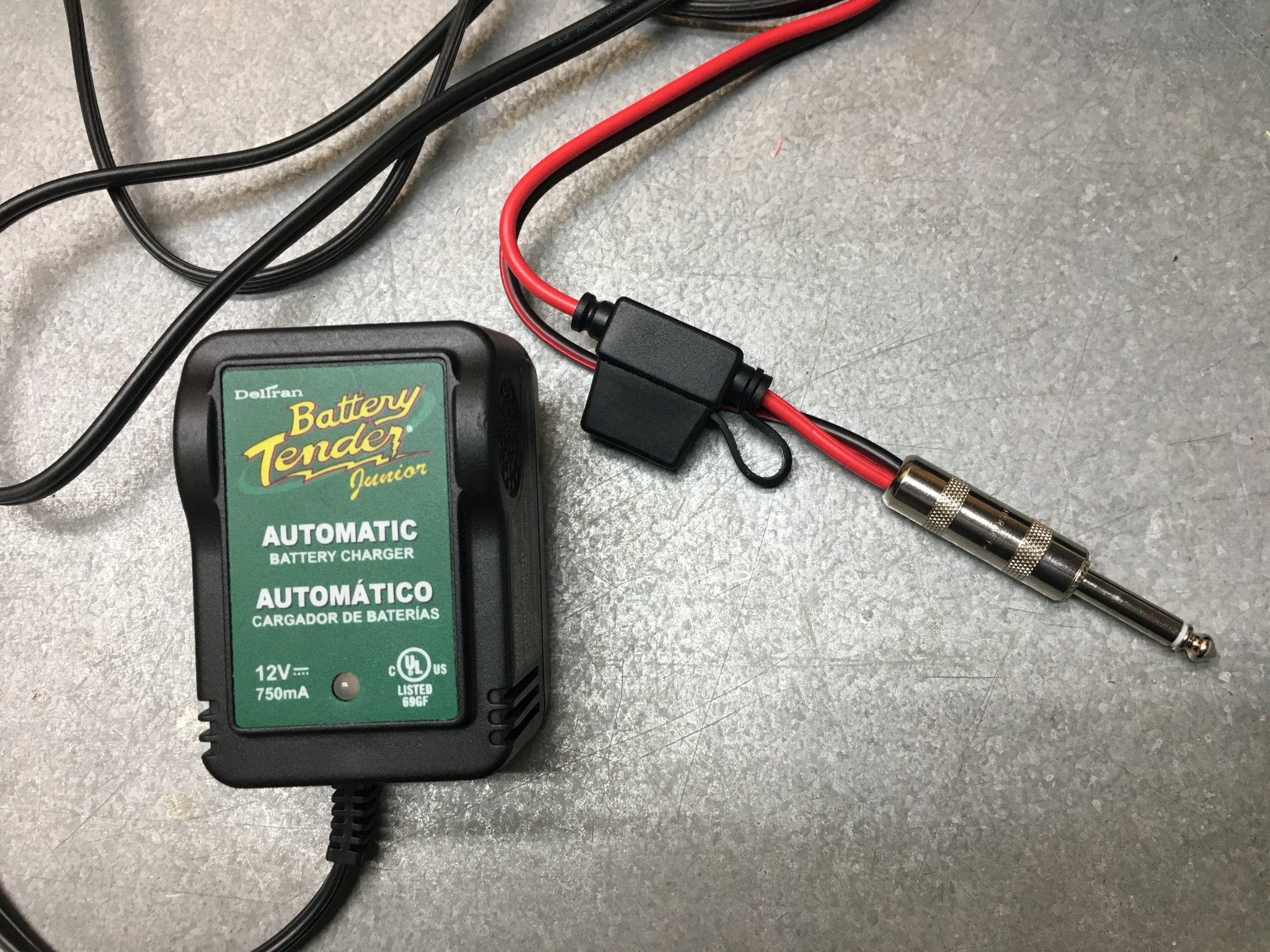

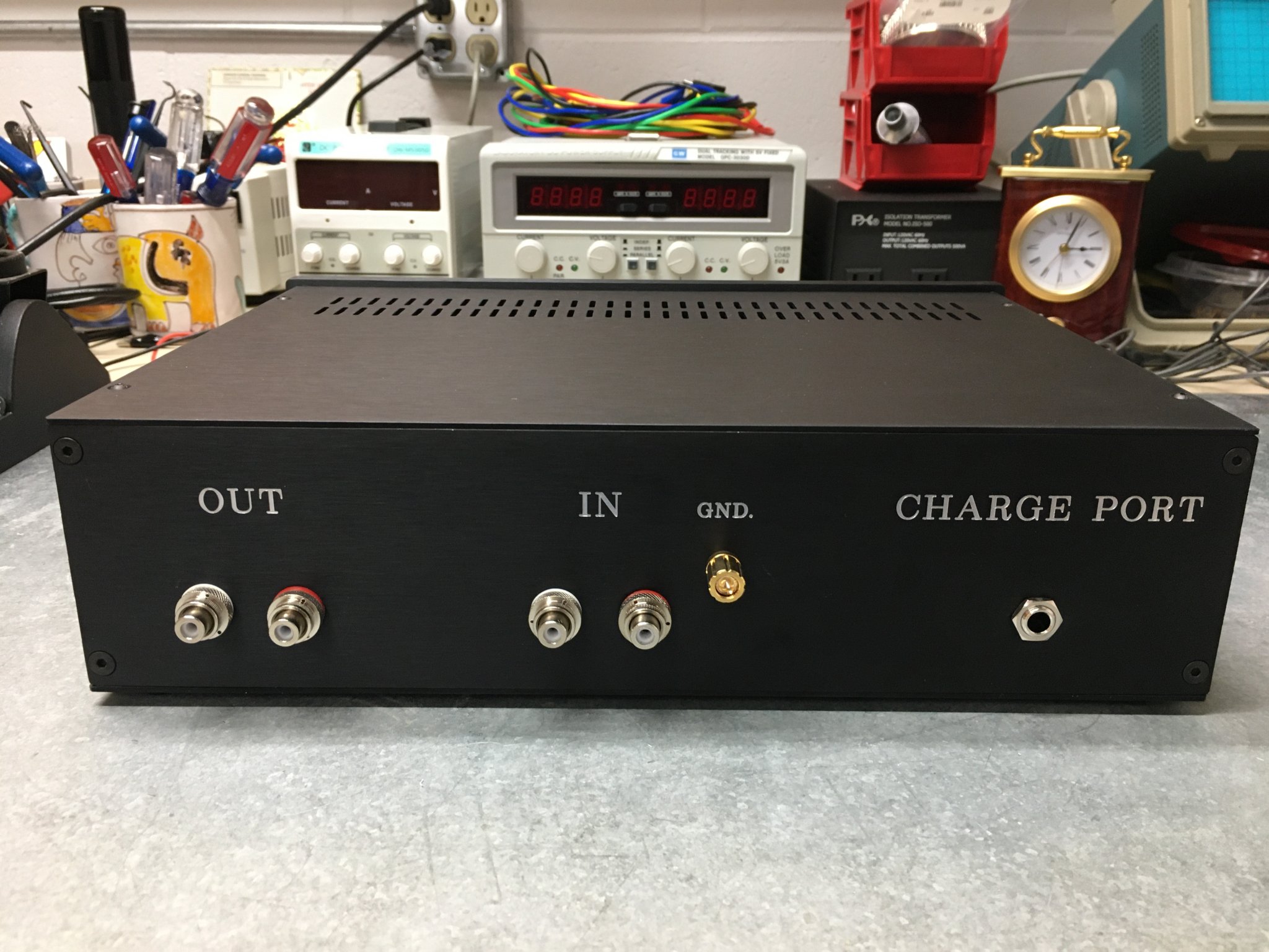

I've always wanted a phono preamp using batteries, so I built this with two CA1212 AGM 12v 1.3Ah batteries. I used a 4PDT switch from Parts Express for the ON / OFF/Charge, and a 1/4" phone plug for the charge port. My Battery Tender Junior works great on my Motorcycle AGM batteries, so this is my charger set up for the LR. The difference in cost from batteries to a regulated power supply is a tremendous incentive to use the batteries.

Yes! Very nice.
A comment on batteries—here's what I had laying around for charging batts on motorcycle trips... It was 3/4 charged when I pulled it from storage... I have yet to charge it up! Just keeps going driving the preamp via Silent Switcher/USB...

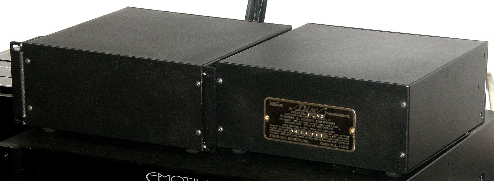

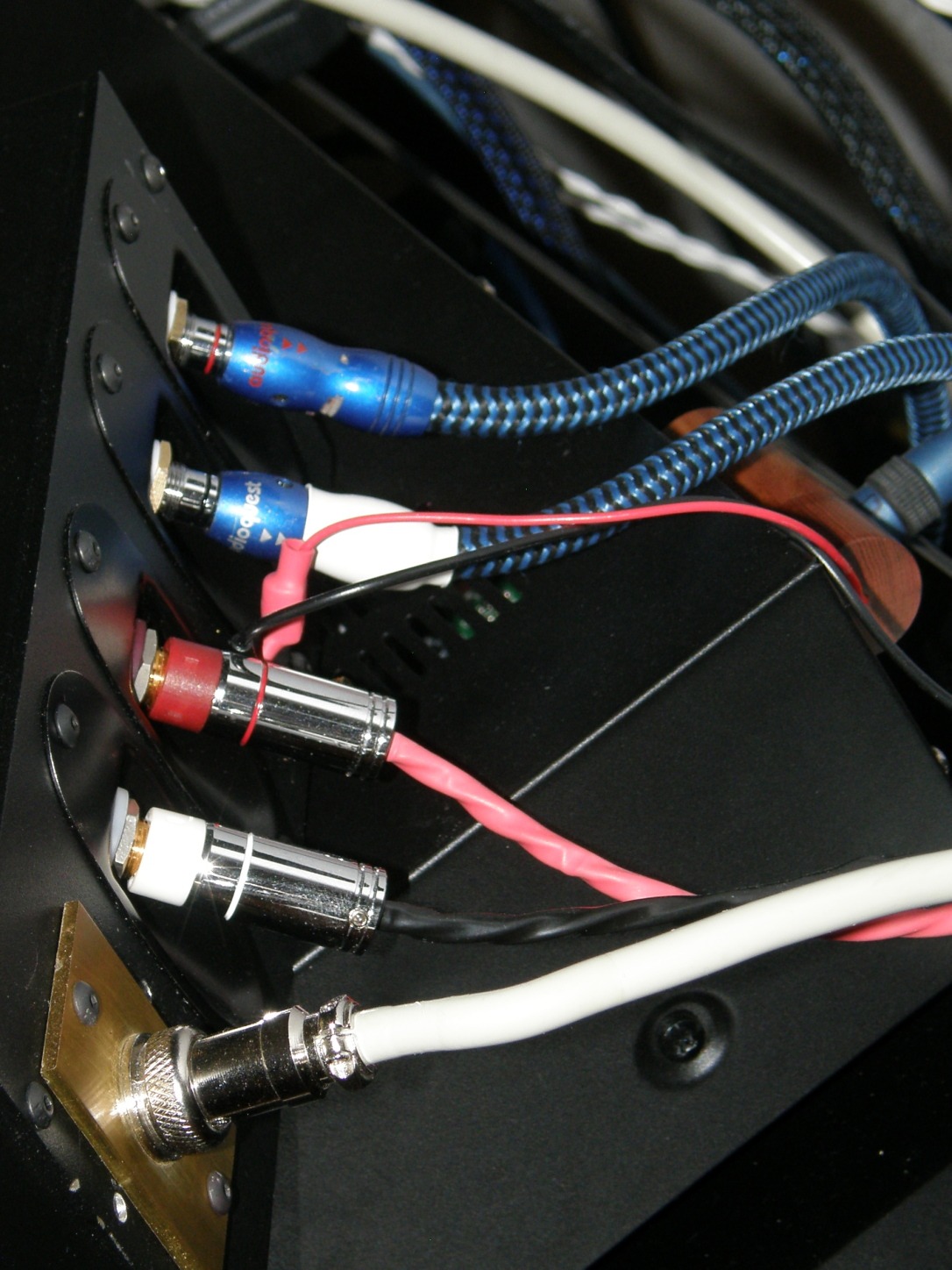

Built two of these so far. Had an issue with hum on both of them until I used a separate power supply chassis. Now they are quiet as a moose, um er, mouse. Used slanted 'boat jacks' on the back. A little more work but can take the strain of f of some IC cables.

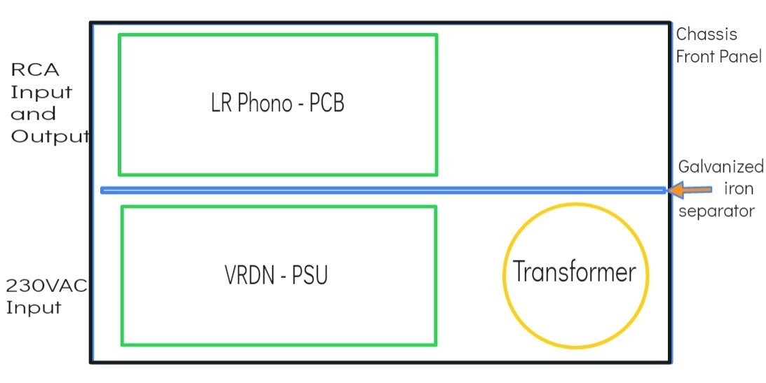

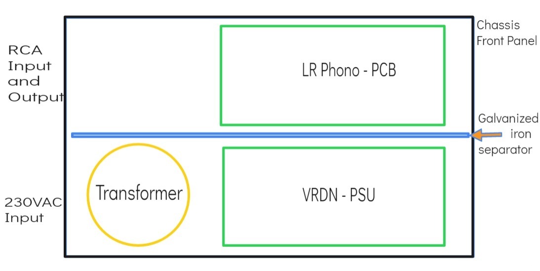

I'm going to build my LR Phono preamp in one chassis, and I'm investigating some layout possibilities.
Given the dimensions of the chassis, the transformer, and the PCB boards; I think I have two layout possibilities for which I have made the drawings below.
Which one do you think is the best option?
Layout 1
Layout 1
Layout 2
