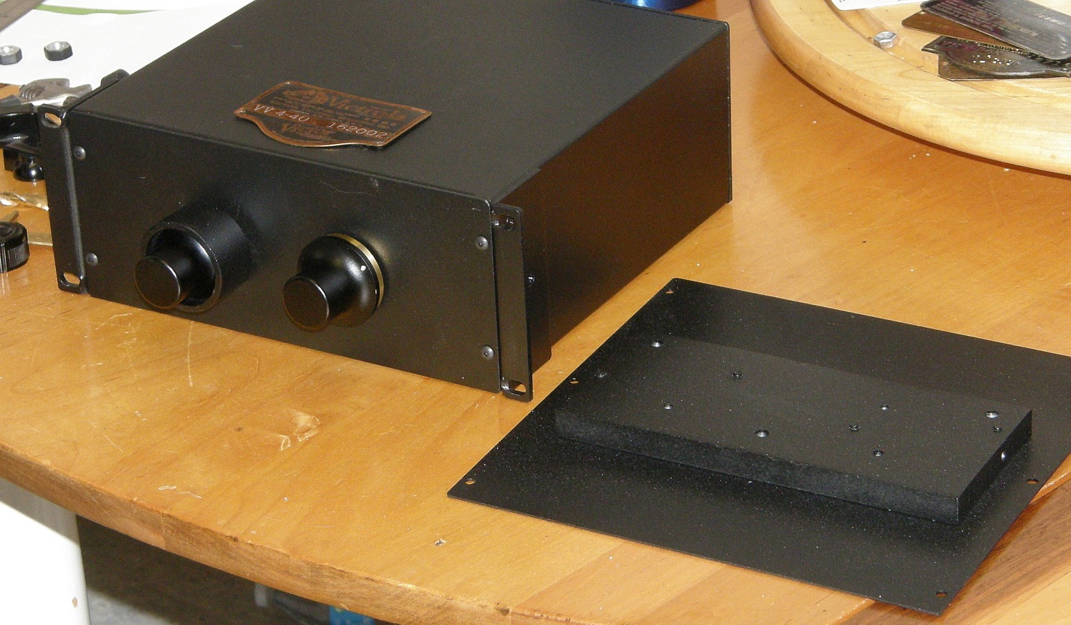

Boy, can I relate! As you stated, the cost keeps rising with parts. One suggestion that I would have for you is to look at eBay a seller by the name of primetalproducts. They offer a half chassis, 2U enclosure that is about $60 shipped, and amazingly high quality. Aluminum is used for the front and back panels but the rest is steel. The finish is first rate. The Cinemag coils are probably $30 each and you might have to wait for shipping.
As it so happens, I have built 2 of these, and even may have an 'extra' set of boards if you are interested. I will go so far as to offer a built board and power supply if you like. I was on a mission a couple years ago and tried out one phono pre after another. I ended up building a very expensive (time and money) unit that has only been completed a month or so ago. Pretty much a nightmare, but it is up and running, hence the reason to put other stuff out there for sale.
FWIW, here is a shot of one of these enclosures being used for another project.
