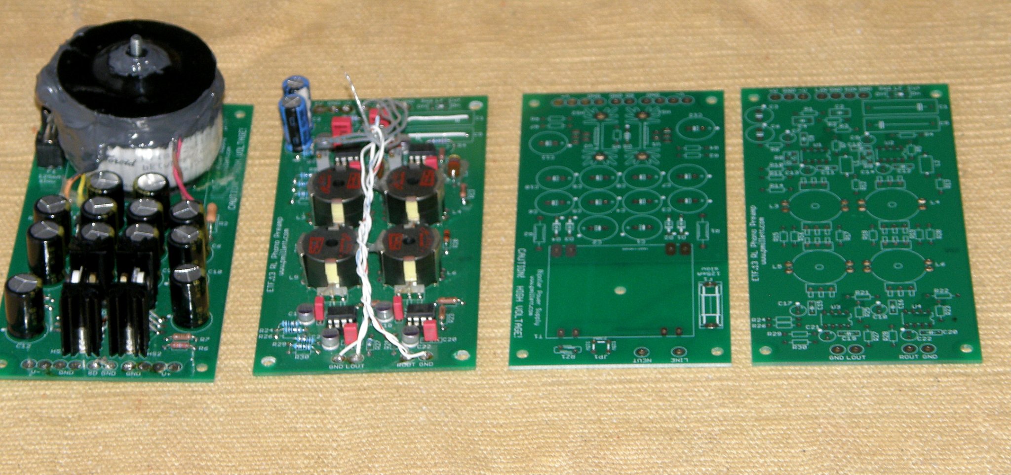

I realize that I should just put these in the for sale thread, and I will, but, ahem, hint hint. Will likely sell at a considerably reduced price. Note the inductors.
YES, IF IT WERE ME, I WOULD LIKELY USE A DIFFERENT TRANSFORMER. I DID A SLOPPY JOB ON IT. THE REST OF THE BUILD IS IMPRESSIVELY DONE!

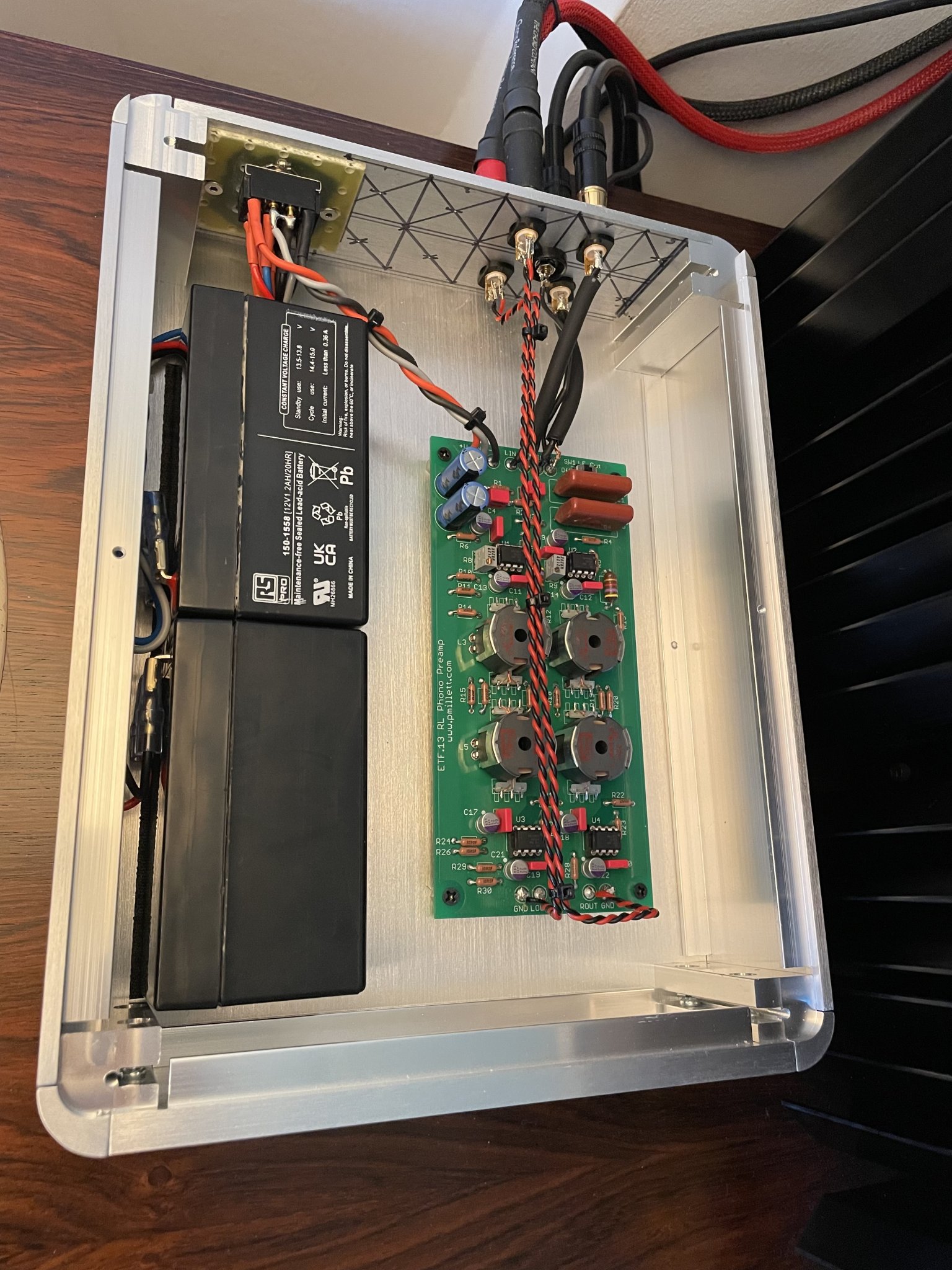

Everything is on it's way and I'm extremely excited! Went with a battery supply as it was working out about the same price as a linear.
You will hear different takes about battery supplies, but I am in the camp that strongly supports this thinking as well as doing a preamp the same way. The obvious benefit is that your unit cannot create hum. To me, that worth the effort all by itself.
