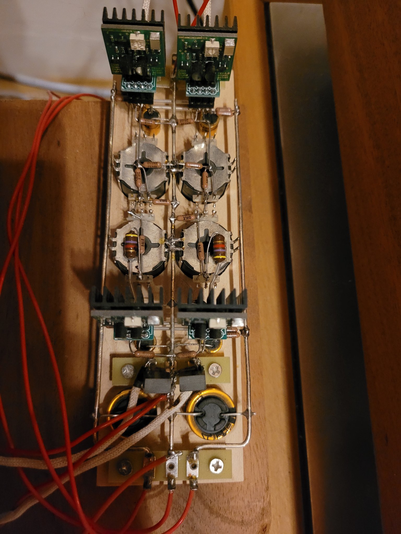

That's pretty creative, nice work.I build the lr phono free wired on a wooden block with Audio Note Kansei lytics.
What are your impressions after listening to it?
Nice work. Your amplification sections look like they are transistors rather than op-amps...FETs I would imagine. Can you share your amplification circuits?I build the lr phono free wired on a wooden block with Audio Note Kansei lytics.
I am really on board with the idea of using discreet transistors in place of integrated circuits. That is one thing that stood out to me here. The best part though was the neatness of the wiring ground path. Sounds funny I guess but when neatness is attended to in a build, it inspires confidence.
Actually, I've figured out what those are - Staccato discrete op-amps. Not cheap.I am really on board with the idea of using discreet transistors in place of integrated circuits.
https://staccatoaudio.com/portfolio_page/osh-s-open-sound-hybrid-single/
Yes, still discreet. The reason that I am saying this is because of building two very similar units, each one with their own design. Ultimately the discreet unit was the I favored. I do not know enough about design, yet I have stuck with this belief since then.
Since I have been using this phono, my tube D3a LCR has been out of work. The discrete staccato opamp sounds much more open and dynamic than the AD797. I use a shunt regulator power supply with great satisfaction.
