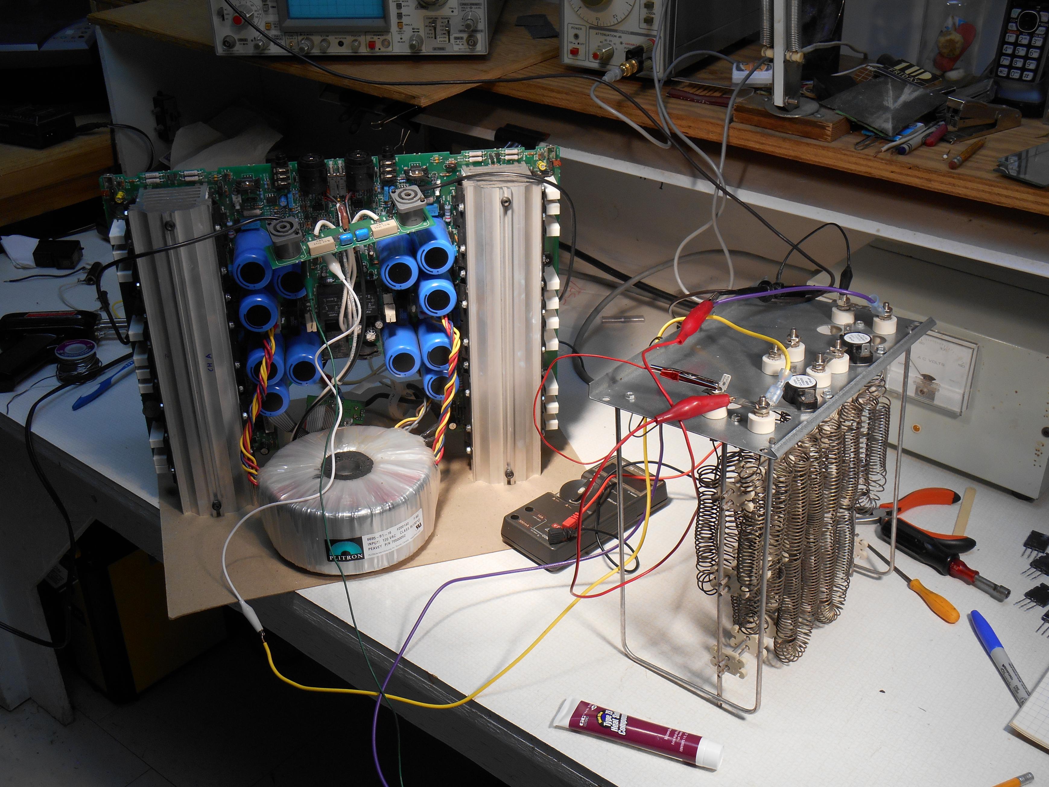

Hi wg_ski and all;
I checked diodes again, all good, and powered up the amp. I drove the amp to 'full swing' into a 125 Ohm power resistor. The amp clipped evenly at 81 Volts RMS. Minor panic as I smelled smoke! Fortunately, it was my 10 Watt power resistor, objecting to the 81 Volts (52 Watts)-----Another rookie mistake!
Apart from smoking my load resistor, the amp seemed to perform perfectly. I could see no glitches on the scope, I was particularly focused on the sine wave, half way up from the traditional (zero or crossover) region). It seems to transition smoothly from the Low to Hi rails.

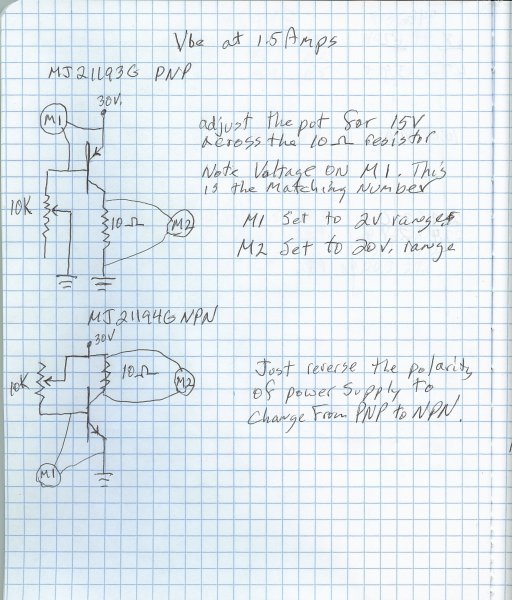

As has been noted: that's scaled for 0.1mA, which is AWFUL low for Power transistors. May make sense for input devices. As said, 1K or 390r may be more your size.
Otherwise-- what more could you want? Oh, there's many-many "improvements" possible. Some measure of hFE may be relevant. Measuring with Vce>10V may be more appropriate than at 0.6V. All of these add complexity, and more opportunity for arithmetic mistakes.

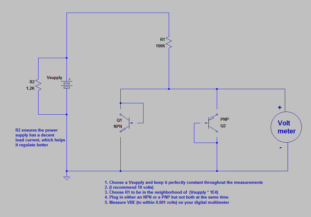

Here is my "Absolutely Simplest Transistor Tester Ever"; I have been trying it on the remaining low rail PNP and NPN devices, which have now been removed.
The transistors are ordered---feels like Christmas! I order 10 each MJL1302AG and MJL3281AG. I went against the advice of wg_ski because the girl at Newark could not assure me 25 devices would be from the same batch, (and secondly; I'm cheap!).
This is the most straight forward arrangement I could find. I am re-posting the schematic below. As advised; R 1 is 1 k Ohm, this allowed a test current of 23 mA with a 24 V supply. My power supply is well regulated, so R 2 was not necessary ( I believe).

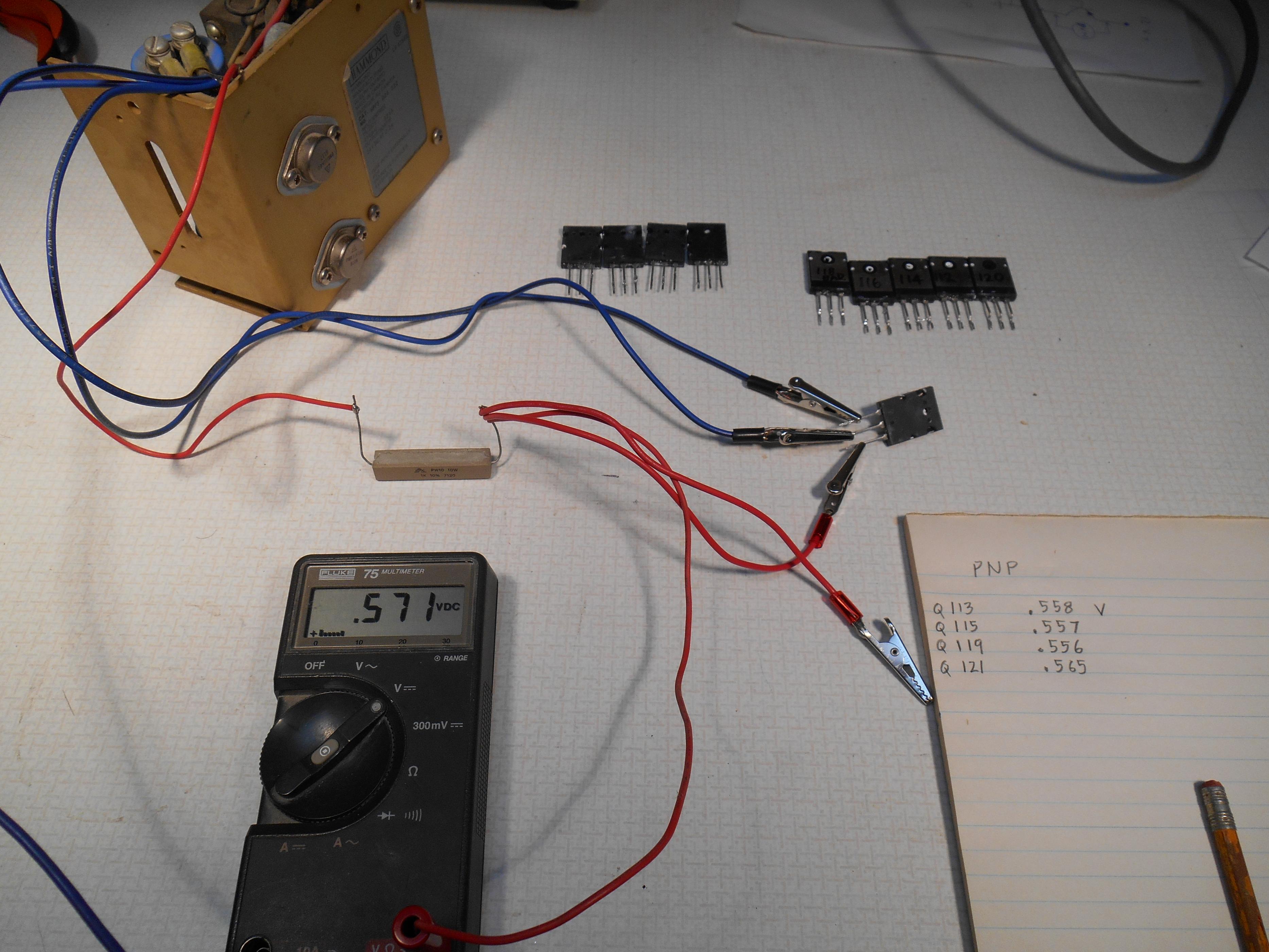

I connect 2 blue clips (on Base and Collector) for PNP, and 2 red clips on B and C, for NPN. I found that readings dropped about 1 mV, at the 10 second point, without much more change, even at 1 minute.
I felt no temperature increase in the transistors (tested here without heat sink), and only just perceptible temp increase in R 1. Obviously, my readings should be talking at the same point in time, but am I correct in assuming that at 23 mA, timing is not critical?
Thanks again, all, Peter

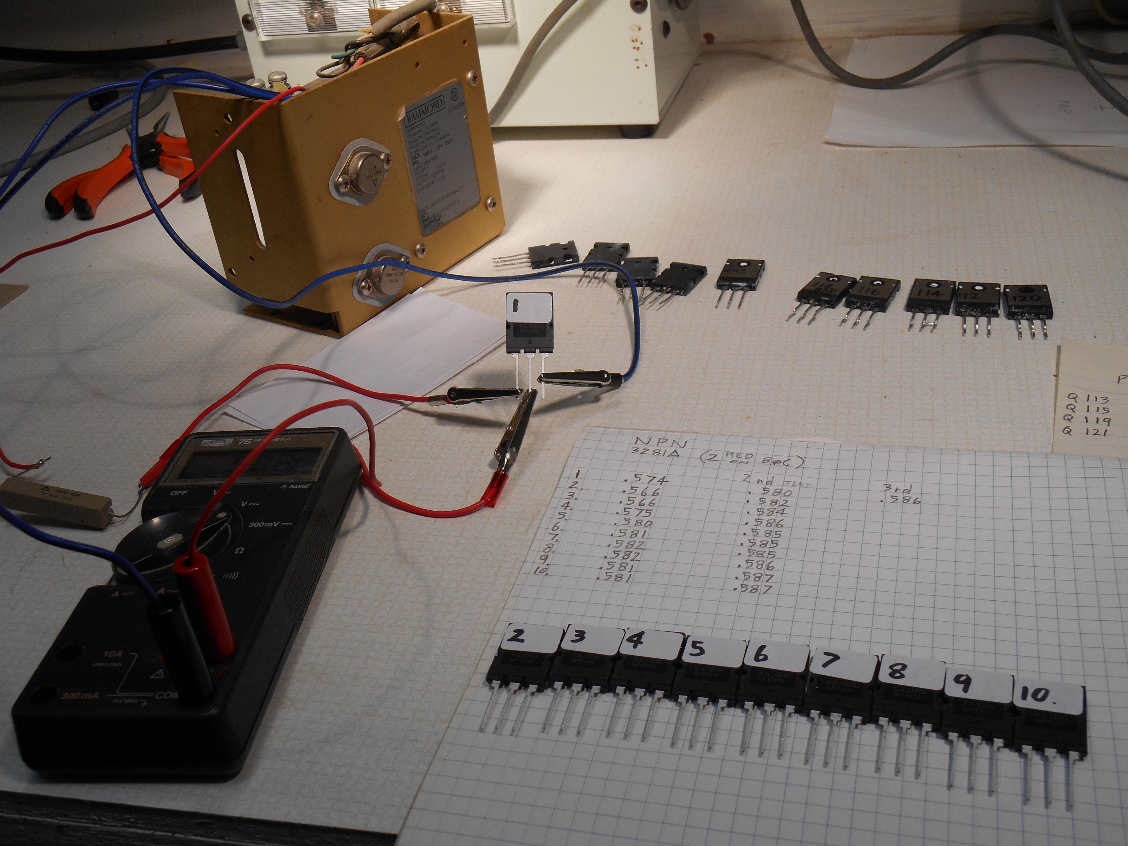

The Tranny's are here!---(I never felt right about that abbreviation).
All the NPN's have the same date code. The lower number is referred to as 'date code' on the pack slip.
Initial Vbe test were disappointing, but after allowing my test apparatus to warm up (connecting the 1 k Ohm resistor directly to the 24 V supply for 1 hour), results were more consistent.

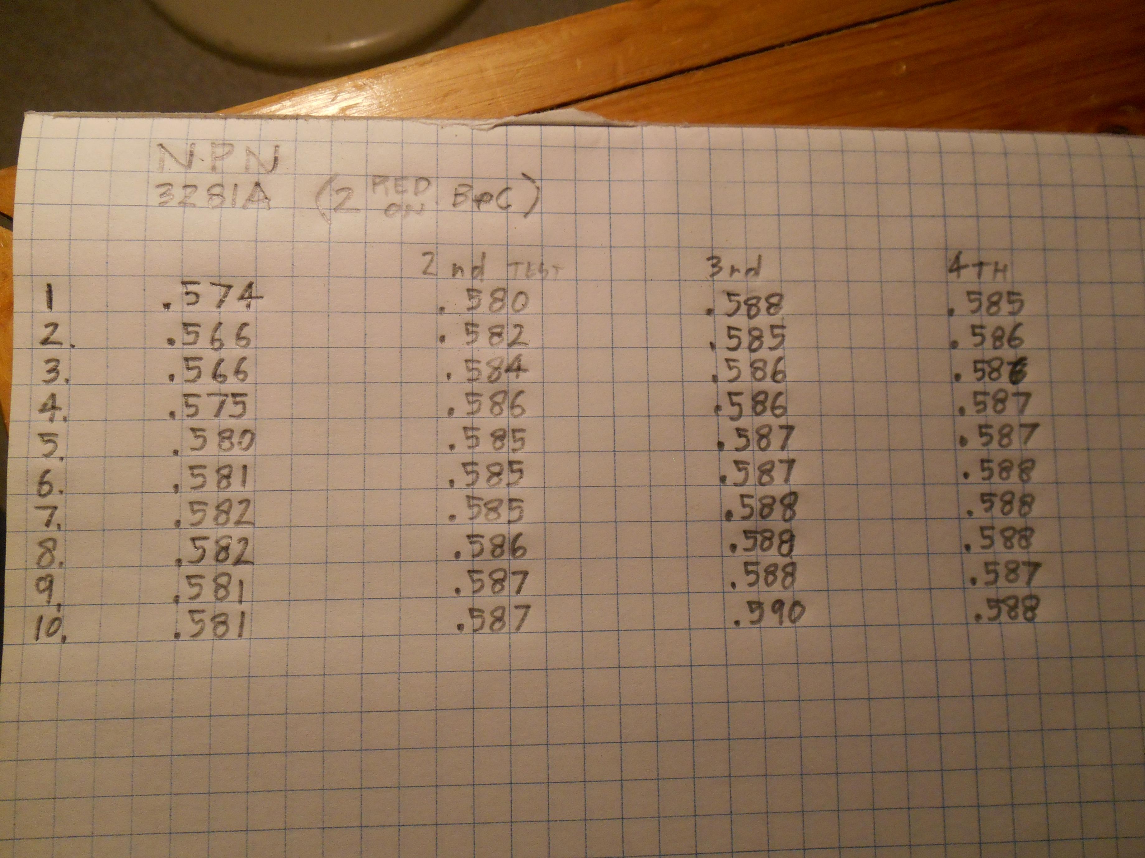

Here are my results; column 1 was from a cold start (all readings were taking after a 10 second count, the 10 second wait typically resulted in a 1 mV drop)
The 3rd and 4th column were taken after the 1 hour warm-up of the test jig.
I feel I may be 'out in left field' here, but my plan was to repeat this measurements a number of times, until I see a definite trend that is specific to each transistor.
I am open for suggestions regarding changes to my test method, but on the forth time around, the readings only varied from .585 mV to .588. The increase seemed to follow the order of my testing sequence, so the most obvious procedure change would be to reverse my testing order. ( I'll get back with those results asap).
My thinking was to select the 5 highest (or 5 lowest?) devices, rather than taking 5 out of the middle. This would leave me with a more closely matched set of spares. Is this foolish?
I really appreciate any guidance, thanks again, Peter
