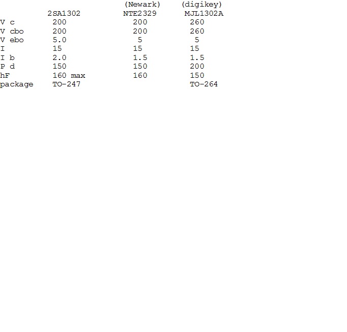

Thanks guys;
The ON semi MJL1302A specs look like a great substitute. Is it a concern that the original Toshiba's had a higher Ib? In any case, I am convinced that all 5 outputs have to be replaced, and a 'rail' of 25 will not break the bank.
Indianajo, you mentioned above that this may require changing more outputs, do you mean in addition to the set of 5 in the rail where the shorted device was found?

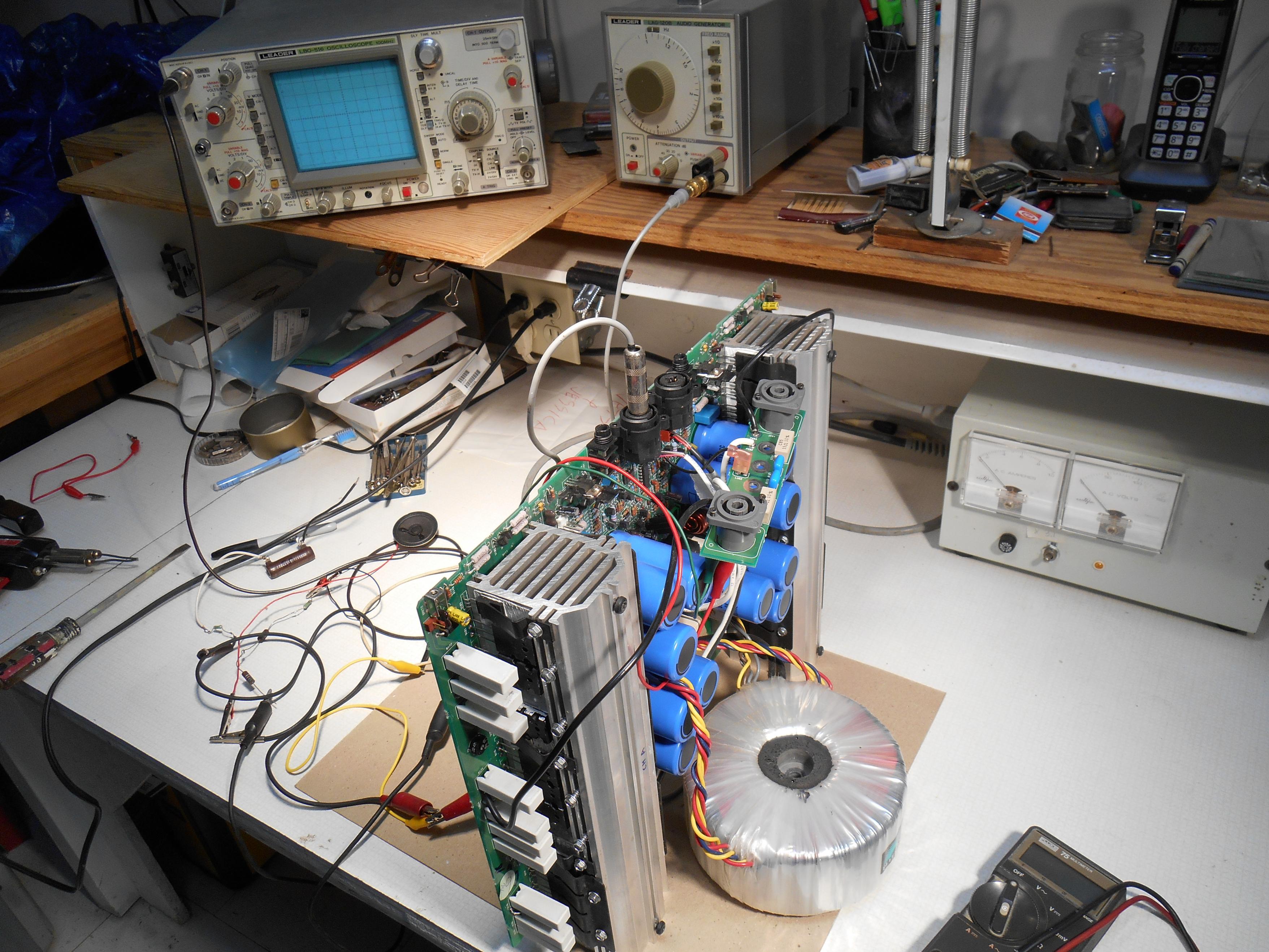

Well, the cheese gets binding;
Just for ships and giggles, I re-installed the 4 surviving outputs, leaving the dead shorted transistor out. I attempted powering up the amp. I could not get my variac above 25 volts, because the AC current meter installed on my variac, was full scale at 3.5 amps...and climbing slowly (could this be because of a negative temperature coefficient of the soft start thermisters?) No load was connected to either channel. When the toroid winding cable for the defective channel A, was disconnected, the amp powered up normally, and channel B came out of 'protect'. I 'diode tested' all devices on the heat sinks (including drivers), in circuit, at the start of all this and found only one shorted output. Is this an indication there are other problems, or must all devices be in circuit, in a class H design? The schematic is on page 2, entry #16.
I'm going to re-check all transistors on the heat sinks and check filter caps as per indianajo's entry #8. Apart from the cracked soft start resistors, I can see no other visual signs of damage in the amp. Crude trouble-shooting, but I left the variac at 25 volts, amplifier drawing 3.5 amps for about 30 seconds, I noticed both bridge rectifiers (high rail and low rail) getting very slightly warm, compared to the bridges in the still functioning channel B. I will of course check, but I'm guessing that it is not a cap problem if both high and low power supplies are experiencing a heavy current draw?
I'm getting ahead of myself, but in an attempt to get the front end of this this amp powered up, could I simply remove the driver transistors (Q 110, 111, 124, 125) and leave the outputs installed 'driver-less'? (assuming there are no other shorted outputs)
or should all devices (high and low rail, pos and neg, outputs and drivers, be removed).
I guess what I'm getting at is; where does one look for the cause of this current draw, if if the shorted output has already be removed?

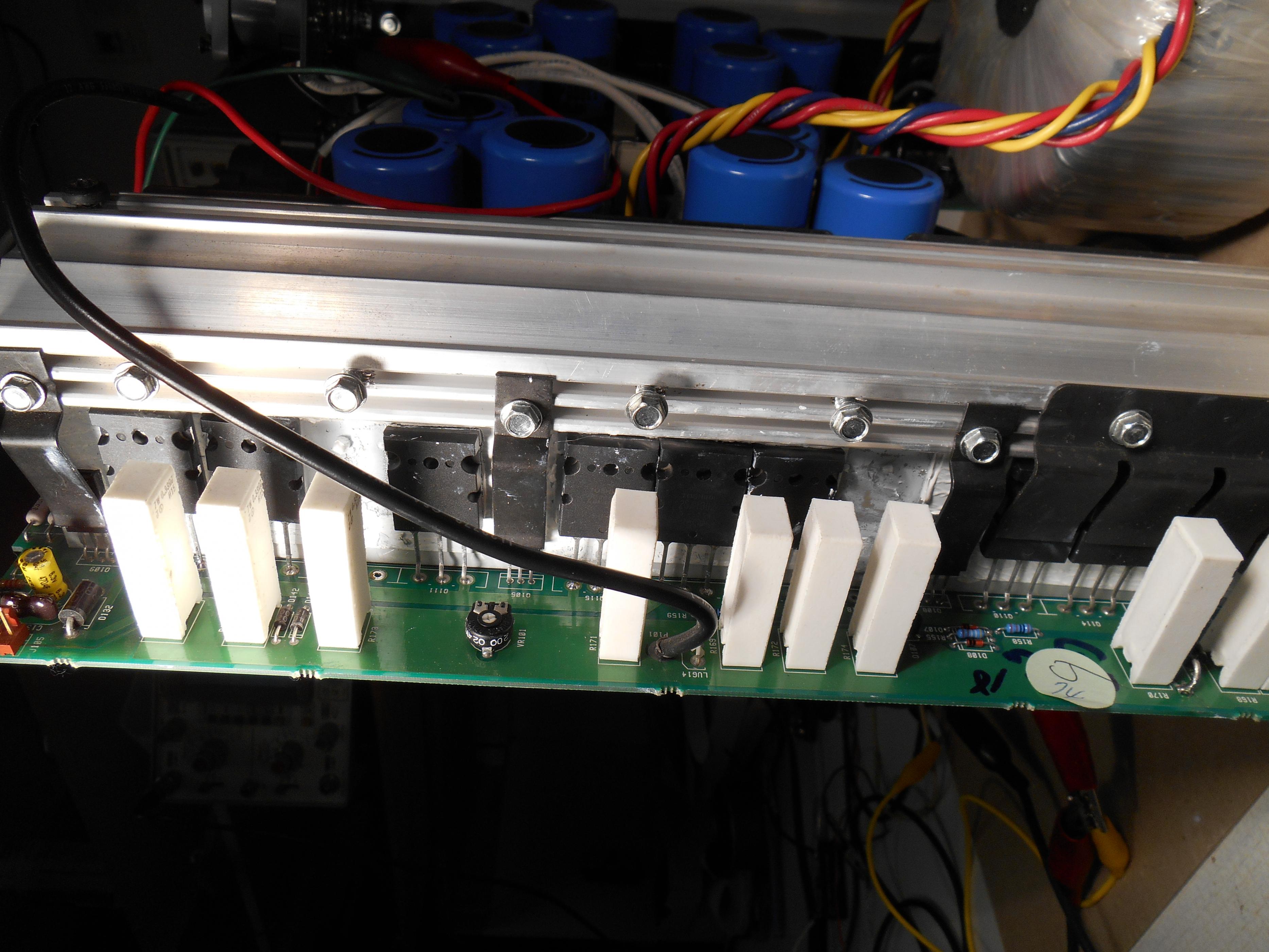

Hi Folks,
Sorry for the long delay, I am hoping to revive this thread! (and the amp). Thanks for the great idea; bypassing the soft start resistors and powering up the amp slowly/partially via variac.
I still have a burning question (no pun intended), regarding this experiment:
Can this amp be powered up with one output missing? (Q 117, low rail B- side)
I have checked every other device on the heat sink (in circuit, with Fluke meter) and find all indications identical to the functioning channel. I hesitate to perform this test, I suspect "something's gotta give", and it still may not be the source of the problem...just my uninformed opinion.

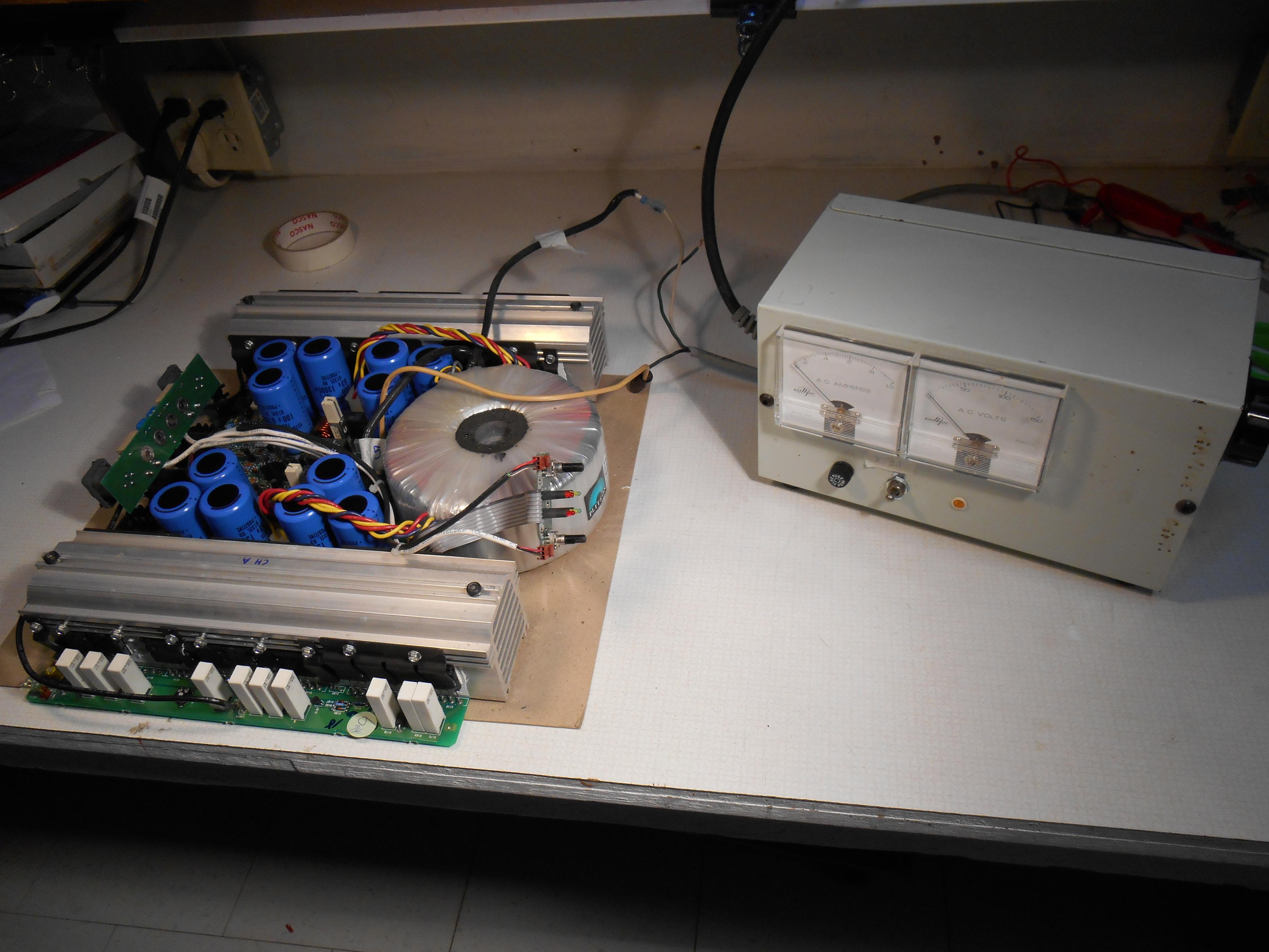

I FOUND A PULSE!
Thanks to anyone following this slow moving thread. I now have time (and renewed inspiration!) to attack this amp. The latest update; from advice here, I checked diodes associated with the output and found D 133 dead shorted. I don't understand the purpose of this diode, other than protection in the event of some device failure? It is rated at 3 Amp (400 V) and I can not imagine any condition in which it would be conducting.
I replaced this diode with a 3 Amp, 600 V diode and powered up the amp as Indianajo advised; Variac connected directly to the torroid primary, one output; Q117 left out.
Amazingly, the amp came alive! As I increased the variac, the protection relay clicked, there was no heavy line current drawn as I brought it all the way to 110 VAC. I had a signal generator on the input, scope and fluke meter on the output (watching for DC offset). I had no other load on the output. I saw a nice clean sine wave ( maybe 5 volts or so, 1 kHz) and was just about to jump for joy and then....a flash of light, a slight burning smell, and the amp 'flat-lined'!
The flash actually came from a tiny alligator clip, feeding AC to the torroid primary, although I did not see any high current on the amp-meter installed on my variac... I found another shorted output, this time on the POSITIVE side, but also low rail.
Not wanting to end the evening on a 'down note', I removed the blown output Q118 and again powered up the amp. Working again! I thought I would call it a day and consult with the experts!
So my question:
Why did another output transistor blow? and on the opposite rail?
Could it be because I ignored wg_ski's advice about running the same number of outputs on each rail? (in my defense, I did not see any DC offset, before the most recent device failure). Or could failure of devices on Neg rail, have stressed devices on the Pos rail?
In any case, I am looking at replacing all 5 outputs on both rails.

Now that the amp seems to have 'balanced itself' (equal number of devices on opposite rails), is there anything I should check before again driving this amp with a larger signal and, as suggested, a 100 Ohm load?
Thanks again, Peter in Canada.
Schematic with missing outputs and replaced diode attached;
....found D 133 dead shorted. I don't understand the purpose of this diode, other than protection in the event of some device failure? It is rated at 3 Amp (400 V) and I can not imagine any condition in which it would be conducting.....
Speakers and crossovers can be reactive, inductive. The amplifier current-limit can cut-off abruptly. When that happens is the same as the spark-coil in your car engine. Voltage kicks WAY up. These diodes catch the kick and limit it to just past the supply rail.
I do not know how it could fail except by extended abuse. Good find.
