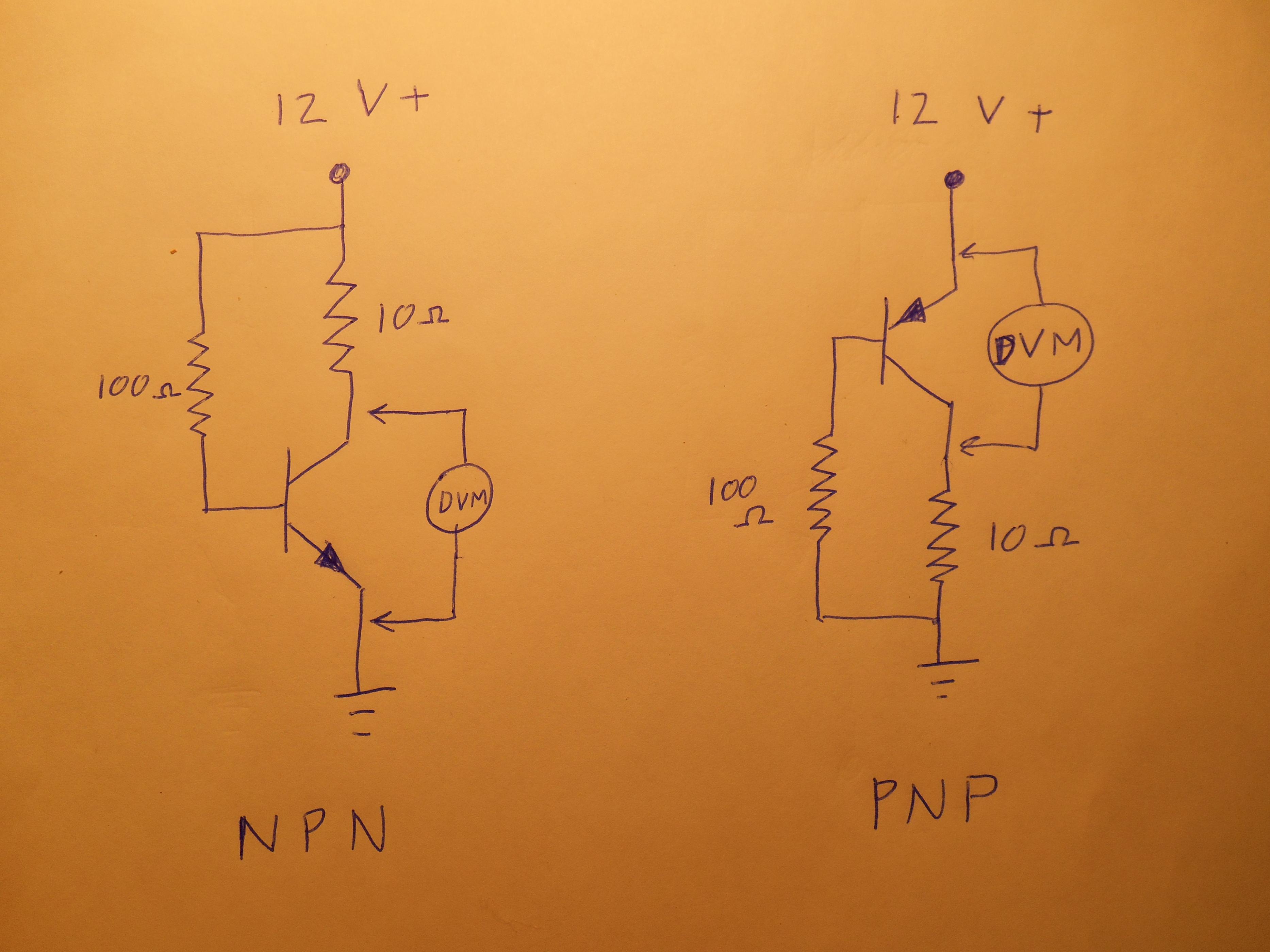

Hi Indianajo and all;
Before I even have all the PNP output trannies removed, I realize I will be in the transistor matching business! Attached is my interpretation of your test circuit. I have a lot of homework to do on the subject but I would like to use this thread as study in output matching, at the moment.
"The hfe is the ratio of the Ic/Ib. Its the current gain of the transistor"
I gather that we are comparing V ce, rather than the current gain?
Also, using the test rig below, how much Voltage variation would be allowed, to consider the transistors matched?

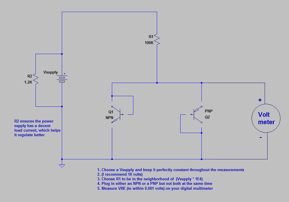

Match output transistor by vbe. Diode connect it, run a constant current thru it, measure vbe. Hfe match is less critical. Parts from the same lot are usually close enough, but you can get them closer - like 3 mv or less. Buy at least a rail at a time, sort by vbe and use the oddballs for drivers.

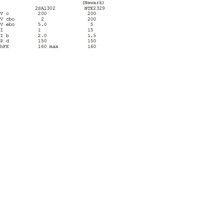

I am prepared to buy a dozen outputs, is this a reasonable batch size to find a matched set of 5? Besides the electrical characteristics, there may be a package size issue. The 2SA1302's case (TO-247) specs a width of 16.2 mm max. One suggested substitute is NTE2329, but the case width (TO3BL) specs max width as 20.57 mm.
I have measured my 2SA1302 devices at approx. 19 mm and it appears that a 20 mm device width may fit, (class H really fills up the heat sinks!) Could you elaborate or your 'diode connect' method. I will sketch a schematic from your description, and post it, thanks, Peter.

I had the transistors on a little heat sink when I tested Vce @ gain 10. I used clip leads & dangly resistors, though.Hi wg_ski;
Thanks again Indianajo;
Your test rig seems simple enough to construct. I suppose I will find out by trial and error, but, regarding the 5 second timing issue, with the 'DUT' on a heat sink, would the device reach an equilibrium temperature, that would reduce the need for timing?
I'm an experienced musician, so counting off 10 beats of 120 bpm is nothing to me. I marched a lot of football game halftime shows at 120 bpm in high school. 6 seconds or 4 seconds would be as valid, but it takes a few seconds to get your hands away from the clip leads and look at the meter. Just be consistent.
NTE meets the most basic of specs when matching transistors. If the original has Ft or Cbo or soa specs on their datasheet, look for those on NTE's. ? Central Semi is about as bad.
Read the sticky thread "my transistors real or fake" on parts forum before trying e-bay or ala-baba for obsolete parts. Rochester will sometimes sell you $100 of something recently obsolete, genuine close-out parts.

"Diode connect" means short collector to base. When you match by vbe when diode connected, you also get a loose match on hfe. Gross hfe mismatch will affect base current, which affect vbe.

My goal is to find a simple but 'universally' accepted method of output matching. My sketch in entry #31 shows the volt meter connected Emitter to Collector. I will retract this, as wg_ski's 'diode connection' method has been reiterated in other forums.
Here is a circuit which appeals to my simplistic nature. Not content to 'beat a dead horse', it must be completely 'fubar-ed'; R1 would allow a current of 0.1 mA, would it not be an idea to run the tests with this value, and again with an R1 that would allow a higher current ( 1 amp?)

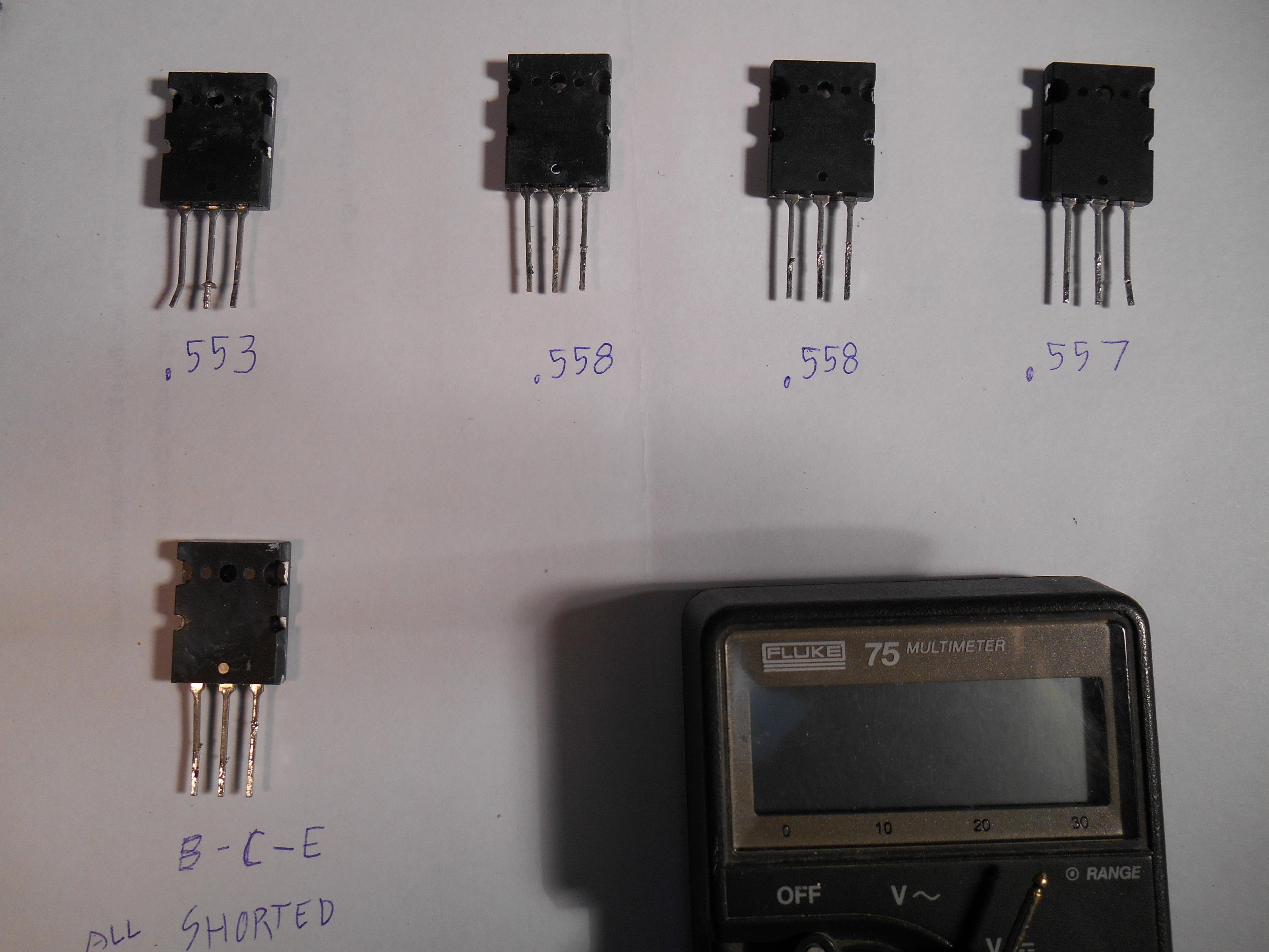

All five outputs of the PNP 'low rail' have been removed. I found only one device dead shorted E-B-C....Is this attributed to all the protection circuitry? When my Phase Linear 700's go 'fins up in the tank', there's usually 3 or 4 outputs shorted, and a smoking voice coil!
Agdr commented on my soon-to-be-vintage Fluke meter. It was just explained to me that the display reading in the diode-test mode may give some indication of matching. I suspect that this is far from sufficient and definitely not operating range current conditions, but what does it mean?
Here are my measurements with the fluke. I would appreciate all suggestions regarding the test set-up in the above entry (#39).
