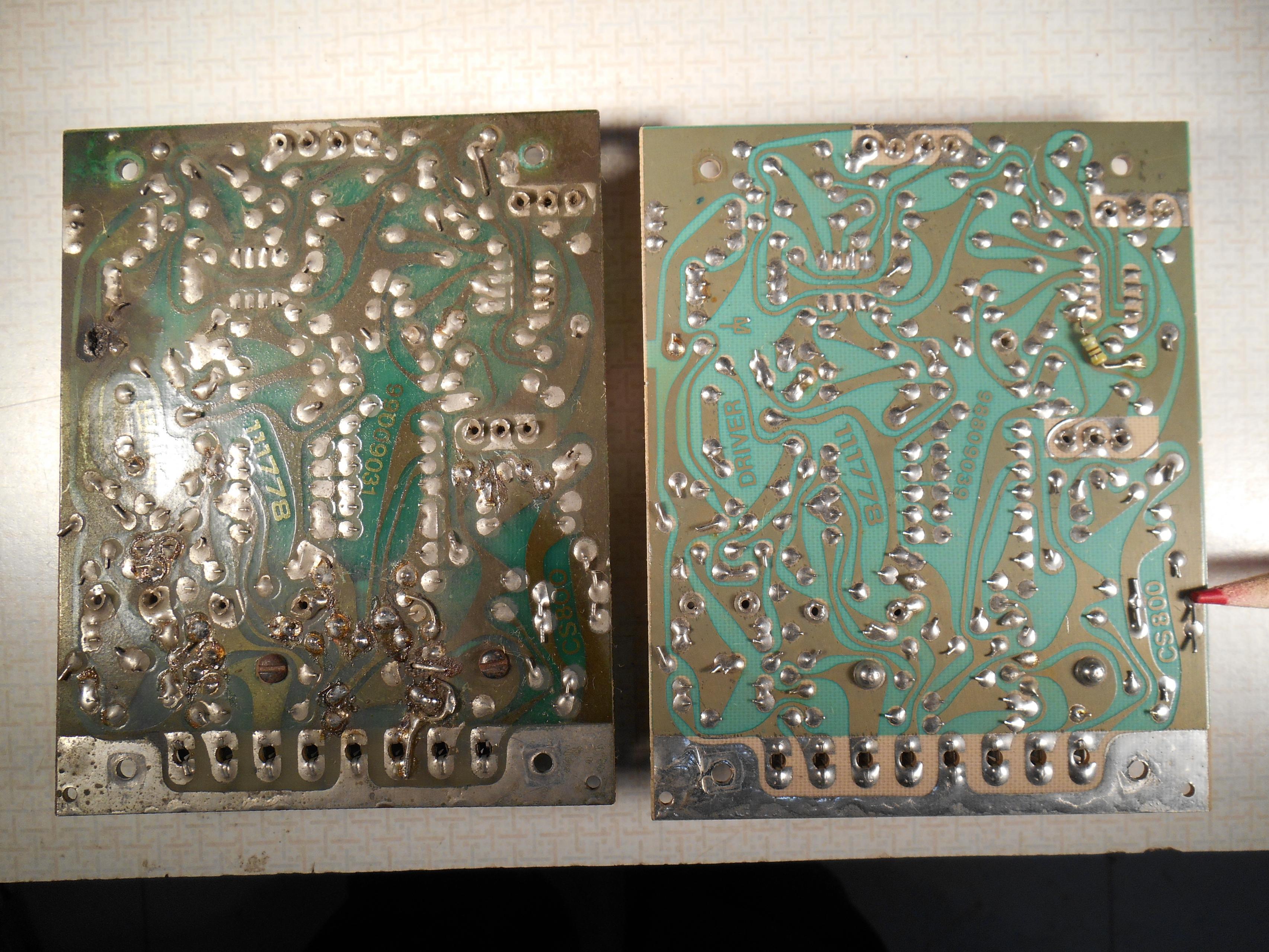

At the moment I am facing the mangled driver board. I have a working driver board from a CS 400. I believe the board is identical. Both are marked "111778 DRIVER CS 800"
Are these boards interchange-able even though B+ and B- are different?
Board on the right is from the CS 400:

You're on your own unless Enzo contributes. I never heard of CS-400 until I saw a junk one for parts on E-bay last week. Enzo posted on a CS-800 thread yesterday over on PA amps.

I compared every component on the driver boards from the CS 400 and CS 800. Everything is identical except for R 16 and R 18. After making the 'conversion', I installed the board from the CS 400 in the CS 800 amp. The weak socket for the TO 3 driver was bent to make secure contact, and some 'iffy' solder joints on the power pcb were touched up. The dead channel is ALIVE!

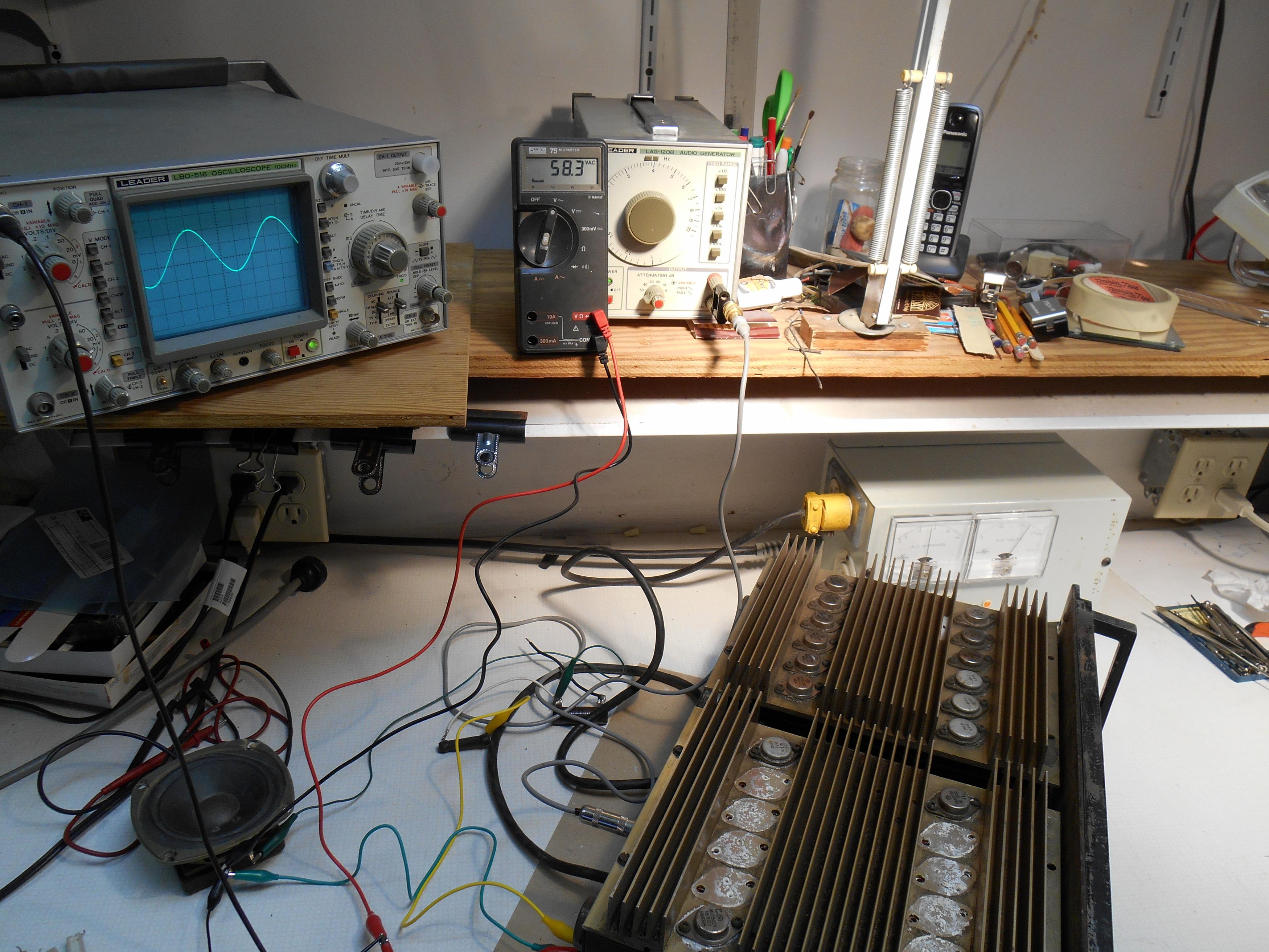

Thanks to the info contributed to this thread, I ran the amp with only the 2 drivers and 2 outputs installed, into a 130 Ohm load. 58.3 Volts RMS, before clipping, not bad, I guess!.

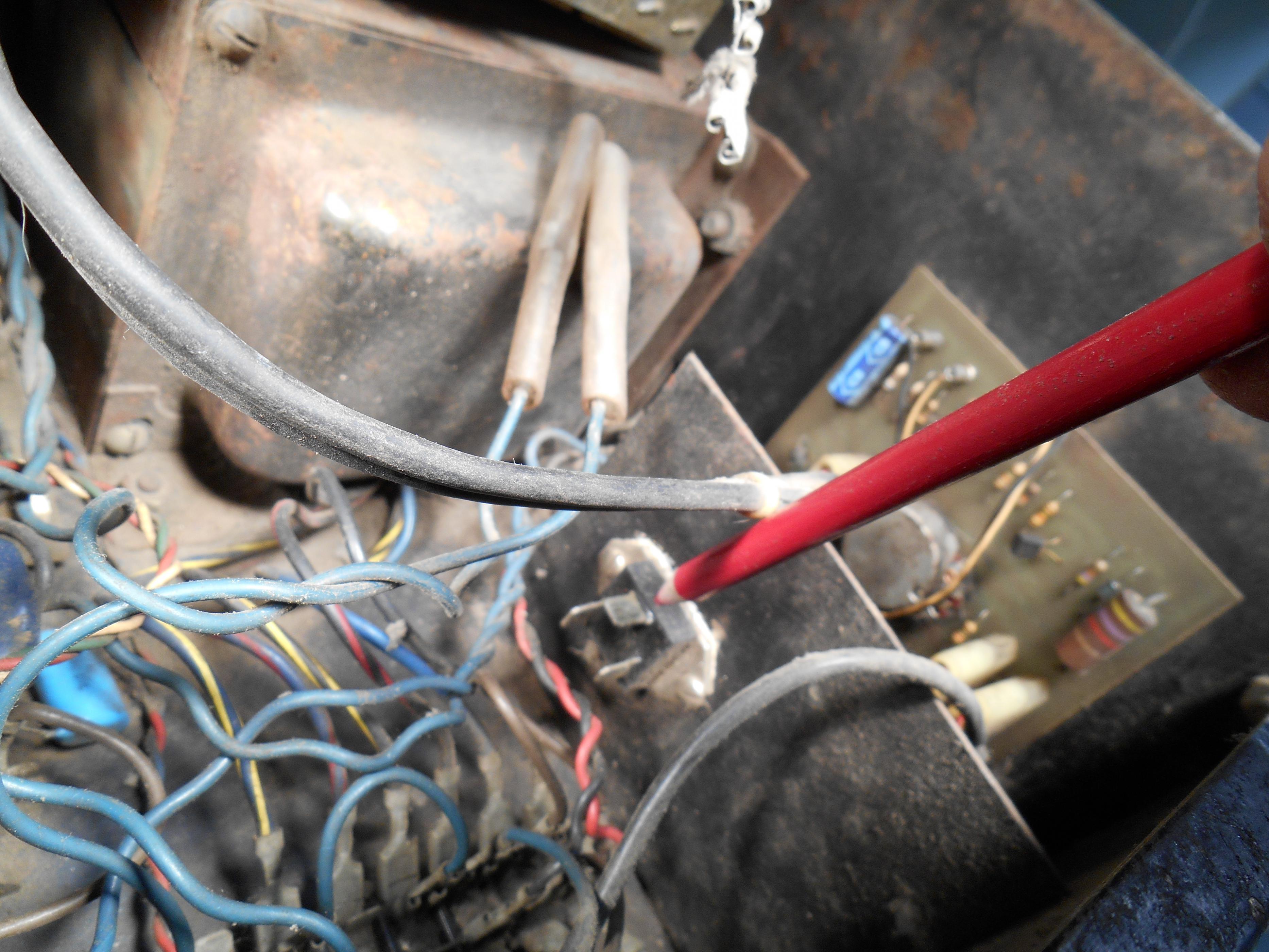

look at the incoming AC line that triac takes the current rather than the actual switch.
should be in line with the fuse,no?
or is that the one that is used for output "crowbar" protection
Hi Turk;
Thanks, I believe you are right, it must be the triac for the AC mains. I'm still not sure exactly what series this amp belongs to. It does not have switches on the volume pots, so I assumed it must be one of the first 'model A's.

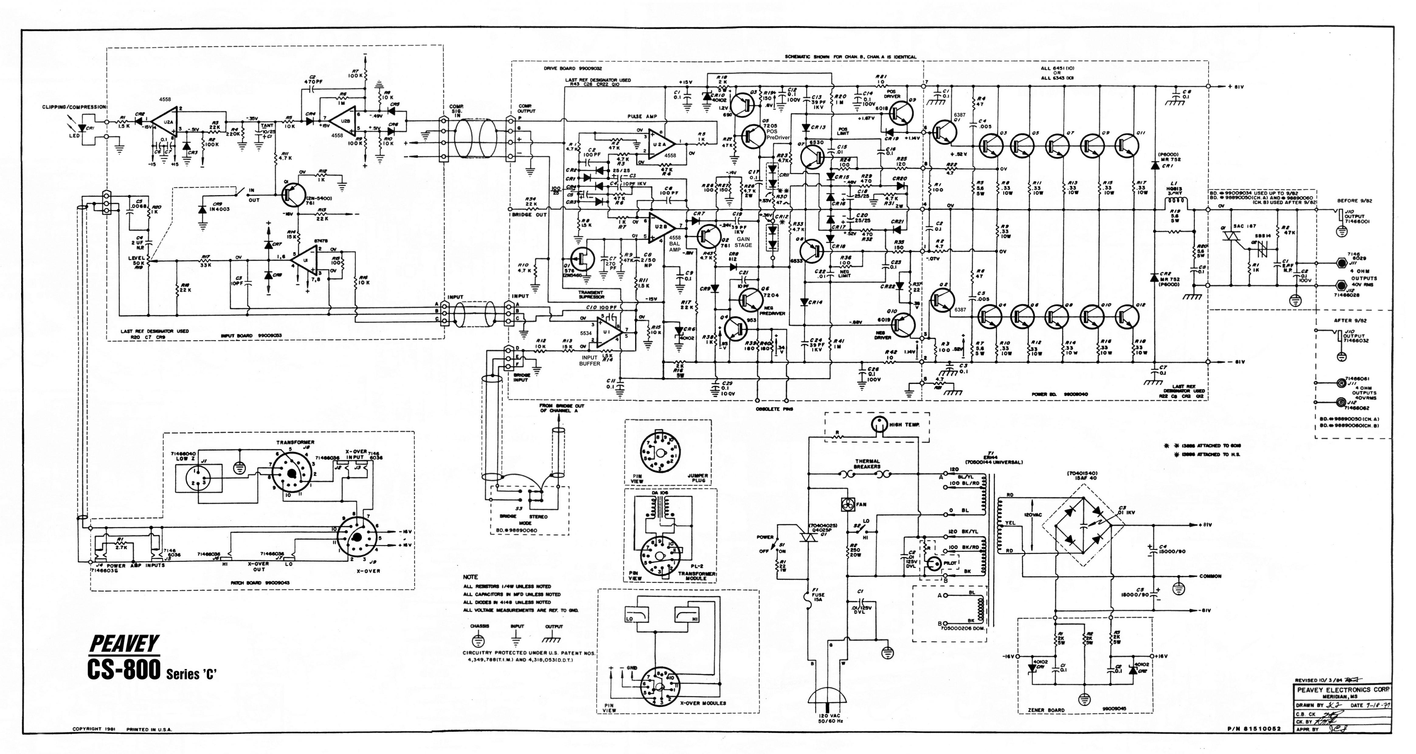

I have 2 schematics for the 'C' version; one shows a double pole power switch, the other has the triac.
The triac is been removed from the circuit. Is there any advantage to reconnecting the triac, other than extending the life of the power switch?

A replacement list would be a great help at this point. I have two conflicting Series A schematics; one shows all 12 devices the same on the heat sink, the other has different Drivers.

Congratulations on board swap success.
Yes, Peavey tended to back up the power switch with a triac so the actual copper contacts didn't take the huge turn on load. The location is where your picture showed. Not usually shown on schematics. Since my PV-1.3k dimmed the room lights at turn on, I put a 1.5 ohm 20 A capable NTC resistor in series with the AC line in- a technology that was not available that long ago.
If you're just doing a few output transistors, MJ15024/25 is a "match". If you're replacing them all, MJ21193/4 or MJ21195/6 is cheaper and allegedly has bigger soa and a smaller silicon die. Enzo told me this was okay for all at once. How rugged do you want? Does the bigger die result in less blow ups? My advice, ditch the 1/4 phone jacks and go with dual banana jacks or Nutrix; you may not blow as many output transistors as the previous owner. Setting up in the dark on stage and getting the 1/4 phone plug all the way in was a serious challenge for bar band roadies (unpaid usually).
As far as different transistors for drivers, the late amps like the CS800s have a magnificant slew rate spec - 20 v/microsec if I remember right (brochure is on the other computer). Cs800s also use a MJ15020/21 TO3 driver instead of a MJ15024/25 like the early models. The 15020/21 has much higher Ft than the 15024/25 but is not as rugged at high currents. Slew rate was IMHO not spec'd on the old CS800 no suffix.

Here is an update; I can't believe that one channel still pumped out 330 Watts into 8 Ohms! A day after taking this apart, I still had a craving for a smoke!

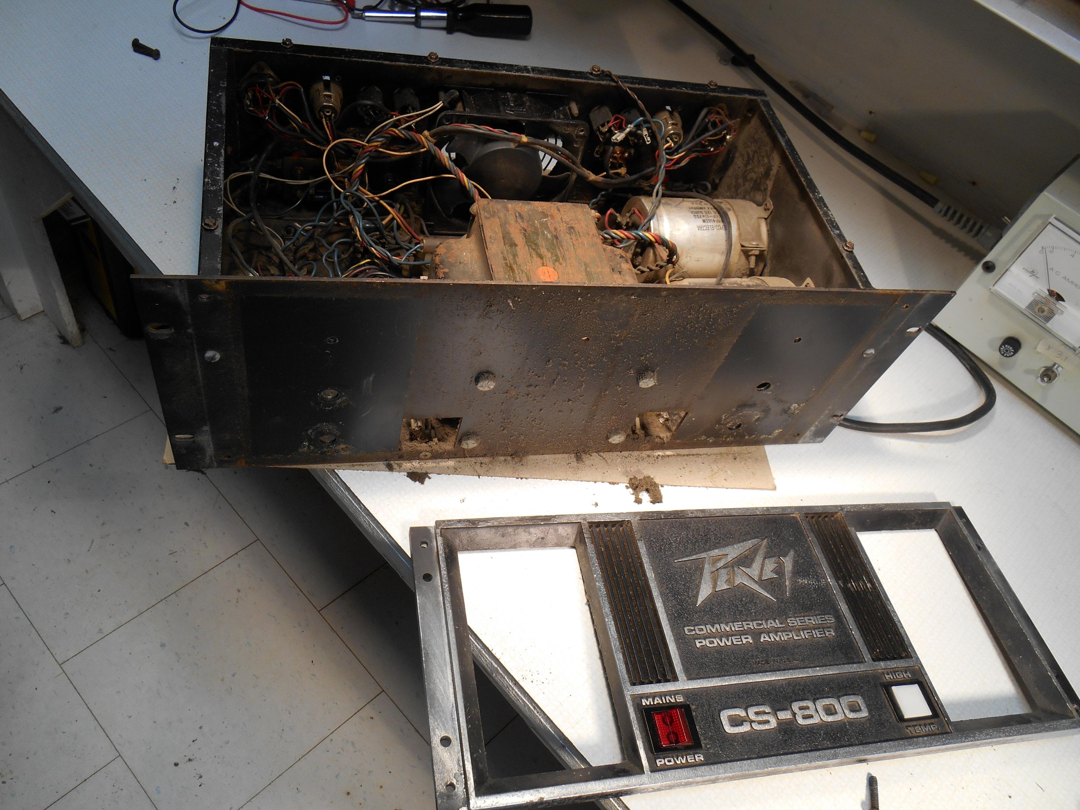

Hi Folks;
About to drag the CS-800 outside to blow out some of the nicotine and coal dust! In the mean time, I am still struggling with selecting the best replacement driver and output devices.
