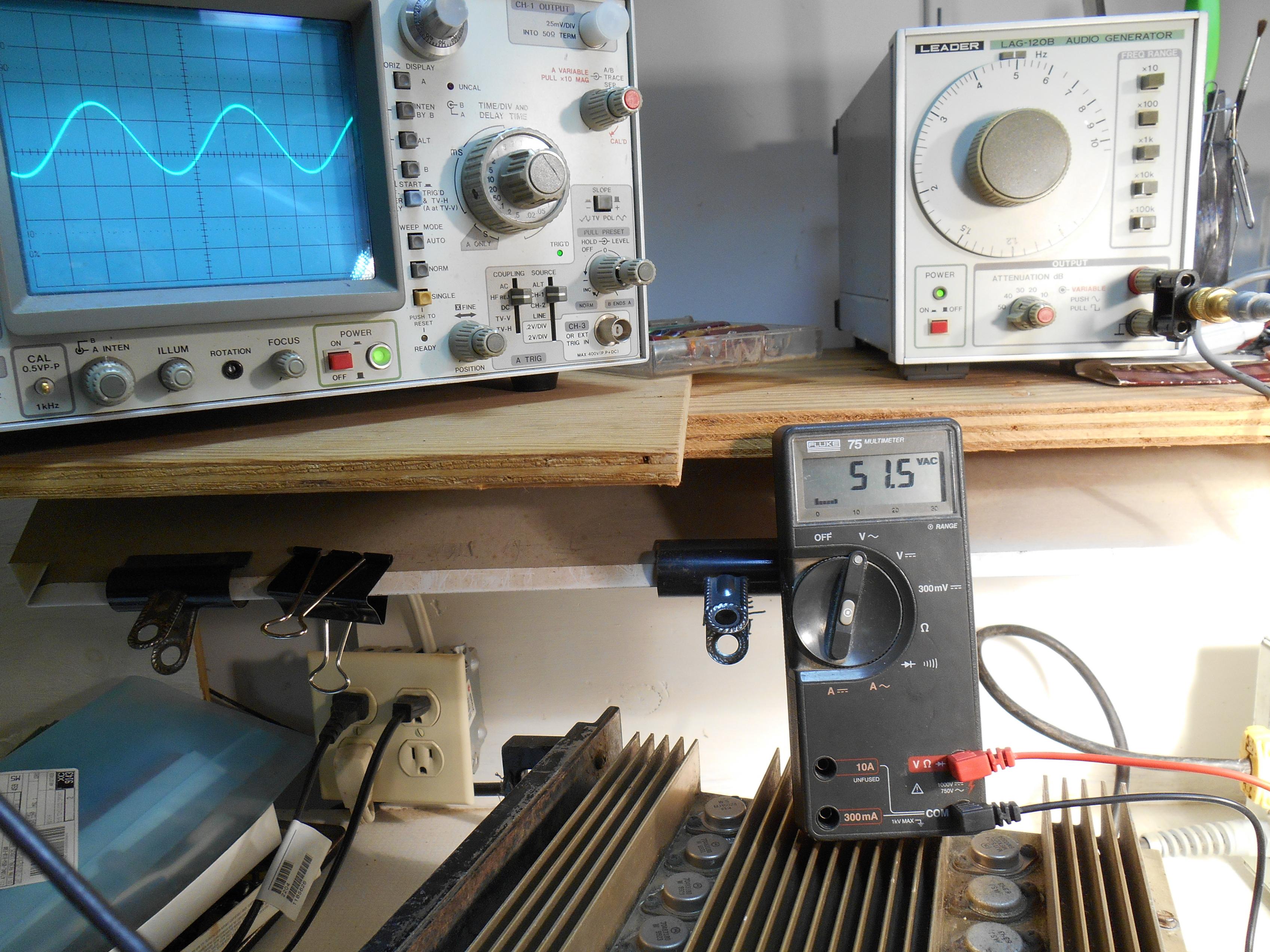

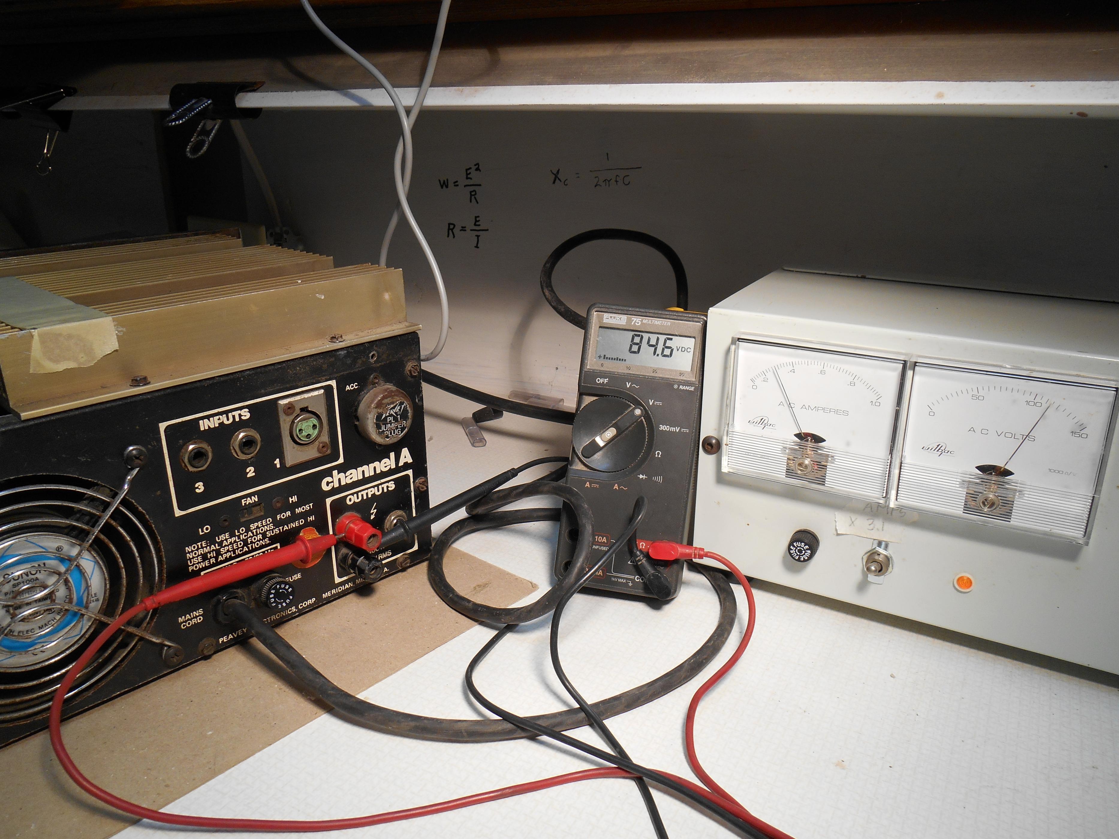

So the CS800 has been powered up; 84 Volts DC on chan A, chan B working; 51.5 Volts across the 8 Ohm dummy load. Not bad! 331 Watts. This thing is as old as the hills, and still exceeding specs by a healthy margin.
My intention is to try to get chan A functioning. From what I have learned, I can remove the shorted devices and (fire) it up with an equal number of good devices on the B+ and B- rails.
I will have check the amp pcb, I have heard some scary stories of smoked pcb circuit paths and Triac protection circuit, which at this point is still a mystery. Hope to report back asap, have to go shovel the drive way, and want to do it while things still look optimistic!

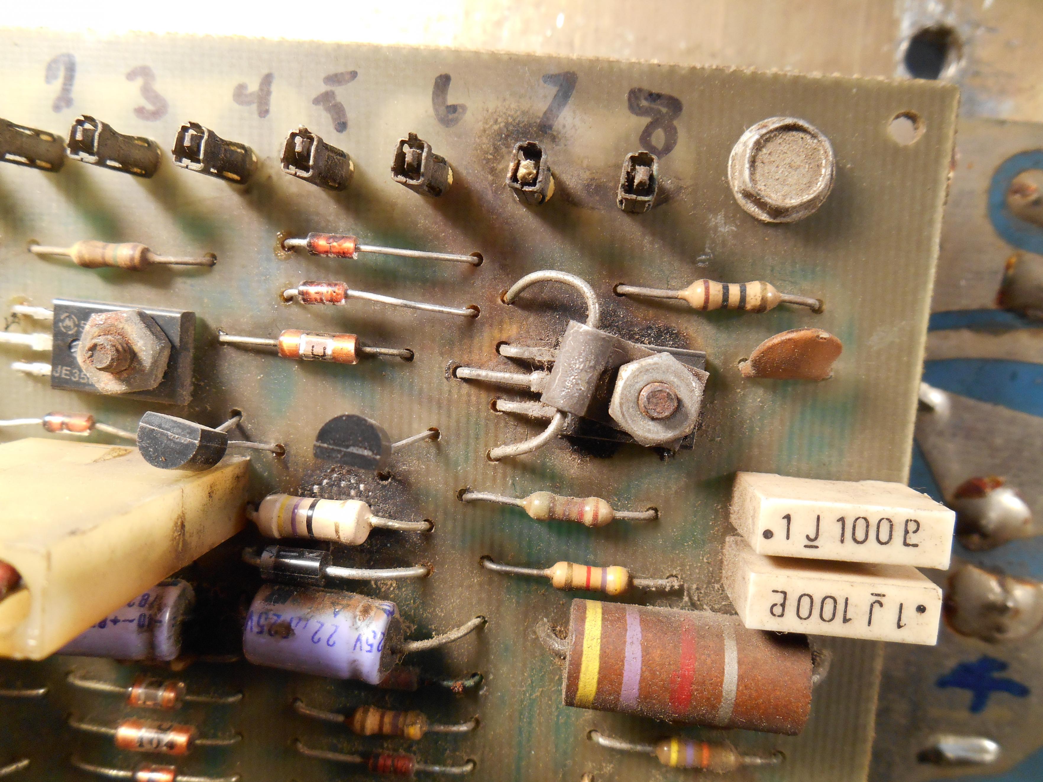

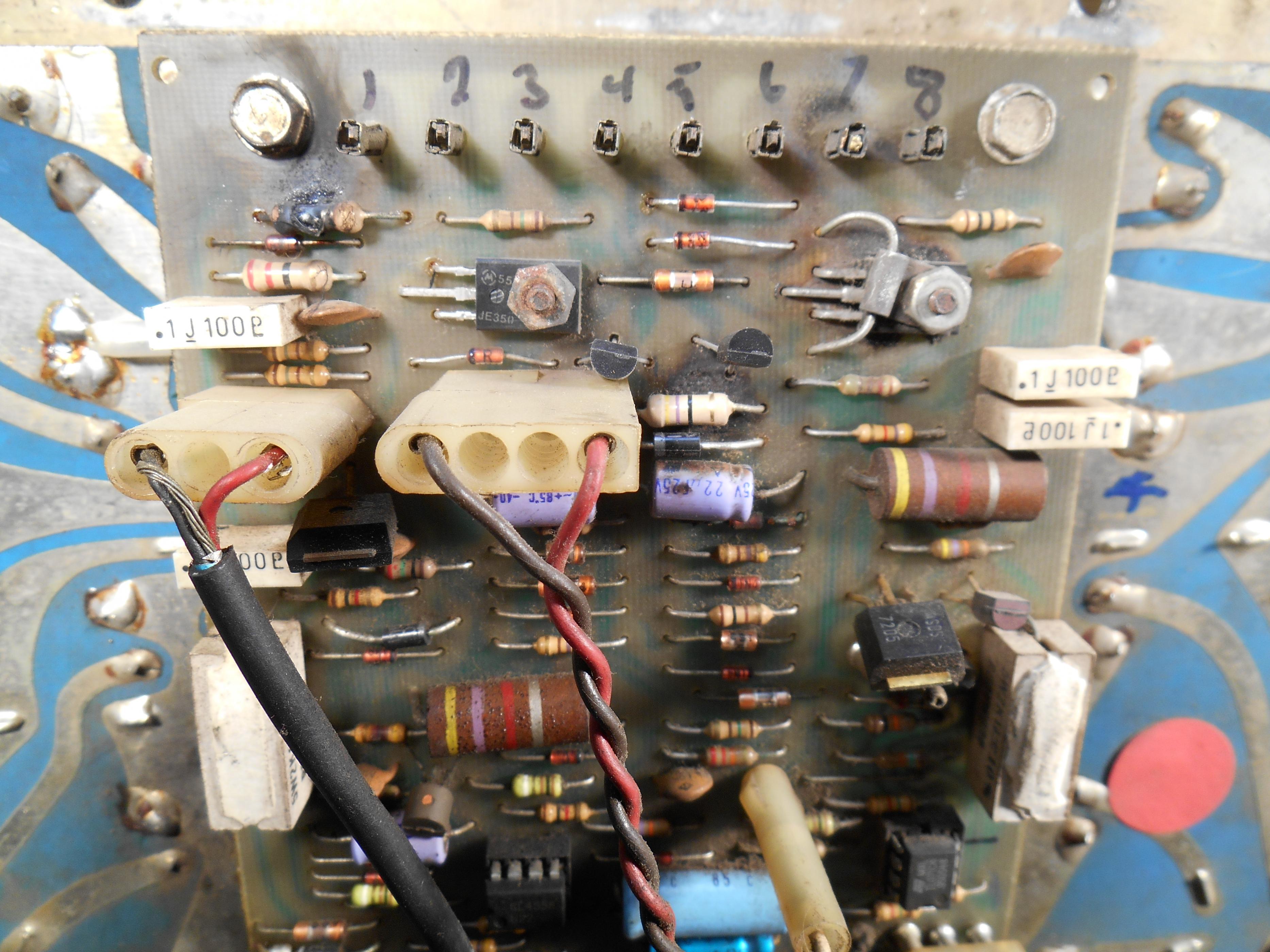

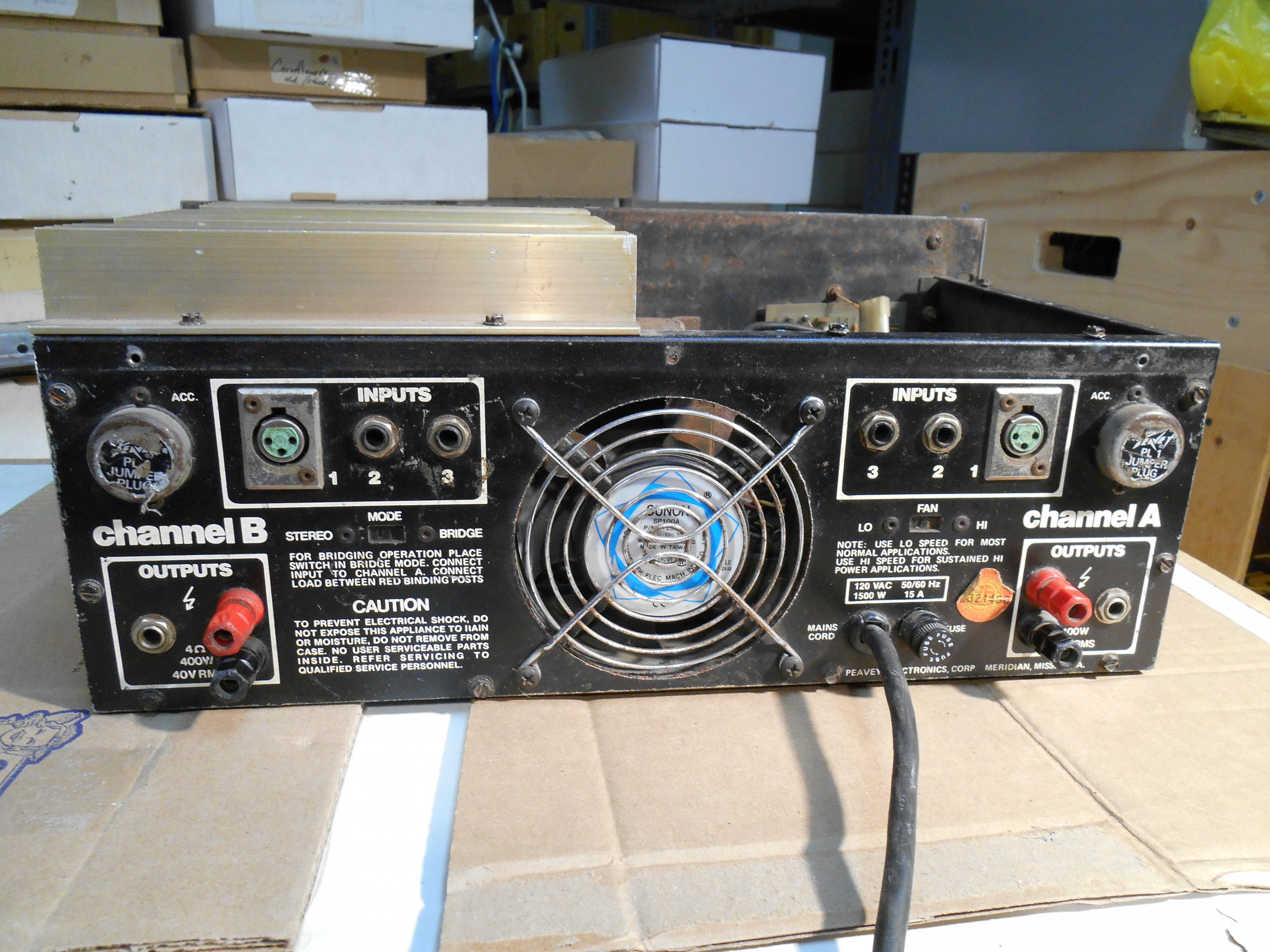

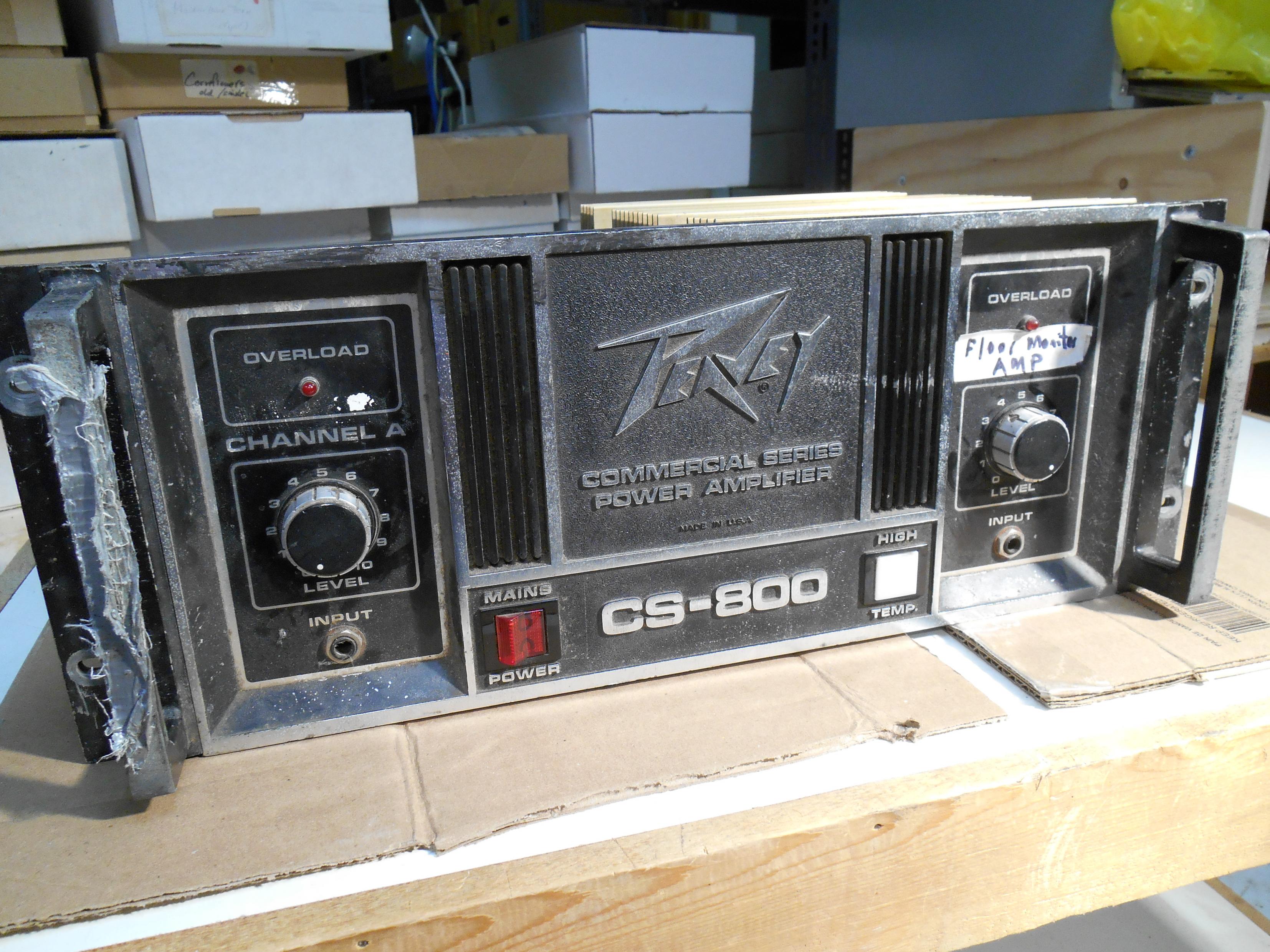

This CS 800 has had a tough life! (probably like most of them) Multiple repairs, some bulging electrolytics, toasted transistor (are they pre-drivers?), and it looks to me like bad connections at the feed-through prongs. And that is just the visible trouble.

This is the clearest version of the schematic for what seems to be my amp. The components are not labeled R1, C2, etc on the (series A) schematics that I have seen so far. It looks like most of the trouble is on the driver board, I am using a component layout (image) from a series "C", at this point, hoping that they are similar.

So far, there has to be at least five reasons why this channel won't work. In removing the TO3's from the heat sink, I found the emitter pin socket to be opened or bent, to almost twice the pin diameter.

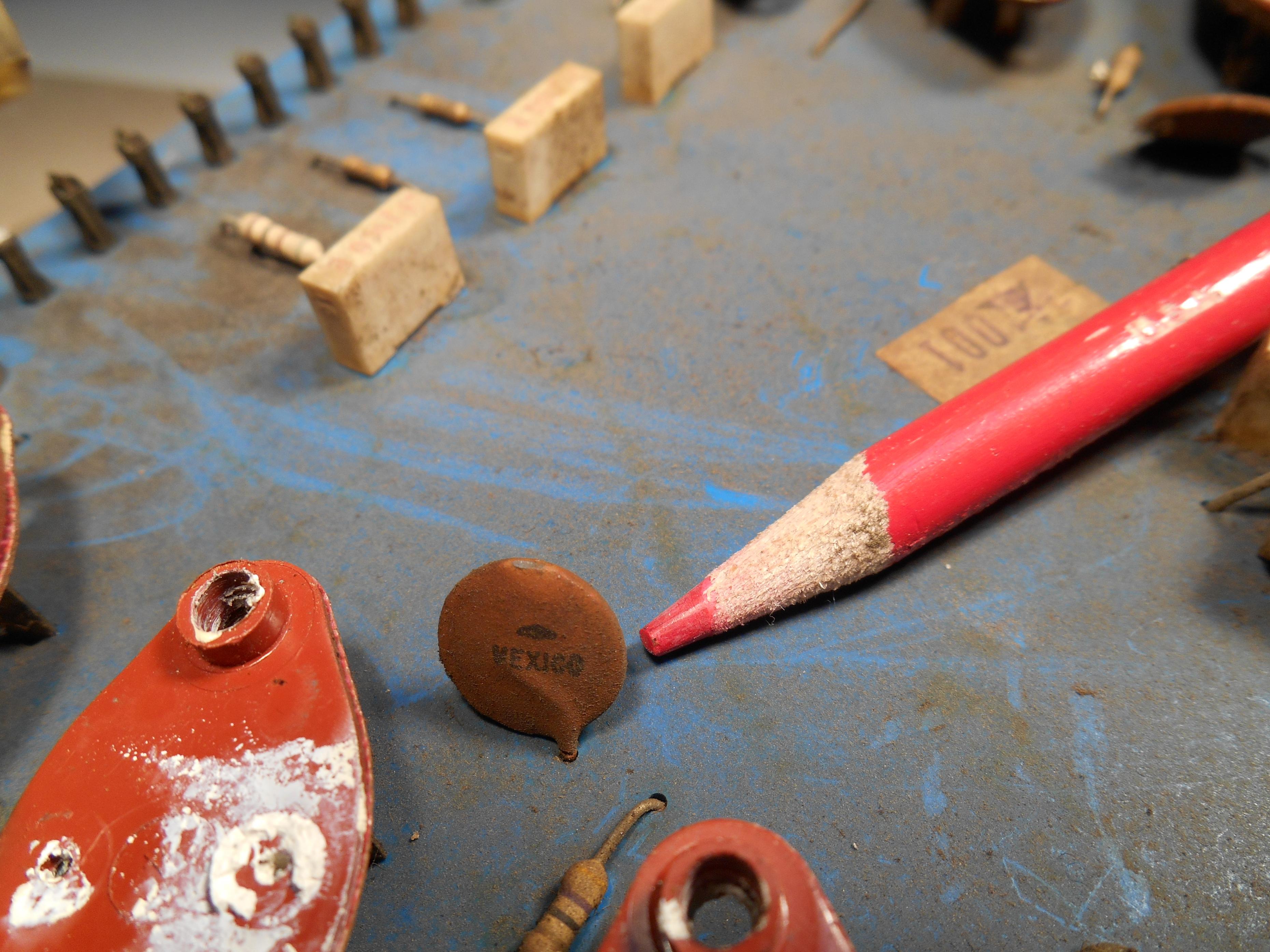

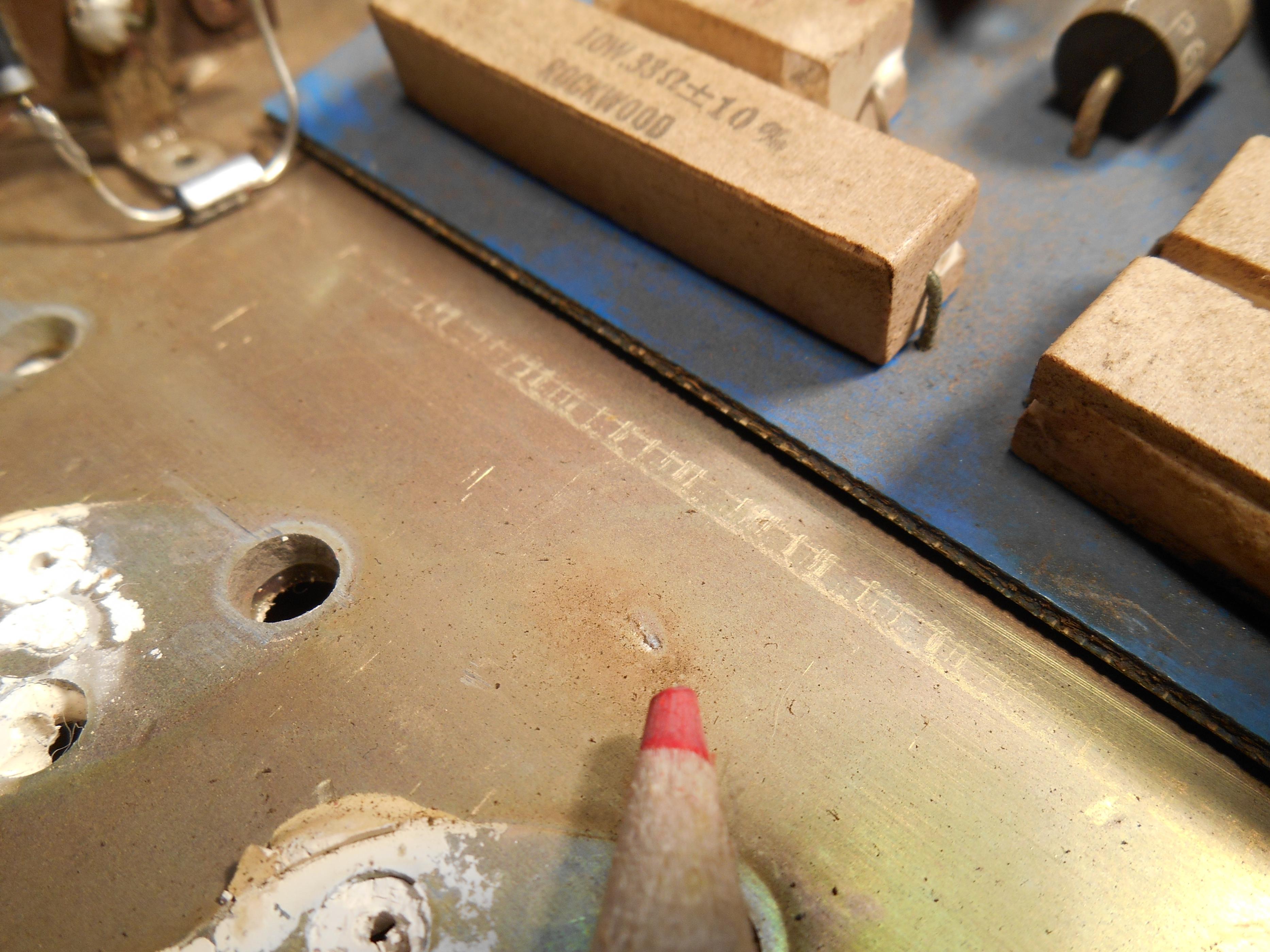

A ceramic disc capacitor on the (power) pcb appears to have made electrical contact with the heat sink;

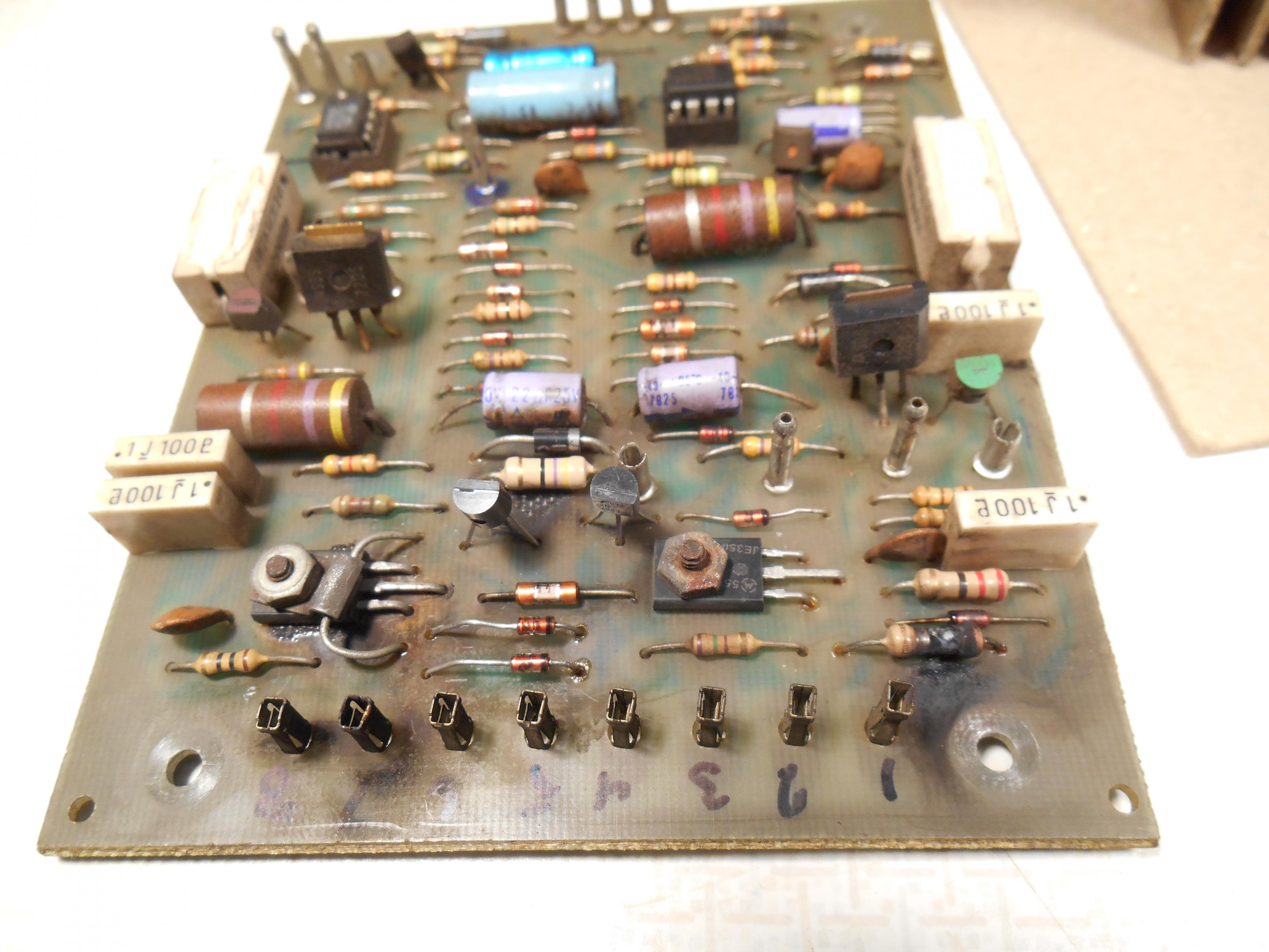

There is some 'sustantial' damage to the driver board. There was 80 something volts on the output terminal, but the TO3 drivers and all outputs checked OK by Fluke meter diode test.

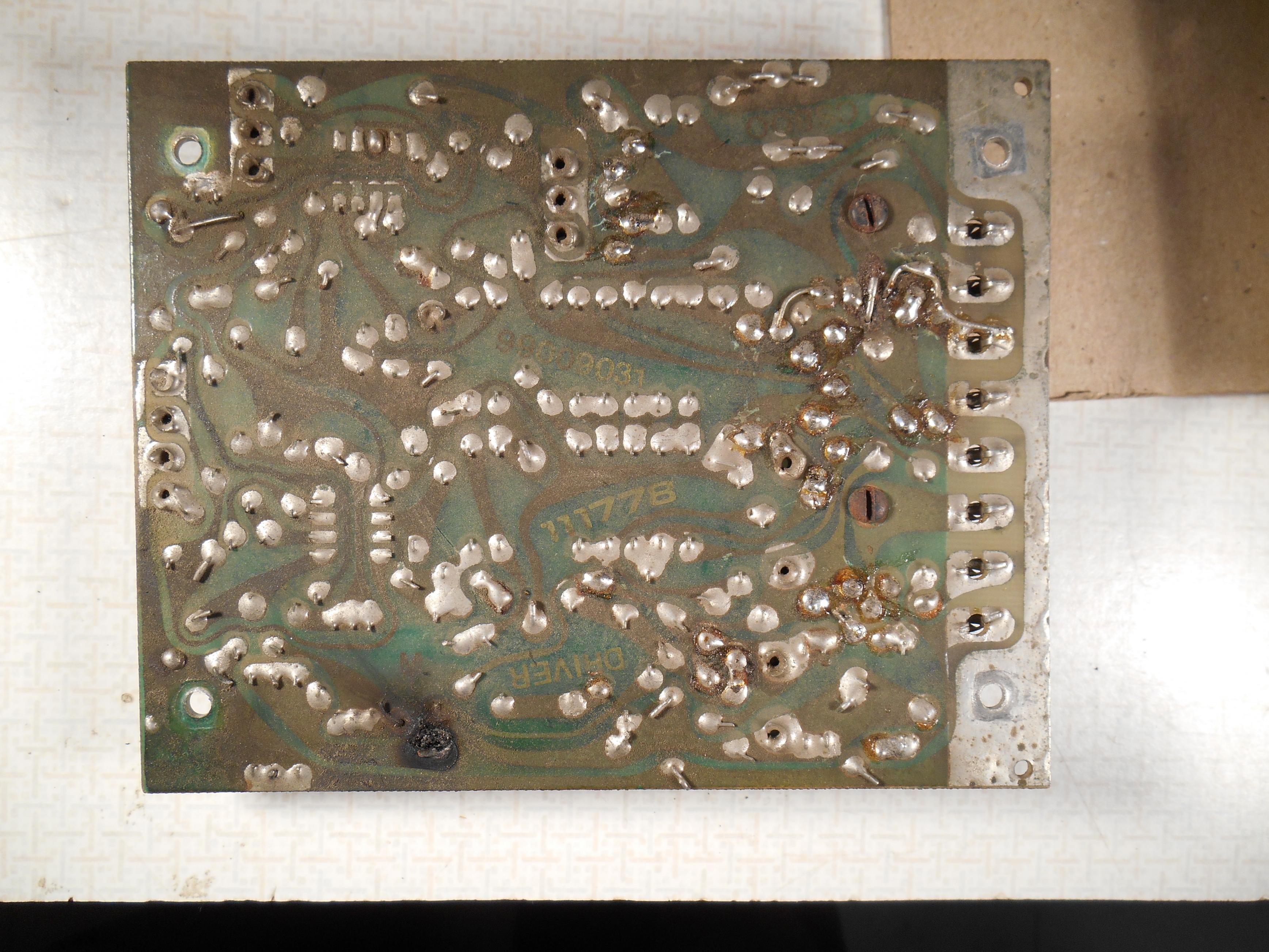

Very Clean!---In the mean time, here's the under side of the driver pcb;
PS: this driver board looks identical to the CS 400 driver pcb (except that B+ and B- are 59 Volts, rather than 81. Are they interchange-able? I have also inherited two dead CS 400's.

Uh, 2v test doesn't screen out over stressed transistors. Use a 12 v power supply or something similar, put in series with a 10k or 47k resistor. Try Vceo ie base disconnected. Current should be low one or 2 digit microamps; if you have nearly 250 microa with the 47k resistor your transistor leaks. I use a car battery charger followed by a filter cap. Plus to collector on npn, to emitter on pnp. I use alligator clip leads, which were cheap at radio shack but newark is now getting $7 for each one. I think Oreilly's auto supply is getting about $4 for two alligator clip leads from Dorman. Dorman ones not rated for 600 v of course.
