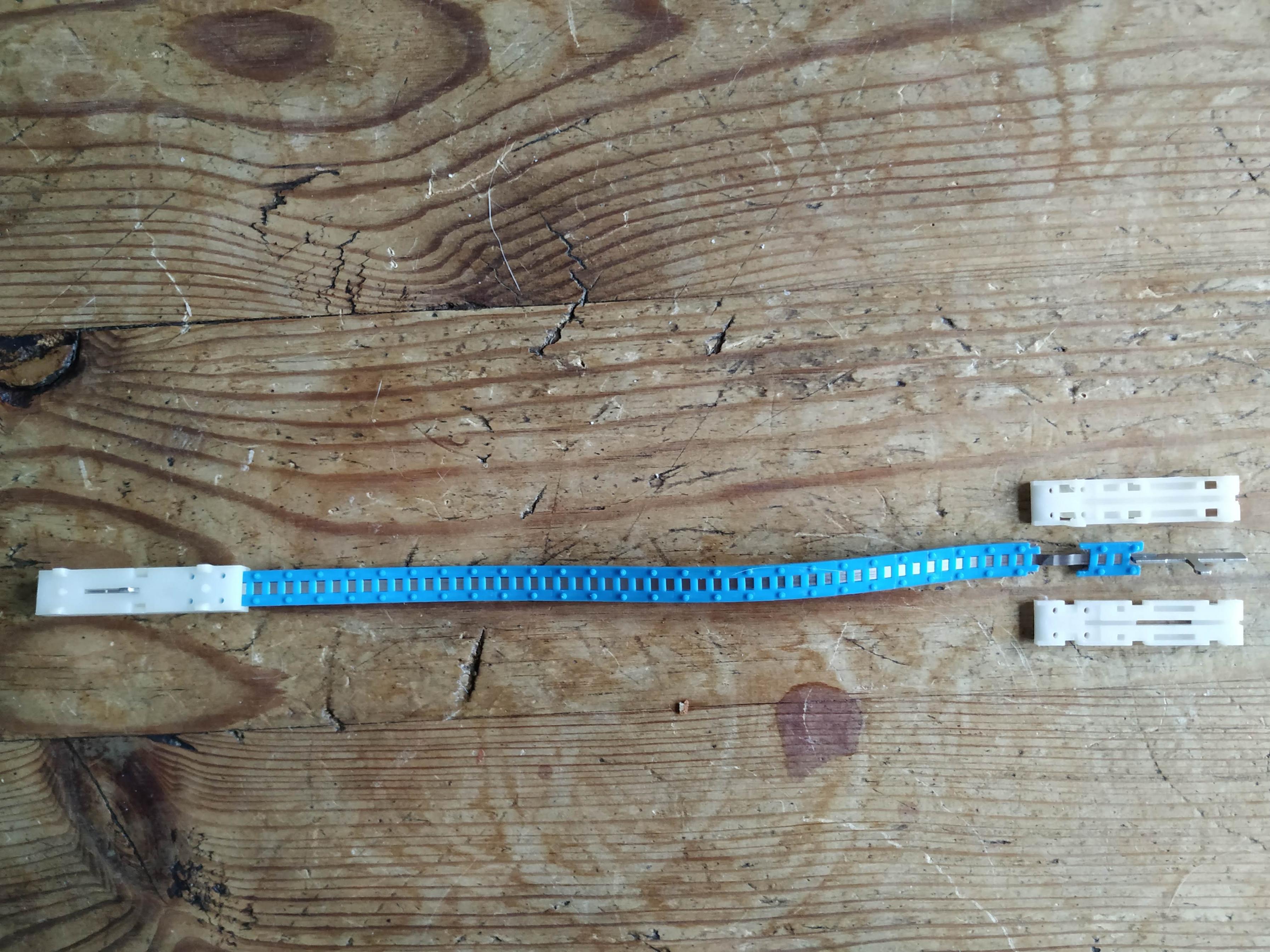

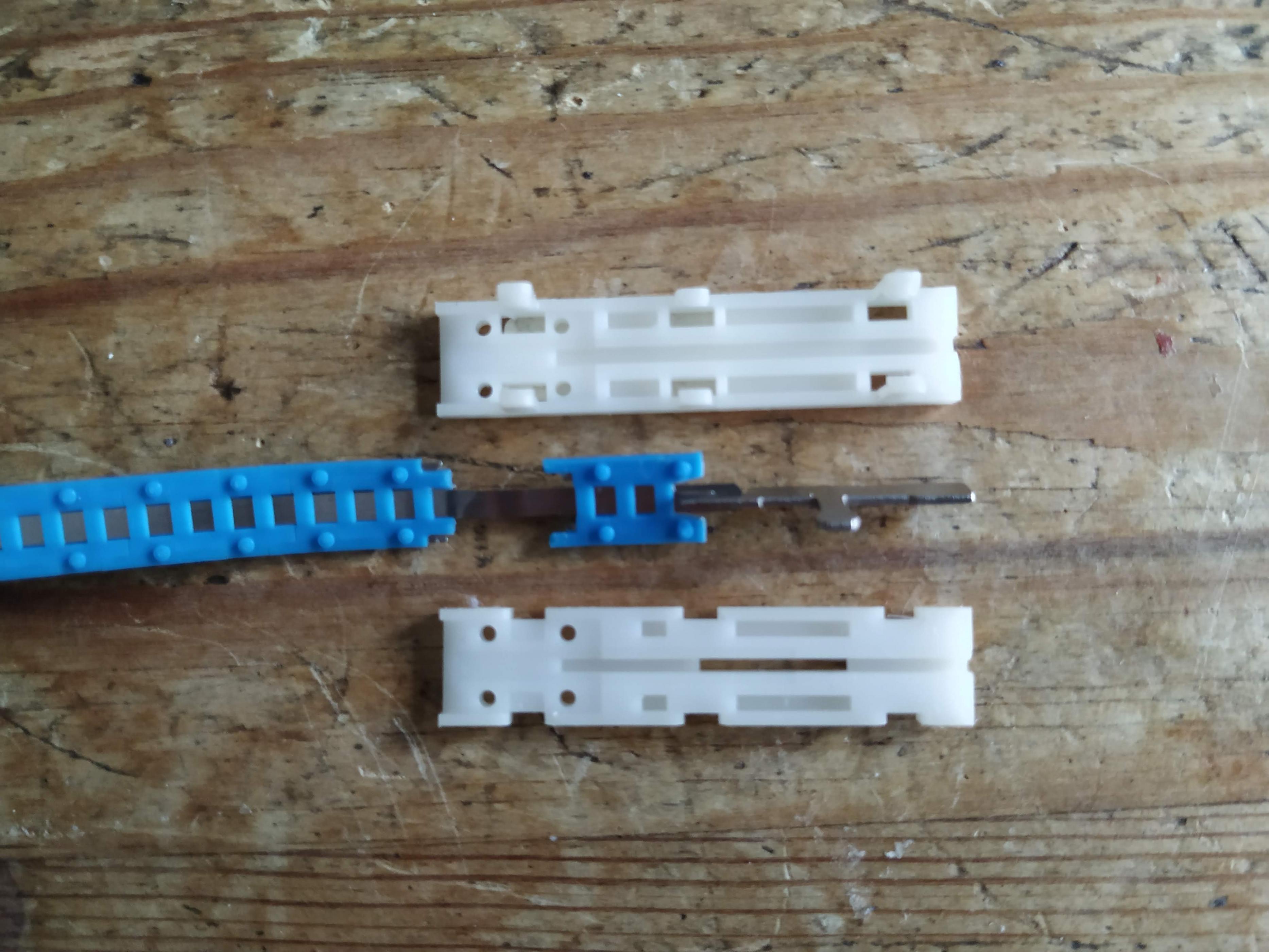

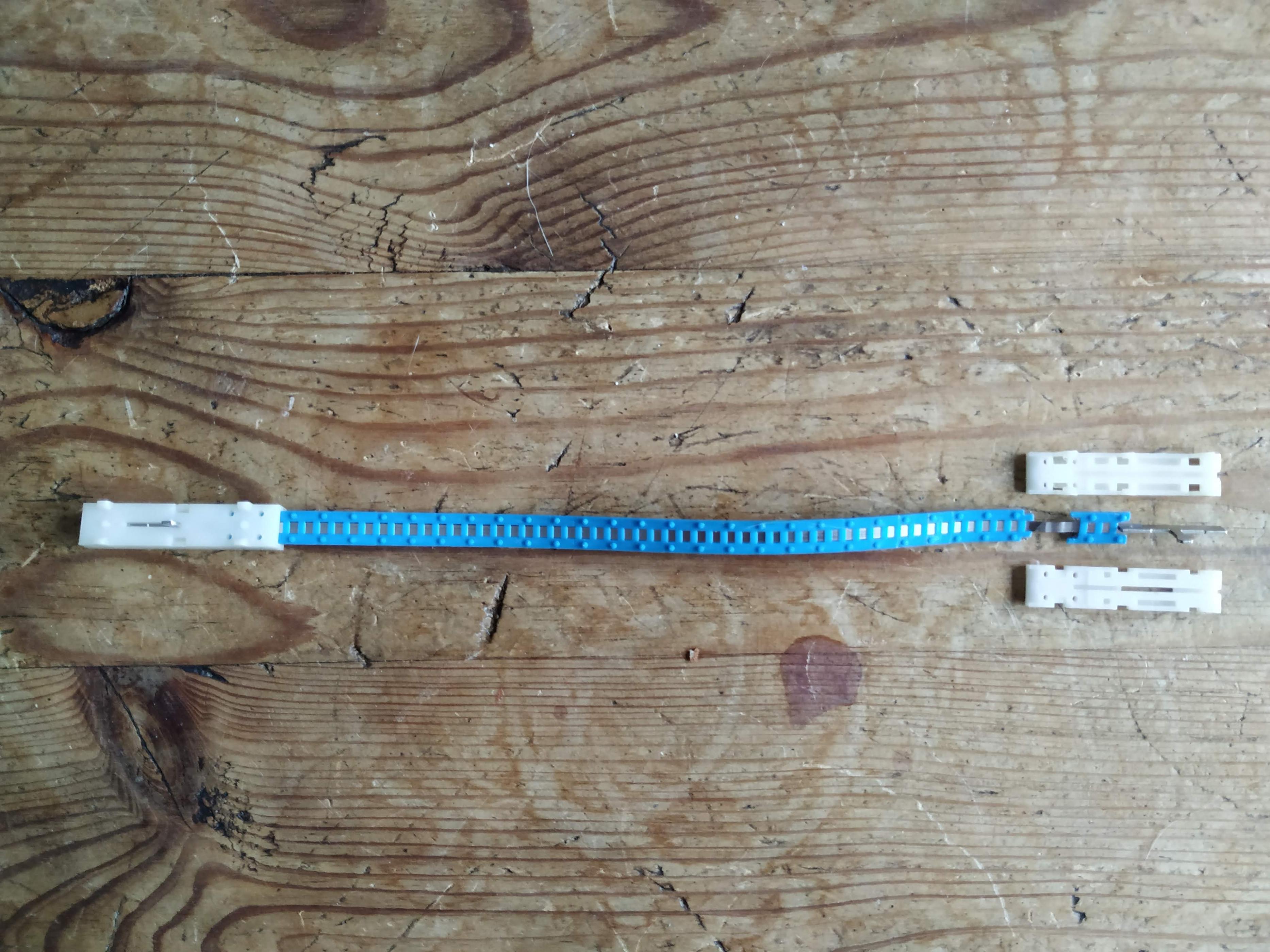

Yesterday I received the Perreaux SM3 preamp from eBay and unfortunately the ALPS flex unit - 4 positions, 225mm long cable (sticker 509Y) is broken. I have been looking on the internet to find a replacement, but without success. Does anyone know where to get one or how to fix it?
