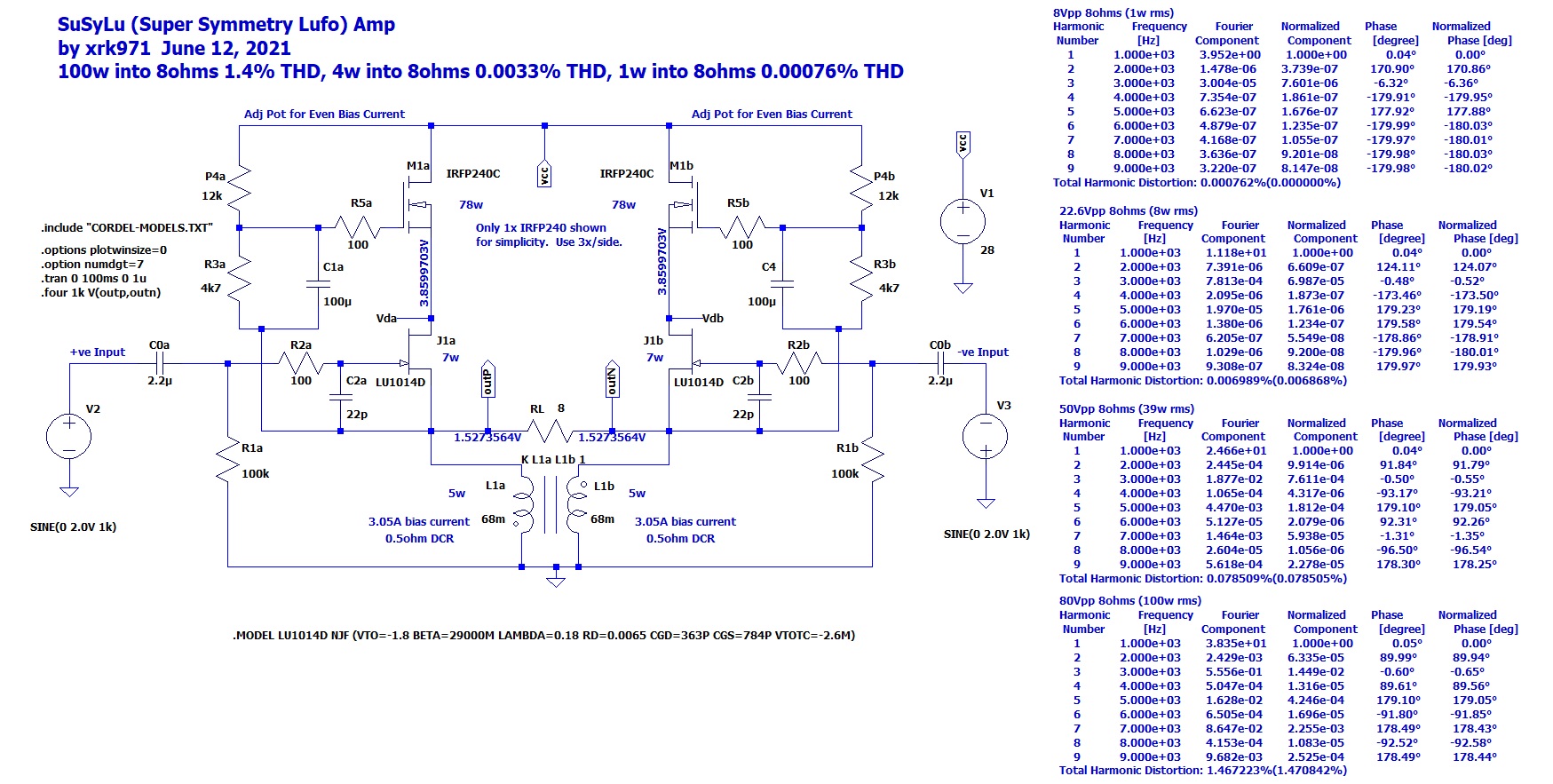

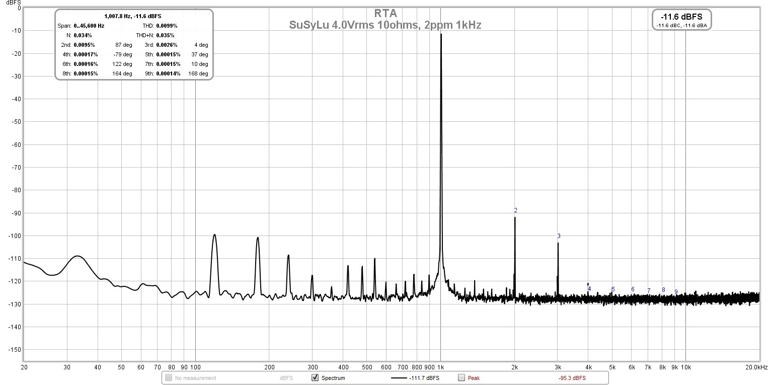

I understand how to make bridged amps on single supply with no cap outputs. I have designed and built the SuSyLu - a 100w choke loaded SE Class A amp with balanced DC coupled output.
https://www.diyaudio.com/community/attachments/01ad7340-7c7a-4e0c-a763-d20e93961d64-jpeg.987583/
Very simple topology:
It sounds great - perhaps one of the best sounding amps I have heard.
I am just saying, for smaller simple amps, 100w with a SMPS single rail supply can make a great sounding amp. I have lots of great reviews on one of my commercial amps that uses this approach.
@jjasniew, even though my Susyamp is bridged, it still has a nice harmonic profile that is not odd order dominant like PP amps. Here is the FFT:
