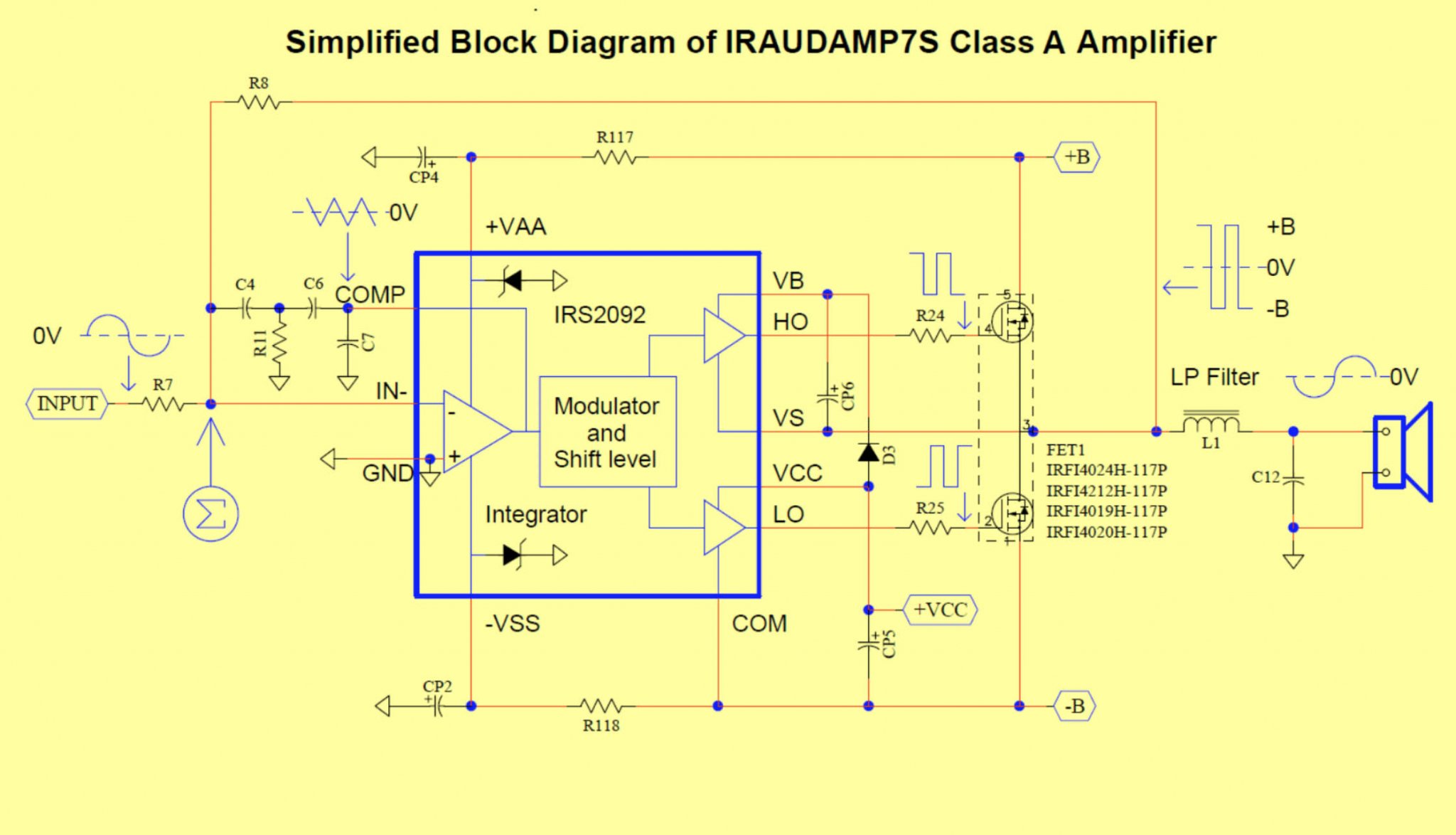

Class D amplifier is not digital. It use PWM but also use negative feedback.
Distortion only can not tell how good the amplifier. At least you should measure IM distortion.

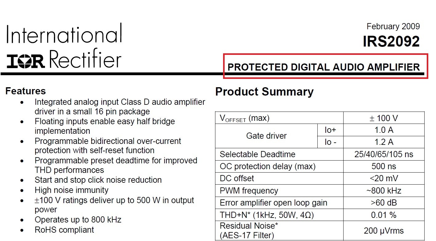

Infineon’s claim to the “digital” Class D amp?
“The MA12070 features an embedded digital power management scheme. The power management algorithm dynamically adjusts switching frequency and modulation to optimize power loss and EMI across the output power range.”
PWM is a digital signal. It is not an analog signal.

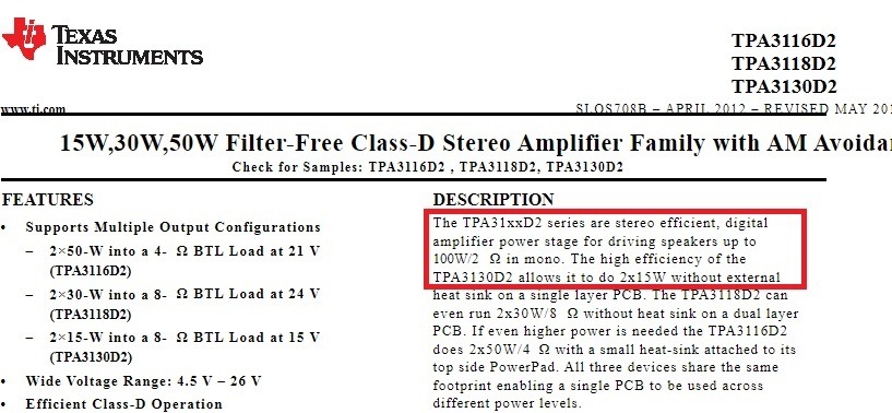

Then you may need to give it to all class D amplifier chip manufacturers.
Tell them that class D is not a digital amplifier.
Including Infineon, Texas Instruments.‘

You know LJM, it is one thing to understand the need for marketing to people who are not as educated as you and think that if it is digital it must be great.
But people like you who are educated in these things should not fall for that and understand that PWM is clearly an analog process.
Don't embarras yourself.

If you have measured DAC. For example, the digital signal of 192K DAC.
You will find that it has the same shape as class D.
Infineon and Texas Instruments also think so.

Manufacturers datasheets use fashionable marketing terms in calling their amplifiers digital. They perfectly understand that class-D is not, by definition, digital. You should as well.
If you believe the opposite, could you explain where is Digital to Analog Convertor in every class-D amplifier.
It doesn't matter what any documents indicate. The only thing digital is a digital file, everything else is analog, taking the shape of some variant square wave, or otherwise. In other words for any measurable/viewable signal there is no discontinuity in time or amplitude for a wave shape to be considered a digital representation. Taken the other way, an analog signal undergoing a A/D conversion is converted to a digital representation without time or amplitude variance. Looking like a square wave doesn't conclude a signal to be digital. Nothing physical can go from one amplitude to another in zero time. Physical waveforms cannot be described in absolute digital terms.

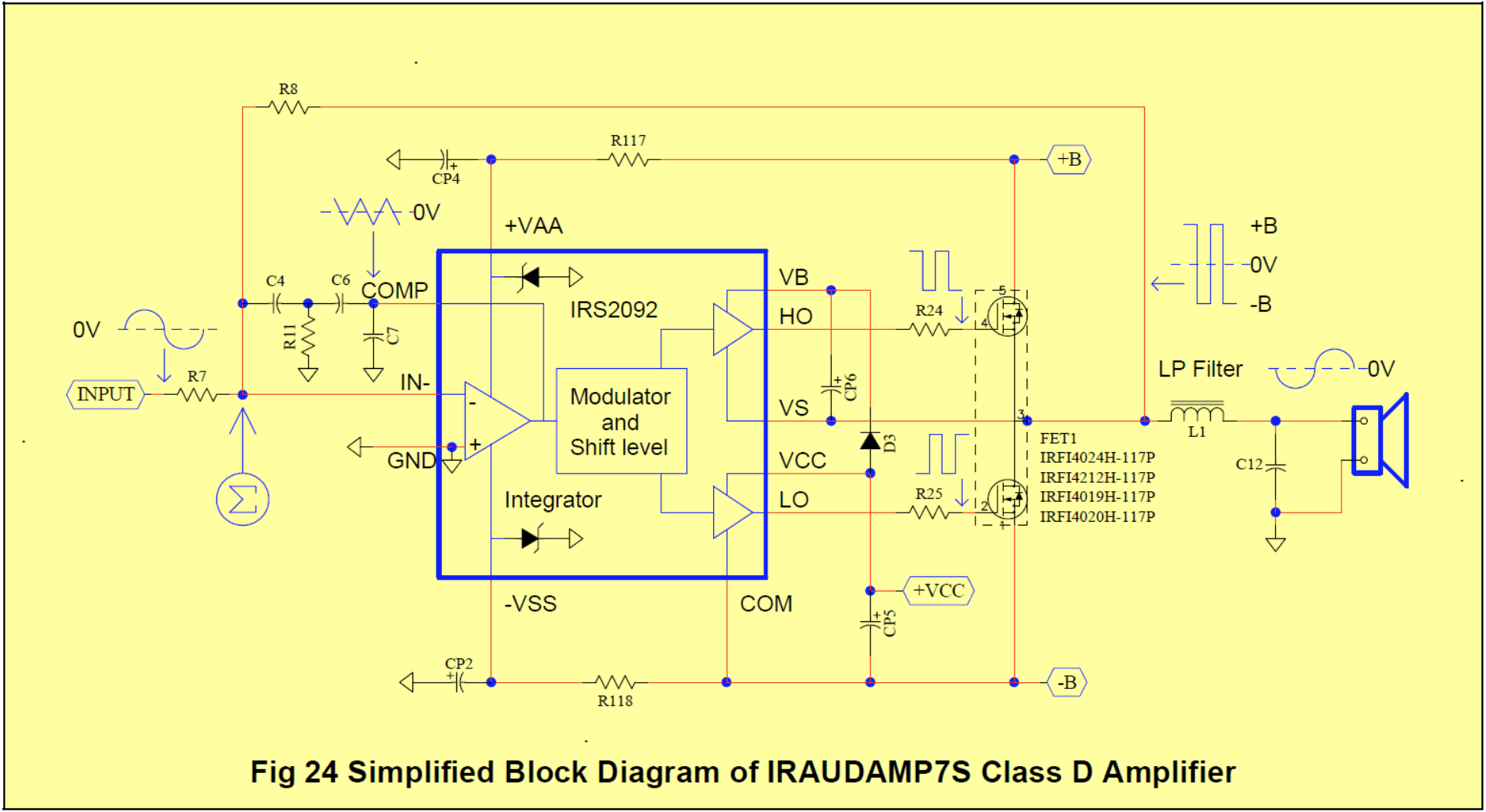

Any one-bit DAC realizes the analog multiplication of the input PWM signal (quantized amplitude, continuous time) with its analog reference voltage.
A class D output stage realizes the analog multiplication of the input PWM signal with the power supply voltage (continuous time and amplitude, ie. analog).
People who forget this make "digital amplifiers" which are really one bit DACs drawing a lot of current from their reference voltage. So they have between 6dB and 0dB power supply rejection.

I understand the principle of PWM.
I think it can be called a digital amplifier. This is no problem.
If someone understands the principle of ADC. It's basically the same. Convert some analog signals into square waveforms. Then convert the PWM square waveform into a circular waveform. Through LC filter.
Analog amplifier has no conversion process. So in order to distinguish them. Digital amplifier is a good name.
