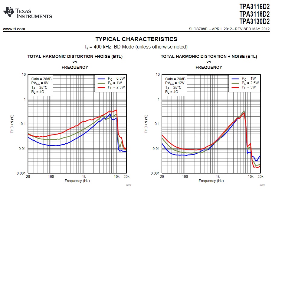

That shows that Infineon and Texas Instruments are some liar businesses.
Then the data he released may also be false. Why should we make tpa3116, 3255, ma12070 😈

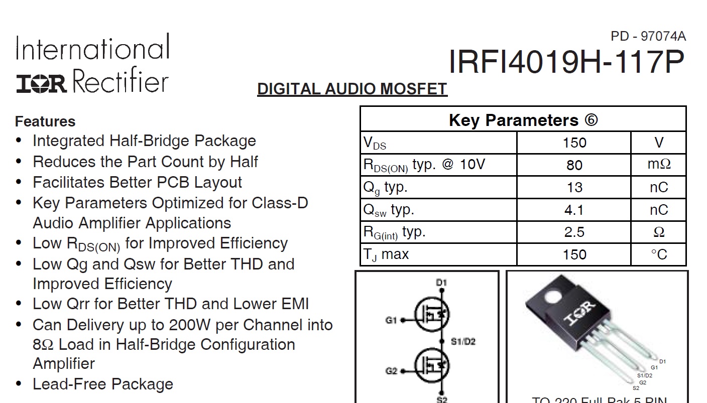

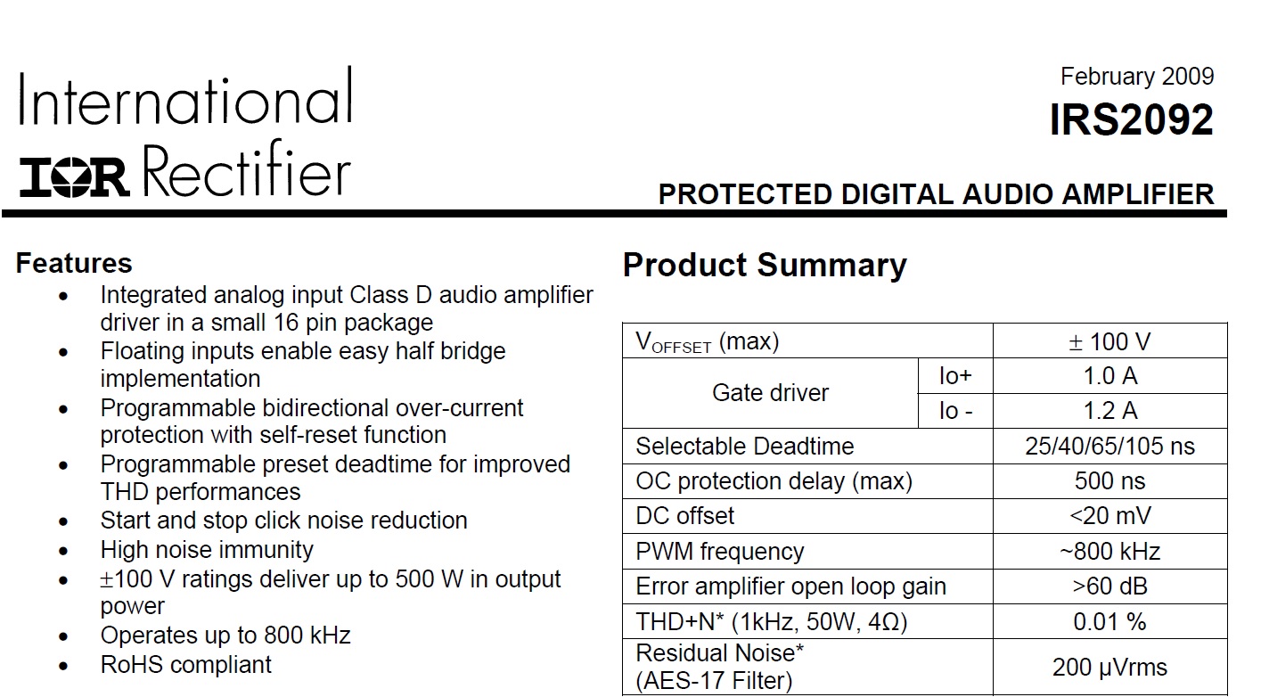

You can refer to here.
PWM regulated power supply. Or PWM amplifier.
In fact, it was born a long time ago. About 1960 years ago. Even before OCL amplifier.
Refer to the documentation for details.
Infineon and Texas Instruments list them as digital amplifiers.
If you have an opinion. You can email them. Let them modify the introduction of the document. I am behind you.
In fact, I'm not sure about their names. I'm not very interested in what I call it.
PWM amplifier is a very simple amplifier.
I don't understand why some people call it class D. Do you know why.
I think D means digital. Or class D is just a random name. No special significance?

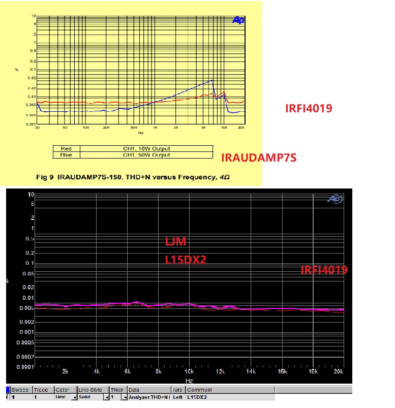

Mosfet arc output IRFB4227In fact, BJT performance is better than MOSFET
I don't know why many people are interested in MOSFET amplifiers now.
But we need to understand. MOSFET has RDS. When a large current is output. Higher voltage attenuation will occur. The VCE of BJT basically remains unchanged, about 1.2-1.5v. It will not change with the increase of current.
So BJT has a lower VBE. Distortion. Has a better driving force.
Although we can correct the voltage attenuation through negative feedback. But in fact, the driving force of MOSFET is indeed worse。
In addition, I would like to add a statement from a friend above. I don't think class a actually makes any sense. It is a commercial advertising behavior.
We can use simple class-B or class ab.
Use BJT CFP structure. Gain the lowest distortion amplifier in the world.
For example, Halcro in Australia
Add: at present, I have heard that the best class D in the world is dsi200 DS 225 of arc company. I don't know the specific MOSFET model it uses. But it uses irs2092 driver chip. If someone knows what type of MOSFET arc uses, you can tell me.
https://www.google.com/imgres?imgur...2ahUKEwj6r7q65vmAAxXjmmMGHd9MDHgQMygCegQIARA3
- Class D
- Performance ranking of CLASS D power amplifier MOSFET.
