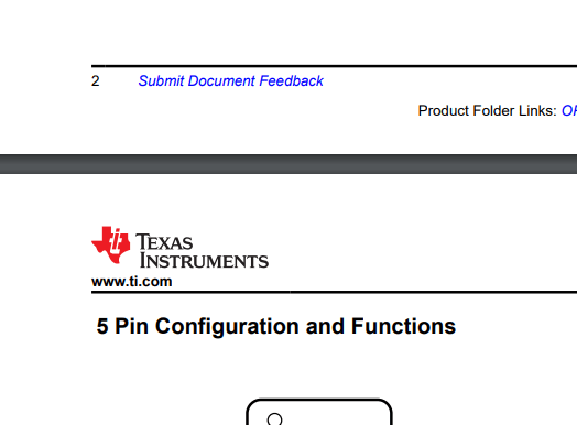

Ohh, I often write to manufacturers about errors in datasheets.You can write to Infineon. Tell them. Your PDF document is wrong.
Digital amplifiers should not be used. Irs2092 should be written as an analog amplifier.
I think they may not reply to you.
Most modern datasheets have a link somewhere where you can report errors.
Not just names, sometimes graphs are clearly wrong.
They always reply and thank me.
Everybody makes mistakes, in this case everybody can see it is wrong.
Note that the guy who is tasked to write a datasheet is often not the guy who designed the part.
He is busy designing more parts ;-).
Example: https://www.ti.com/feedbackform/techdocfeedback?litnum=SBOS901B&partnum=OPA1655
Jan
I suspect in this case its really just marketing calling an amp a 'Digital Audio Amp'. Just like some headphones get marketed as 'Digital Audio HPs'. Of course it can be wrong as well as be marketing but in this case I doubt they'll acknowledge it as a mistake. The first bullet point acknowledges the device is 'analog input'.

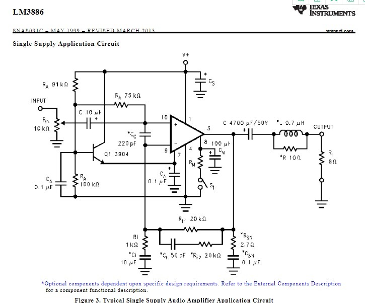

Let me make an analogy.
Lm3886 should be a chip that everyone knows.
If you use the first scheme, use an lm3886 chip. Use + - 30V voltage.
The second scheme uses two lm3886 chips. Use + 30V GND voltage BTL.
Which effect do you think is better. Which is cheaper. Obviously.
The first option is cheaper. And the effect is better.

What do you mean 'effect'? Lower THD? Depends on the rest of the circuit.Let me make an analogy.
If you use the first scheme, use an lm3886 chip. Use +30V GND - 30V voltage.
And their functions are the same.
Cheaper? Don't know, two chips but simpler power supply; an extra high value electrolytic is probably more expensive than an extra 3668.
Total price depends on, well, the total circuit.
Better sound? Maybe for you, maybe not for someone else, very subjective.
So I really don't know what your point is.

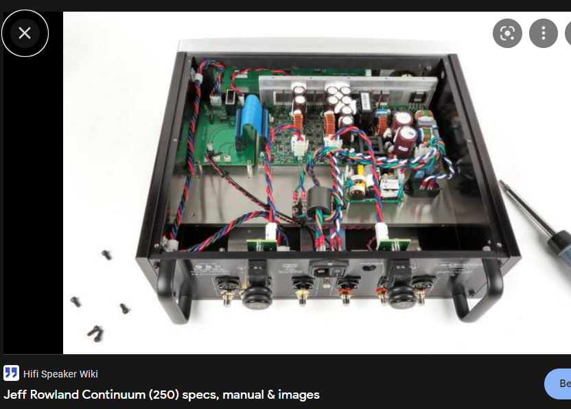

In my cognitive range. Iraudamp4a and iraudamp5a are the best amplifiers.
Then iraudamp7s.
I used these in 2010. In addition. I used Jeff Rowland 250
ARC DSI200
They all cost more than $3000. And I have fm115 here. Class B amplifier.
The price is $150000
I don't use Jeff Rowland 250Sure. You use Jeff Rowland 250?
Class D and SMPS.
Have fun, I have better things todo.
Jan
I just compared this machine with iraudamp7s.
The result is that iraudamp7s is much better.
JEFF ROWLAND 250 use ICEPOWER 250
