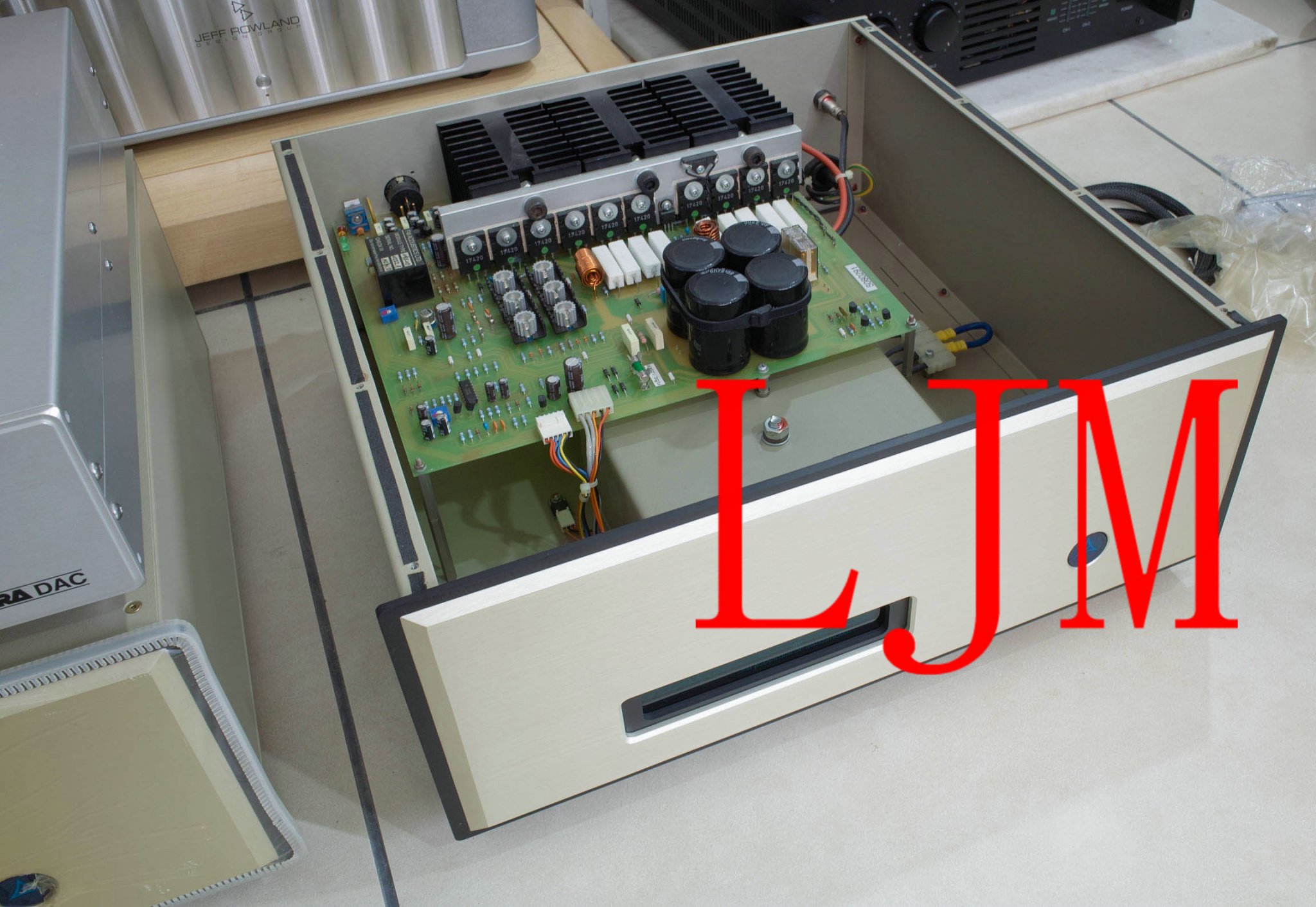

This is fm115 and Jeff Rowland。
Now BBS has become a place for businesses to advertise.
Lose the meaning of discussion. I seldom come to BBS.

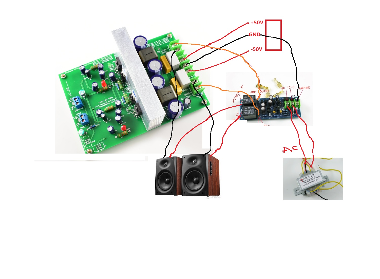

I copied iraudamp7s. But I changed it into a double-sided PCB.
Jumpers may not be used. I think it's simpler.
Iraudamp7s PCB design drawings are provided by Infineon. All components also have detailed values.
DIY is very easy. About $40. I named it l15dx2. To avoid the same product name as Infineon.
I have compared its effect Better than Jeff Rowland 250
Because I don't have iraudamp5. So iraudamp7s is the best class D I have ever used in the world
You can also download PCB design drawings on Infineon's website.

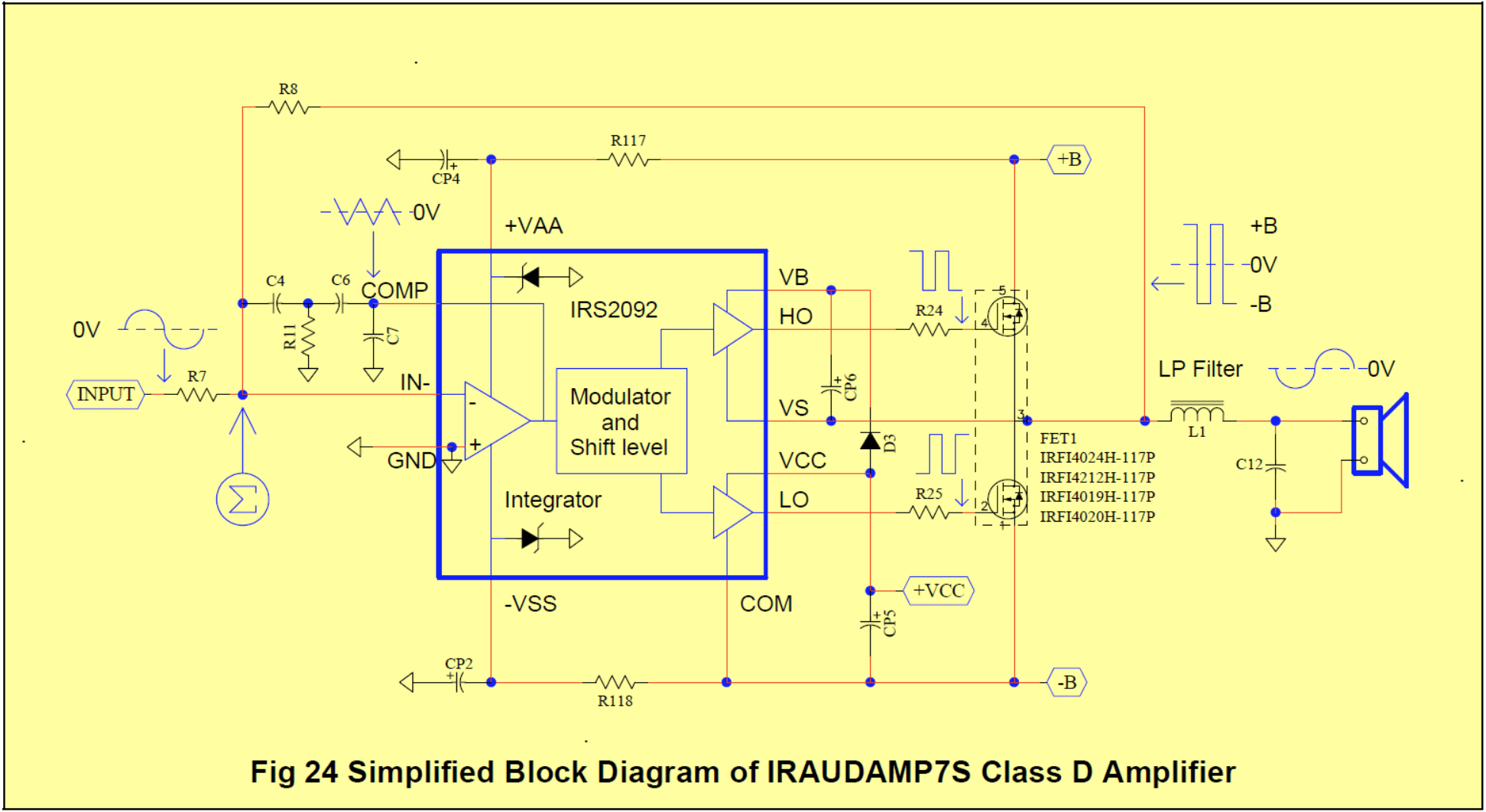

IRS2092 spec sheet:
"International Rectifier’s proprietary noise isolation technology allows a high current gate drive stage and high-speed low noise error amplifier to reside on a single small silicon die"
Impressive...
It also comes in DIP16 (DIL16)...

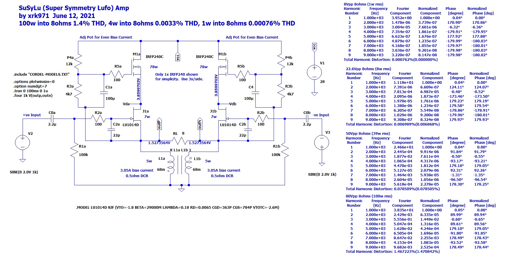

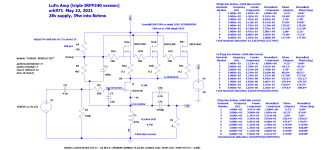

I understand how to make bridged amps on single supply with no cap outputs. I have designed and built the SuSyLu - a 100w choke loaded SE Class A amp with balanced DC coupled output.
https://www.diyaudio.com/community/attachments/01ad7340-7c7a-4e0c-a763-d20e93961d64-jpeg.987583/
Very simple topology:
It sounds great - perhaps one of the best sounding amps I have heard.
I am just saying, for smaller simple amps, 100w with a SMPS single rail supply can make a great sounding amp. I have lots of great reviews on one of my commercial amps that uses this approach.

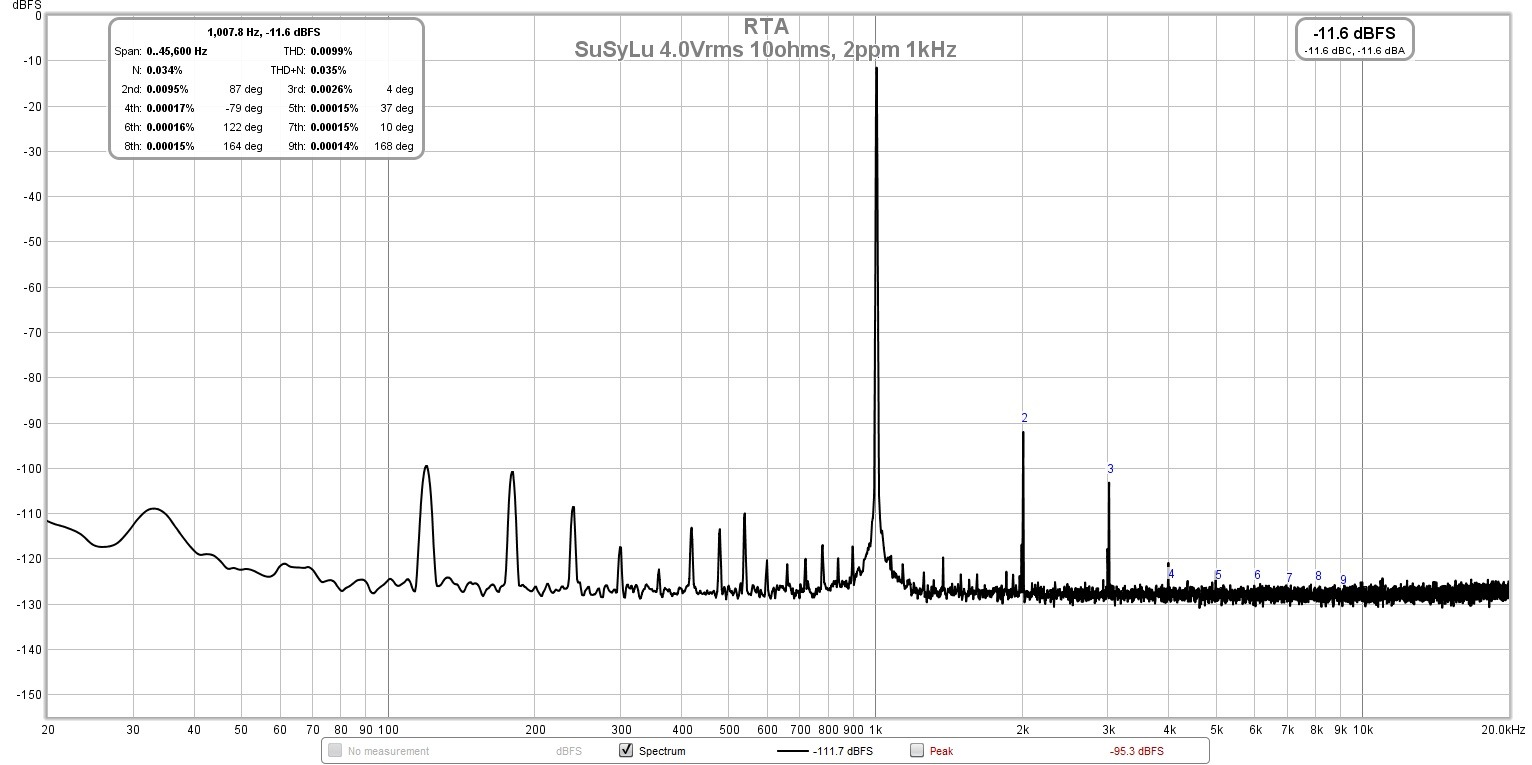

@jjasniew, even though my Susyamp is bridged, it still has a nice harmonic profile that is not odd order dominant like PP amps. Here is the FFT:
