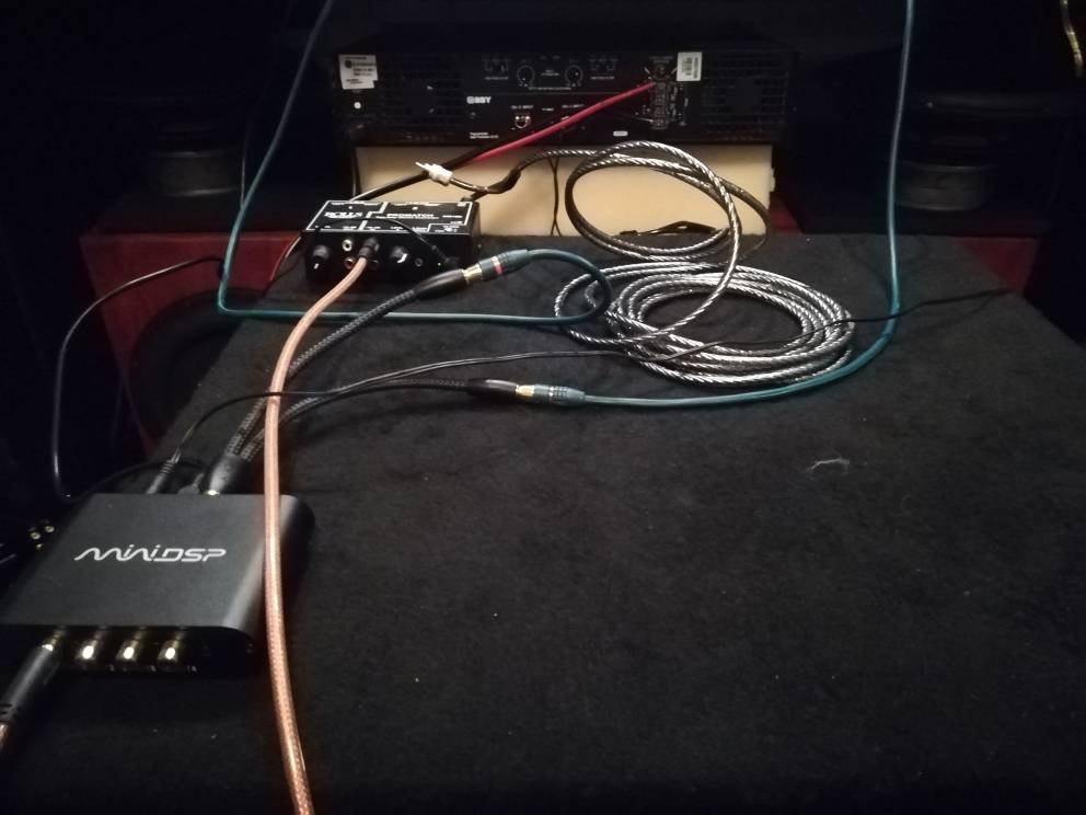

Hooked up the Crown Cts3000 on the 18" with dsp and signal amplifire. having 3000w in 4ohm to play with.. but for sure not using all that.. anyway tuning a bit on miniDsp tonight as well. the DA 18" plays very nice and deep where it stands right now. but will try it in another possition to get some space on the floor. Cable chaos at the moment[emoji28]

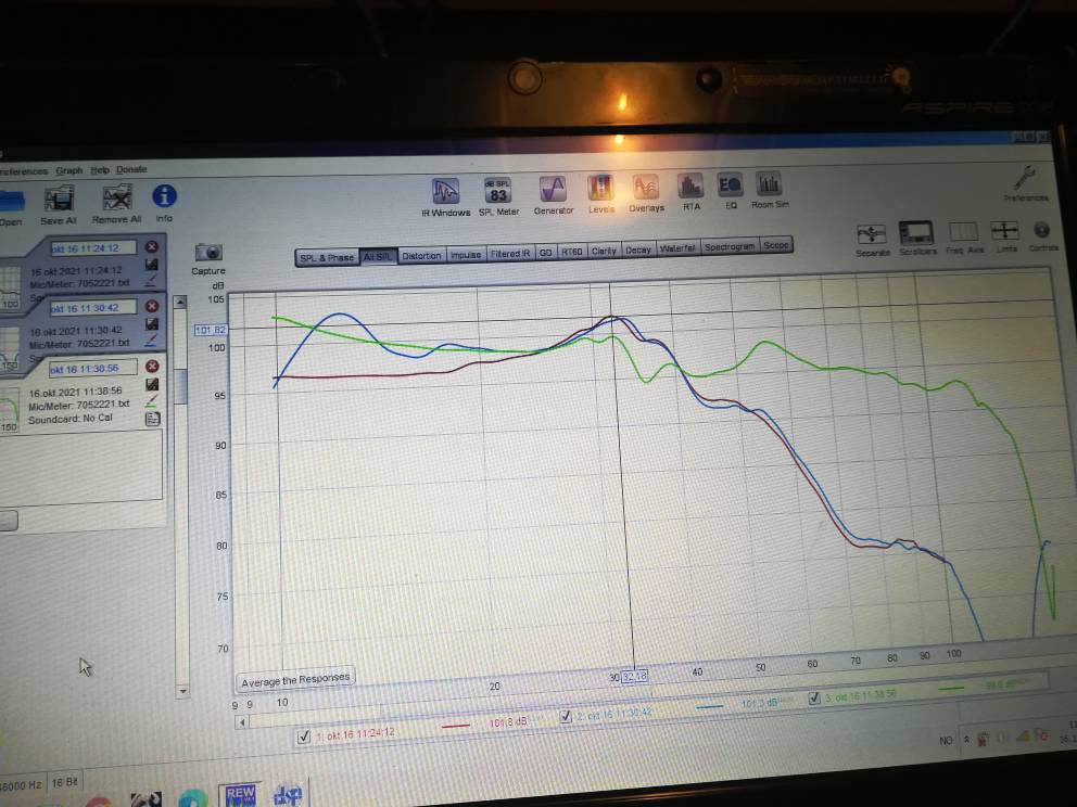

Forgot to post a picture of the Umik-1 test yesterday. this is 1x18" and 2x10 xls Green curve. View attachment 990902
So the green are the two xls 10 drivers? Surprising how flat the curve is and how low they go, the 18 does not seem that much better?
The green line is 1x18" + 2x10" the 2x10" help a lot on those possition they stand in that room for more low end. it is pretty funny. the curve is pretty flat yes, but on the amp for the 2x10 i turn the crossover higher... musicwise i prefare to not have so high crossover on those, i feel it is a bit to much of the high fs/hz.. i use to have them about up to 60-80hz on the amp. +-So the green are the two xls 10 drivers? Surprising how flat the curve is and how low they go, the 18 does not seem that much better?
i have reposition the 18" now under the desk. so i have not tried a new meassurement yet. but it play very well.

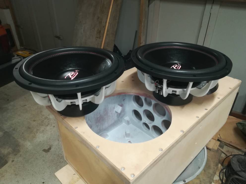

The enclosure is done and are on 5th day of running in the subwoofers.. short explained.. im impressed how these drivers sound and produce detailed and deep bass.. this is for car audio btw...
Those subs deserve a plexiglass enclosure!
