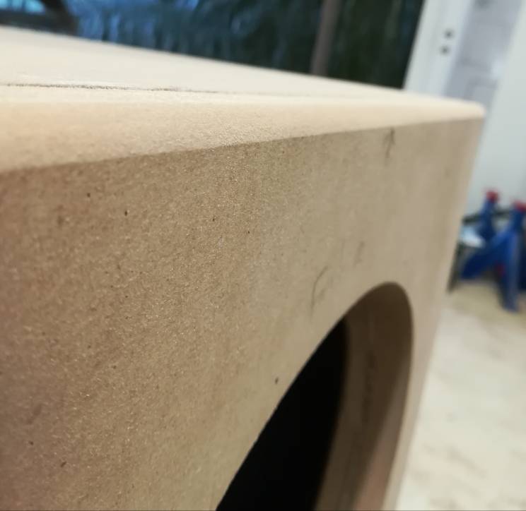

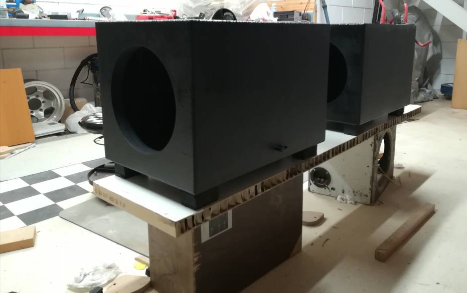

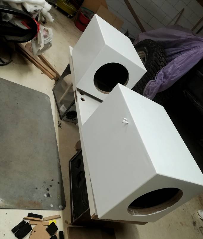

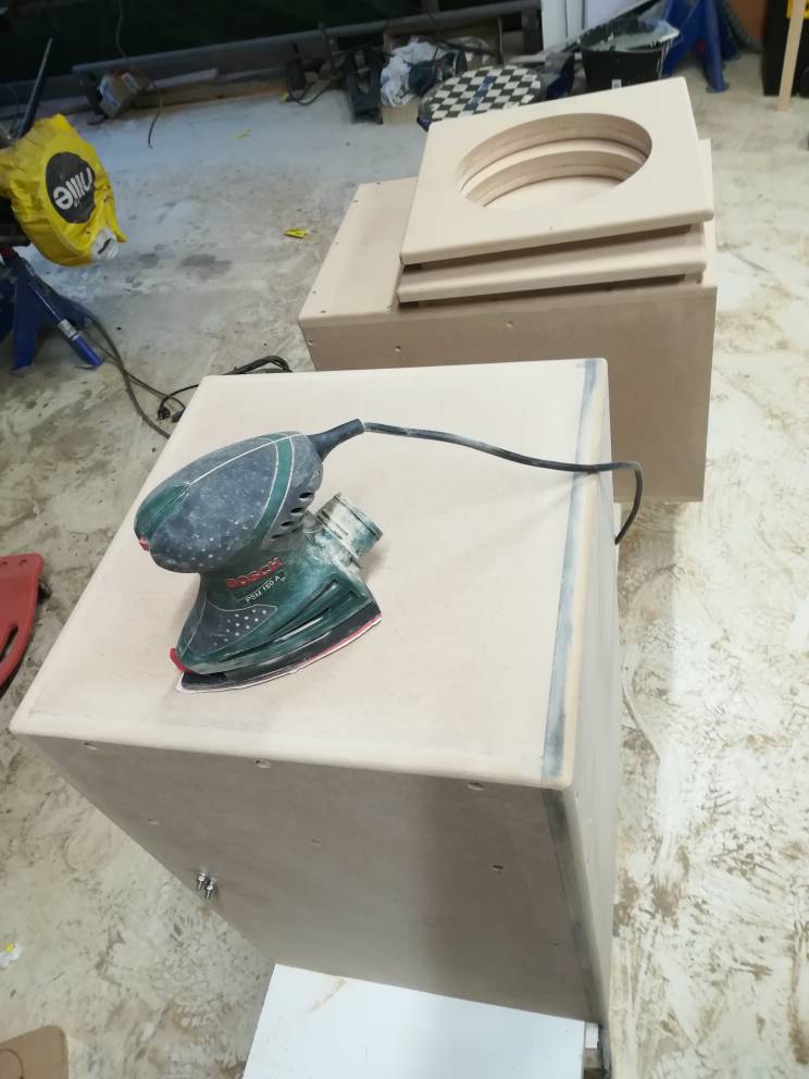

Somehow the boxes weight 42,8Kgs without driver.. the boxes have got rounded edges and sanded down and soon ready for paint.View attachment 829136View attachment 829135View attachment 829137
Thanks, it plays so clean, deep and detailed. Hard to explain [emoji28]

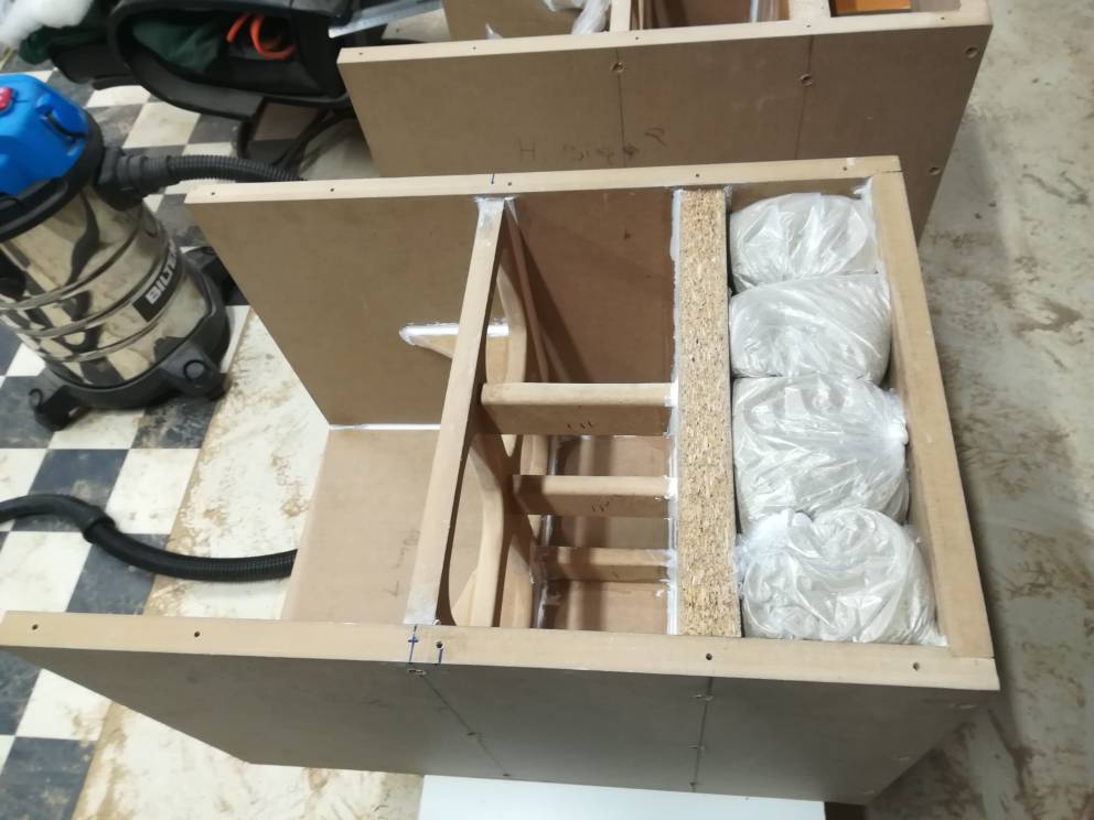

I didnt put any damping stuff inside either.. not sure yet if it nessesary for these drivers.

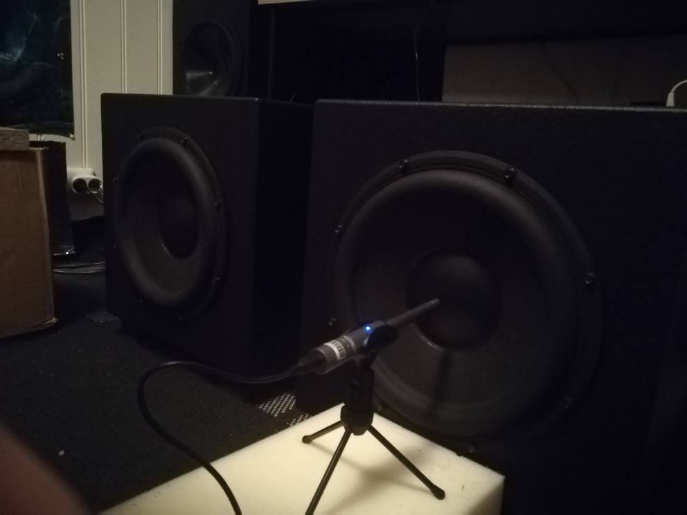

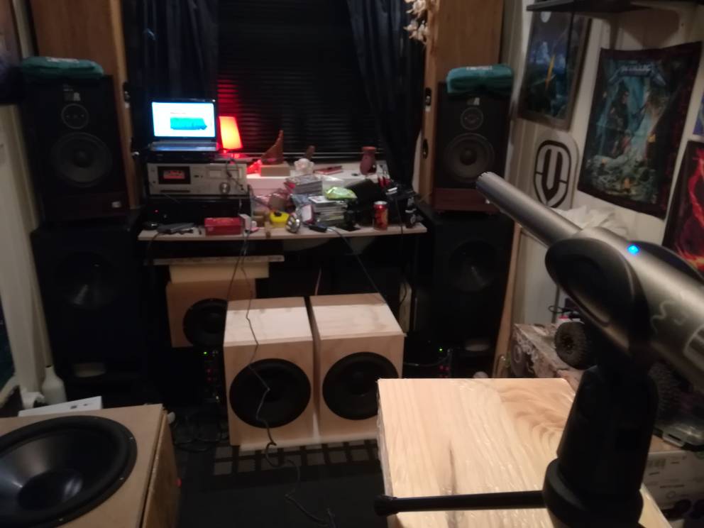

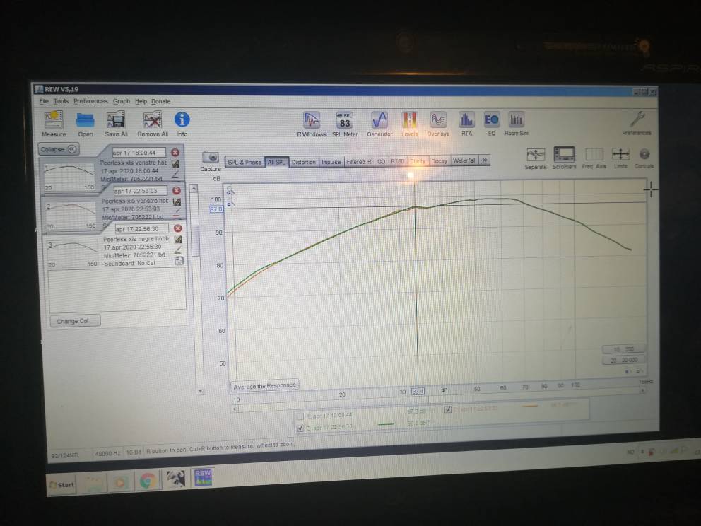

will try to meassure the subwoofer first in the livingroom with minidsp, mic and rew program.. i have not use the program before so will maybr take some time to adjust.. but seen some youtube videos allready.

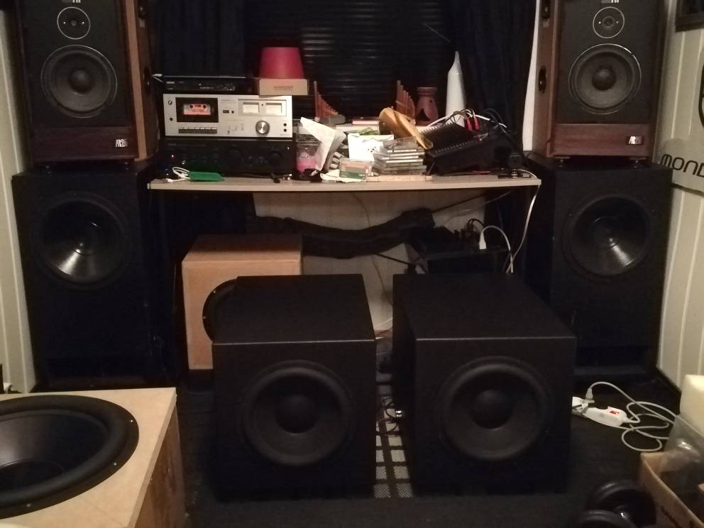

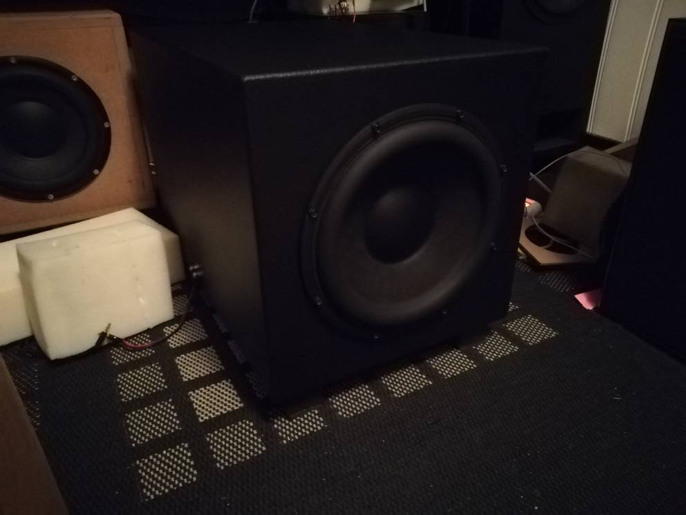

I have now moved out these 50kilos boxes where they will be in used and are allready ready to bang some Lf.

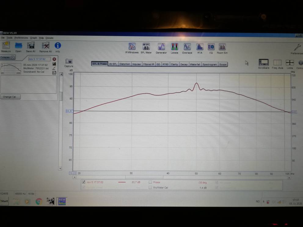

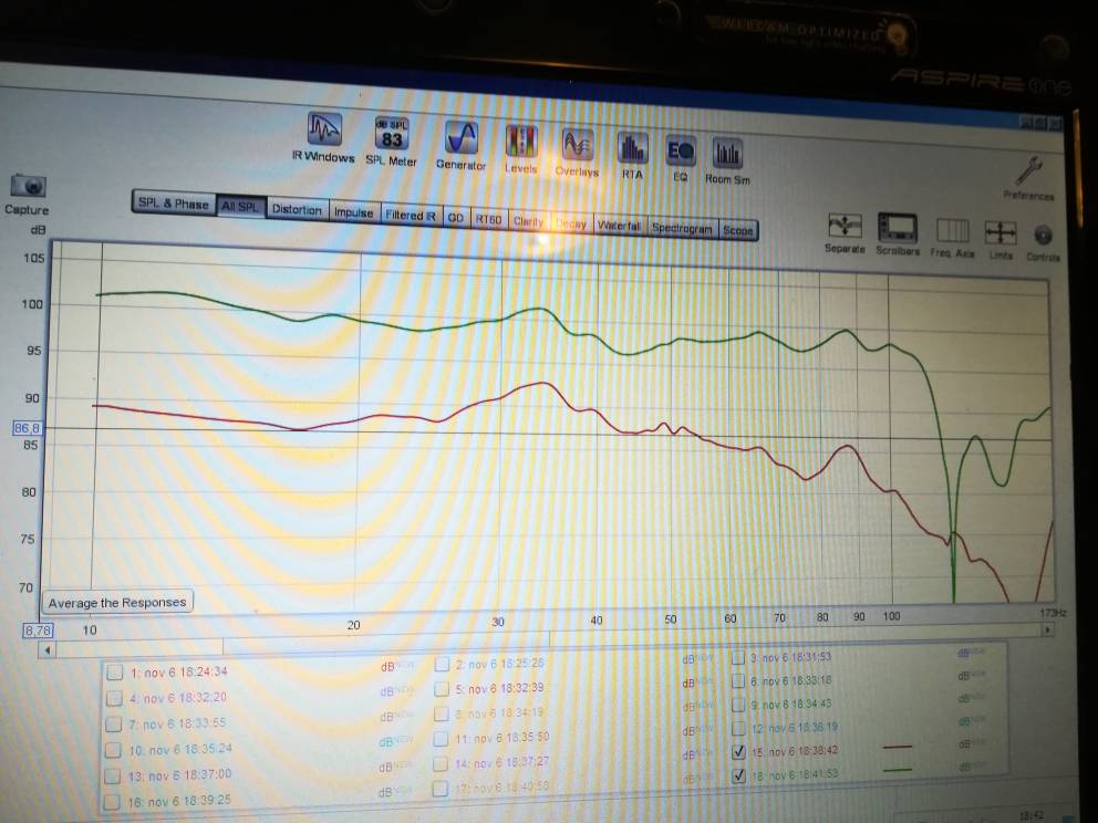

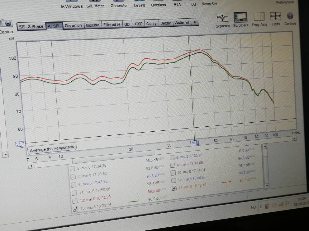

Picture of the curve is with and without 20hz 3db boost. anything else i did from listening position was to adjust the delay on each subwoofer. the subwoofer is designed to work best around from 40hz and down.. as i have tested in music and movie for now they really deliver very nice deep and clean bass..

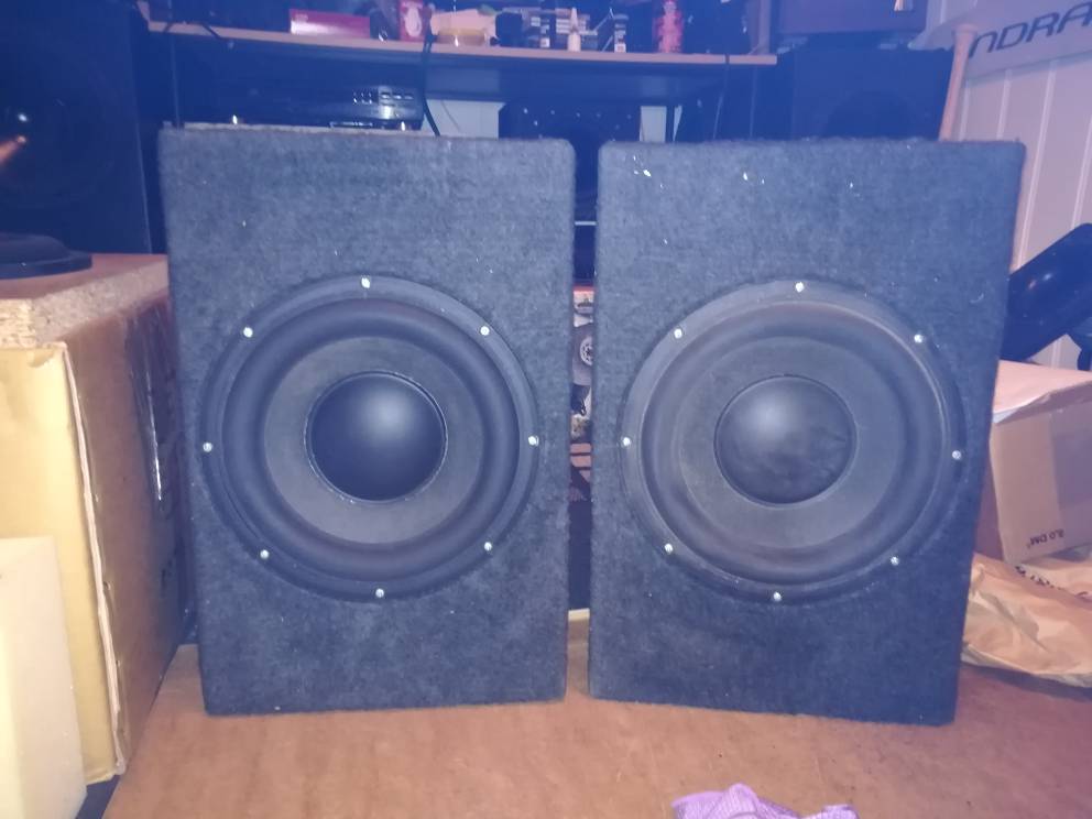

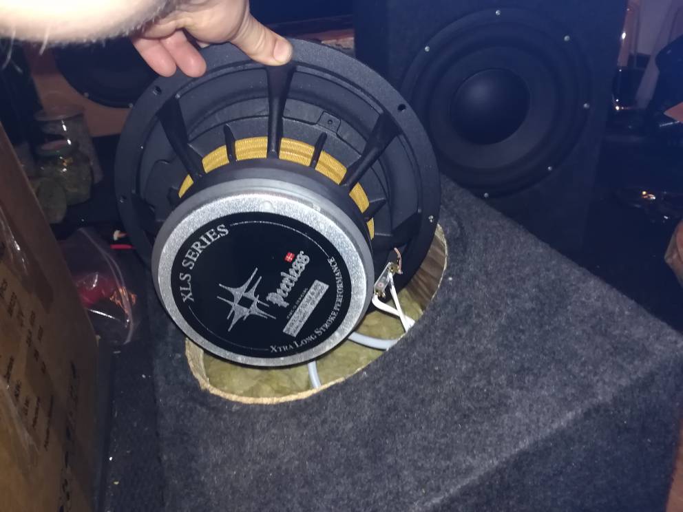

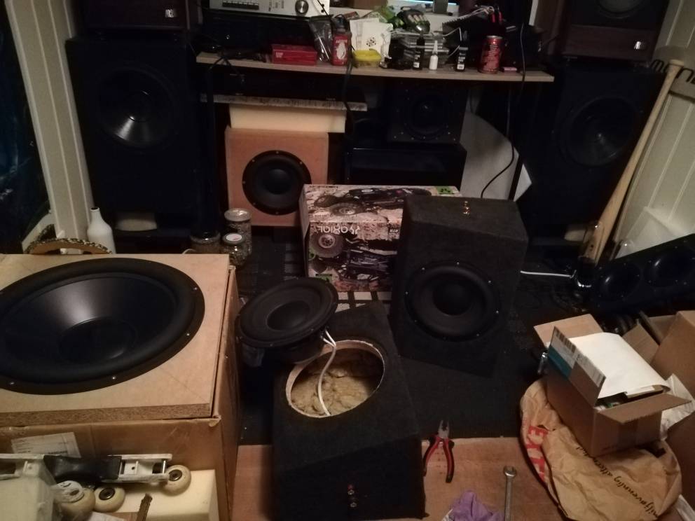

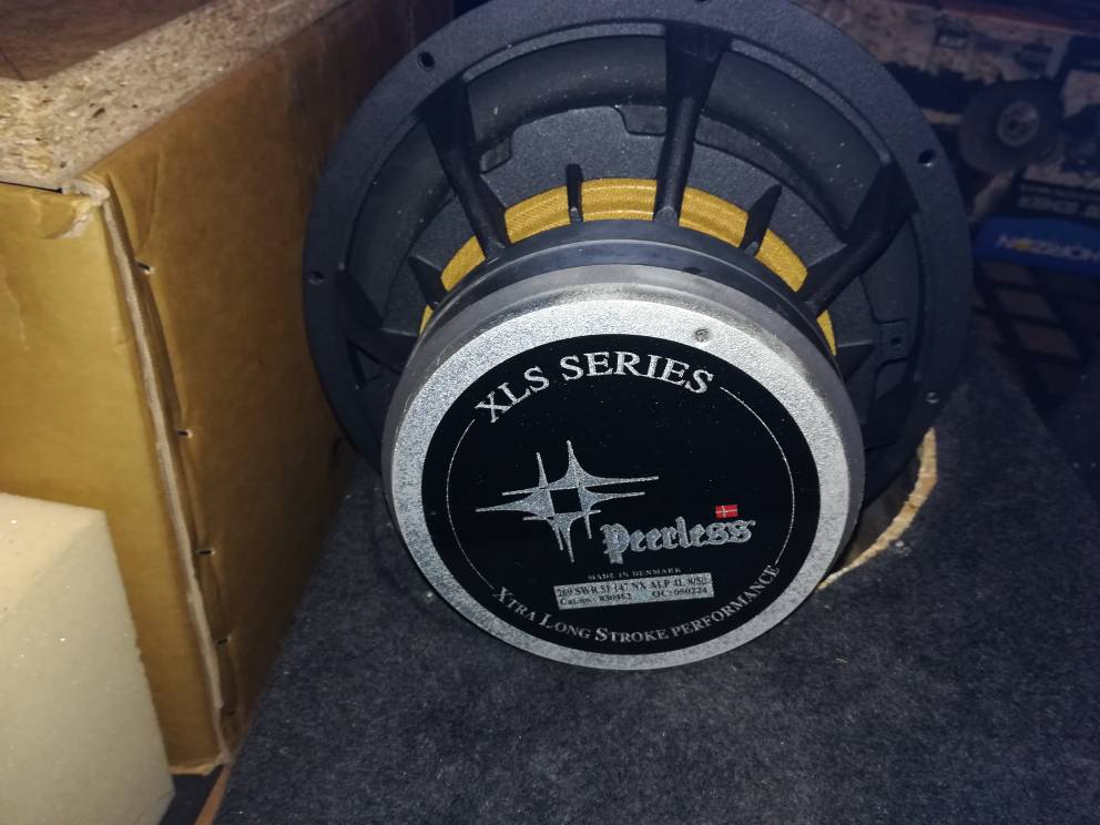

Ooupsii[emoji51] 2 x 5/8ohm original 1 owner xls that arrived to me today [emoji2] the sealed boxes followed with them, they are actually pretty good, the play deep detailed and nice. i will keep them, just fix them a bit out and inside, i guess about 20-27L internal volume each,.. Actually my plan was to make sonotube passive radiators with the 12" scanspeaks i have. will see.View attachment 876396View attachment 876397View attachment 876398
So a pair og 2 x 12" original XLS showed up.. now i have 4 in the 8/5ohm version, 1 owner. the enclosures is ok, will do a finish on them later. also bought a pair of active oldschool amps as well from same owner [emoji2]
My plan is to run 4 of the 12" in my livingroom cinema, maybe will test them in front first, and rear after.. right now im using 2 front and a 15" Ultimax in a huge enclosure from behind. View attachment 890802View attachment 890804
