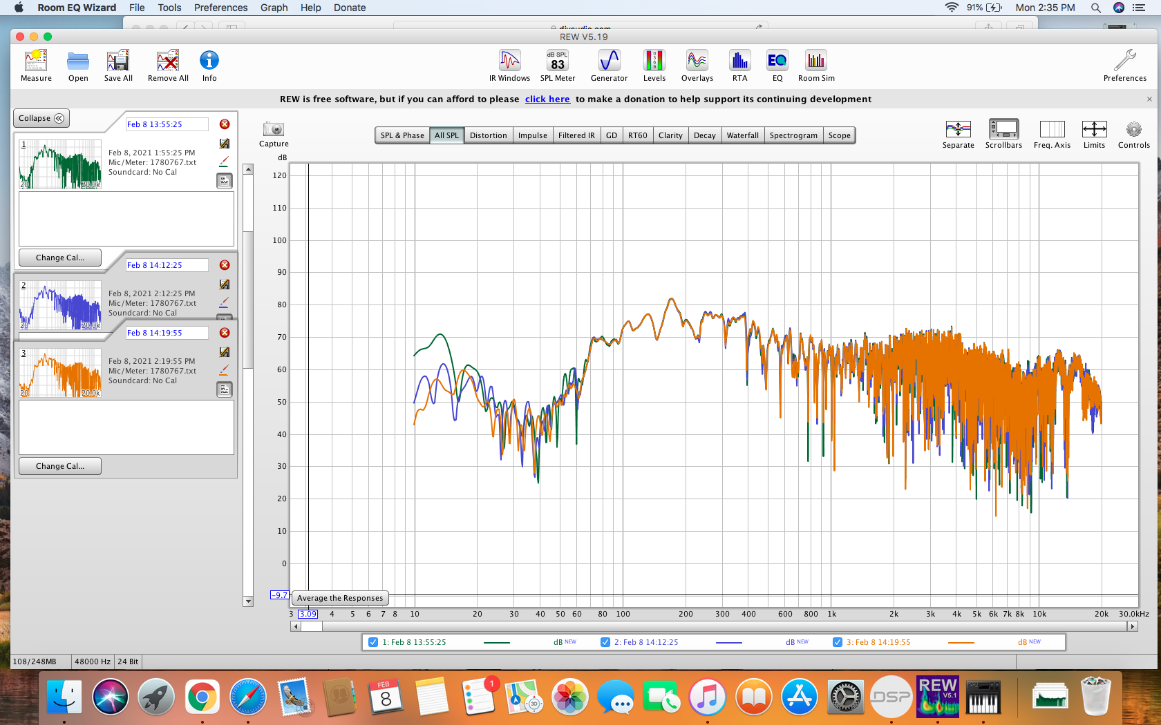

there is this "hole" between the line arrays and the subwoofers that I cannot manage to fill no matter how much goofing around with the DSP, or how high I cross the subs...
I have only run frequency sweeps so far, I cannot see this black hole on the graphs, but I can certainly hear/feel it.
I could consider the room acoustics, but the room hasn't changed from my last set of speakers so why should the room be ruining the response now?
In fact, these arrays are even closer to the corner Apex (and the floor and ceiling) than the previous corner horns were. There should certainly be less S.B.I.R. than before...
But I digress... I suppose I have alot more EQ-ing to experiment with!!

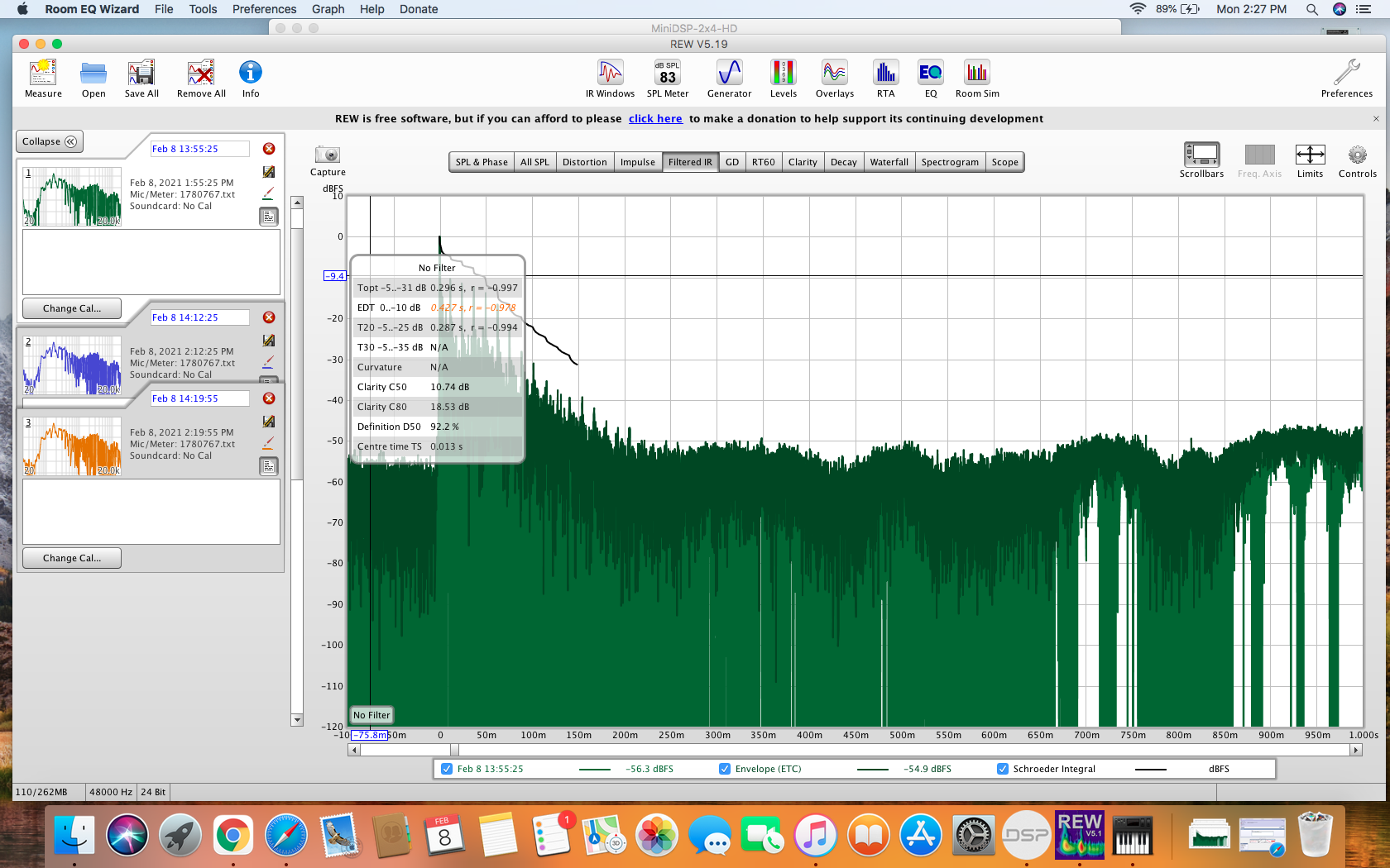

It took me quite some time to find the right settings. I have a big hole in the bass in the center of the room. But on the backwall - wow... sick bass... Now I listen a little off centre and its OK in the middle of the room too.
I must have lost the saved REW measurements. Unfortunately I am basically REW illiterate..
Here is a screenshot of FIR. (I think lol) It says "no filter" on bottom left-
