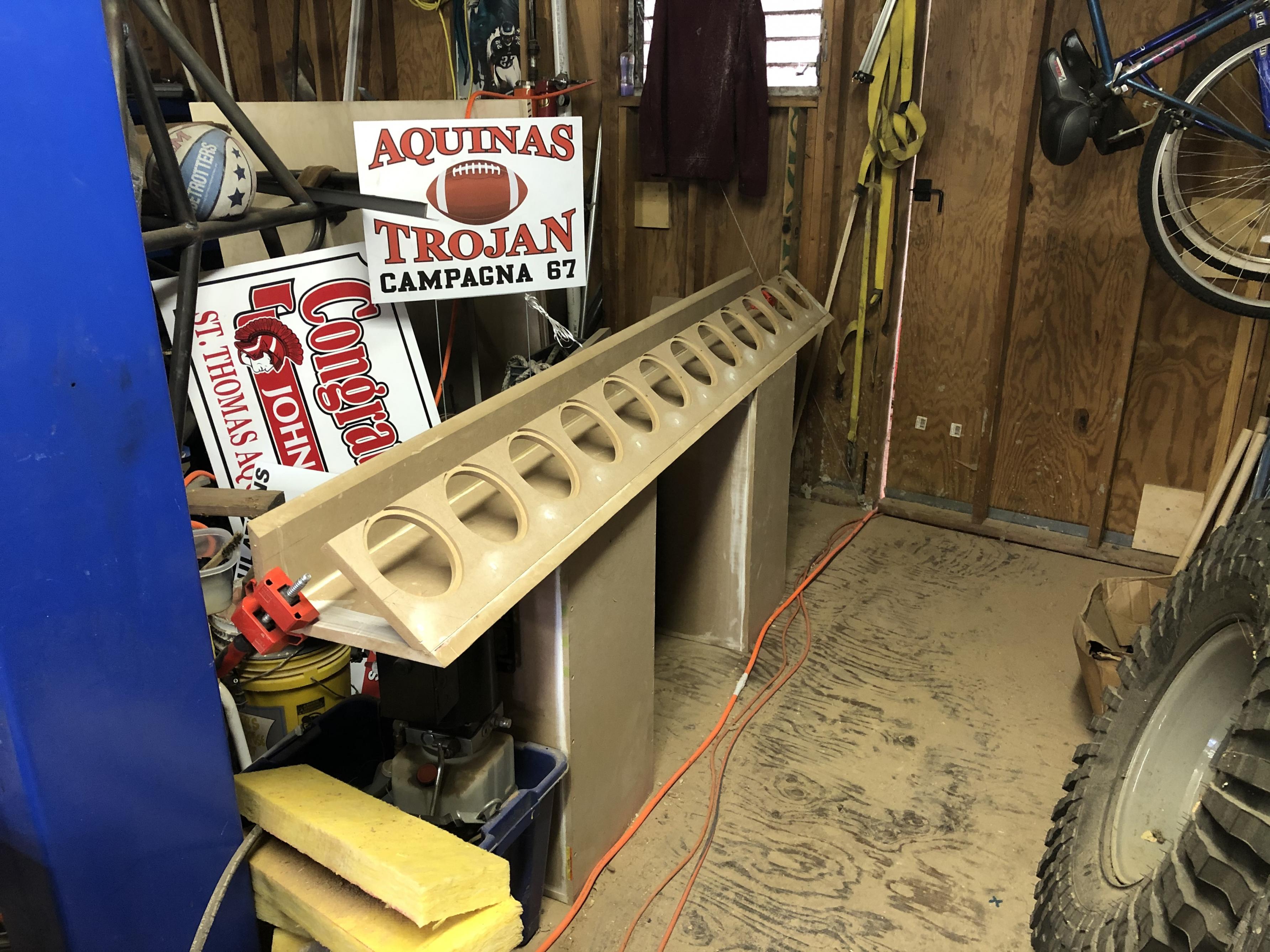

Peerless TC9 corner array build (low brow)
Some subjective listening impressions-
Again, this is with NO REAL PROCESSING!!! again, other than PEQ there is no other digital experimentation and NO REAL PROCESSING/FIR!!!
Last night, just for laughs, I high passed the arrays with some basic in-line filters (capacitors) I had lying around.
To my ears, It definitely cleaned up the arrays at high volume playback.
Ill see if I can measure/confirm some of this in the distortion values of REW.
These filters are rated as 150Hz high pass into 8oHms, 1st order.
I realize I can do this with the miniDSP-HD,
but since I'm using it as a DAC...going from the DSP to my pre-amp,
which outputs to to L+R mains and L+R sub, I did not want to high pass digitally, depriving the subs of any native bass frequencies.
Another reason I didn't high pass with the DSP is I had hoped the small sealed enclosures would have restricted excursion, but I don't think that's happening much.
After all this, and my complaints about a lack of upper bass/mid bass response (again, other than PEQ there is no other digital experimentation and NO REAL PROCESSING/FIR!!!), one could come to the conclusion that I may have been better off building somewhat larger, and therefore ported enclosures (arrays).
That may have been a better starting point. They certainly would have dug deeper, and perhaps I'd be having less trouble blending them with my subs...
This is what led to my prior "musing" of building another set of small bass arrays to go next to these.....a kludge arrangement to having not built ported enclosures to begin with...

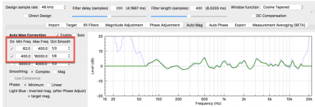

Yeah, their website doesn't make the frequency dependent correction very apparent.
It's in the Auto Magnitude and Auto Phase components.
The FirDesigner and FirDesignerM versions allow an unlimited number of bands in those components, each of which can have their own degree of smoothing applied.
By looking at the FIR mag and impulse response that will be generated, along with panels that show their windowing error, and wavelet, it's pretty easy to see when the Auto corrections need to be split into bands.
Auto also can take Coherence into account, backing off of corrections with low measurement Coherence (from Smaart, Systune etc)
Other things that make it my go-to program; are it's ability to work fully manual ala rePhase style or mix manual and Auto, the ability to define target curves via unlimited bands, and the ability to add manual Voicing corrections into the file in use, if measurements show such would help.

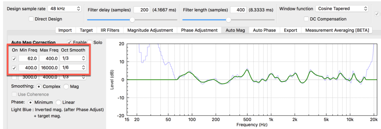

Hey, here's a related aside. And it gets to why i'm a fan of steep xovers.
When i make corrections to a driver, it's usually to get mag and phase flat thru xover down to -40dB.
Generally, on even a half-decently behaved driver, only one Auto band with one level of smoothing is needed across the driver's response range....when xover is steep (96dB oct, lin phase of course).
When i try, say 24dB oct xovers, getting response corrected down to -40dB almost always requires making extra Auto bands for the slower rolloff upper and lower response tails, to be able to soften the correction in the tails to avoid filter error. Hope that made sense.

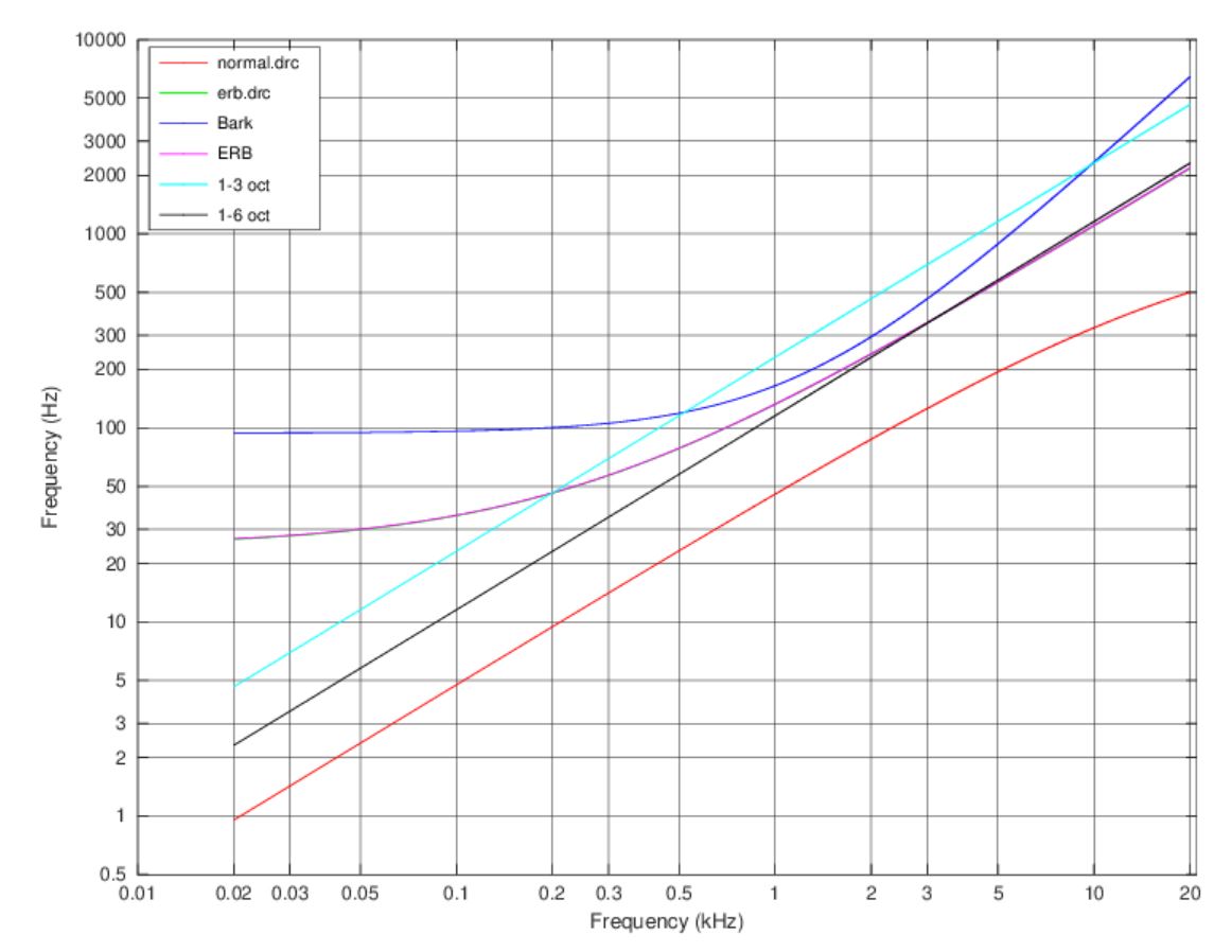

What DRC does is set windows based on sample lengths (width) at different frequencies which can be changed through the configuration file. This is an example

Hi fluid,
Yes, my take is they are different implementations to achieve the same goal.....goal being to use an appropriate level of frequency resolution across the spectrum.
Like shown below in the DRC comparison chart to conventional smoothing.
Looks to me that the DRC method achieves frequency dependent resolution via frequency dependent windowing, or rather maybe better termed frequency dependent FIR file size.
(Quick question: does DRC allow or use different widowing ala rectangular, Hamming, cosine etc on each individual band, or does it use a universal window setting across all bands?)
Whereas like you say, FirD method lets you divide the bandwidth into however many sub bands you want, and apply different levels of smoothing to each sub band. And yes, it is quite easy.
The real-time visual tools that FIrD has to determine when to make sub bands, and what smoothing to apply are very helpful.
Sometimes, I've even found it helps to skip any correction at all in small narrow bands. Measurements back that up because they inevitably lack Coherence there, with or without correction.
Which method ultimately works better? Who knows? Would be interesting to find out.

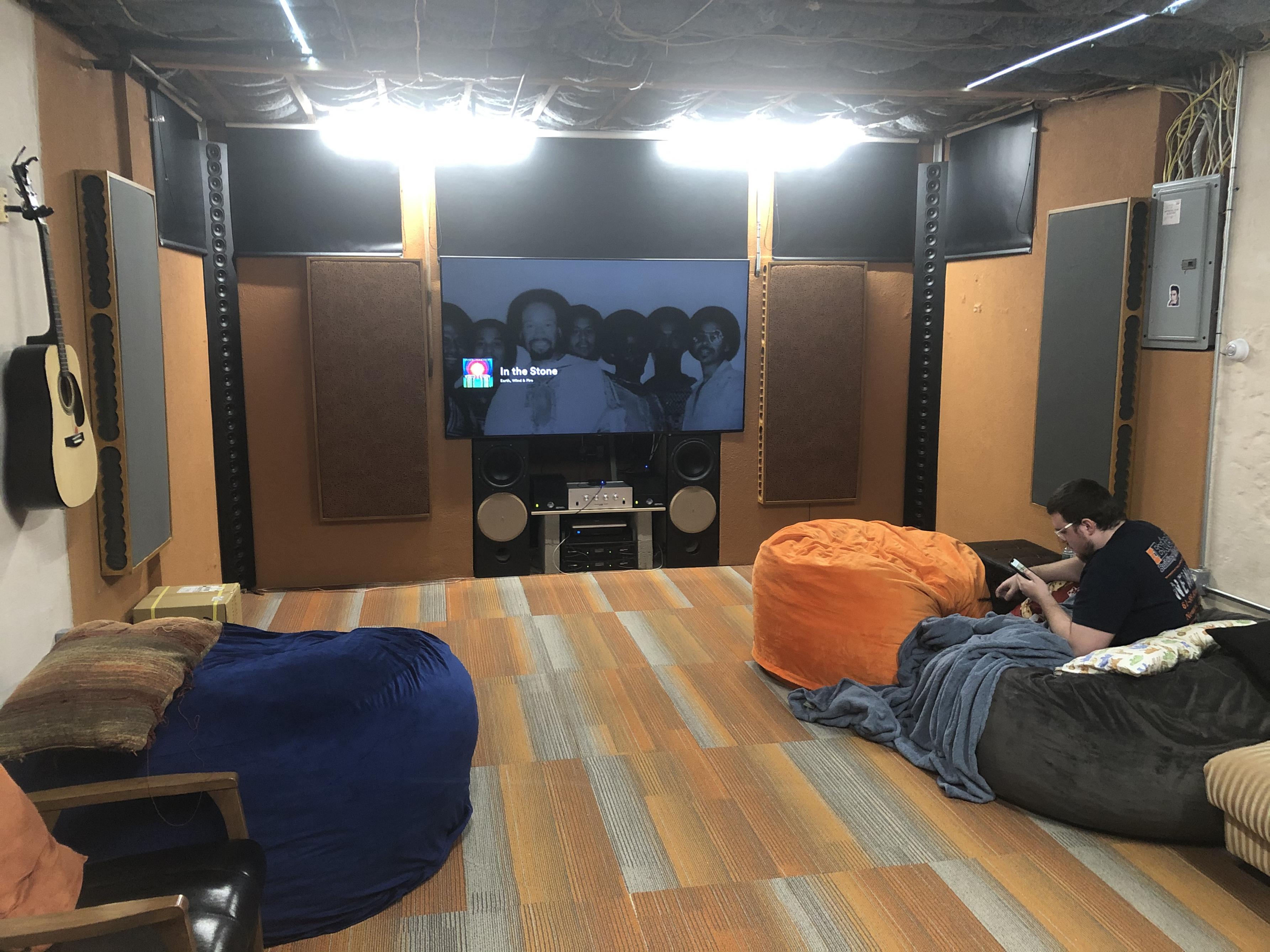

I did finally get up the panel absorbers. They are very easy to put up or take down. Now it’s time to get back to playing with REW in an attempt to improve the arrays some more…
Meanwhile…my son still enjoys it as is LOL

Rooms looking great !
Nice work on the panels.
Our kids are often the beneficiaries of our audio obsession huh ?
My 4 sure have enjoyed it...
Your fine looking young man appears so too 🙂

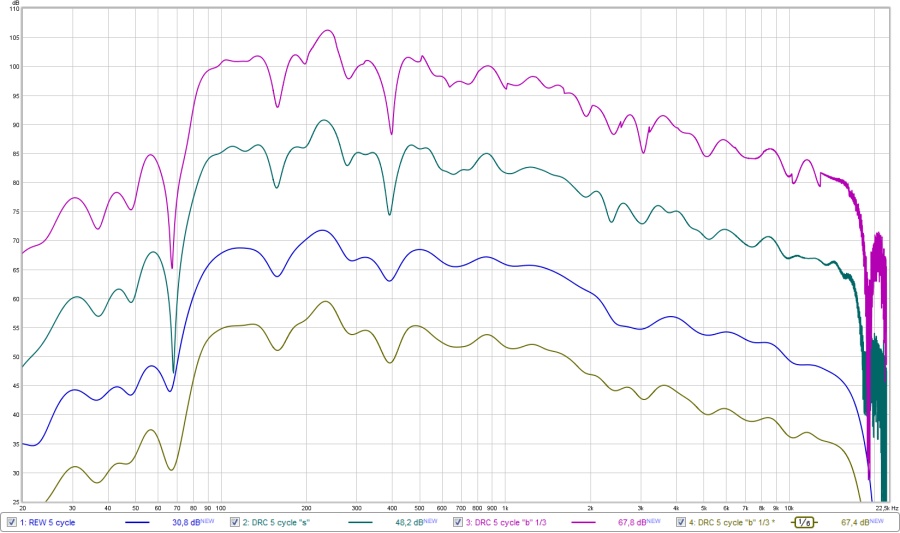

I'll try and answer your question, based on what I've found (so far), as a user of both DRC, REW and a tool like RePhase...
For a start, the frequency dependent window function used in DRC-FIR is way different in operation than the one incorporated in REW...
Here's a comparison, done on an old measurement from ra-7's arrays early on (of which I kept a picture to show the windows):
attachment.php
The blue one (3rd from the top) is a 5 cycle frequency dependent window in REW
The top is a first option of a 5 cycle frequency dependent window from DRC-FIR.
Second from the top is another (default) option of a 5 cycle frequency dependent window in DRC-FIR.
The bottom graph is the second from the top DRC-FIR curve, after a 1/3 octave smoothing (done in REW).
In DRC, there is an opportunity to vary the number of cycles as frequency changes. Real handy with a source that has it's output arrive varied somewhat in time.
