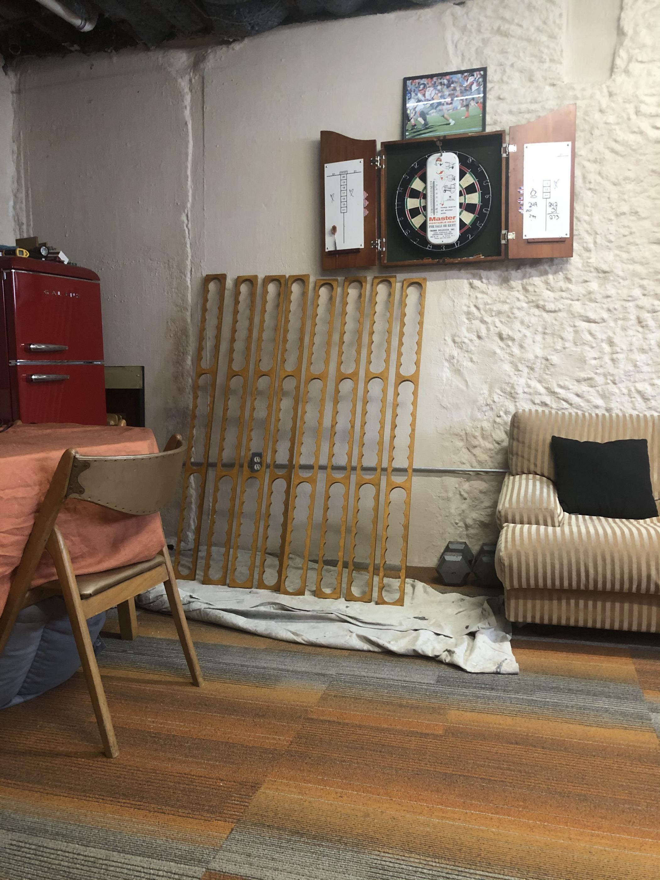

Here Are some pics of the sides. They will hold 4”s Owens Corning 703
They are going to be- 5 feet tall by 2 feet wide by 4 inches thick.
I have made four for now.

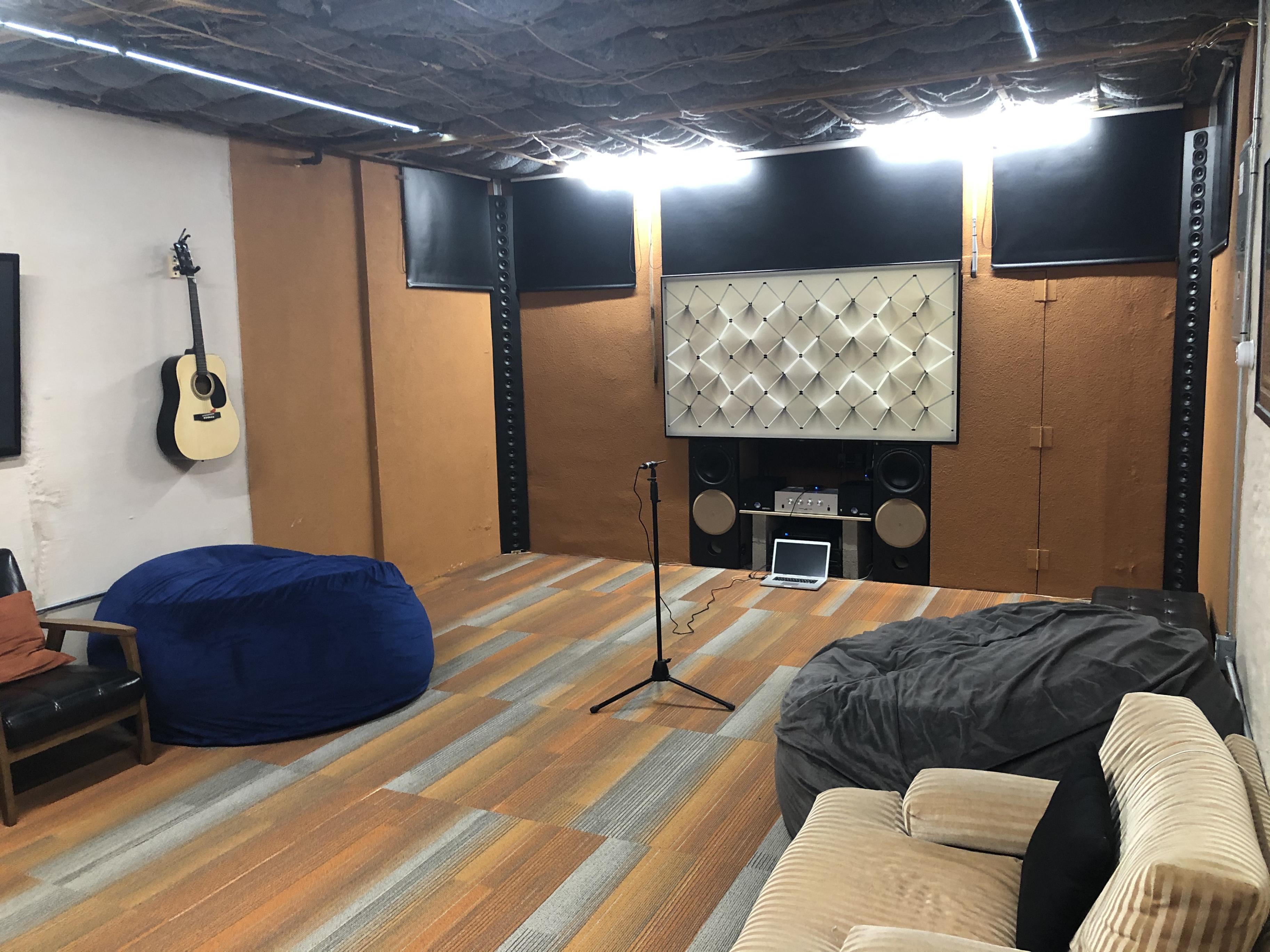

It really helps to see these speakers and the room as one "system" that we need to control. That way we get the rewards they can give.
Arrays are funny, different from other speakers. Take their strong points and work with it and you'll get the rewards. Good plan on the panels, did you see mine? I have panels at each first reflection point. Making it that much easier to dial in what I want out of them. Only 3 needed in my room. But it does make a huge difference.
Love that workshop! There's work going on in there 😀.
I did eventually get to cleaning the shop up LOL.
How did you come up with the location of your first reflection points?
If I line up the center of the line and direction of woofers,
the first reflection point winds up at the rear 1/3 mark of the length of the room.
