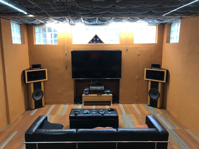

I use corner horns now, and I love the lack of what I perceive (subjectively) as less early reflections, as compared to tower speakers out in the room.
This build is not a desire to replace my corner horns, its a desire to finally hear a full length array. I certainly do not expect them to play as loud or have near the dynamics. Just a different flavor (hopefully good).

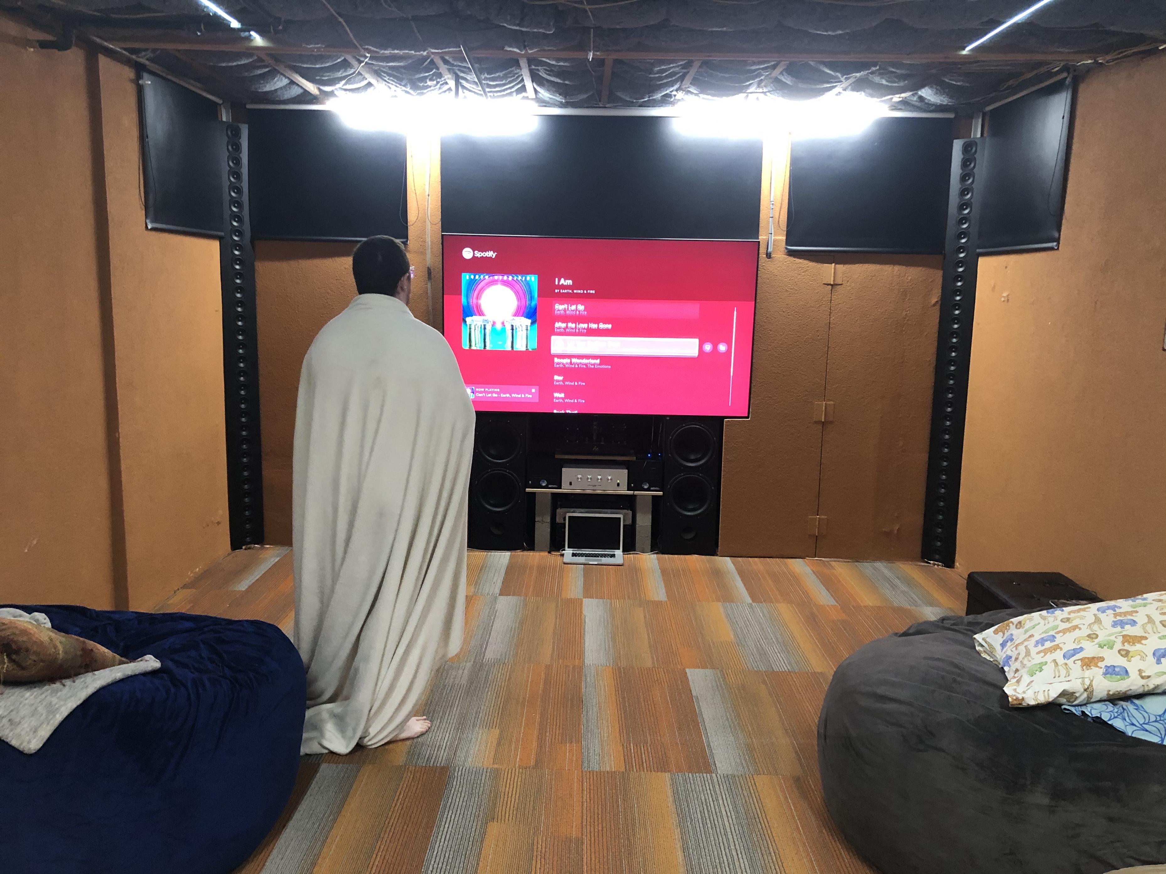

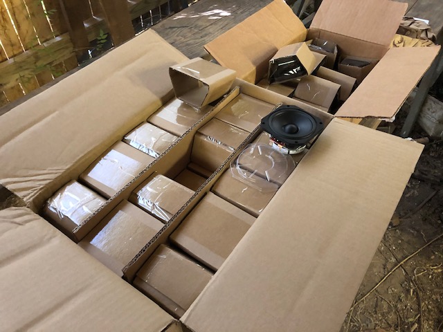

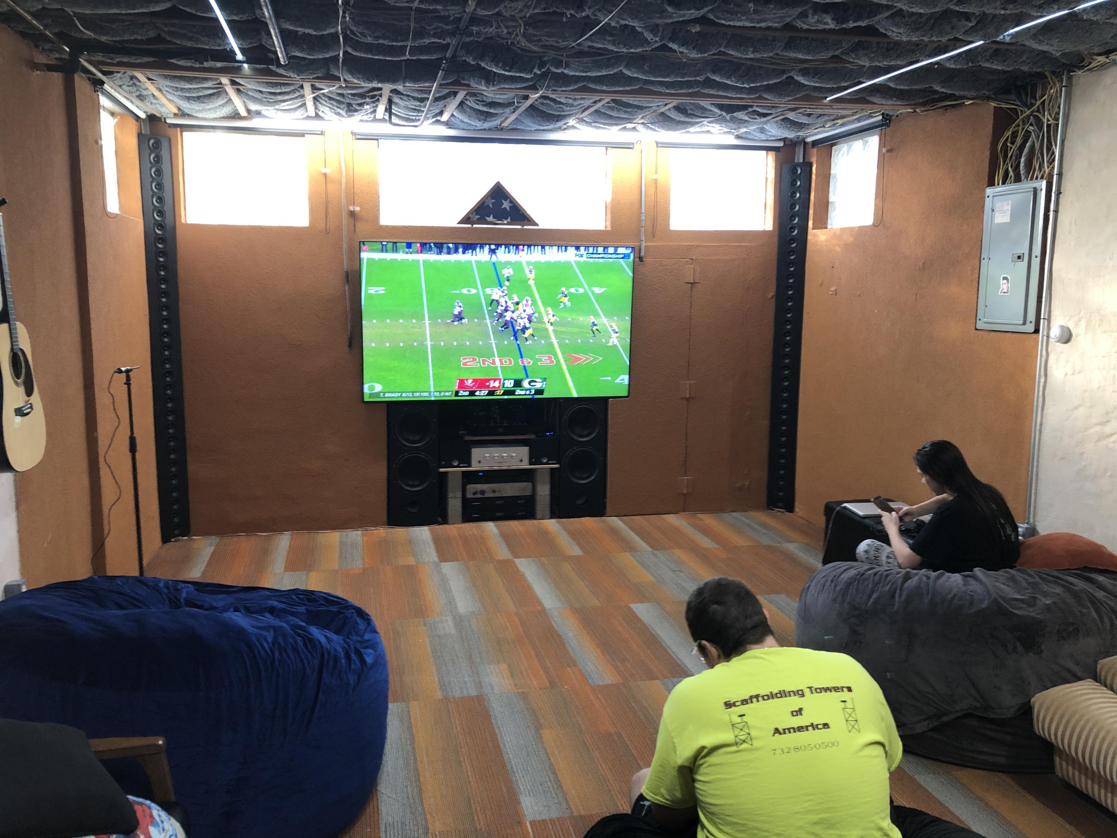

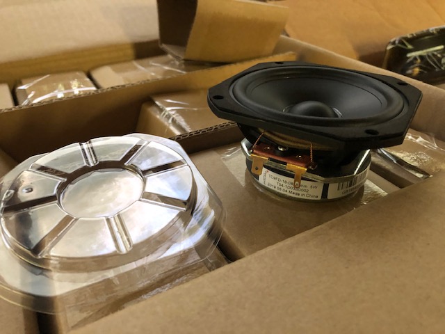

Ive attached a pic of the room (basement) where they'll go, and pics of the 60 little TC9 drivers that just arrived.
The room is 14'.5 wide x 28' long x 8'8" high.
The entire ceiling is un-finished, with ultra touch (cotton) insulation showing, so I may have to install a triangle of sheathing above each array in the ceiling corner to get some of the benefits of a floor to ceiling array, but Ill try it without first.

That’s what TC9FD looks like. Treated paper cone on front. If you look carefully at the back of the paper cone you will see it’s pentagonal shape where it’s glued to the surround. That’s the patented trick to reduce cone resonances. 5 sides breaks up the round drumhead modes and gives it the flat response.

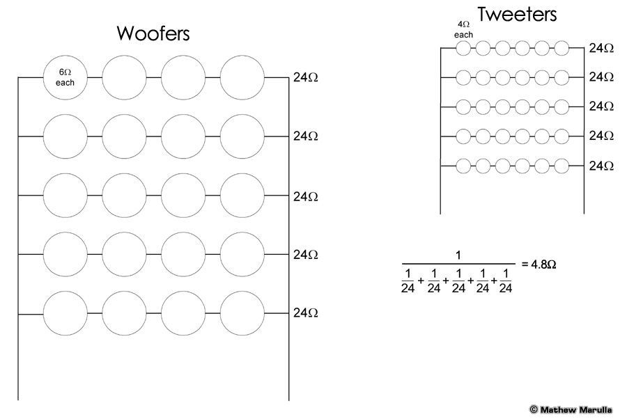

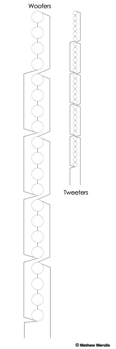

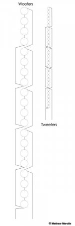

For a 28-29driver line-up you might need a dummy load to keep the impedance in check.
Wiring Series/Parallell:
(I currently run 4S5P for a nominal 6,3ohm load and mk2 will have two independent groups of 6ohm for each side.)

I just checked the impedance of all 60 drivers with a multi meter, they all (but 3 or 4) measured right about 6.4Ohms.
I have a GW Instek frequency generator, so I could check each at 1Khz,
or I suppose I could sweep each (manually) but I wonder if this is absolutely necessary...

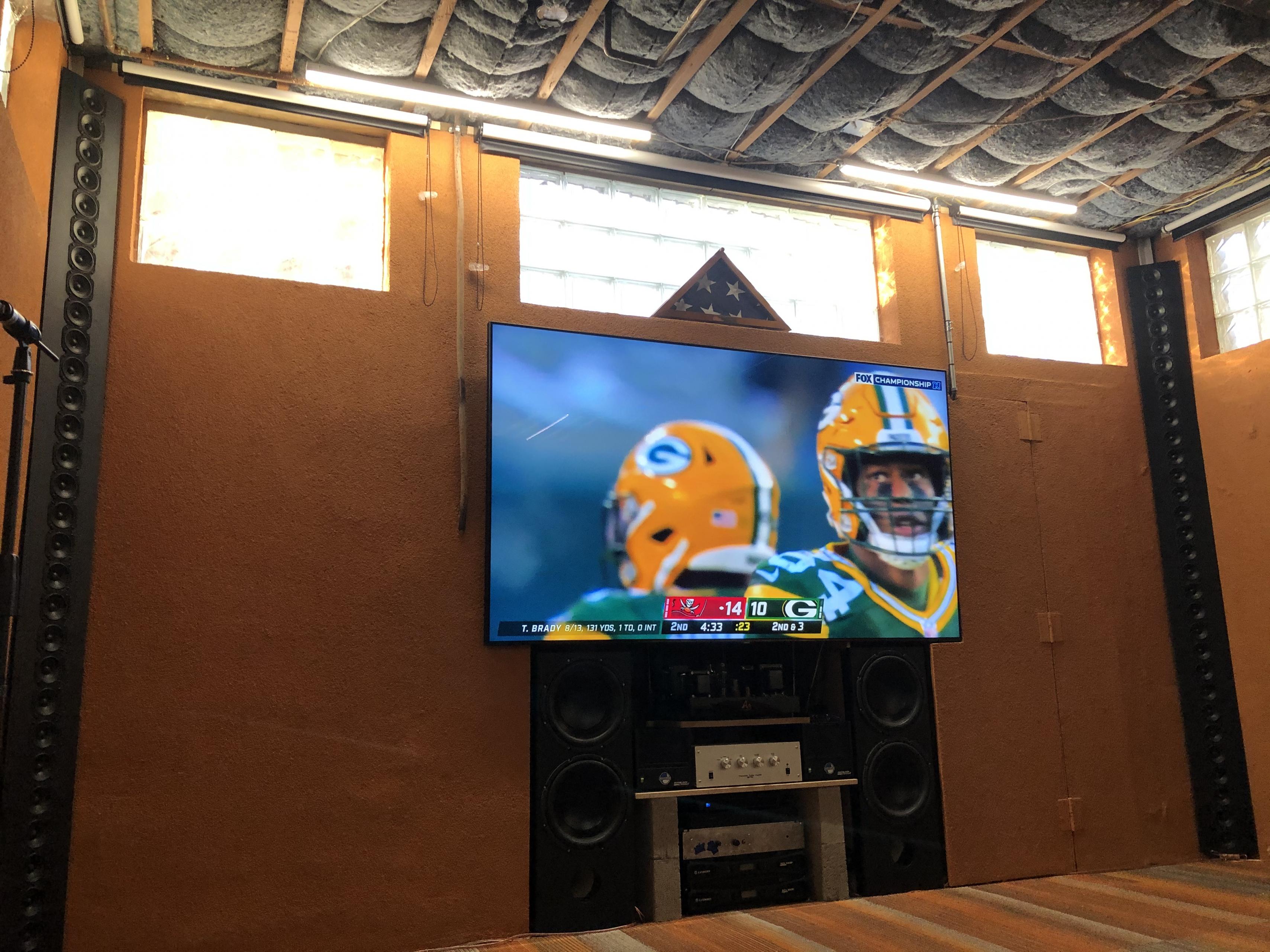

I did finally get the rough version of these 30 driver arrays finished this weekend.
Just got them hooked up, now time for running some sweeps to see the response and then equalize/DSP and such.
Ill try and post some pics. I didn't take as many pics as Id like, as it was all I could do to even try to work on them.
Also who needs to see more front baffles with dozens of 3" hole saw cut outs lol.
More to come.
P.S. I did have a listen to them straight up as is (no EQ)...... as expected they did not sound so good!! 🙂

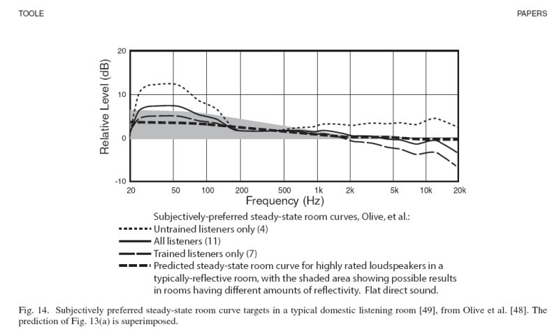

Are you going with that mini-DSP you mentioned? Try to get a feel of what's happening in the room by measuring at a few spots before deciding upon an EQ strategy.
As far as a room curve goes, I'd recommend the JBL trained listeners curve to get you close. Move on from there.
attachment.php
I always end up close to that curve. You can vary it a bit from there to zoom in on something that sounds great. Just experiment a little.
