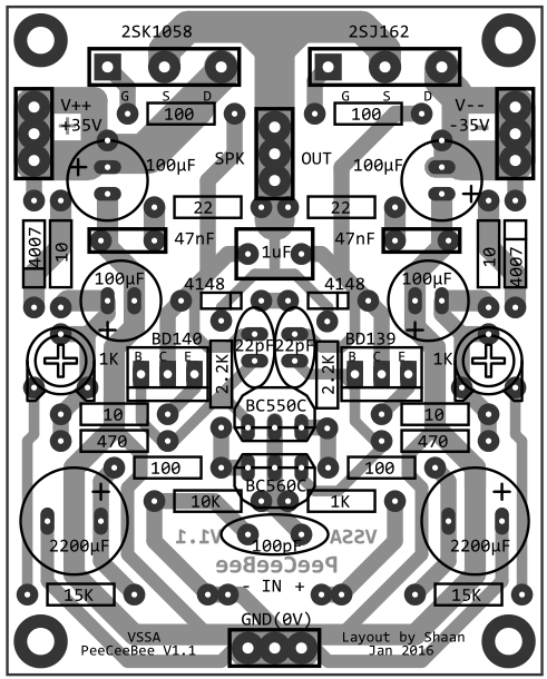

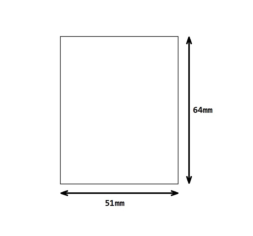

Superb @ Shaan... Wish these layouts were uploaded earlier ... lol. Right Now i am Working on Another 2 Projects .. Cresecndo ME and Bryston. I had yesterday received the SKs (Toshiba Mosfets) for Crescendo. And Now i have to Itch the Boards, Drill, Component Assembly, Make Enclosure for Crescendo ... lot of work there.
To those who would like to know what changed in the V1.1 layout from V1, here are some details.
> smaller size, 2" x 2.5"
> correct pin spacing and orientation
> miller compensation
> symmetrical zobel at output
> larger PS decouple caps
> better component placement
> no input capacitor
> much better and easier offset trimming with small plastic trimpots
Cheers.

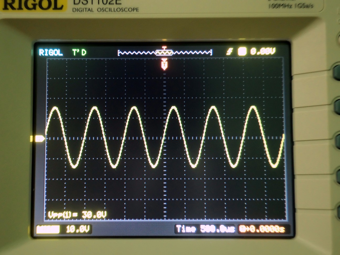

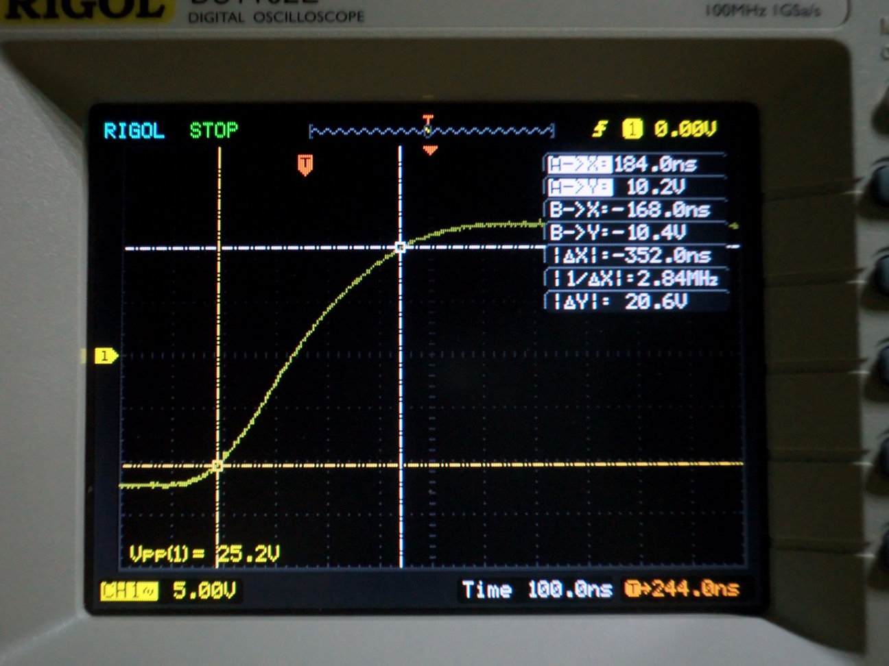

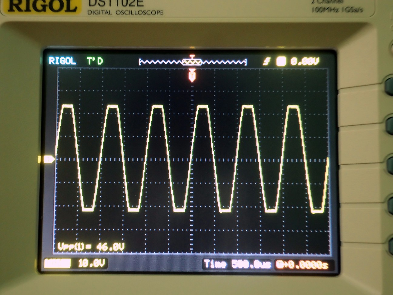

Here are some traces of the V1.1 PeeCeeBee. All tests done with 10R resistive load and +/-30V PS, zobel disconnected, 100pF at input and Cdom installed.
Pic 1 - 1KHz response
Pic 2 - 1KHz moderate clipping
Pic 3 - 1KHz high clipping
Pic 4 - 16KHz 80nS rise time input squarewave measured at 25VPP output.
As you can see, no sign of overshoot, rail sticking or other ill behavior. Slew rate is about 60V/uS. This is normal with compensation and input HF filtering.
This concludes my tests on the V1.1.
Distortion performance can be found here Post#1900
Coming next - V2.
stay tuned! 😀

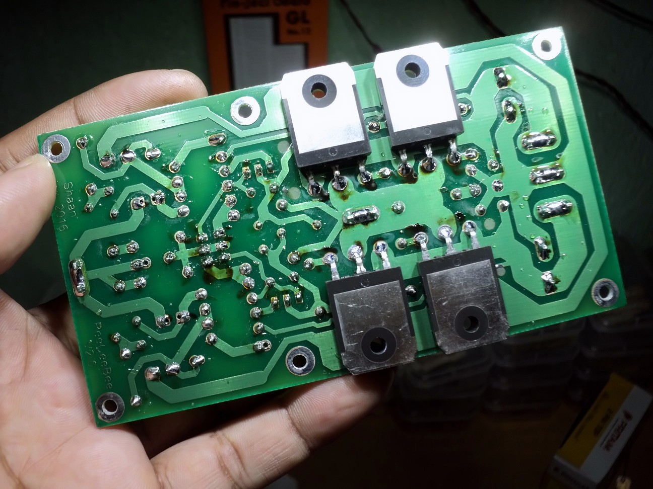

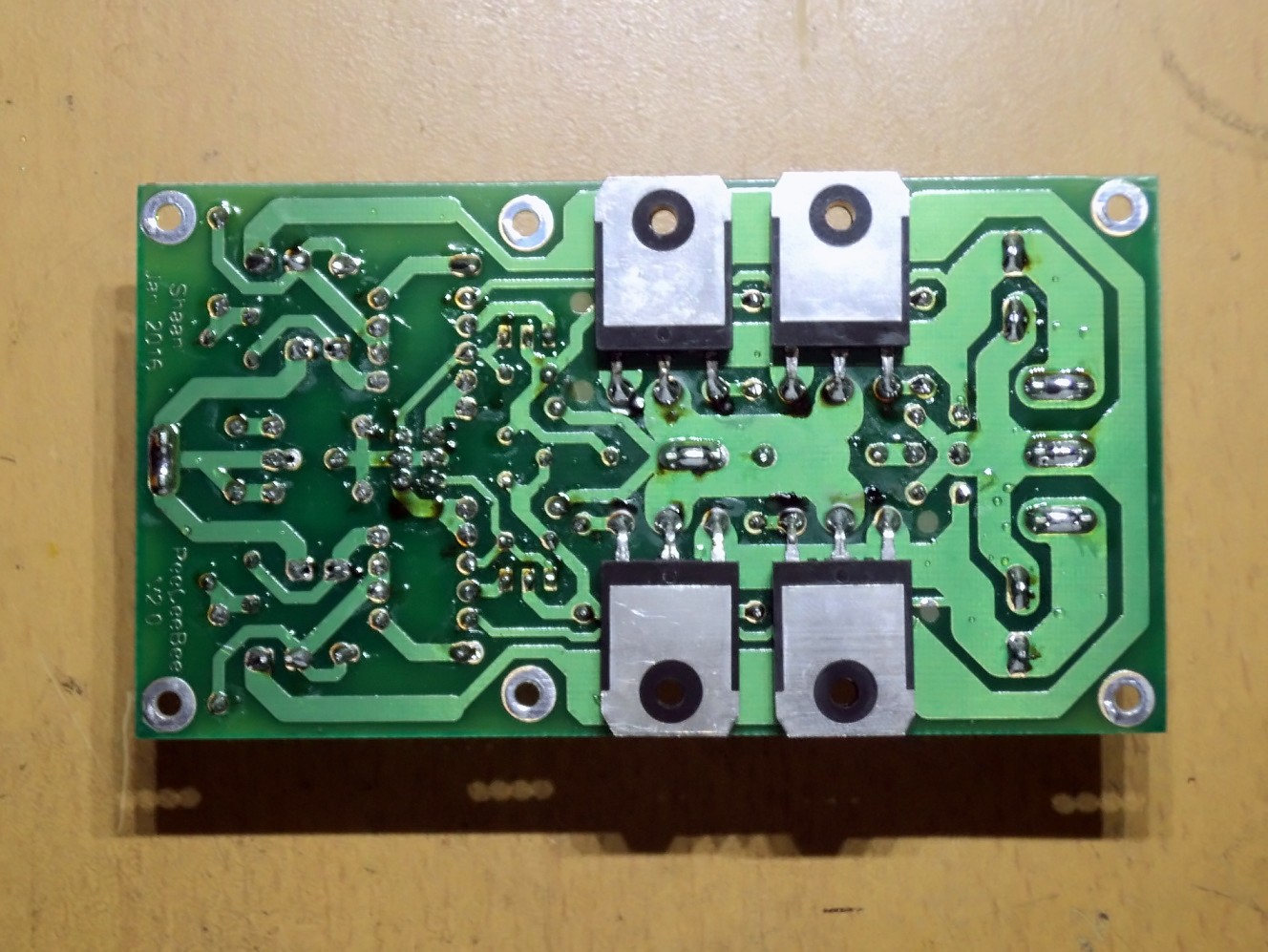

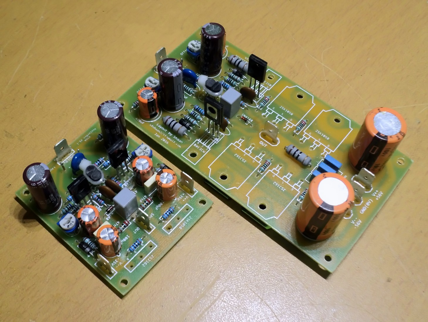

The populated V2.
Assembling was easier than I expected, and the assembled board looked also somewhat better than expected.
FET legs bent at 5mm from case and that's it. The VAS trannies are standing instead of lying because I like them that way (and because I have only metal washers now.) 😱
Anyways, nice huh?
