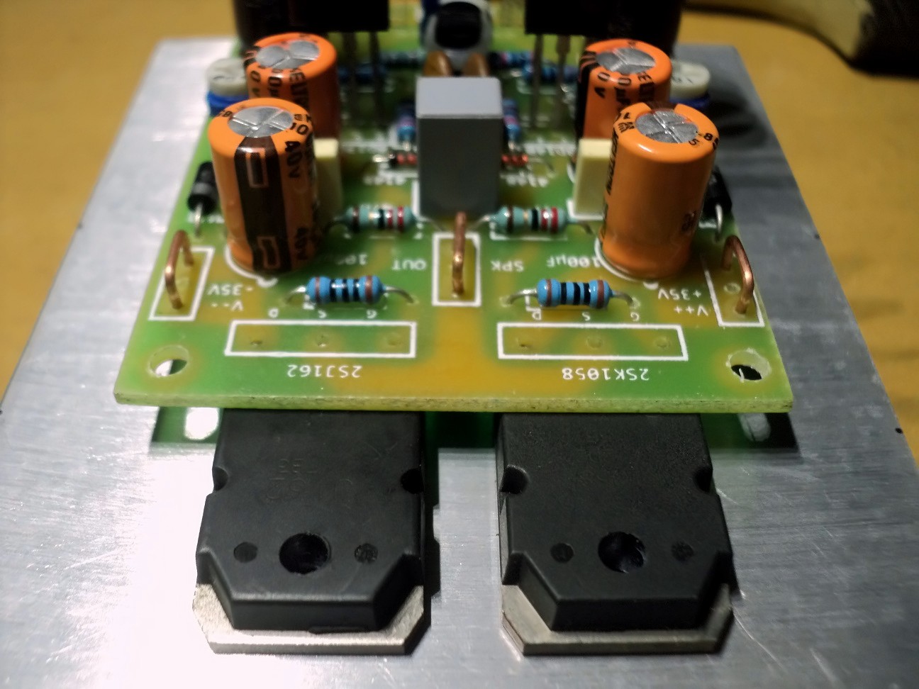

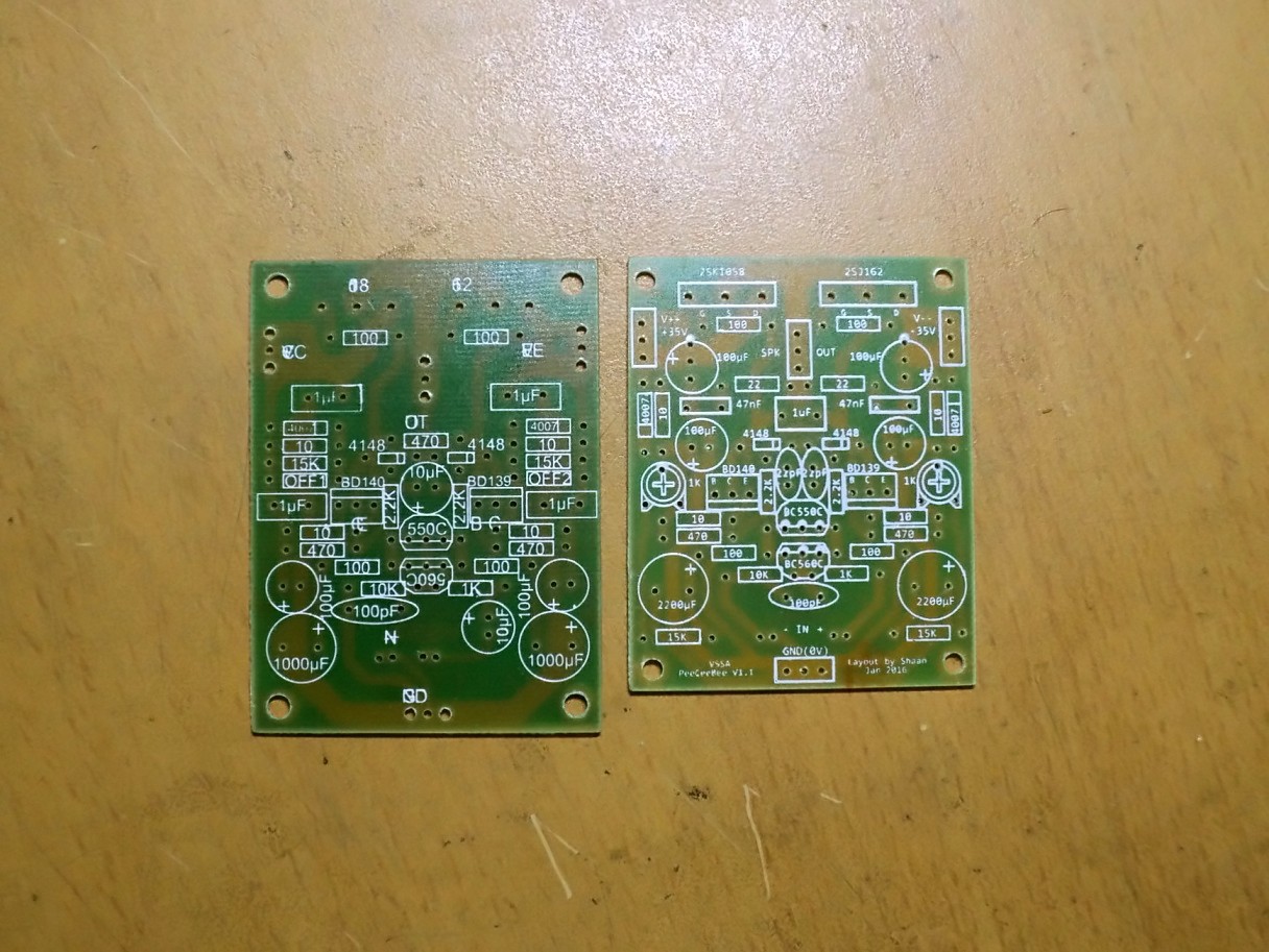

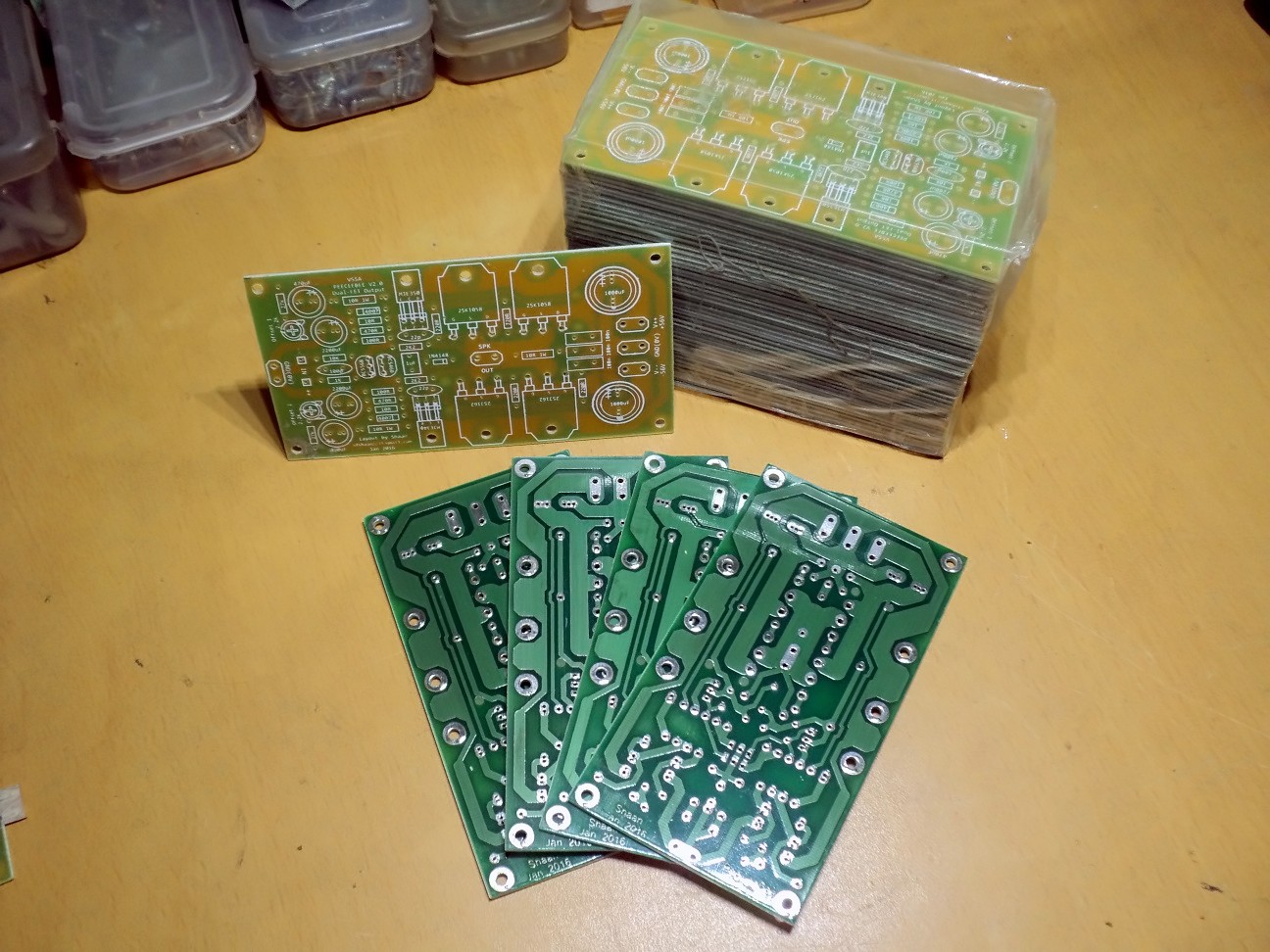

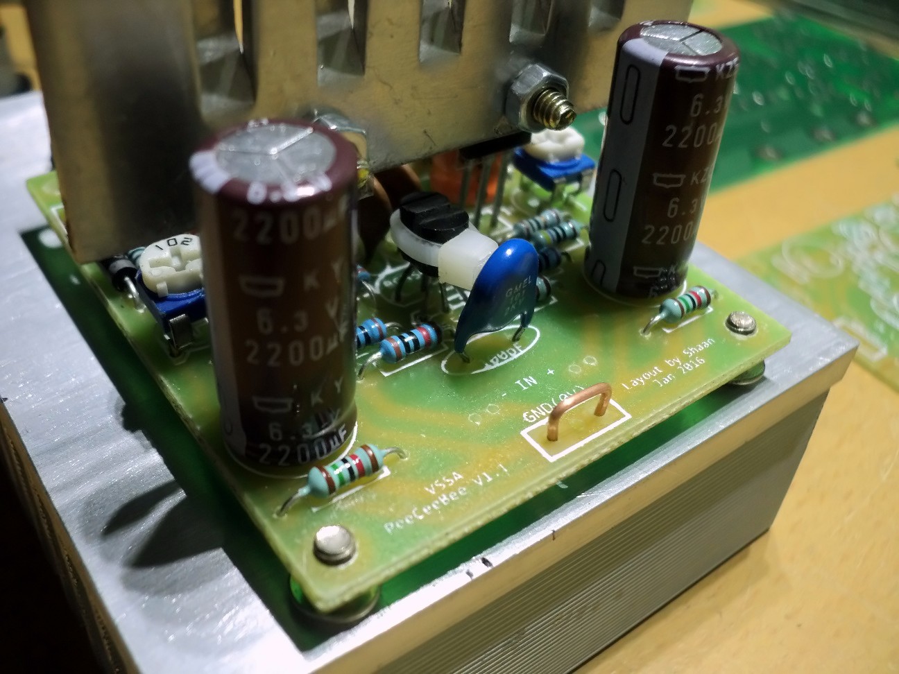

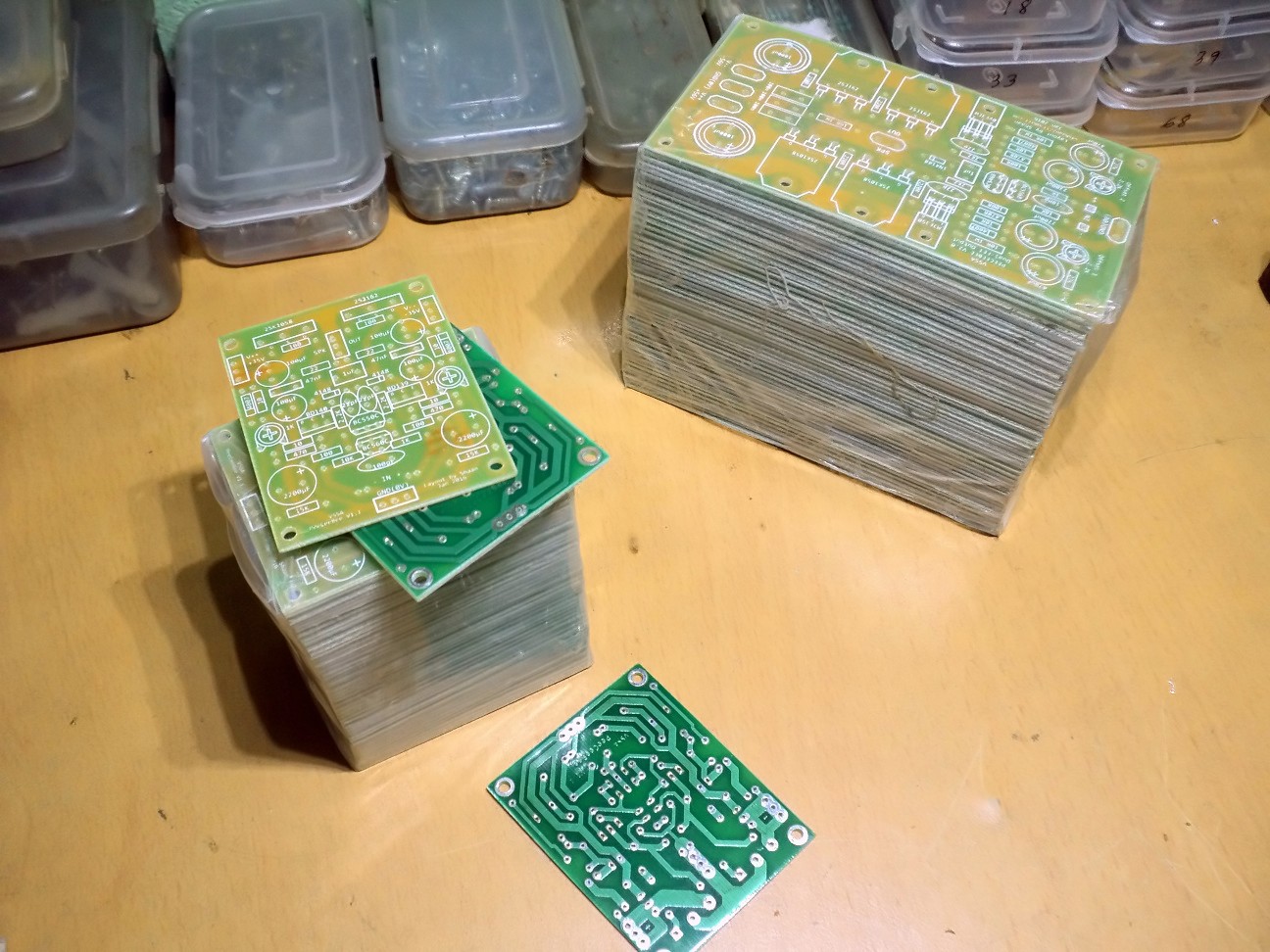

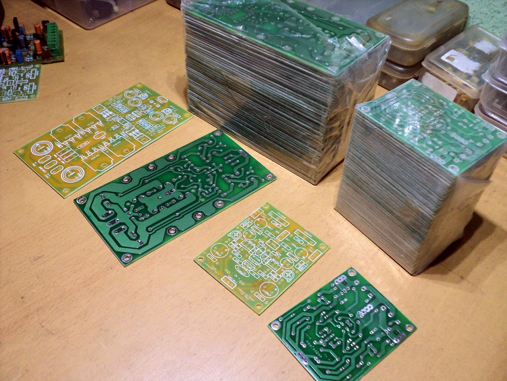

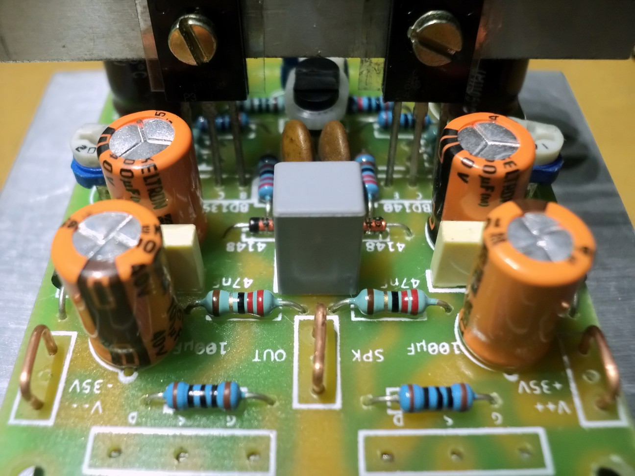

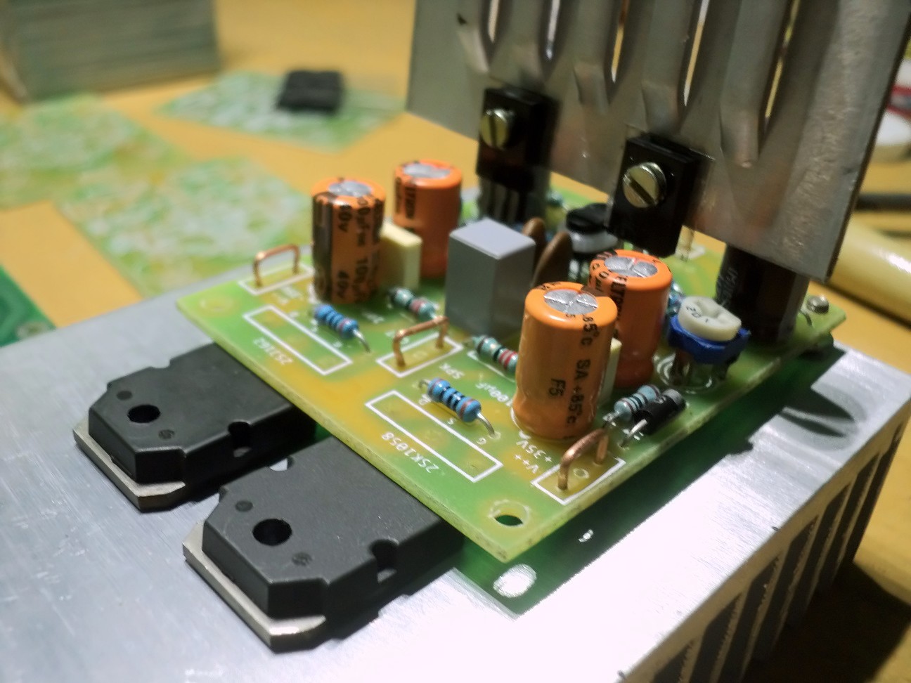

And here we go! 😎
V1.1 and V2 reach home this morning!!! 😀

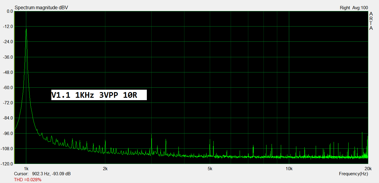

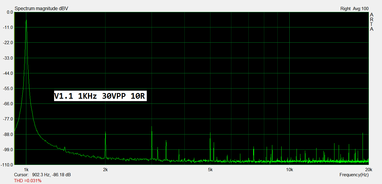

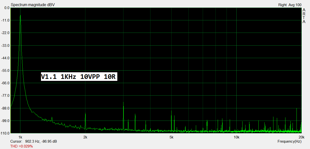

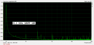

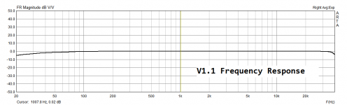

Some measurements of the V1.1 PeeCeeBee. Measured after an 11:1 attenuation from the resistive load.
Pic 1 - 3VPP into 10R.
Pic 2 - 10VPP into 10R.
Pic 3 - 30VPP into 10R.

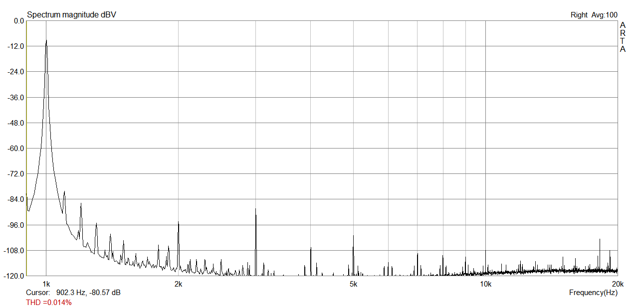

Pic 4 - Residual distortion of soundcard output.
Pic 5 - Freq. Response from 20Hz to 40KHz.
Notice the first three pics. THD reading showing nearly static distortion of 0.03%. Also notice the noise floor. Now, my PCs 1KHz residual distortion is about 0.014% shown in pic 4. So you do the math. 😉
The cutoff slopes in the freq. response trace is due to my sound-card's internal LF response and sampling rate limit.
Coming next - clipping and slew performance.
