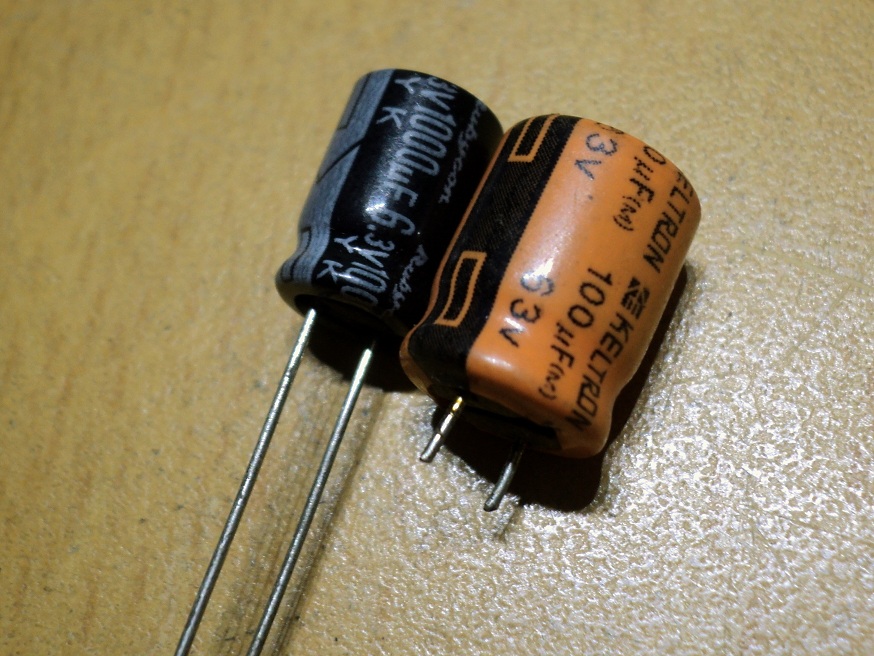

PeeCeeBee
I think those caps are okay.
hi, amp keep destroying, clipping then burning resistors. already have 470pf comp caps, up from 100pf. 10ohm resistors keep burning out. 36v+/- and 15k bias. can i increase bias resistor, make it more stable? gate stopper from 100ohm to higher to more stable? what are my options? thank you.
my homemade pcb ground very bad. but i want it work here. so i need make it more stable, worse sound 🙁
Can you post some pictures? The circuit design is fine so you must have some other issue going on, even a bad or fake device somewhere causing you problems. If your layout is bad or the board itself has a fault you may be forced to move your components to a known good layout and make a new set of boards. No point trying to 'fix' it if there is some very fundamental problem causing your greif.
Of the four 10 ohm resistors in the circuit which ones specifically are being damaged? Have you measured the voltage across the ones in the VAS emitter circuits to see how much VAS current you have? Have you measured how much current the board draws in total?
