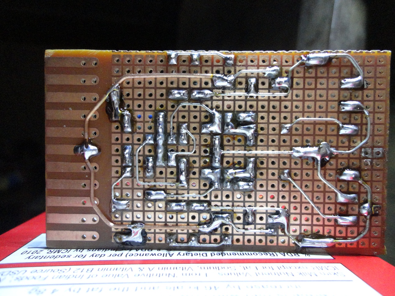

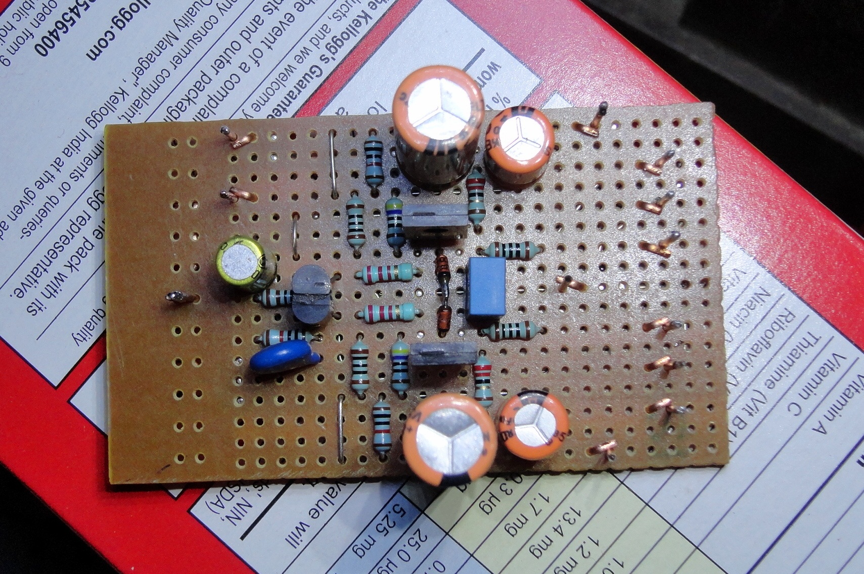

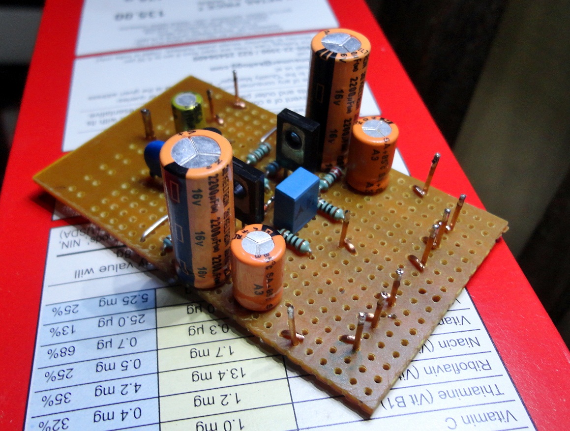

Why not. I too encourage P2P builds. For reference, attached below is my take on VSSA for the very first time, on veroboard. I think component placing has a big influence on stability, as this little ugly guy was stable since its birth while sonically resembling its genus, the :worship:SSA:worship:.

Nothing ugly about your P2P implementation. I would be proud to perform work of this quality.

Hi Shaan,
For the interconnection, are you utilizing the resistor lead, or using another appropriate wire size to connect the parts?
BTW, your veroboard looks great and pro! 🙂

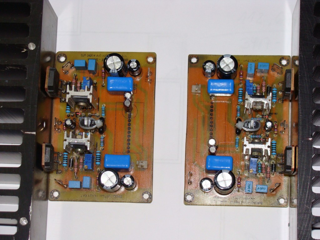

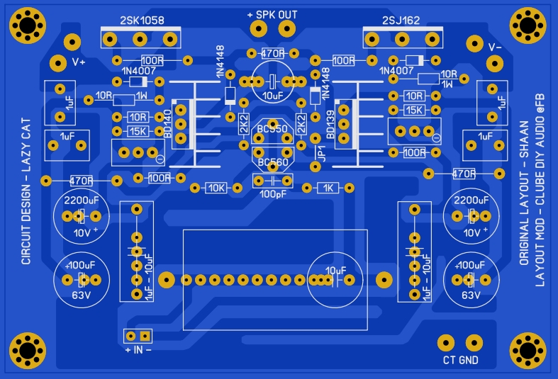

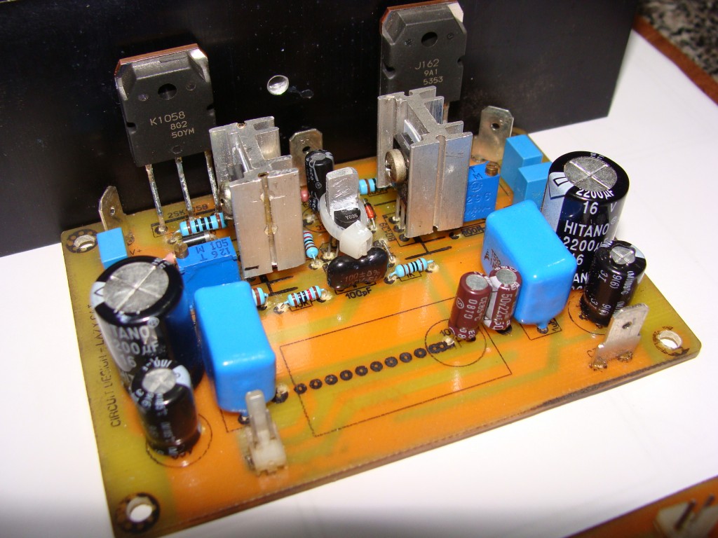

A while ago I posted the board that we made based on the Shaan's layout, but with minor changes (basically a extra polyester capacitor). Here are pictures of our board (shaan excuse us if the card does not fit the purpose of the topic, but we did tests without the polyester caps and the results were similar, and we are thinking of discarts it). We are in the fight to solve the problems and doing tests. Thank you for your attention. Hugs.

Watch out the BD139-140
Depending on the producer of BD139/140 it may be even necessary to use compensation caps with them. Some BD139/140 transistors are prone to oscillation.
This is true, I just remember that I also has a problem with the BD139-140 too...
before I use the BD139-140 I check their the hFE with DMM, I use higher hFE around 200+ closely match hFE. I thought it good cos it higher hFE,
but I was wrong, got burn 4 pcs 10 ohm resistor because of that transistor.
Then I replace with another grade BD139-140 hFE around 150-160 & I still use it until today no bad thing happening again, just lot of good thing 🙂
I'm also add the compensation caps + zobel too (long & big speaker cable)
