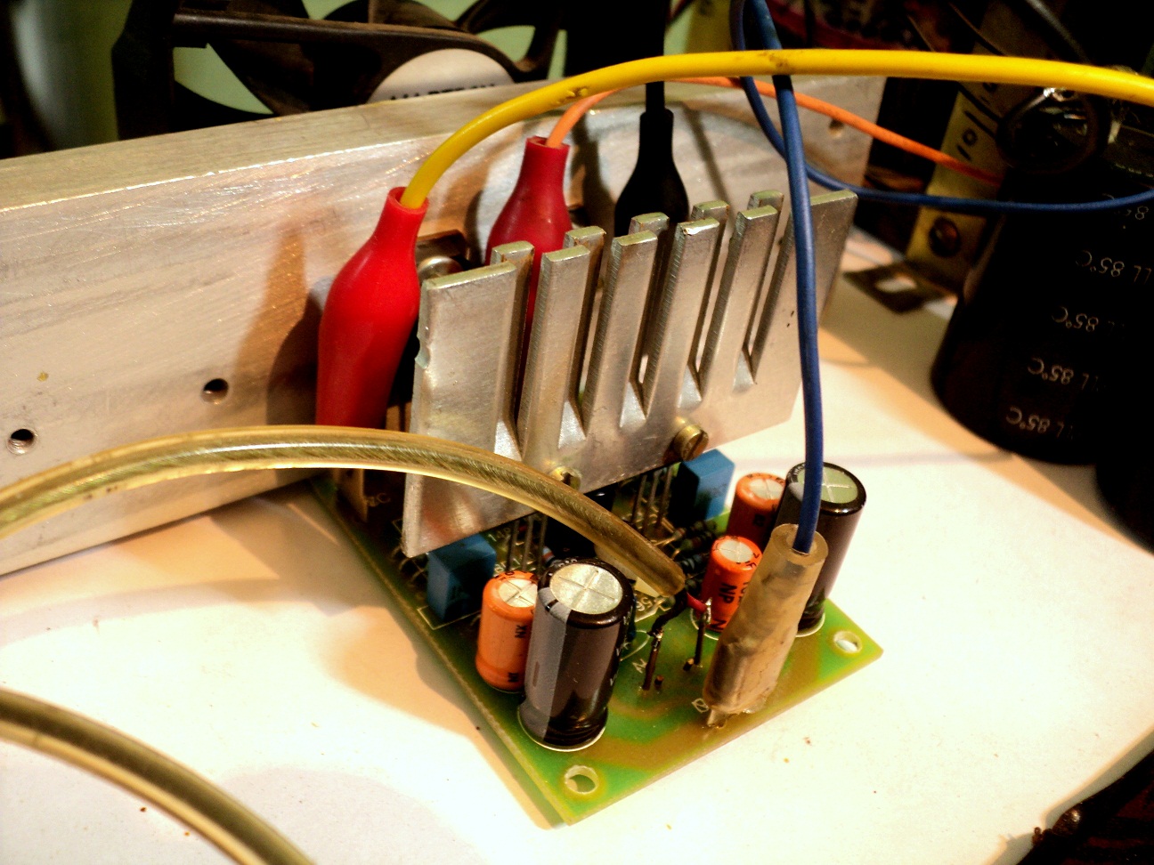

Hi Shaan,
I'm waiting the picx... 🙂
Here they are... 😉
VAS transistors share the same heat sink, current source is the default 15K, offset 20mV default. In final setup main heat sink will be way larger than the one currently used with fan cooling. 😎

Here they are... 😉

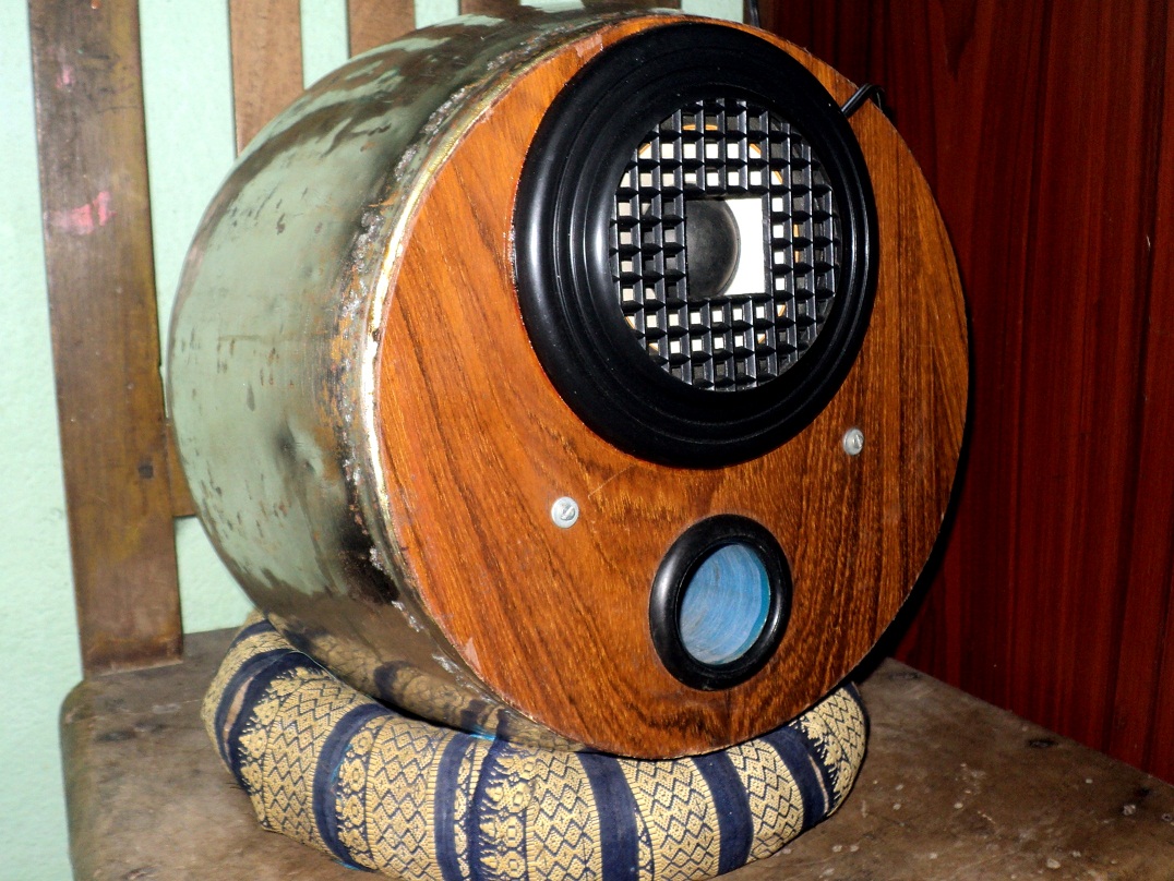

The sub must be better than my pipe's one,
I think I should make something like it too 🙄
so I have 2.1 setup too...
How about the sound,
with your PeeCeeBee any speaker will be shackin'
& can show their potential
people around will amazed with the sound produced

Hi John.
Nobody can beat your pipe speakers, most innovative DIY enclosure I will say.
Yes the sub has superb bass with PeeCeeBee, and cone control is just excellent, better than any amp I previously tried on the sub. It's just a 4 inch little guy, but trust me the kicks and basses seem like 40 inch hehe.
I played Akon's 'I wanna love you' some days ago, to see how it manages with the track, it did better than I expected. All the doors and windows were shaking with it, it was fun.
I guess the sub, with the particular driver and port, is at optimum tuning. Although I didn't do any mathwork/calculation of any kind before making it. Just put it all together and eventually dug up some hidden treasure.
I have plan to build another, with a little bigger enclosure and driver than this one.
Happy listening.
