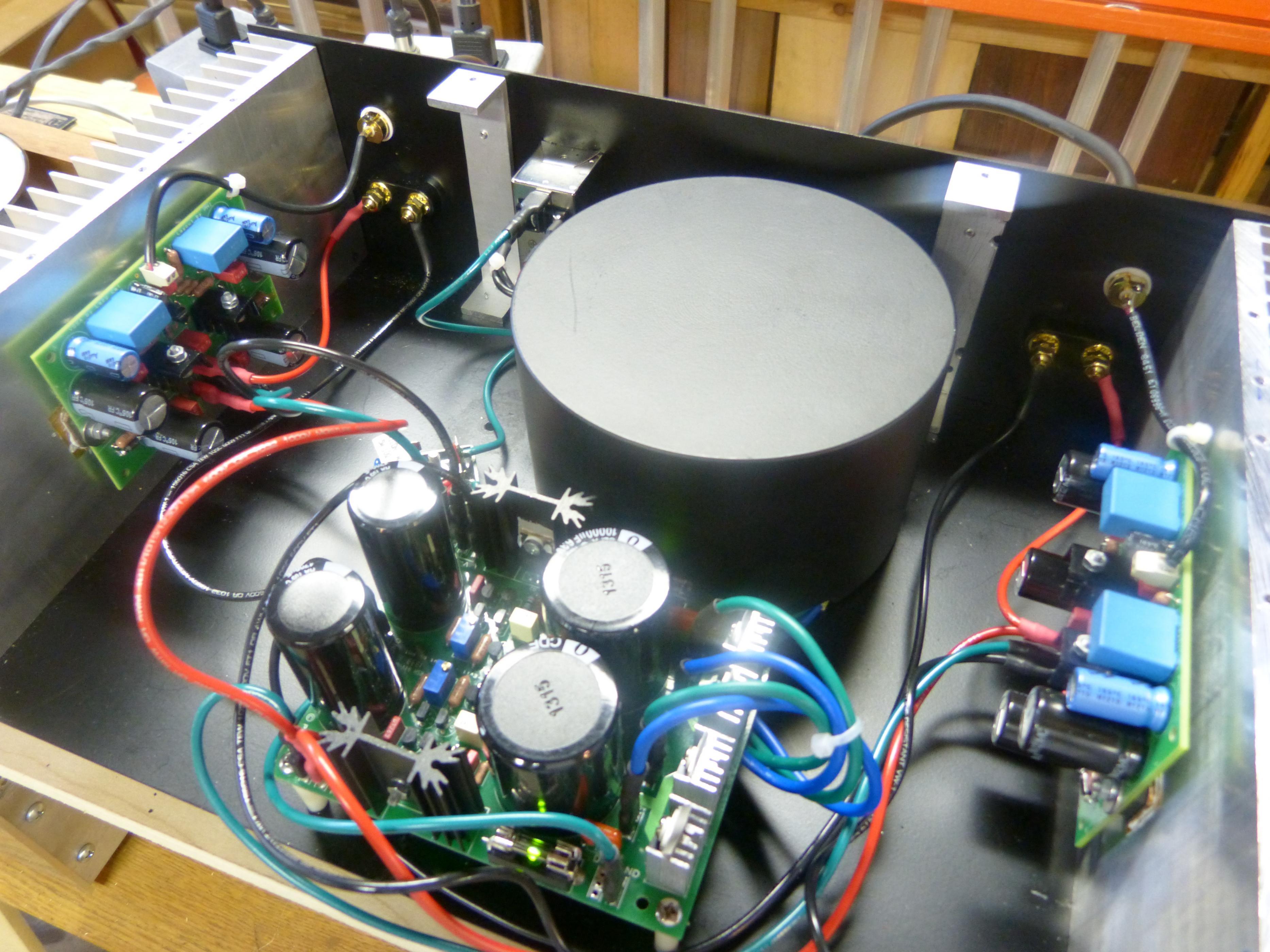

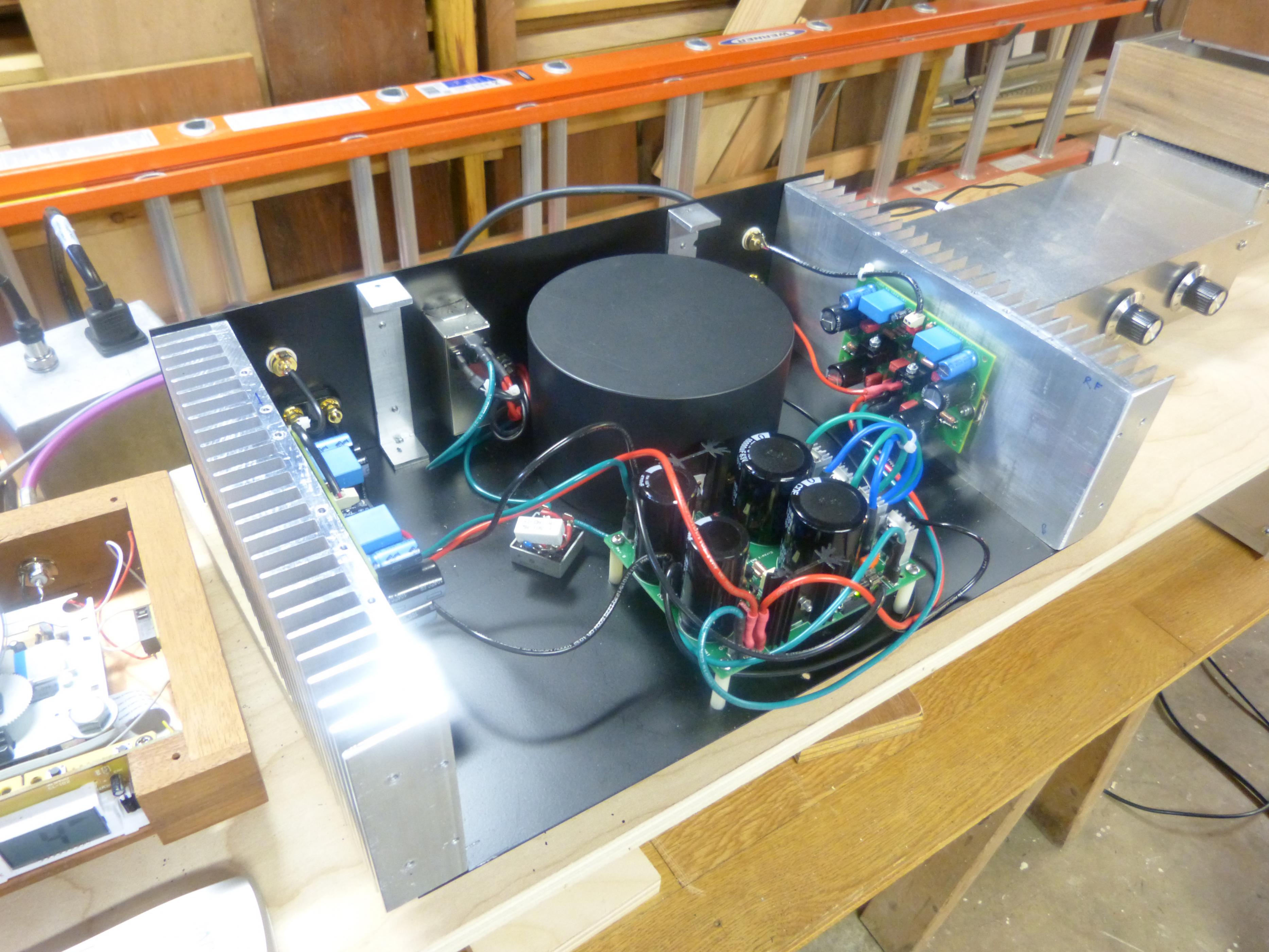

Hi Everyone,
this is my new peeceebee.:D
as you can see, I'm using the Mr. Evil/PMI capacitance multiplier psu. I'm really loving it and it would be my favorite amp except that I have a hum I cannot solve. to me, it sounds like the typical 50-60hz hum.:scratch1:
I originally built without the transformer cover, but it has not helped. since my first version I have also increased the size of the cabinet. the hum is audible maybe 2 feet from my woofer but not from my listening position. However, if I put the peeceebee in my bi-amp set-up, the hum becomes audible from listening position. none of my other amps have this characteristics. I've swapped out power supplies, preamps, the ground loop breaker, and have tried many variations of ground connections, but nothing seems to impact hum at all. even when I assemble full enclosure, no change.
the hum is acceptable (did I mention this is my favorite amp!) until I put in the bi-amp rig. Has anyone else experienced this with the peeceebee? Any recommendations?

.....except that I have a hum I cannot solve.....
Hi very nice build/setup looks good. Maybe this purpose ends as air, but then tried as not a reason. Do they big washers on output devices touch anything and make any unintended ground loop. In middle of amp board you have empty ground point, try connect it to both VAS heatsinks by leads. Have you tried different voltage drops on CM PSU board. Last guess, those lytics feedback caps are 2,2mF, if under 1mF here exchange with at least 1mF (those caps size do change amps behavior in lows, just where you have misbehavour).
Thanks , BYRTT. I'm in process of changing position of trans and psu to eliminate the grounds that encircle the trans. I failed to mention that I'm using PMI's amp boards which have a convenient ground connection between the small heatsinks that I did not think to use. Thanks for your help. I will report back shortly. Cheers!

Just my guess, the heat sink of one trans of the cap multiplier may have attracted some stray magnetic fields from the trafo and disturbed its function properly since it touches the cover metal. Try to make some distance away from it.
Regards.

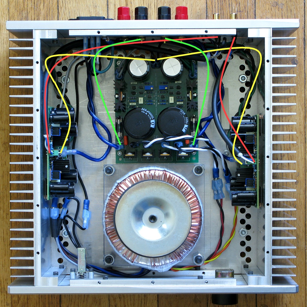

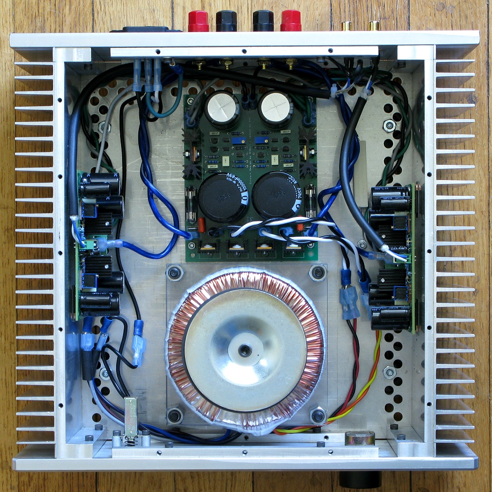

Ground Connections
Just for reference, the two pics below show the ground connections in my test chassis. Ideally the two RCA's would not be in one corner, but the chassis was originally made for something else.
I tried to avoid looping any signal or ground wires even partially around the transformer.
Red: Signal Ground. Separated from Power ground by a small ground lifter resistor on the VSSA/PeeCeeBee board.
Yellow: Power Ground. Closest ground connection to the 4700 uFd output caps.
Green: Speaker Return. Closest ground connection to the 10.000 uFd main reservoir caps, and to the rectifier. Bypasses the PSU ground bus where the filter circuit ground connections are made on the PSU board.
There is one ground connection for every power take-off on the PSU board, so other configurations are just as easy.

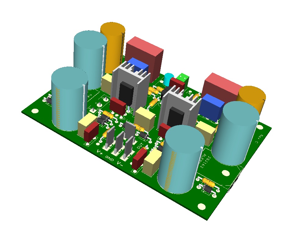

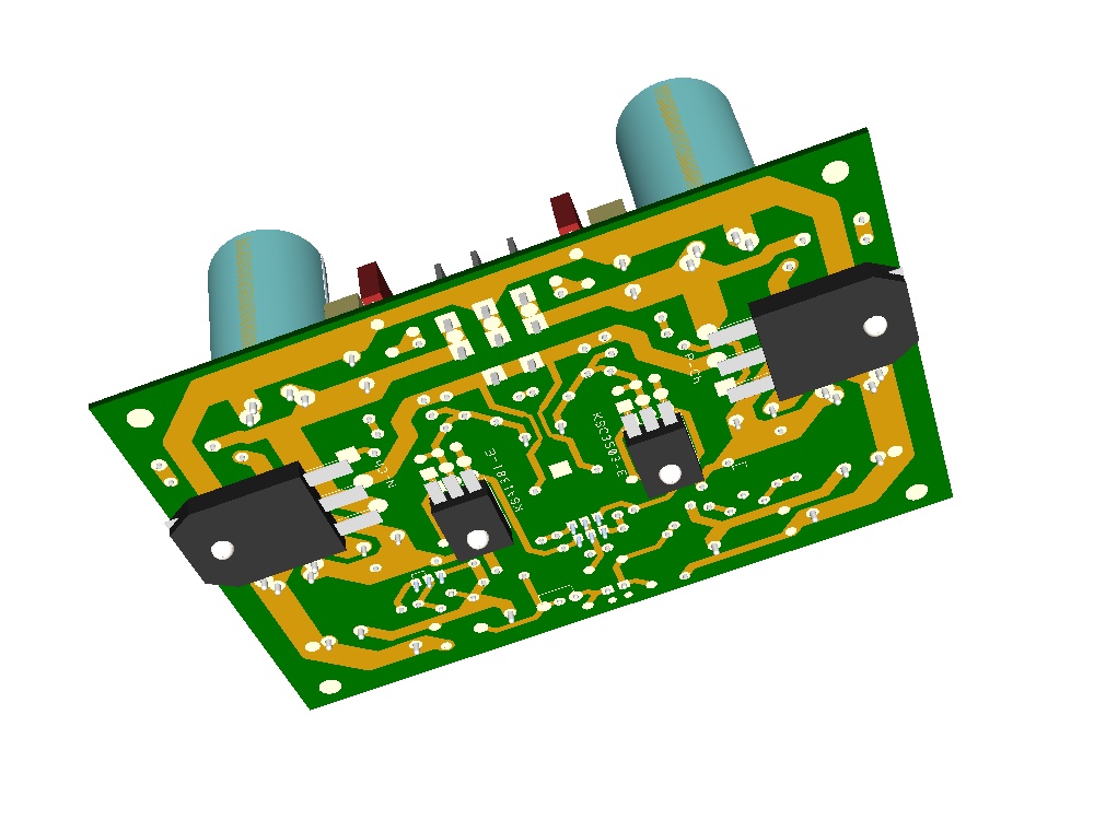

PeeCeeBee/Through-Hole VSSA Layout, Revised
I finally finished my PeeCeeBee layout revisions (almost exactly 5 months after the first layout). This will make the 4th version of VSSA for me, including one built close to Shaan's original schematic, one close to Version 1.4 of the original design, and the VSSA modules from LC's first Group Buy.
Some small component spacing issues and hole size problems have been fixed, and the circuit board will now accept a wider range of capacitor sizes and VAS heatsinks. This includes a standard U-shape heatsink like the one used in the last version, and the H-shaped heatsink with extra fins I used on the Cap Multiplier power supply board.
VAS transistors can be mounted on separate heatsinks as shown in the first model pic, or on the main heatsink along with the Latfets, as shown in the second pic. This should allow higher supply voltages, and a little more power per channel.
The circuit board will now accept Renesas Latfets, or the ALF08N/08P. With regard to the Alfets, pads for protection diodes ahve been added.
Aside from that, the original concept is still the same. The circuit board can be built close to Shaan's schematic at the beginning of this thread, or closer to the Version 1.4 schematic. With or without the 10uF parallel caps, with or without the Jfet CCS, input cap or direct coupled. Still single layer.
Conventional through-hole parts only, no exotic or unobtainable parts, and lots of room to experiment, and have fun... :D
