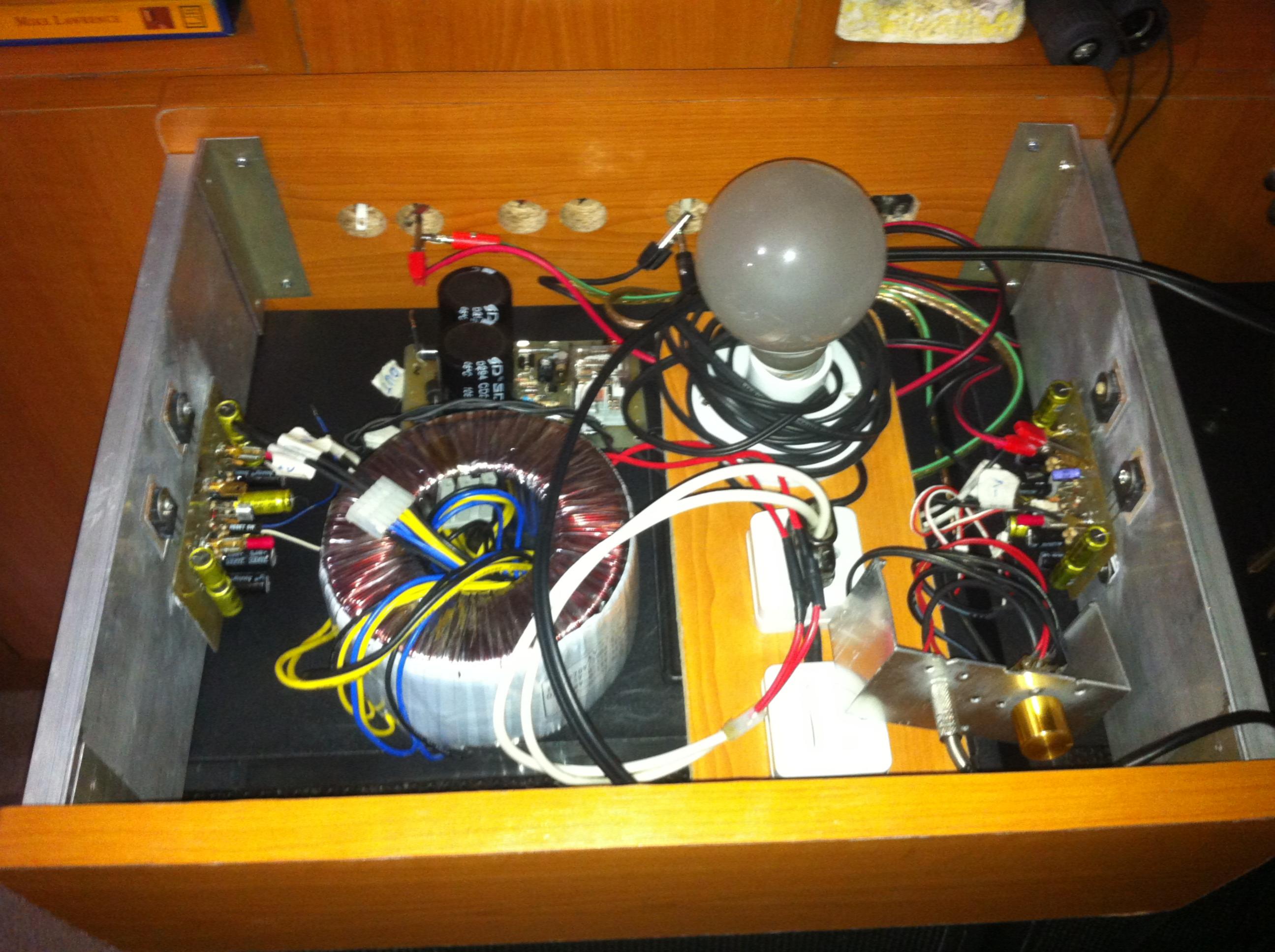

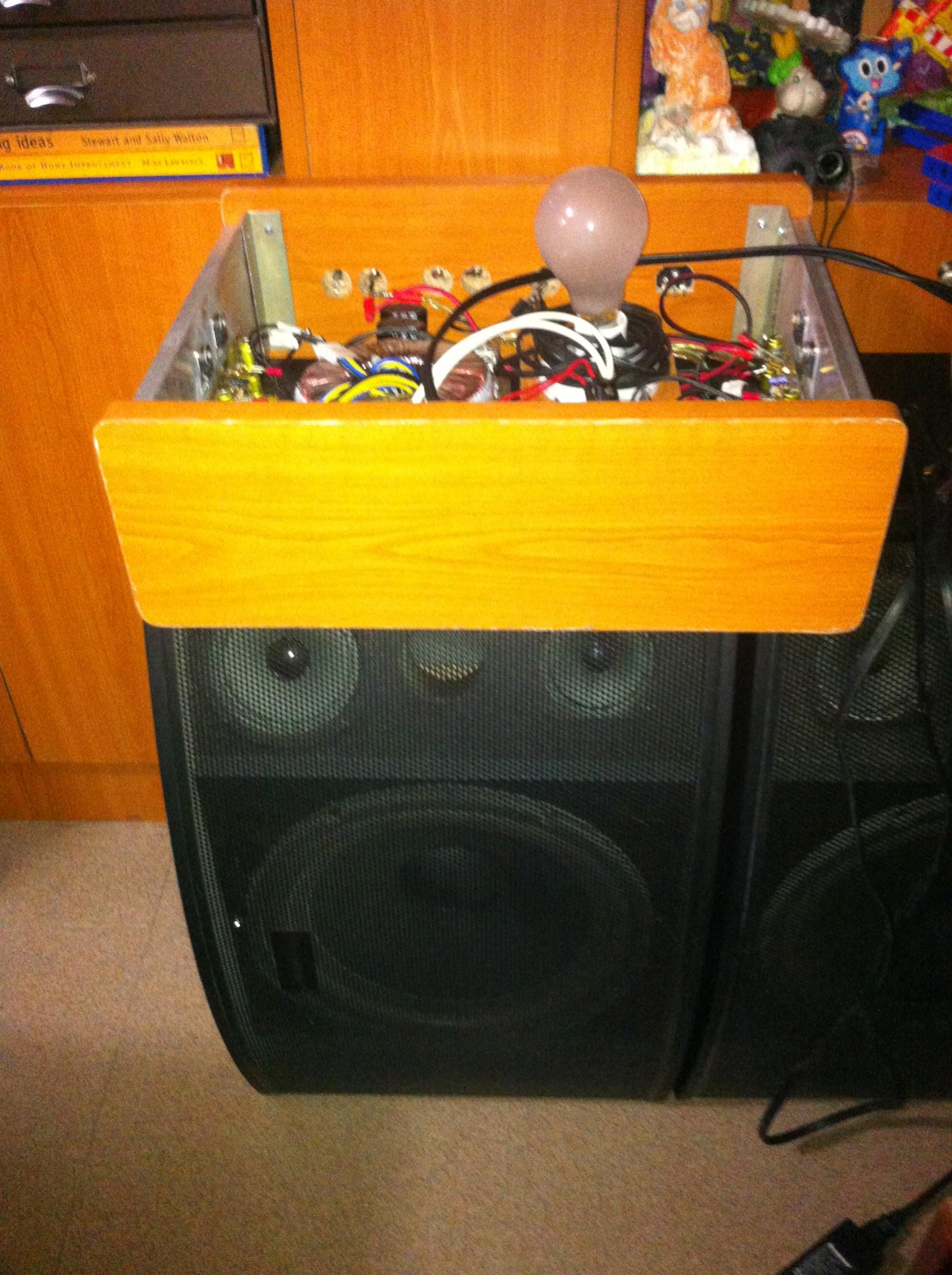

My PeeCeeBee
My build sitting on an unfinished home-made case.
I am always guaranteed of good music that comes out of it while waiting for my other case parts.
Here is my novice experience during the build:
1. I ensured the two 2.2k FB resistors were closely matched.
2. I ensured the two 100R FB resistors were closely matched.
3. Since I didn't have instrument or jig to match hFEs of BC5xx/BC4xx, I just measured the base-emitter resistance, and base-collector resistance, and ensured that they closely matched. My point was since matched transistors were hard/difficult to find anyway, and some parts in the circuit contained unmatched parts in a certain way, I thought I could live with this situation without imposing hard-rule strictness to the match hFEs requirement. Being close to a match was acceptable I think, and I reasoned also that hFE profile was in anyway not guaranteed to be the same during operation even if it was pre-matched and one would tend to be hotter than the other, etc.
For above, I am a newbie so forgive me of this little ignorance. 😀
4. First channel, I put compensation caps of 24pF since I observed that the output DC reading was not steady. When it became steady, DC offset can be read but needs to be lowered. Putting a parallel resistor of high value (from 150k to 2 MegaOhms) can balance this DC offset. It can be done by clipping an alligator clips at both ends of the 15k resistor, and connecting the other ends of the alligator clips with the trial resistor. In my case, I found 330k resistor was appropriate with the DC offset reading down to 2mV. Contented with the value, I soldered it on the board.
5. Second channel, DC reading was steady so no need compensation caps. DC offset was 150mV, and I found 1.9 MegaOhms resistor which lower the DC offset down to 5mV. Contented with the value, I soldered it on the board.
By the way, in this channel I used BC547B / BC556B while the first channel was BC546B / BC556B. Listening-wise comparison, the two channel is no different than the other.
Best regards.
