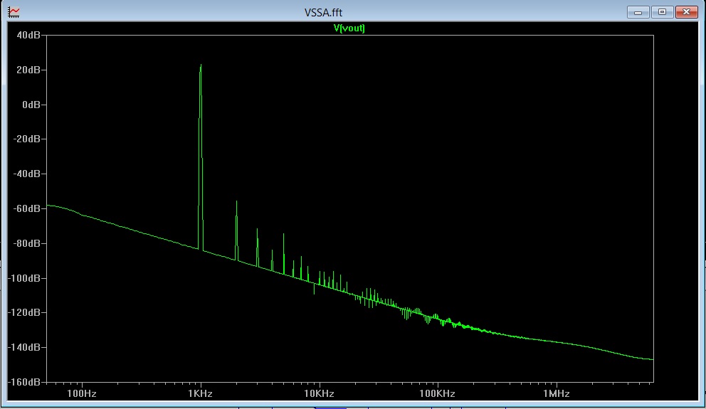

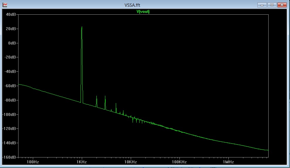

I attached the sim files. The models I use are the Cordell models.
  • VSSA.asc
    VSSA.asc

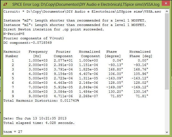

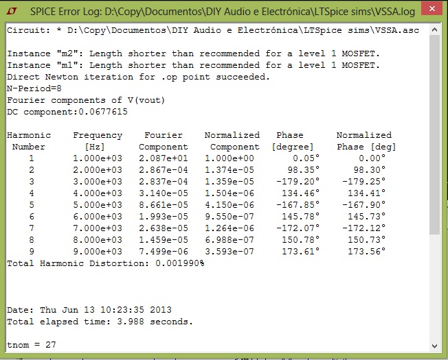

But I simulated with LTSpice both cases and the KSA's give me much lower THD. So, wich ones should I use?
Thanks.
I use KSA/KSC having 155-175 hFE and 5,6 pF Miller cap, 2,7 Mhz (-3 dB) with input filter and Zobel in action, now imagine. 😎

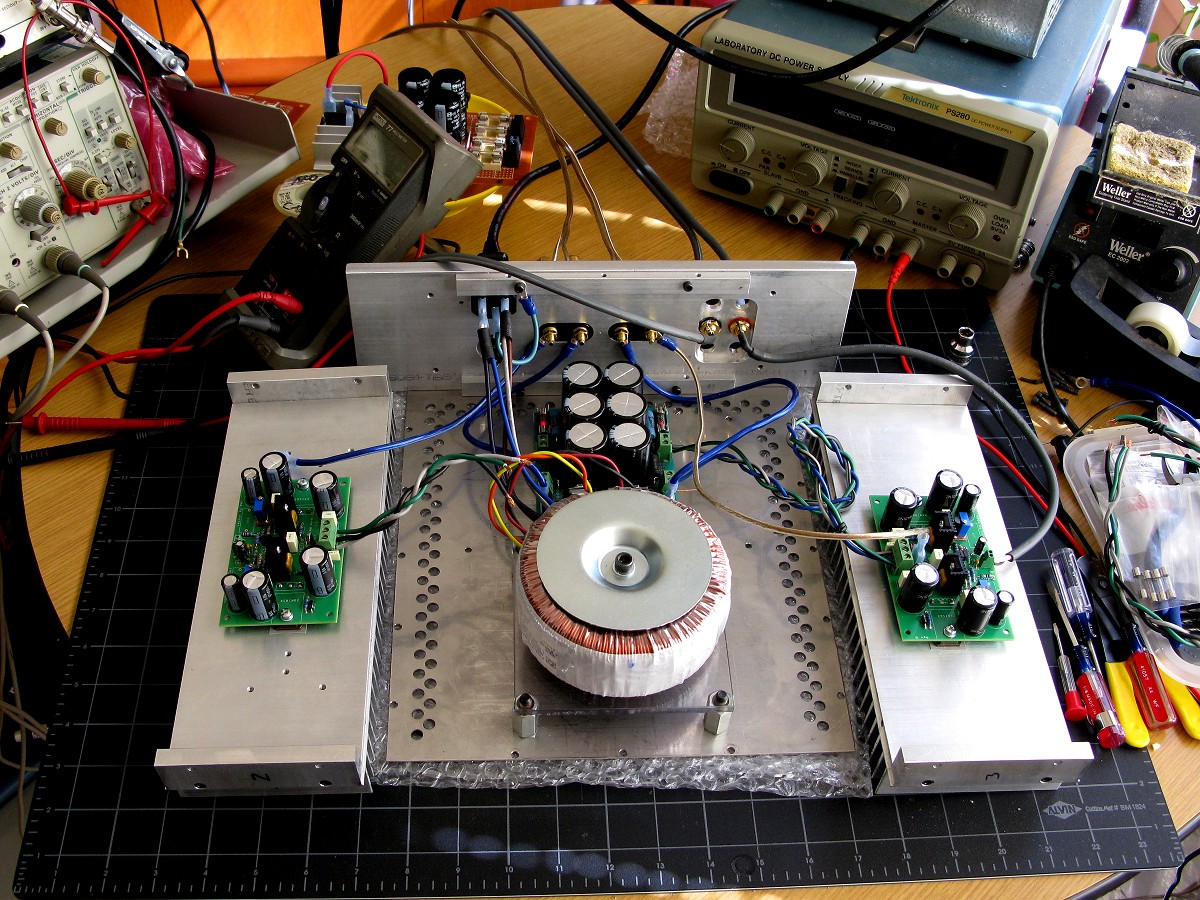

I had a bit more than 1 m, probably double that, the ground was disconnected from the chassis at the time, and one ground lead was intentionally looped about 270 degrees around an unshielded transformer.
I promise to treat your "children" with more respect, 😉
edit: this was about how the test setup looked

@Paulo: The tests being discussed here have to do with performance well above normal audio range. If you basically want to experiment with high frequency signals, this is great experience, not to mention fun. If you want a working amplifier to listen to... maybe not so much 🙄
If you have them use the Fairchild KSA1381/KSC3503 pair, if not use the faster version of BD139/140. Use the cap. It will not affect how the amplifier sounds, and it may save you some trouble later...
One thing I found today is that if you test with an unconnected/ungrounded signal cable which is long enough, the circuit can be made to oscillate very easily within the bandwidth of the input filter. I let some smoke out of the Zobel in the process, (pretty much expected at roughly 200KHz). Nothing is completely fool proof, I'll use 1W next time... 😀

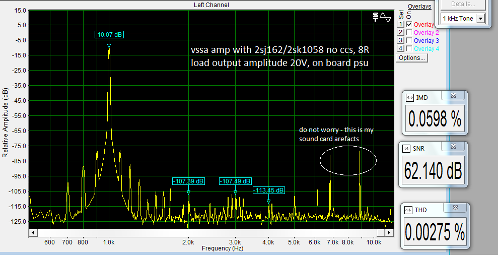

I am using bd139/140 group 16 with hfe around 200, very easy to match and there are insulated. THD is very low (version without ccs).
I do not know but it may be useful information, the shaans version with 2sj162/sk1058 have some very small noise when I put my ear to speaker, and there is some hum noise if I twist speaker cables (in the amp) or leave very long input cable. Now to the point, the irfp version is dead silent, I am checking supply voltage couple times to make sure the amp is on, even on scope everythink is clean - Is that due to higher Vgs voltage ? Maybe toshiba 2sj201 version with higher vgs would be better ?
