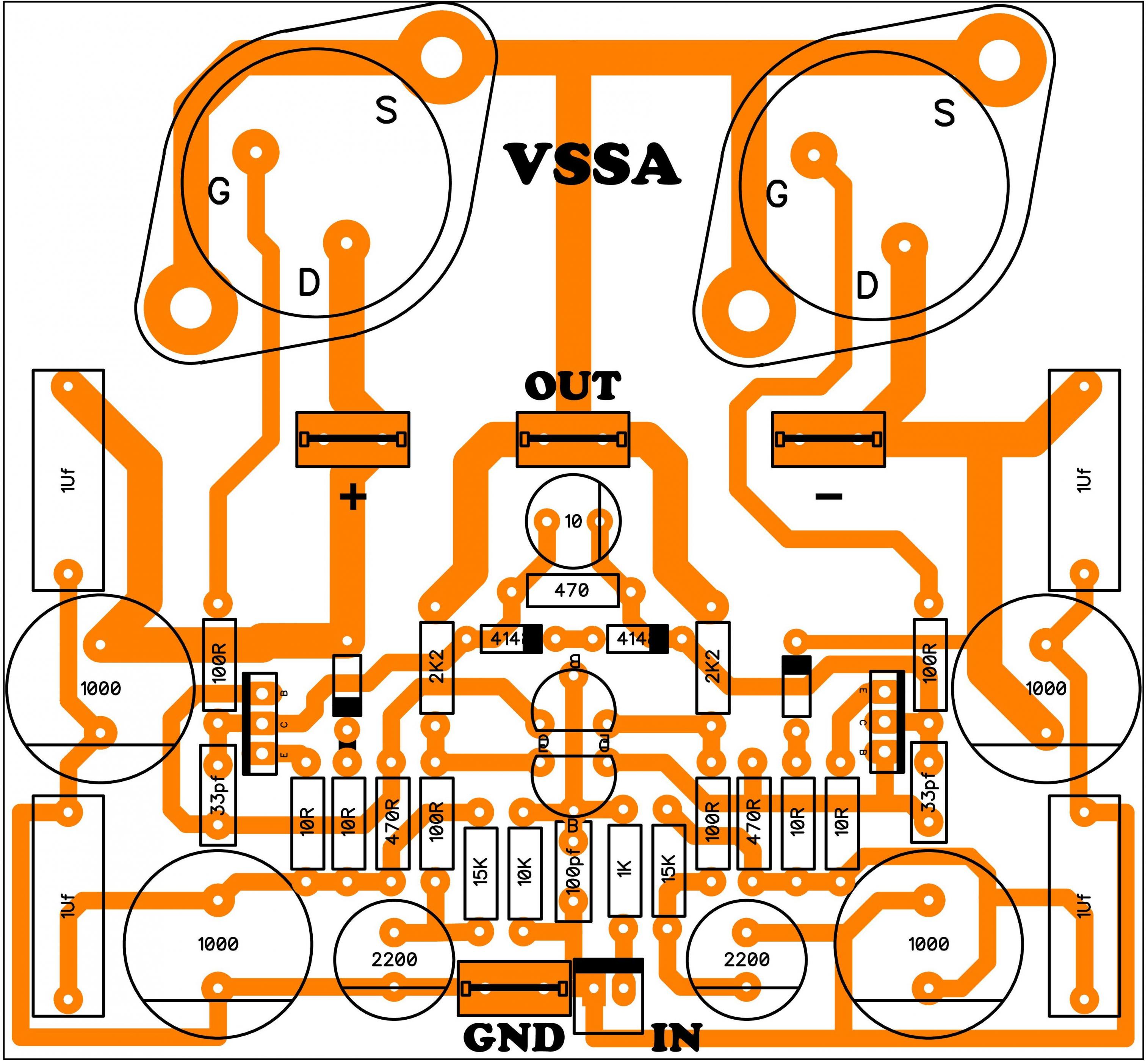

For discussion, here are the components on the pair of boards I have used for testing:
BC550/560, Fairchild/Mouser, matched (note that this was NOT a simple single-point match) thermally coupled (glued)
KSA1381/KSC3503, not matched, with 47pf compensation caps (planning to test w. 22pf, but have not tried yet), w. separate heatsinks.
2SK1058/2SC162, Renesas, Tayda Electronics, with 100R/130R gate resistors to offset differing gate capacitance. (note that if you go by the datasheet, this should probably be 100R/150R, not 130)

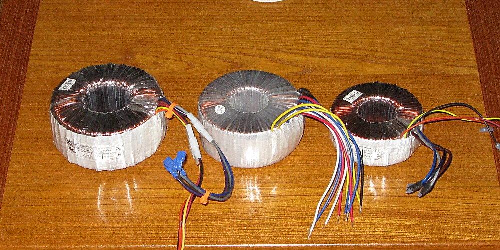

One single 250VA transformer for two channels, with plenty power to spare, but I am not designing a supply for a combination of worst-case conditions, or for class A. note the pic below, the 250VA is the little donut on the right (626VA on the left, and a super-special Hypex 500VA with all the extra goodies in the middle... 😀)
I am a bit reluctant to start this discussion here, because it will not satisfy anyone completely, and also I am not in any way opposed to big transformers, or large arrays of filter caps, or the SMPS approach.
The 40~50W, for me, is for peak power, good for a nice extended dynamic range in occasional loud listening, with a single pair of moderately efficient speakers... even then, only for when the neighbors are absent.
50W into 8 ohms translates to 20V and 2.5A rms. At +/-35V DC nominal rail voltage (37V max), my power supply has to be capable of ~90W per channel, peak power. Two channels, plus some losses in the bridge rectifier, and in the transformer itself, and the closest standard size for a toroidal transformer is 250VA.
Note that if you want to design for continuous power, 4 ohm loads, multiple speakers, etc., this post is not for you. In that case the first thing you need is some really LARGE heatsinks first, then some nice big reservoir caps, and only then, a bigger transformer... plus inrush limiting, and output protection, and fuses on the amplifier board, and thermal limit switches...
I have some moderately sized heatsinks rated at 0.65 C/watt, which cost only $12 each, and a small chassis made from a few pieces of industrial-grade aluminum. See post 528, it shows the transformer inside the chassis. At normal listening levels, the transformer only gets barely warm, and the temp rise on the heatsinks is about 12C, meaning, they get warm, but not hot. I have made this kind of inexpensive chassis/supply for other people in the past, and so far none have overheated or failed.
However, when I was doing high frequency continuous sine and square wave tests near clipping, (without the Zobel installed), the temperature rose too much in a matter of a few minutes, and I am aware that some things are left out of my calculations for a true worst-on-worst case analysis.
... which brings me back to the beginning, this will not satisfy everyone 😀

The pair of boards I am using for testing has been running without the 470R, 2 diodes only. I assume I can just use any old pot or trimmer in place of the resistor for adjustment, I would rather not have to remove the diodes.
Any other test conditions? Unregulated supply, bench supply? test freq 1KHz or something else?
Also - which version/suffix of BF139/140 are you using w/o compensation caps? In other words, the slowest, or the fastest (BD139/BD140-16S)?
