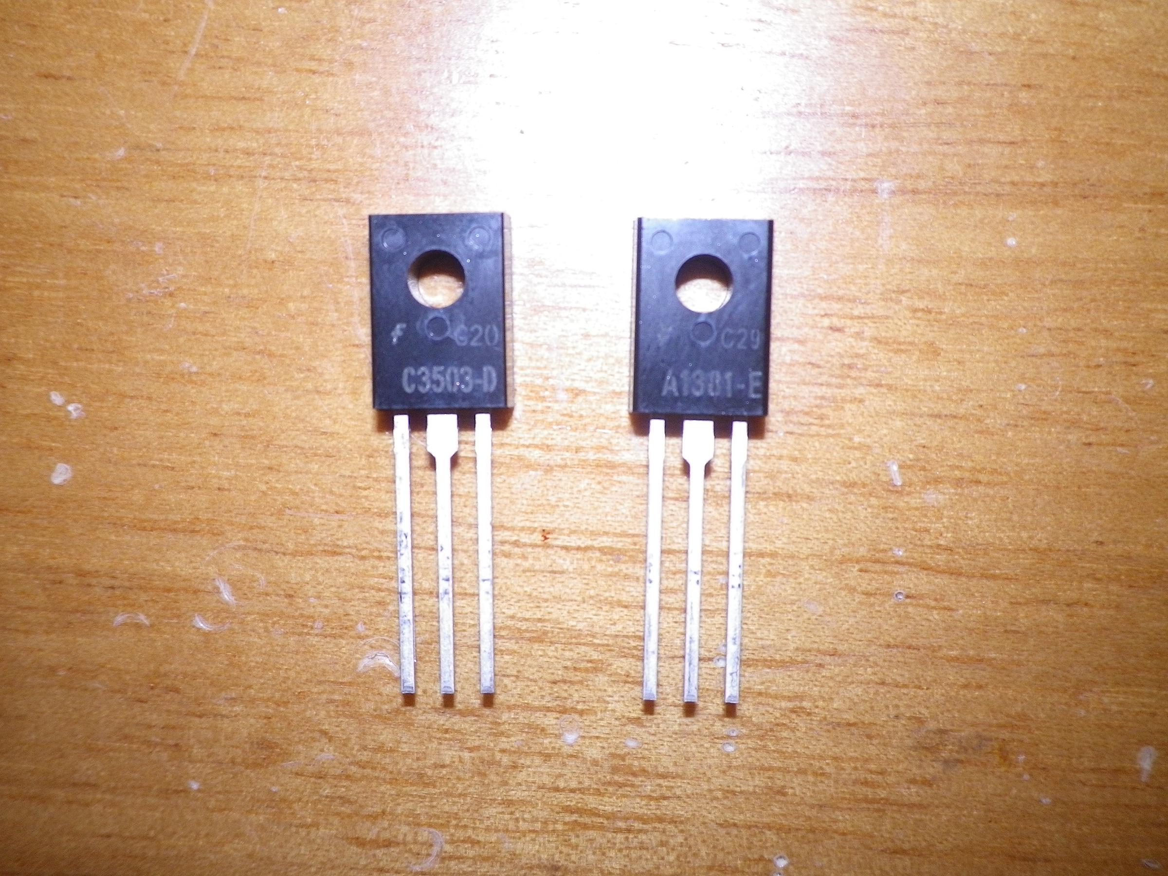

Speaking of gain match in the VAS, I just bought a bunch of the Fairchild KSC3503D and KSA1381E (I couldn't get devices of the same Hfe rank) and found that although the ranks overlap my KSA have about twice the gain of the KSC and none are all that close. These then won't be suited to future VSSA builds?
OK, what I have here is 100 pieces each Fairchild KSC3503D and KSA1381E, bought from Mouser. The gain testing was done on a DMM as a pre-sorting exercise which was intended to lead to further matching. The KSA range from a low Hfe of 133 to a high of 145 while the KSC range from a low Hfe of 76 to a high of 89. Quite different from each other.
According to Fairchild the other Hfe ranks are now obsolete, all new KSA will be E rank and KSC will be D rank which will largely preclude these devices where reasonably close matching is needed. Hope I didn't waste my money.

...these then won't be suited to future VSSA builds?
Yes these can be used, but, 1)offset will get a mind of its own, and may be 2)more even harmonix than oddz.
If you want your peeceebee to sound warm then use input and VAS pairs which are miles apart hFE wise(you may actually like the sonix, I like my DOZ very much 😀 ). But, for the real thing, close matching is necessary and within +/-20 is good, as Andrej said.
