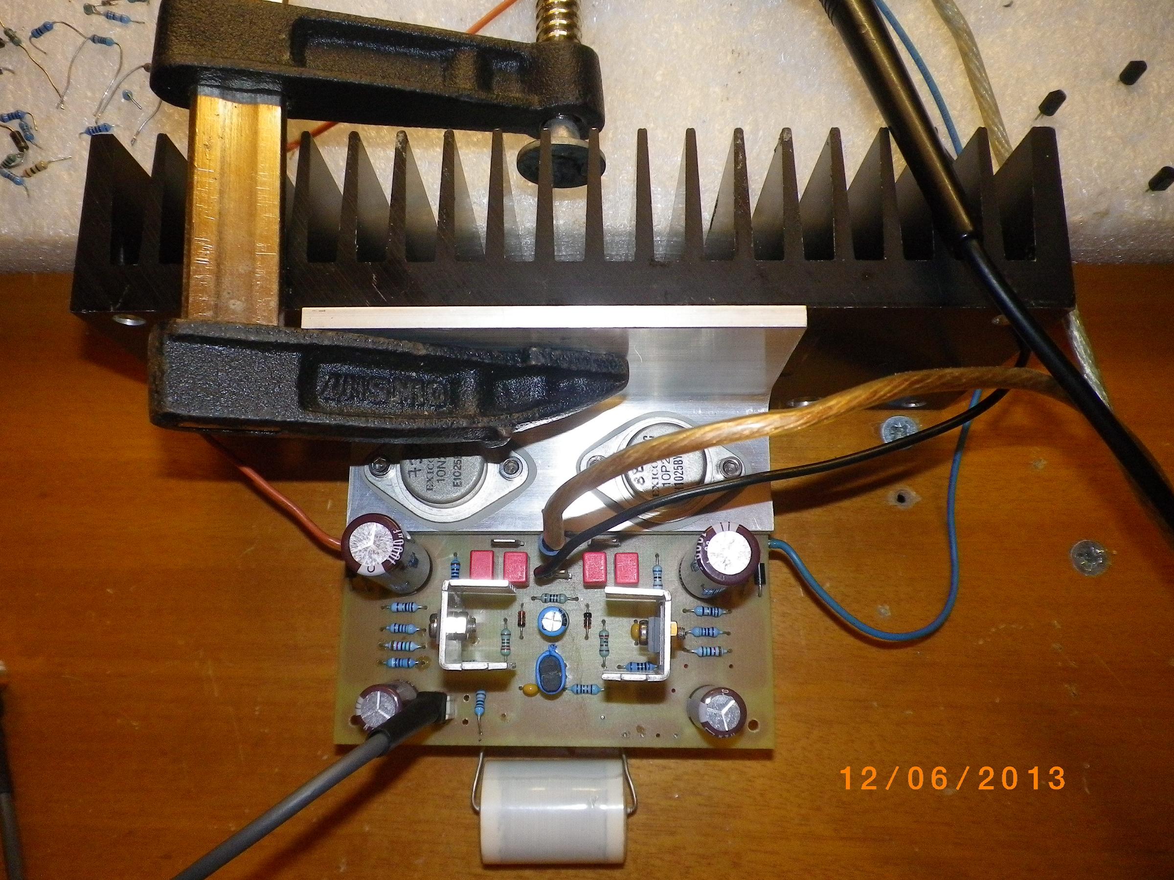

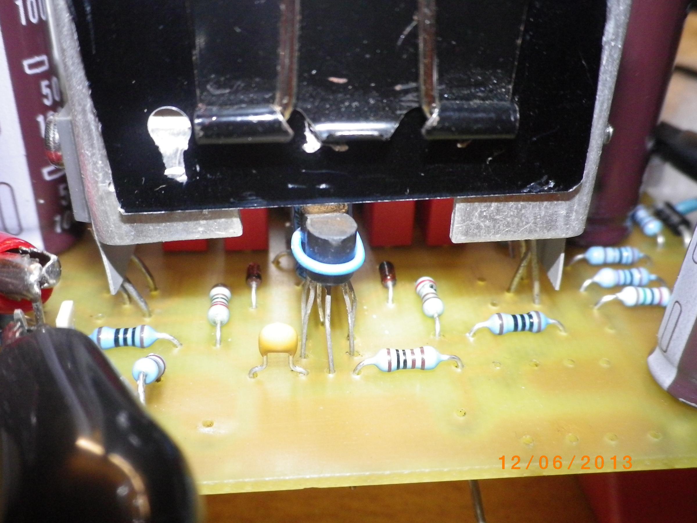

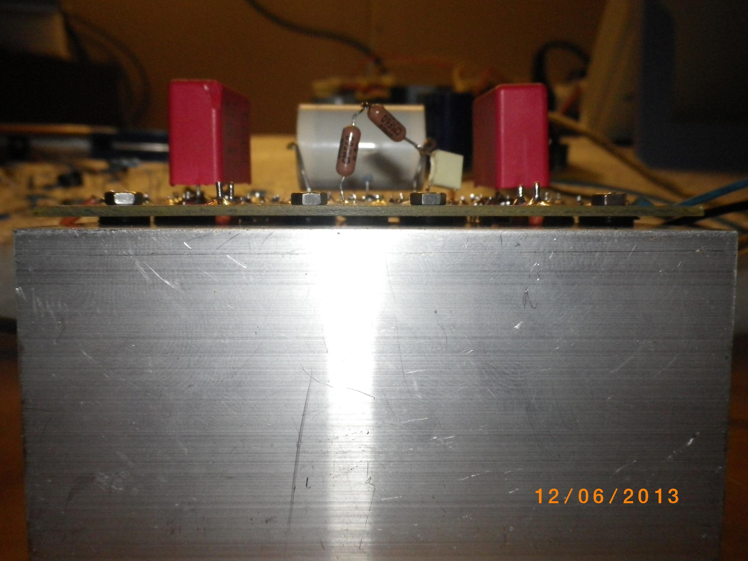

Look what you did Shaan , LC23 mA is too much for VAS, 12-15 mA is optimal. Input pair on the same temp (must be glued together), their gain match, VAS BJT gain match, PSU symetry if you use only resistors (not CCS) for input stage bias current, check them all, since all of them affects output DC offset. 🙂

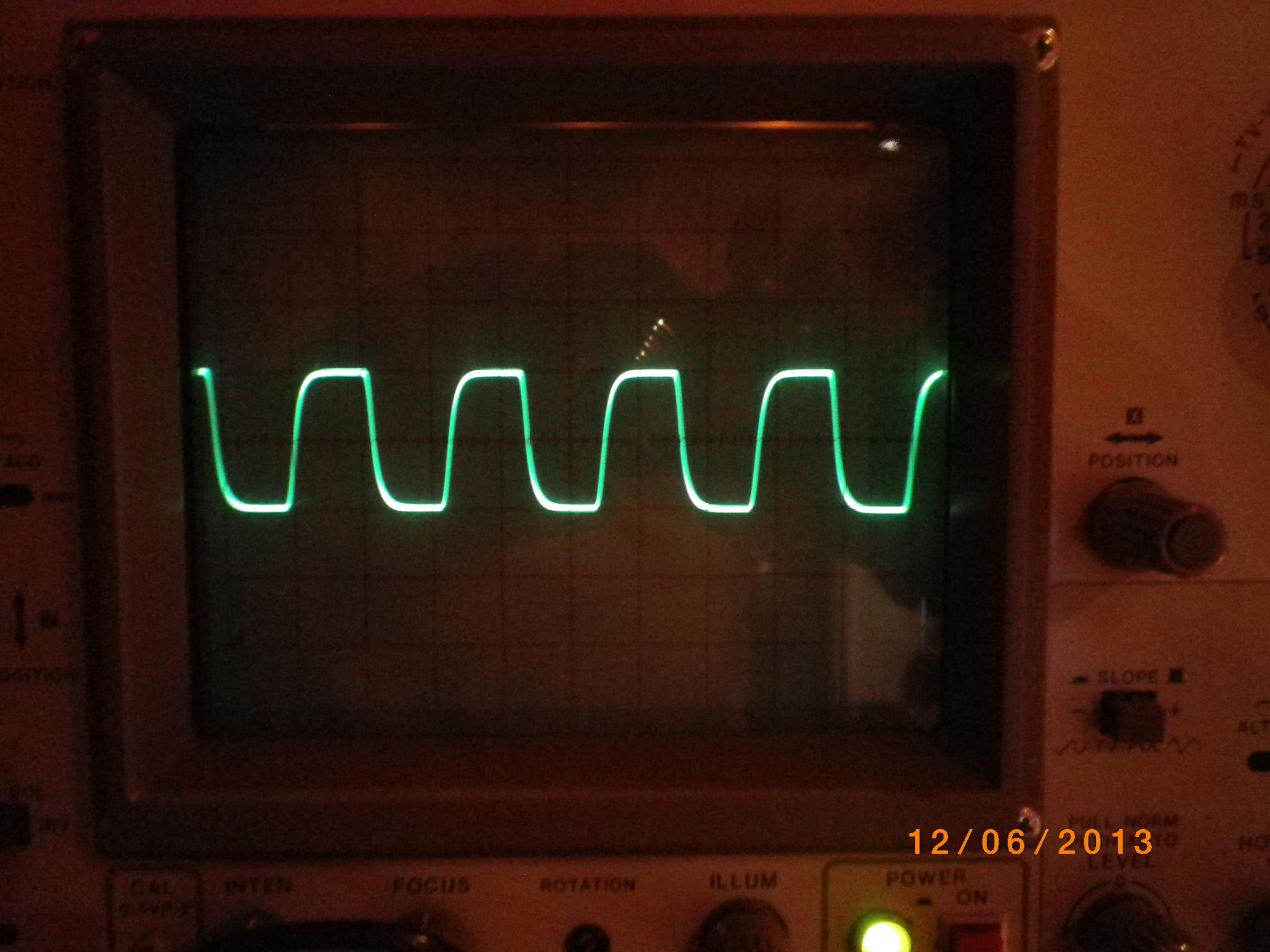

500 KHZ under load 8 Ω and ,10mF input cap without comp at all as told Shaan
No oscilation at full wave with BD 139 -BD 140 at 15ma , offset 0-5mv
unmached BC550-560 and BD139 -140 ,910 KΩ resistor paralell 15kΩ
on 100Ω 205 mv -208mv to other on 470Ω 790 -805 mv to other
magic sound !!
VSSA T03
Next step to put Zero gate res N ch and P ch and test at full load square wave to see if breaks at corners , and any osc
Also ι created a gap between boards and aluminum edge through an insulator so as not transfer the heat on board .

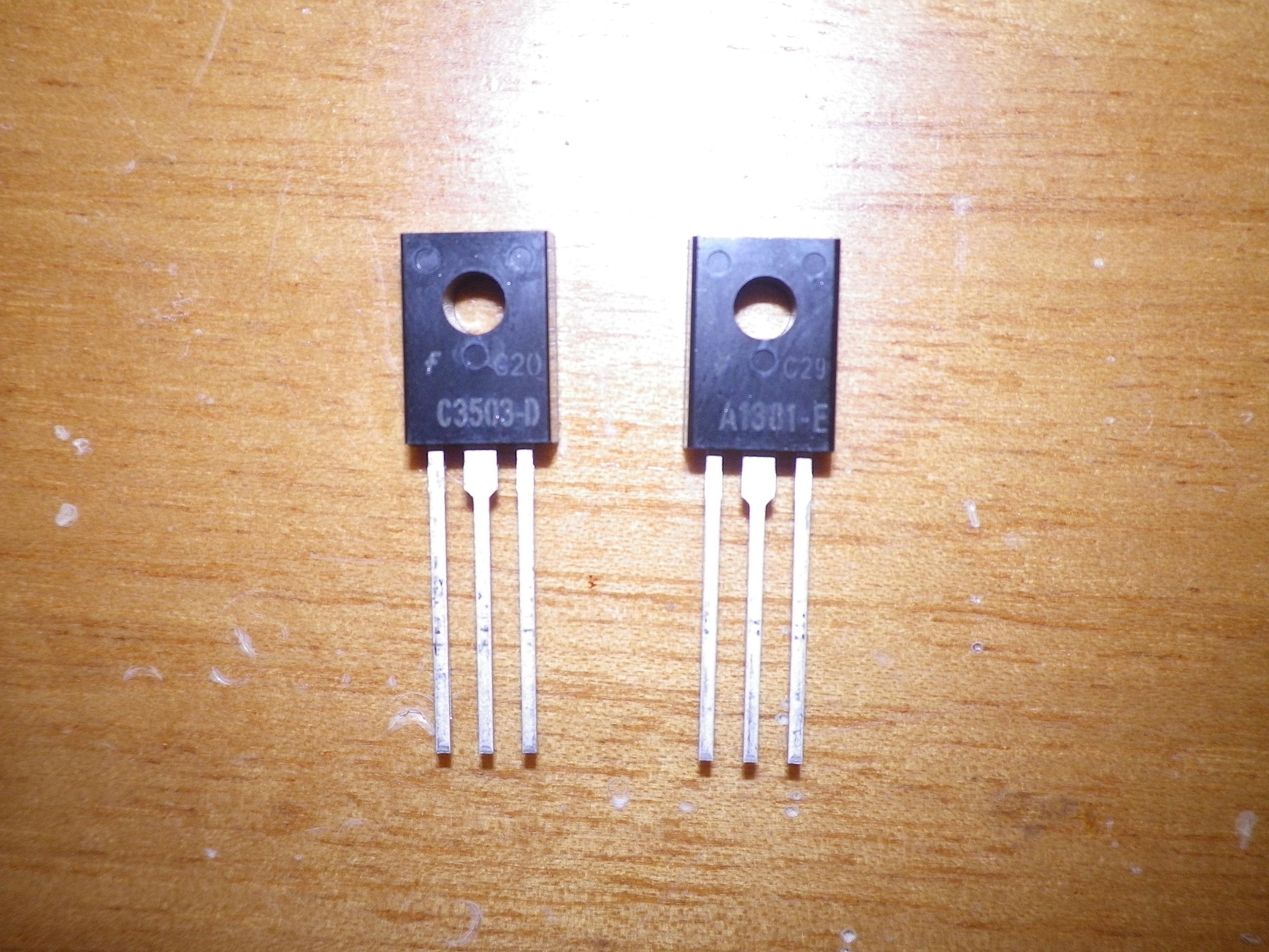

Anyway. I bought these transistors for better but I dont get good results offset and sound. Is it original ?
Zero both now. 😀

...500 KHZ under load 8 Ω... ...10mF input cap... ...without comp at all as told Shaan... ...No oscilation at full wave... ...magic sound !!
Zero oscillation without compensation, Proved. Thanks for the very symbolic post nikos, justifies my choice to eliminate those caps at VAS. The thread needed this.

...I bought these transistors for better but I dont get good results offset and sound. Is it original ?
I think they aren't fake. However, the suffixes (D and E) makes me think that they may be at least 100 units apart from each other in hFE. Did you match the pair before using?
No. I do not match
The same and I think maybe the difference to be there. Νext days im trying to measure and match them if is it posible.

I'm also confused about this: My KSA1381/KSC3503 are also D and E versions and about 80 hfe units apart. That's why I tought it would be better to use BD139/140. But I simulated with LTSpice both cases and the KSA's give me much lower THD. So, wich ones should I use?

Simulators, AFAIK, can't drive a speaker. And usually real measurements differ to a large degree from simulated results. The problem you are facing wasn't evident in the sim, this makes the point clear enough. 🙂
Our good old BD pair is (in fact) smart enough fo its job in a CFB amp, like VSSA. The performance of a specific component depends on how well it is implemented in the project. IMO, VSSA utilizes this old couple to its best (being a CFB amp) and there is little, if nothing, more to gain from modern counterparts.
That said, I will encourage you to try every possibility. For it's the experience that matters most. The conclusion is that, if you don't feel uncomfortable with BD, then don't change it. 😀

If you have them use the Fairchild KSA1381/KSC3503 pair, if not use the faster version of BD139/140. Use the cap. It will not affect how the amplifier sounds, and it may save you some trouble later...
